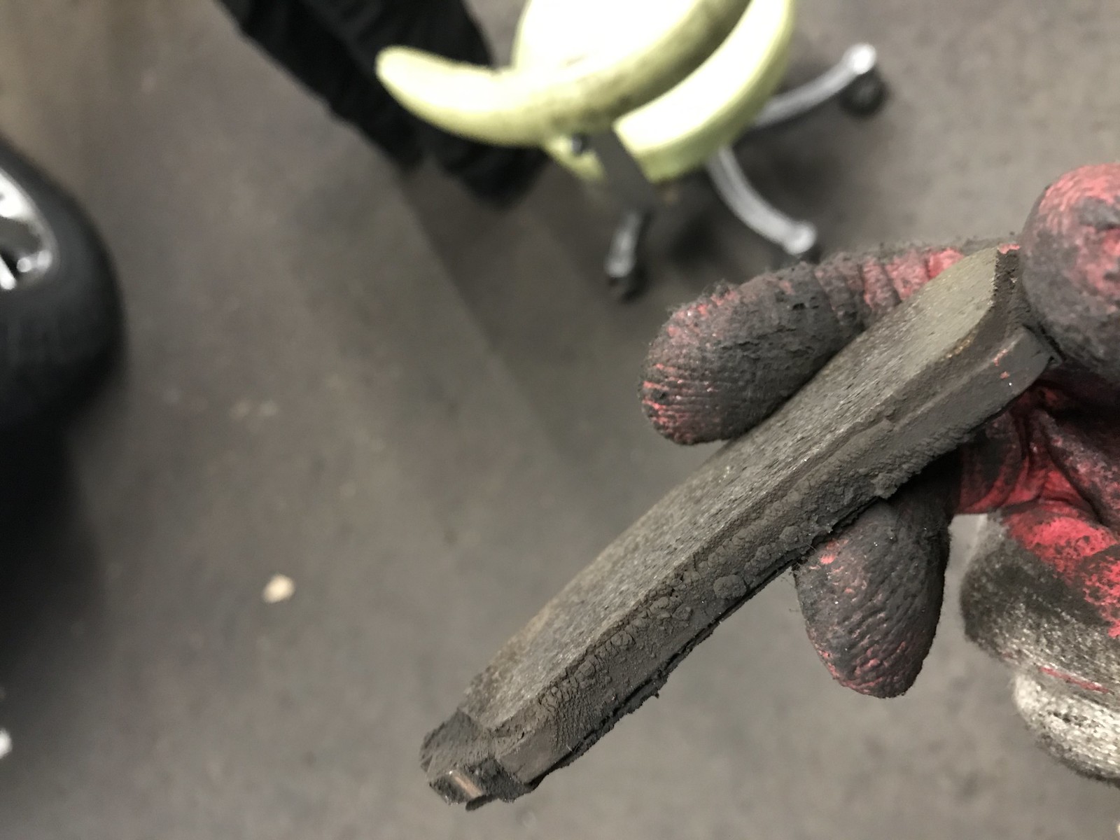

While installing the rear spacers, my inner pads were almost gone, they wore unevenly because one of the slide pin was a little stiff. Took that out, clean up the old grease and applied new grease and installed new pads. Should be even now that everything slides smoothly.
