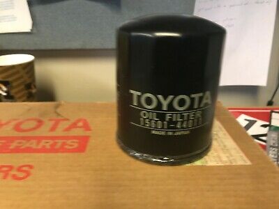

@CatskillsRunner did her first oil change on the 2UZ-FE.
Used a different oil filter too. Can’t stand the Thai manufactured -YZZD3. Decided to use the Supra 7M-GTE Japan-made Denso filter instead. Perfect fit.
View attachment 2211905View attachment 2211906View attachment 2211907View attachment 2211908View attachment 2211909
Wow, that filter is massive compared to stock. It clears the drip deflector ok? Wish i had known this, just bought a case of 90915-YZZD3 off of ebay last week. I see that there's a case of these available now for 40 bucks.
How much more oil do you end up putting in?

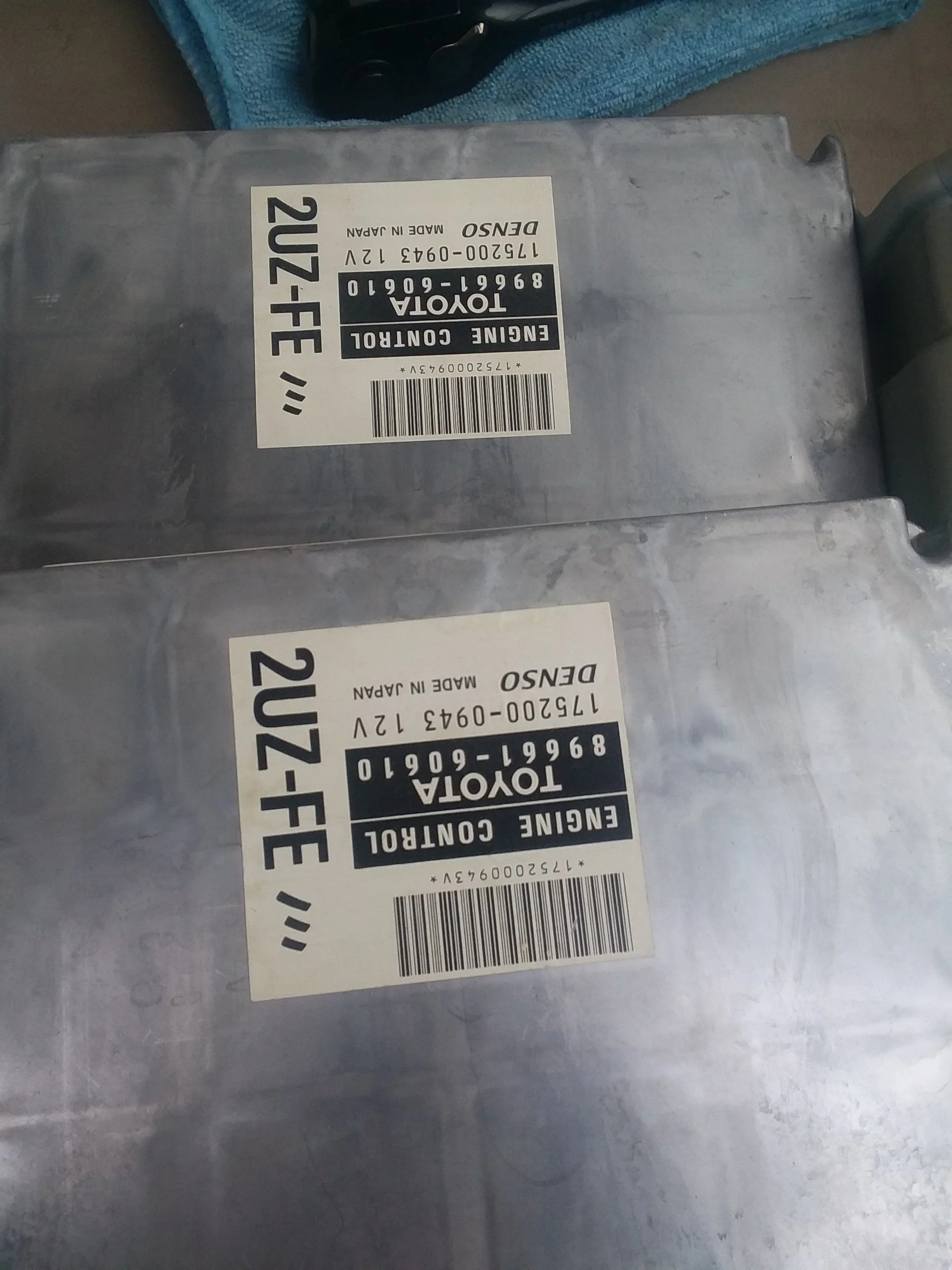

Just Wednesday I replaced my ECU with an exchange from @Mauser -great service and very helpful.
Now relieved to have six master keys and a valet.
15601-44011 aren’t available from your Toyota dealer here in the states. They have to come from Japan. They are only available in Japan.
Oil capacity is 7.2qts for the 2UZ-FE... I went with 7.5 roughly.
