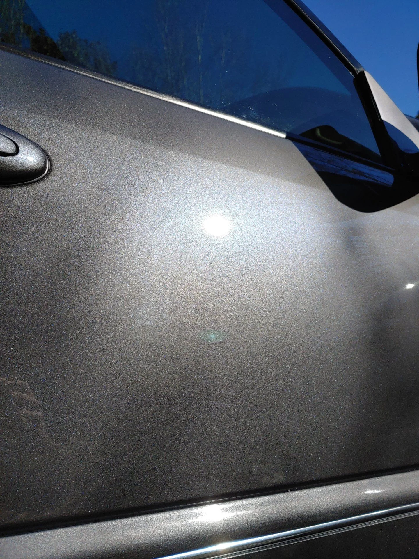

How is it holding up in person? I don't mean to sound rude, but it looks like it's faded back to match what mine looks like in the pictures. I'd been considering doing it as well.
Don’t worry about it man no biggie that guy who I had it painted is a con. Poor job. Yeah it’s kind of faded. I will have repainted again this summer.

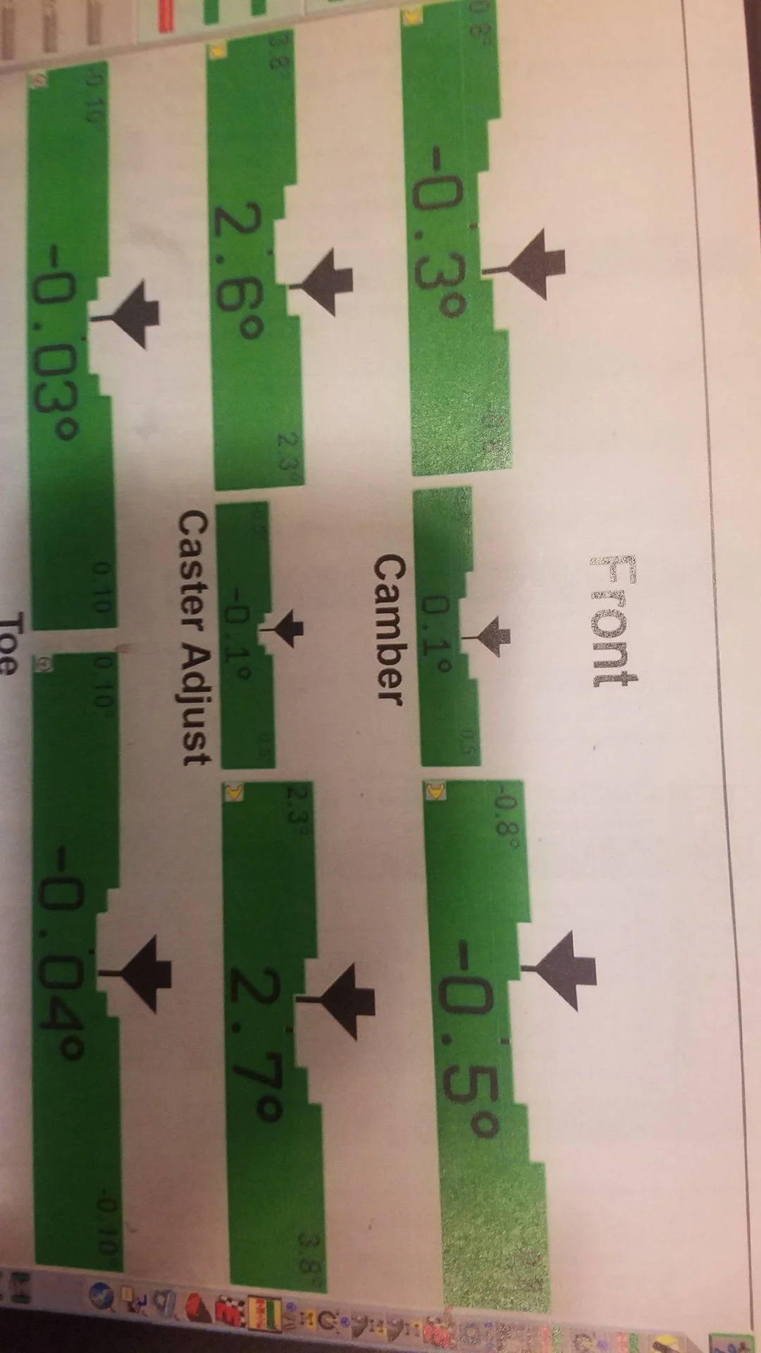

Installed the Nitro Upper Control Arms with uniball ball joints. The 21 year factory ones that came out weren't too bad and the ball joints are only 6 months old - so probably didn't need the upgrade, oh well!
Left the truck at the local Toy dealer for alignment only to get a call from service rep claiming that they can't align my truck because it has aftermarket parts and they don't know how to align them :rolleyes:
When I explained to the rep that it should all align to the factory specs with the same camber bolts etc, they said they would charge $250 for alignment instead of usual $109!! I politely insisted that this is no different that any other alignment and finally got them to do for regular price. Asked them to max out the caster on from wheels. Here's what the new numbers look like.
What do you think?

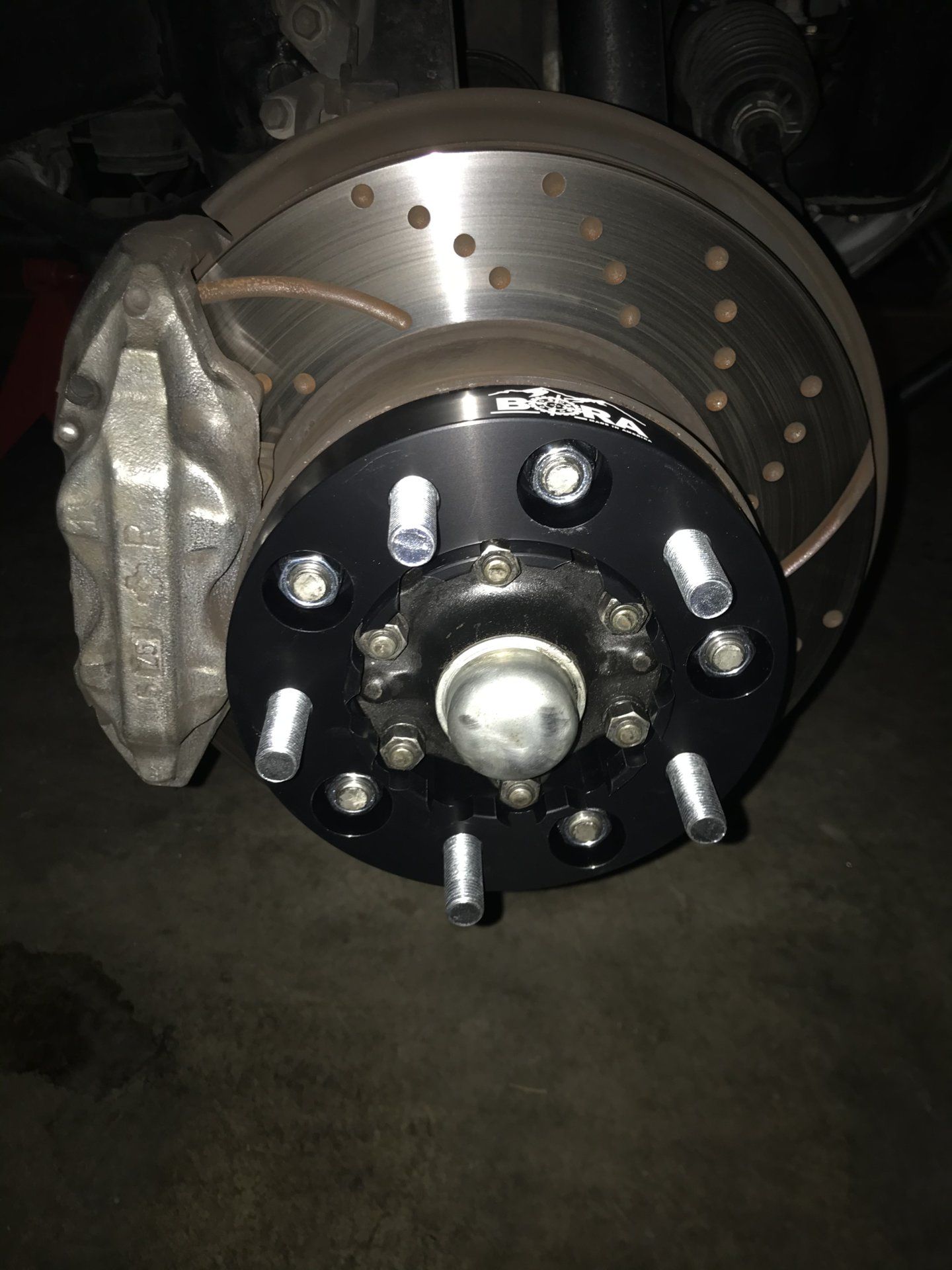

I like to be pro-active and do maintenance before needed. Changed out the rear pads.
They were good for at least another 23 miles . . . :rolleyes:
I pushed them a few weeks waiting for my Bora spacers (BF special). Spacers installed (rear) too. Inside pads wore more than outside, 2mm on the outside might be paper thin on the inside. I didn't catch these because I check the fronts, and assumed rears wear slower. The fronts are next (still have 4-5mm, they were replaced same time as rears).
Got great mileage out of the Akebono pads - soft on the (new) disks too. Replacing w/ akebono for the front and some wagner (rockauto closeouts) on the rear.

So I notice that it is much more responsive to the steering input and there is a lot.less wandering at highway speeds.
