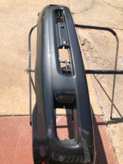

Been a while since my last update, but I've been busy! Had my hood and roof professionally re-painted and chose to tackle the bumper and fill panel myself. Custom matched aerosol topped with spray max 2k clear. wet sanded with 2k grit and polished with my PC orange LC pad and Meguiar's ultimate compound. I got really close to the factory orange peal and it looks fantastic up close. I had already done my trim and the next step is the rear bumper. I will post some updates and before and afters on that as I go. Installed new Depo fogs while I was at it. Thanks @renma21 for those.

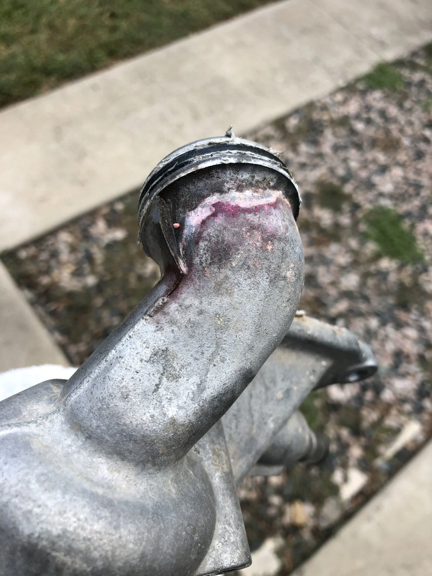

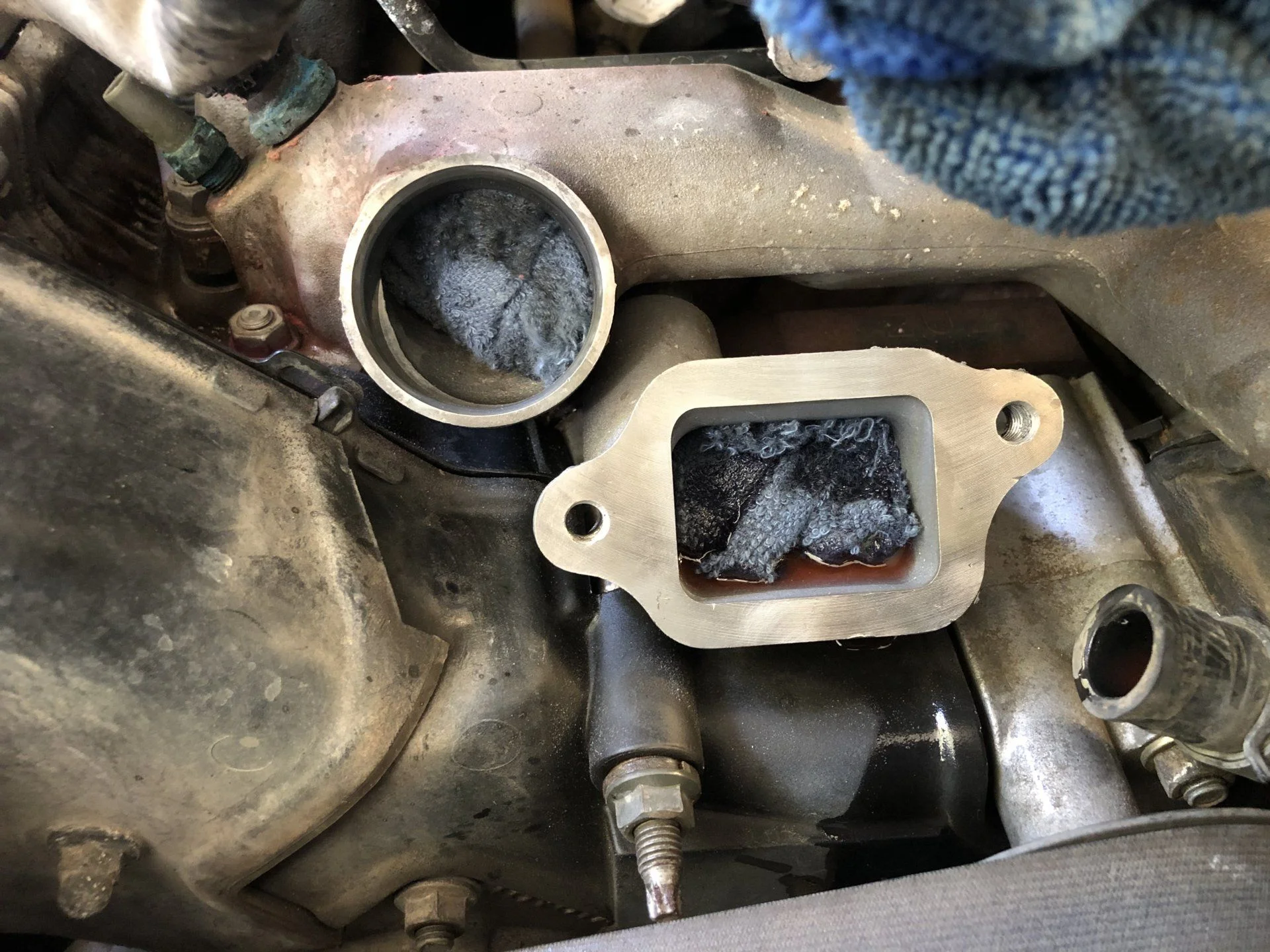

I have over 290,000 miles now on my 2003 LC and had some time this week to do a little work. First started with the coolant leak at the thermostat bypass at the front of the engine. Ordered the O-ring and black gasket maker to make the repair. I drained the radiator and pulled the thermostat bypass housing off after removing the air intake tube. I may have lost a half gallon of coolant which was topped off in the end. Then, while waiting on the part to be shipped I changed the front differential, transfer case and added a quart to the rear differential. Greased the driveshafts and ball joints underneath.

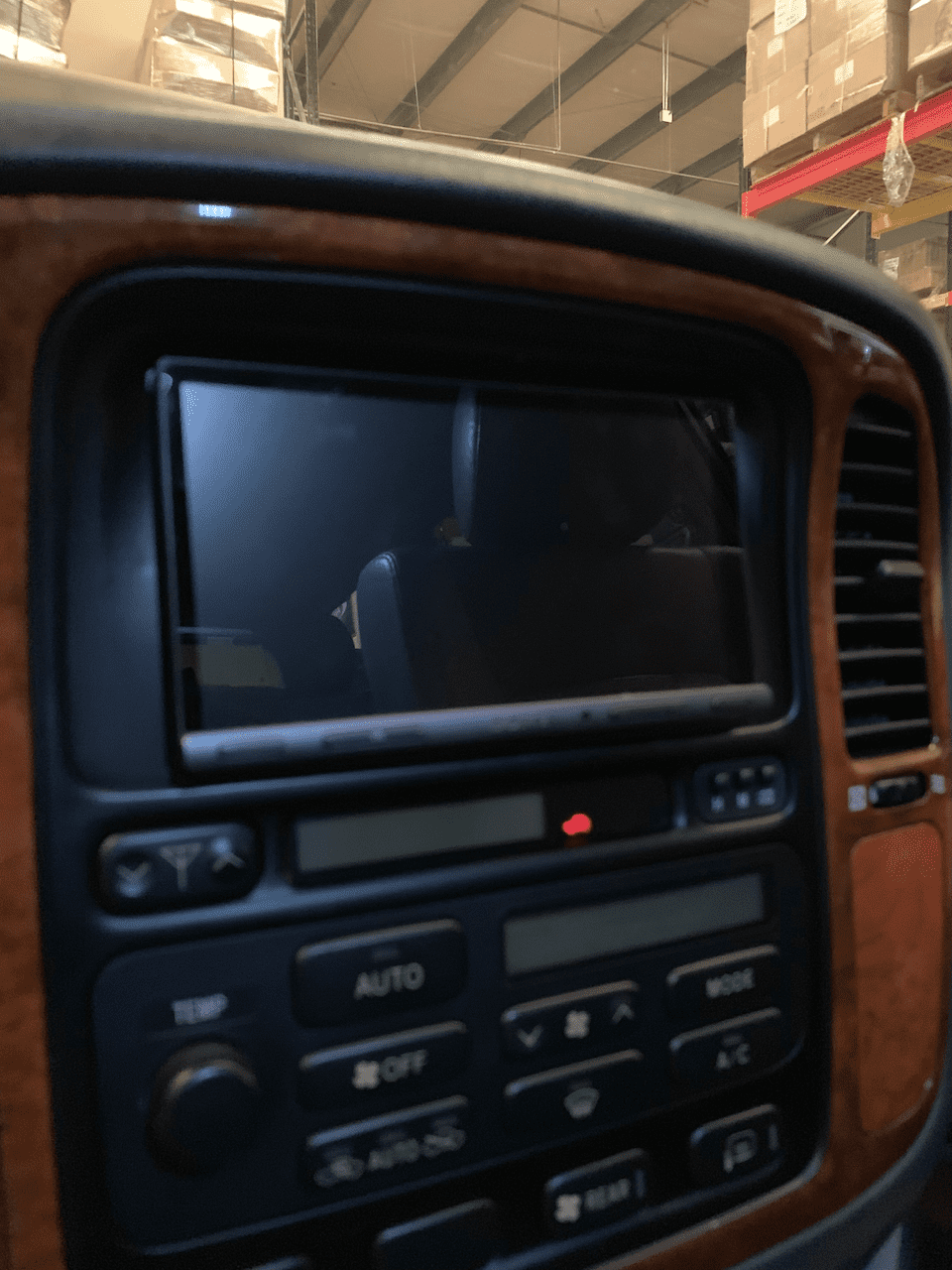

The best part was taking the USA Spec Ipod interface out and replacing it with a GROM blue tooth and hands free calling unit.

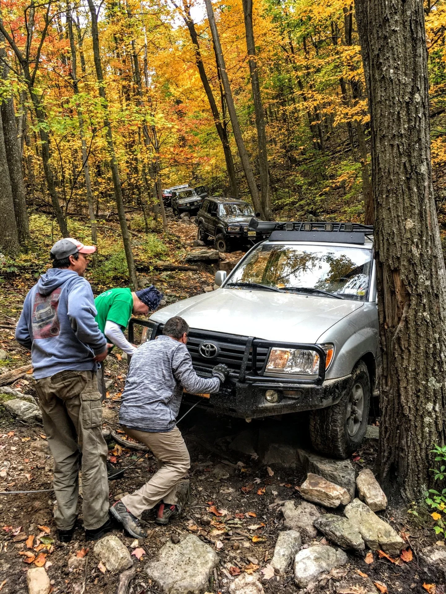

It was mildly nauseating to know turning either way down the hill meant trouble. The trees actually kept me from sliding further. I felt a lot better with the lines on the truck. It was the first time I have winched while driving, which was really intimidating at first but I've got some pretty knowledgeable coaches.
It looks like fun was had! I am glad you fenders and doors didn't get bashed in. Do you have a rear locker?
No.
But even tho he knew this, my buddy kept saying to me: lock the rear!
Actually got a little dent right between the tire and slider. My husband is more upset about it than I am.
A locker would've come in handy on those black trails.
