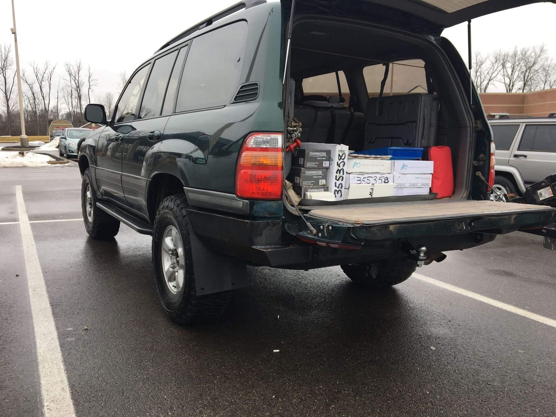

So the truck almost left us stranded along i65/i70 on the way back to Ohio. Voltage dropped to 10-ish. I was able to stop at a Costco and by 2 interstate replacements to get me home 140 miles. First one went in right away and the second one went in 9 miles from home. I drove running minimal accessories at 75mph. Heater at hottest setting and the second notch and parking lights on at night. The ABS system will shut down just before the fueling system at about 8-9 volts.
I don't really blame the truck, I hold Schaumburg Toyota in Illinois responsible. They diagnosed the original issue at a dead battery. Stated they inspected and cleared the starter, alternator, and associated electrical systems and found zero issues. This issue manifested the second time driving after realease from service (first was driving it to my in-laws).
At least now im home and can start trouble shooting. I'll start by disconnecting aftermarket stuff and checking the starter alternator and grounds.

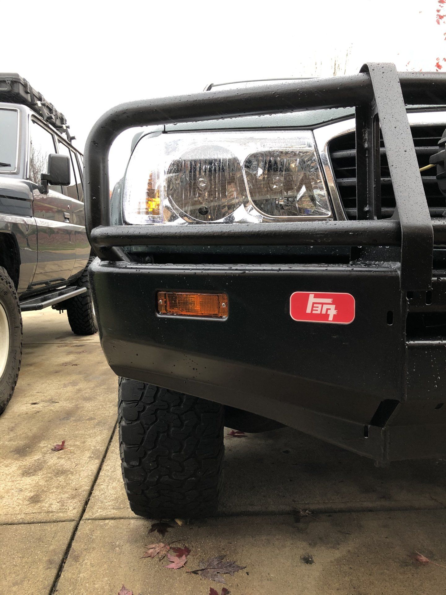

A lot of work to my 77 recently. Now it’s the 100’s turn. Depos went in a while ago. Great upgrade to factory lights. They will likely get morimoto hid’s at some point.

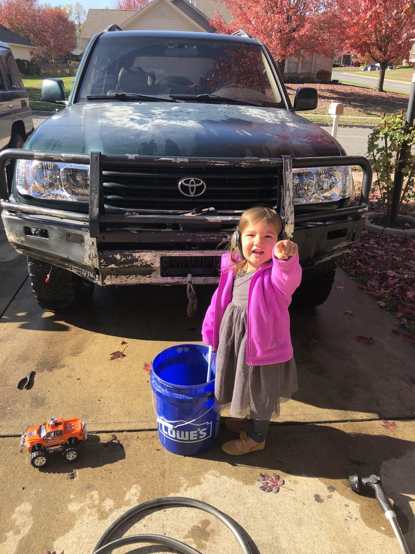

I started pulling the front bar to send for sand and powder, however the first bolt pulled on snapped off.
this truck is likely getting 37’s in the future, so screw it I’ll cut the bar off at a later time. Decided to strip as many accessories as possible, and deep cleaned with dawn. Chased all the rust veins from stone chips, rewashed and prepped with por 15 metal prep. The por15 will go on tonight and rattlecan rustoleum satin black once cured.
Because the bumper couldn’t come off this go around I’ve done the best I could.
Several scrub downs with zep degreaser (concentrated bottle but doing a 50/50 mix).

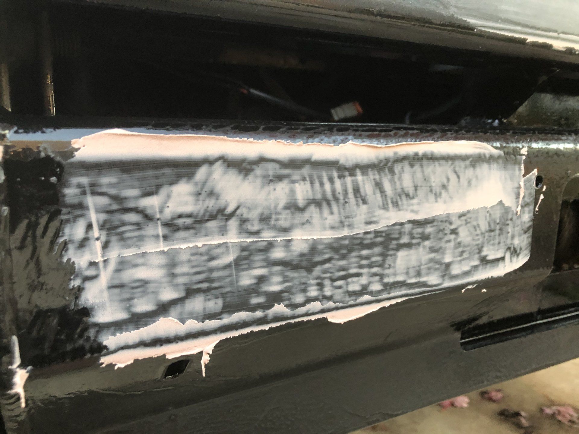

I did have some visible marking from grinding out the rust on the front. Decided to fill the grind-scars and trail rash with bondo. It’s a very superficial and applied over three coats of por15. I’m not going for a perfect finish just reasonably smooth.
(Before the bondo was applied)
I used a combination of: palm sander and hand sanding to finish off the foundation. The back side didn’t get this treatment. I didn’t really care that the por15 had drip lines.

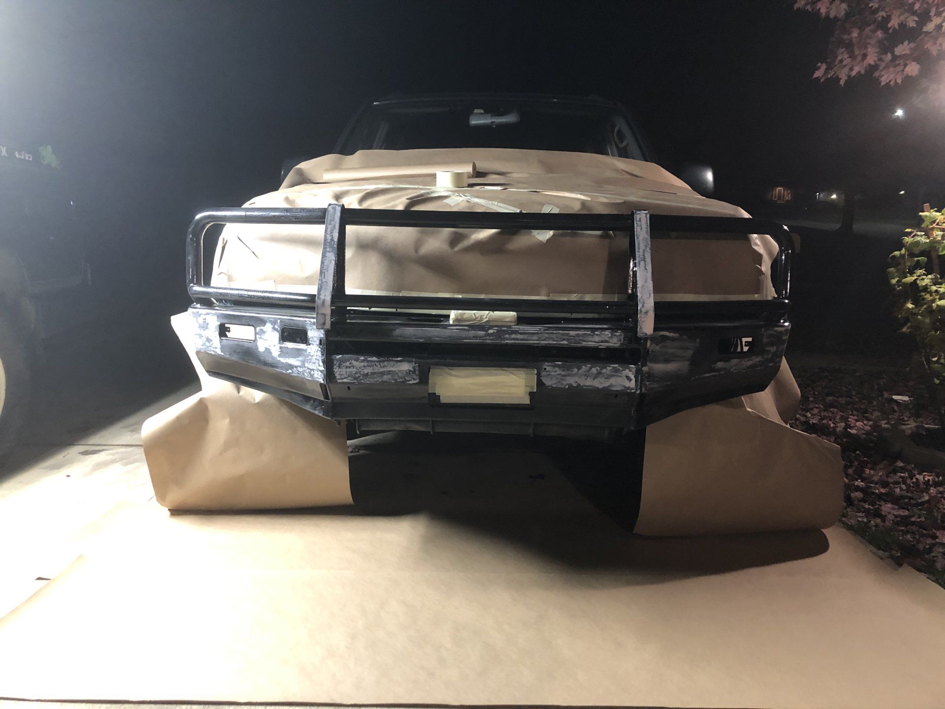

I then wrapped the truck in paper and hit it with maxx fill 2k primer. I’ll wait for that to cure then I’ll finish off with a satin black with satin top coat
