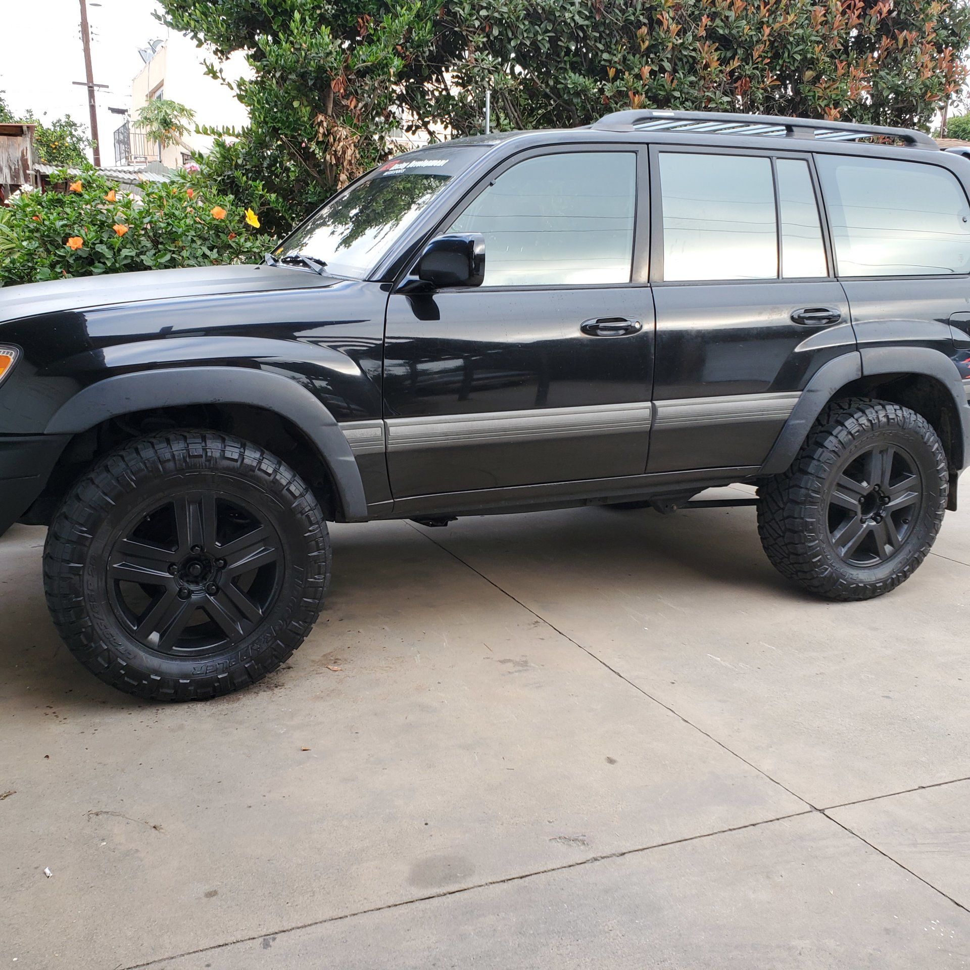

Did the quick mod for the AHC. She now sits at this for mode N. 1.5” higher if in H mode.

that's cool! so basically your high is extra height mode and normal is your high mode? how did you accomplish?
No.
