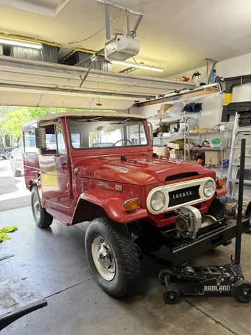

New bumper and mounting an old Warn-Belleview winch I had laying around
