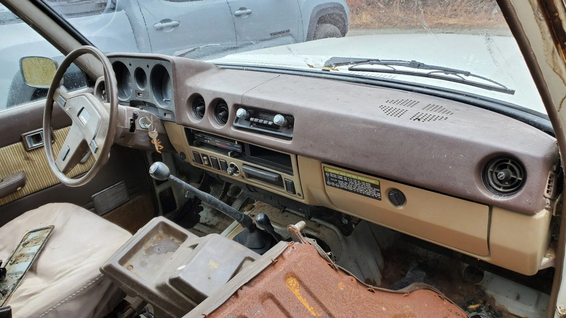

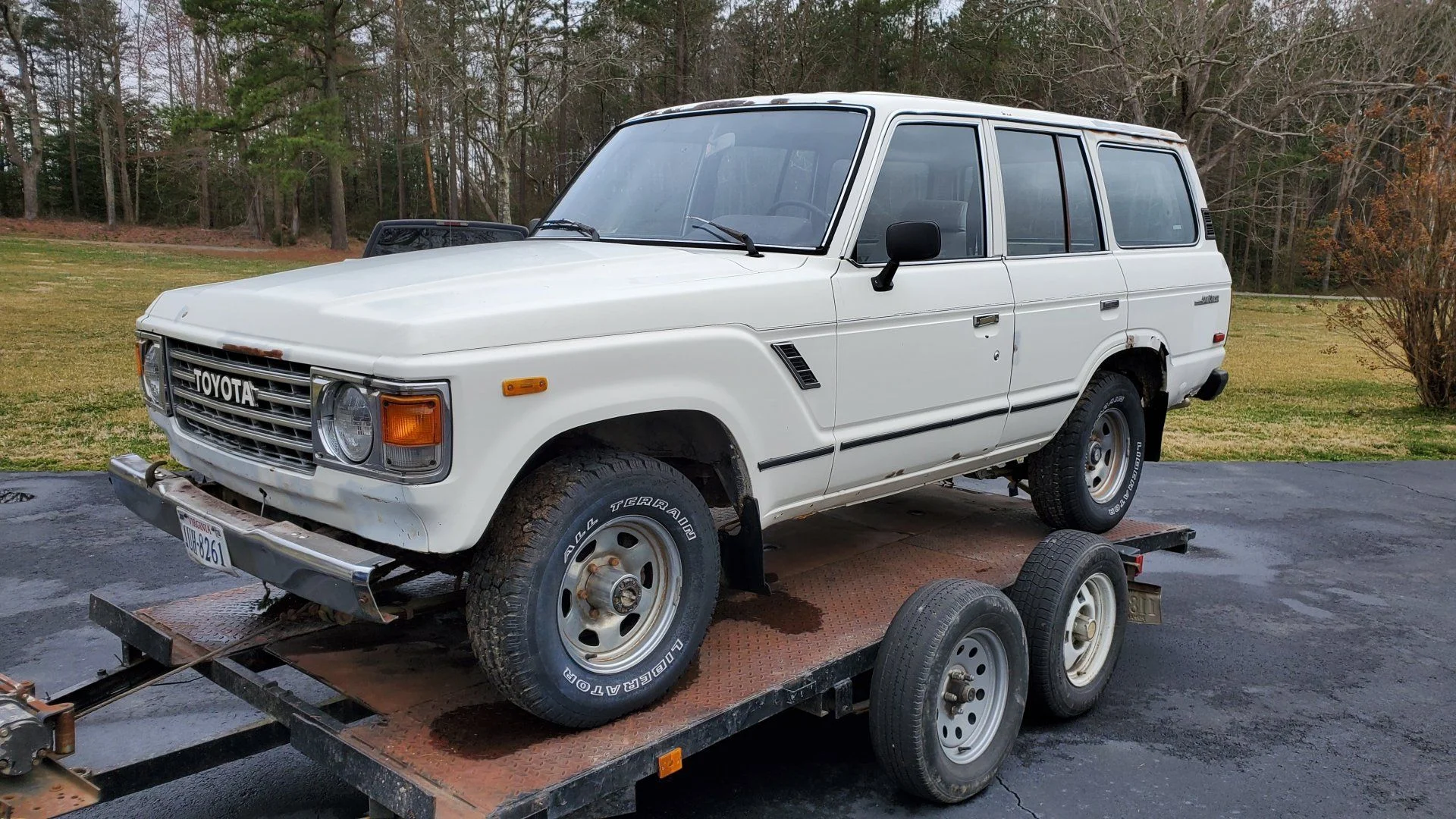

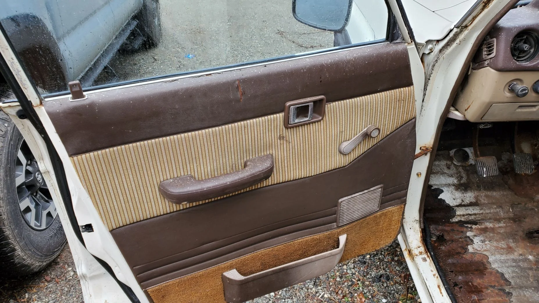

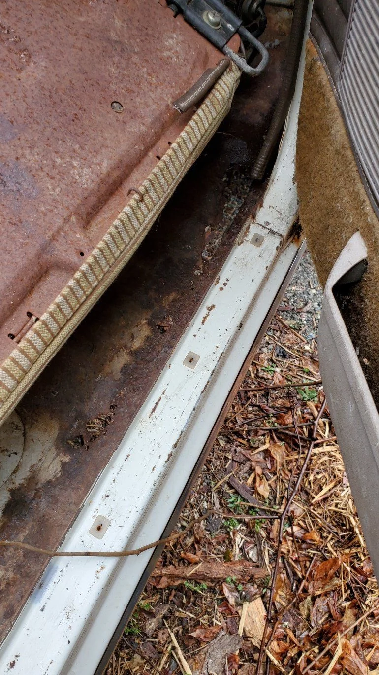

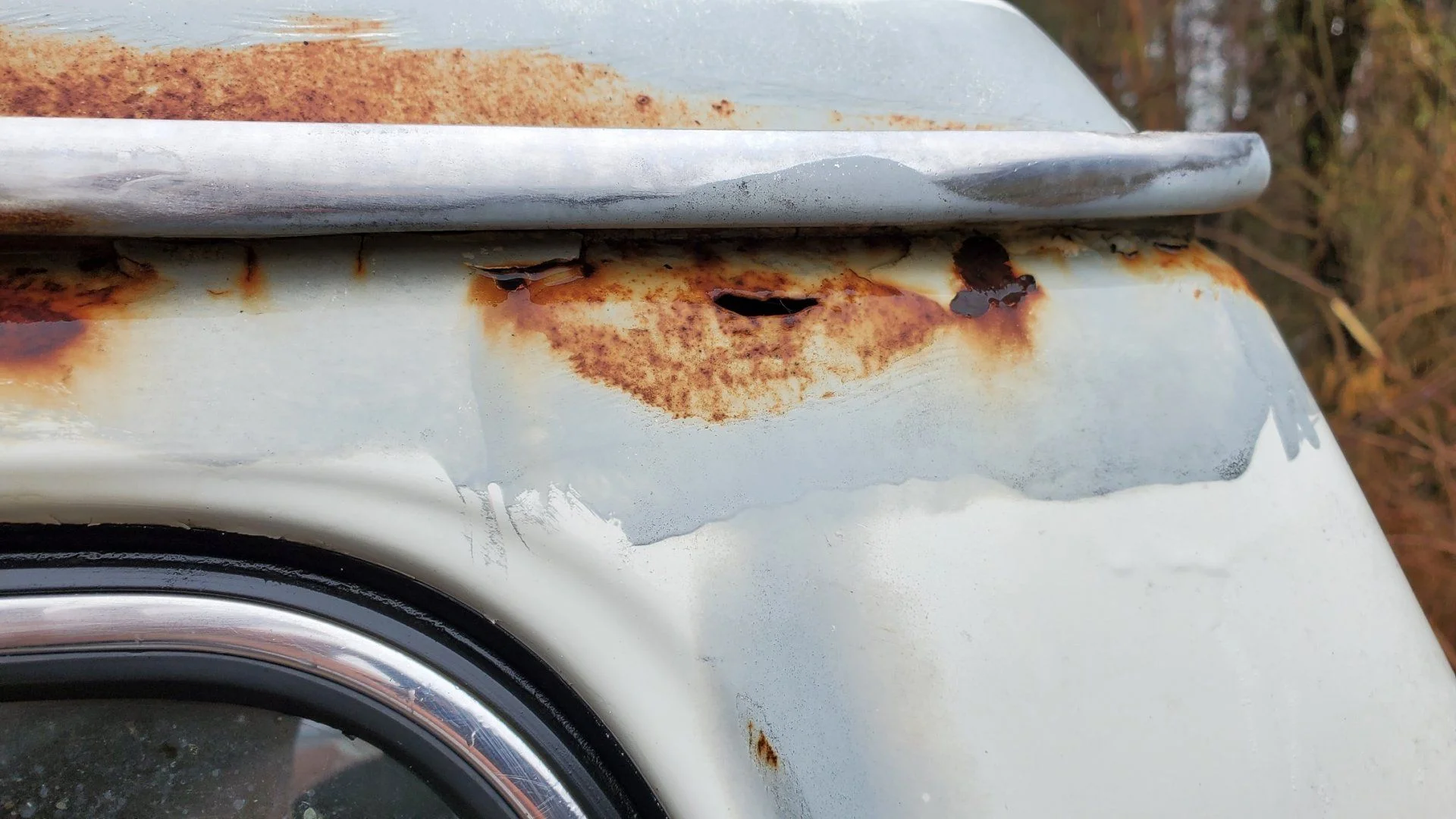

Well I'm usually the guy who figures out he wants a certain classic 5 years after they become popular and decent examples become expensive and the rest are a ton of work. I decided I wanted a 60 bad enough to take on a pretty big project. I doubt it's the most rusty but it's definitely going to teach me a lot about body work and everything else. I'm hoping to learn a ton from this forum and honestly reading through ih8mud is what convinced me to actually take the leap. I will add more pictures as I start working on it. The rust is pretty much in a bunch of places. It's going to need floor work from leaks. Lots of what I'm hoping is mostly surface rust on the roof, rain gutter, just above the windshield. The body is actually very straight with a few small dents in the roof that I think will push out after dropping the head liner. I'm hoping to get my 11 and 9 year old sons interested in cars by involving them in the work and decisions along the way. I was told the motor has no compression in 3 and 4 so I'm currently assuming a blown head gasket after a little preliminary research but I plan to adjust the values and do some diagnoses myself.
So the specs.
1981 Toyota Land Cruiser (FJ60)
Cream(not sure of the real name) with brown interior.
I didn't bother checking the miles yet.
Mostly complete but pretty torn down so until I go through everything I won't know.

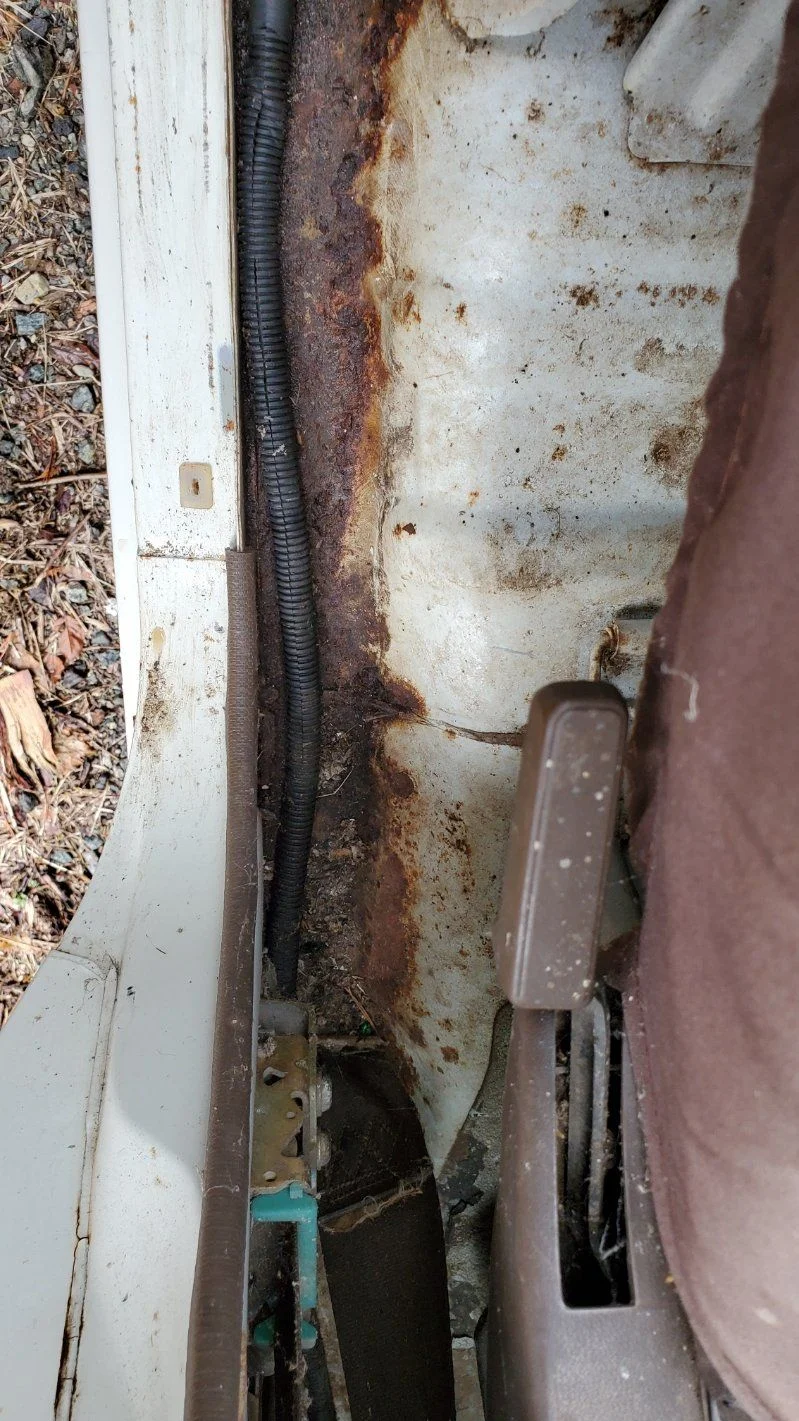

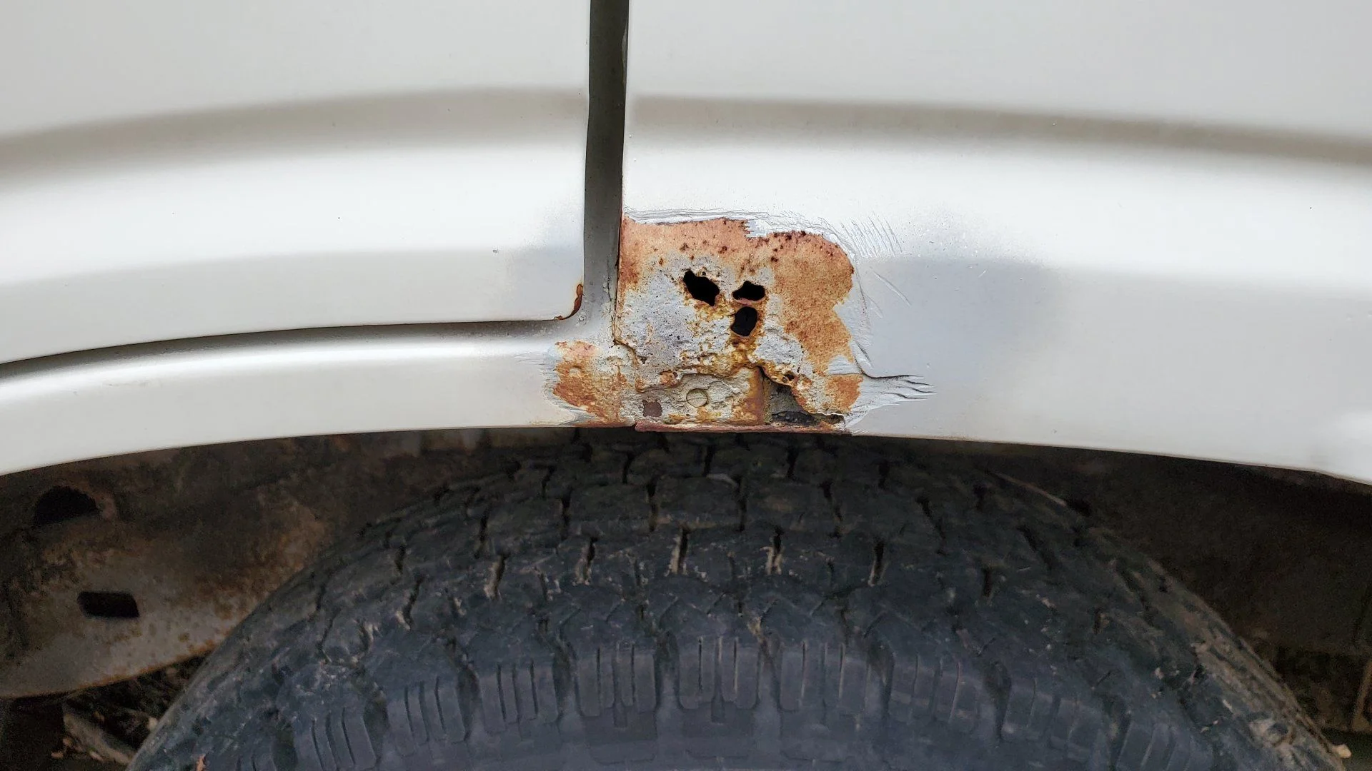

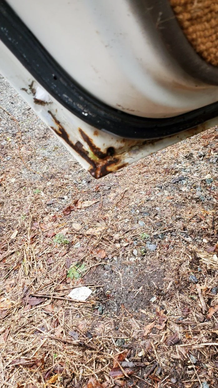

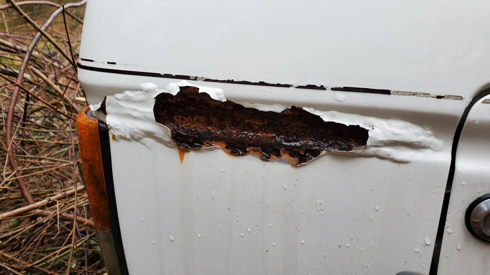

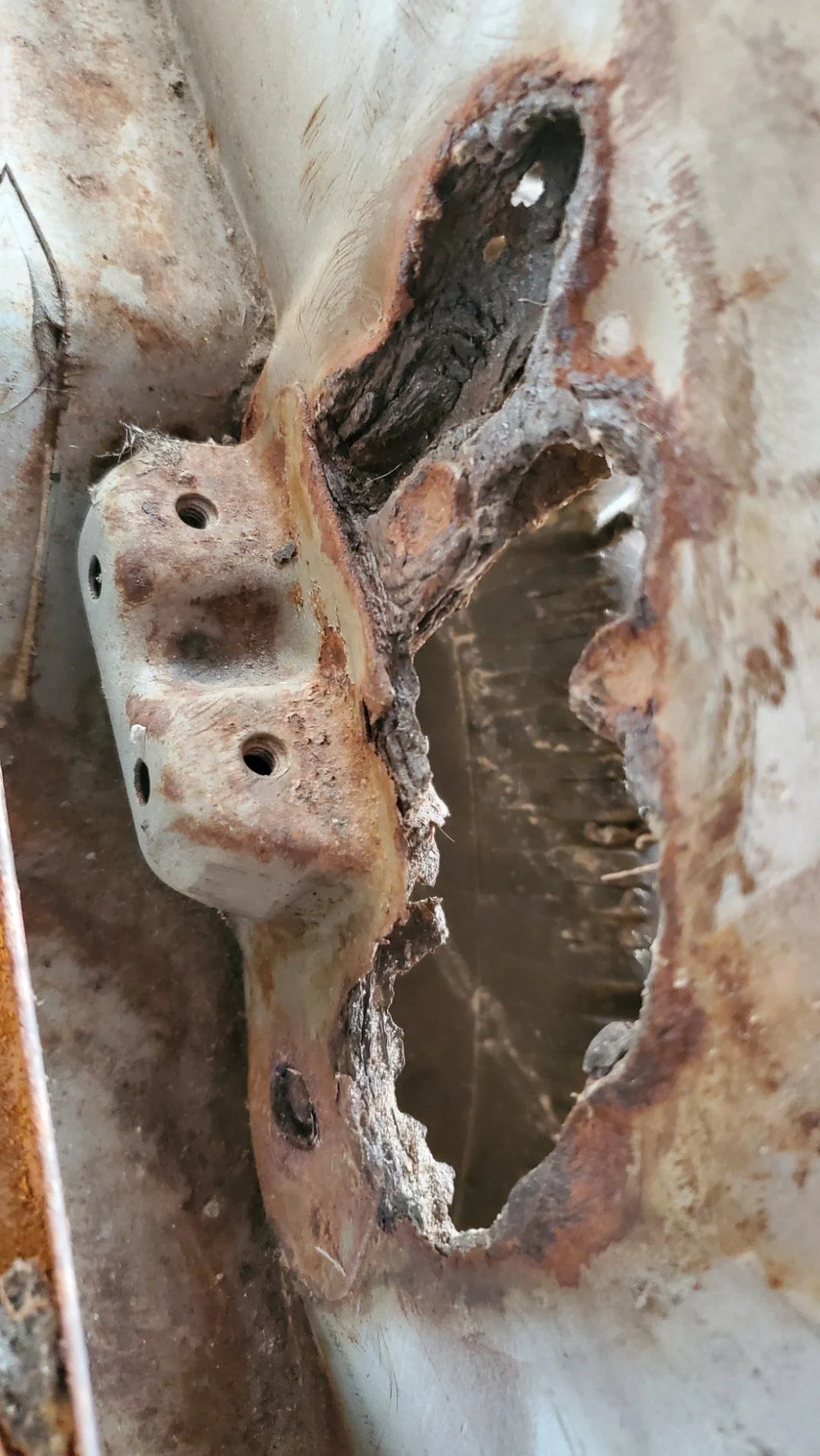

Yeah, you got some work to do but I've seen worse rust. Hell, I have worse rust.
The engine will be the real kicker though. Let us know how it progresses.
Good luck.

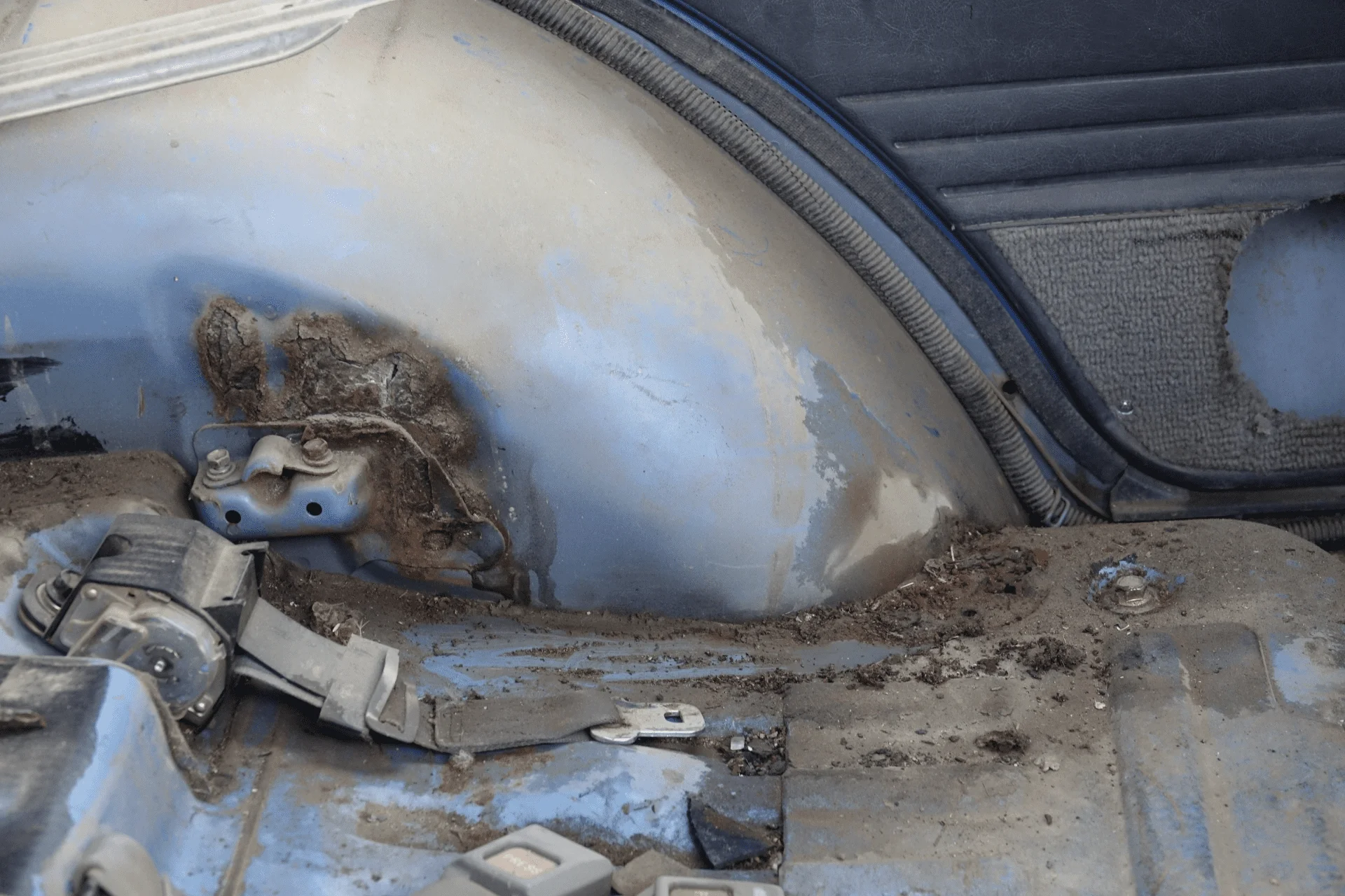

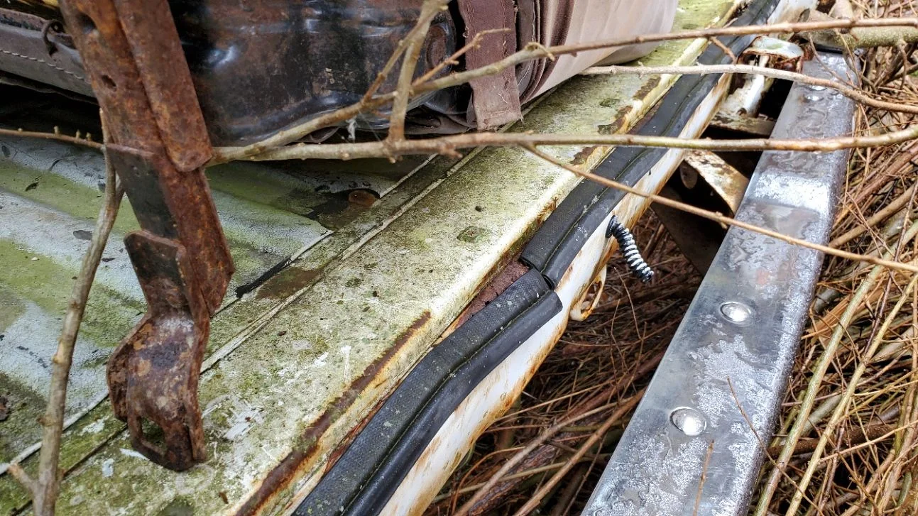

And just to share your pain a bit; here is just one spot on my particular rust bucket.
Good luck.

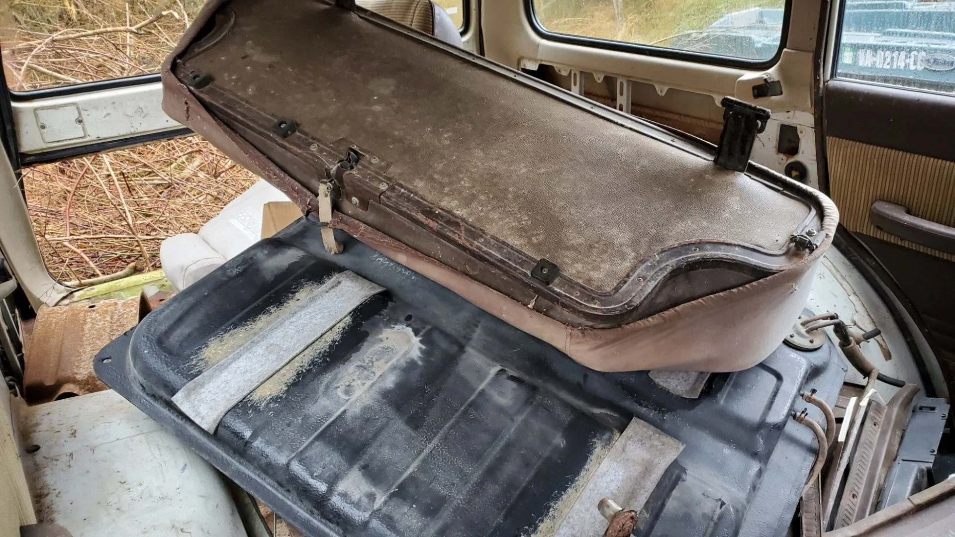

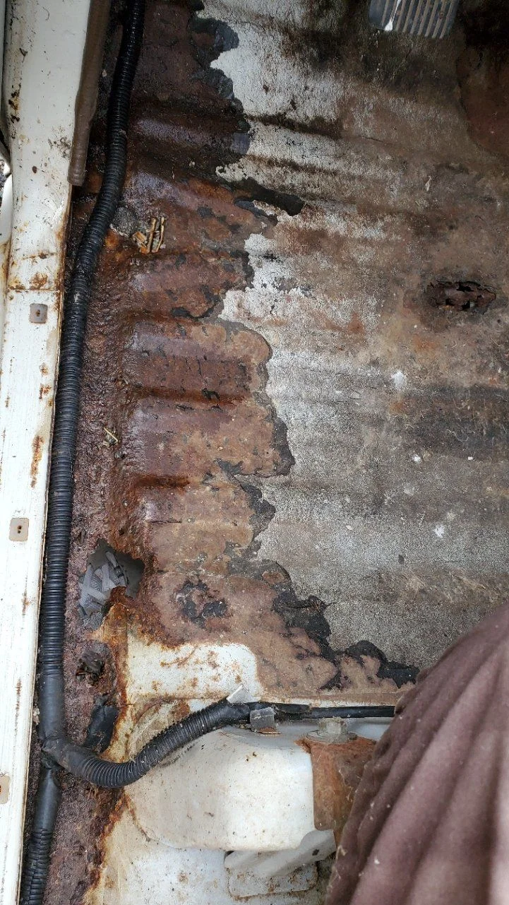

Yeah I can see the ground through the floor in several places and almost from the front to back on the driver side. Once the rain stops and I clean out all the bits I'll post more. I don't think the wheel wells are rotten but who knows. I do like your blue interior not sure the brown will last as the carpet is already long gone and the dash is rough so might get replaced also. It's really amazing how rusty these vehicles get.

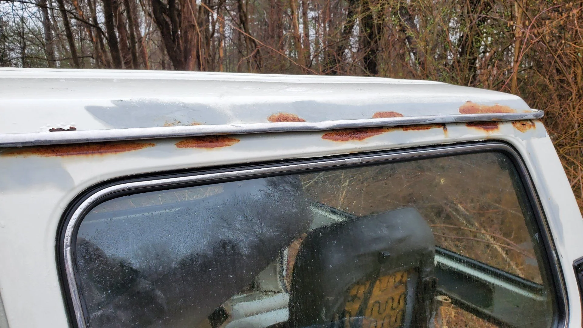

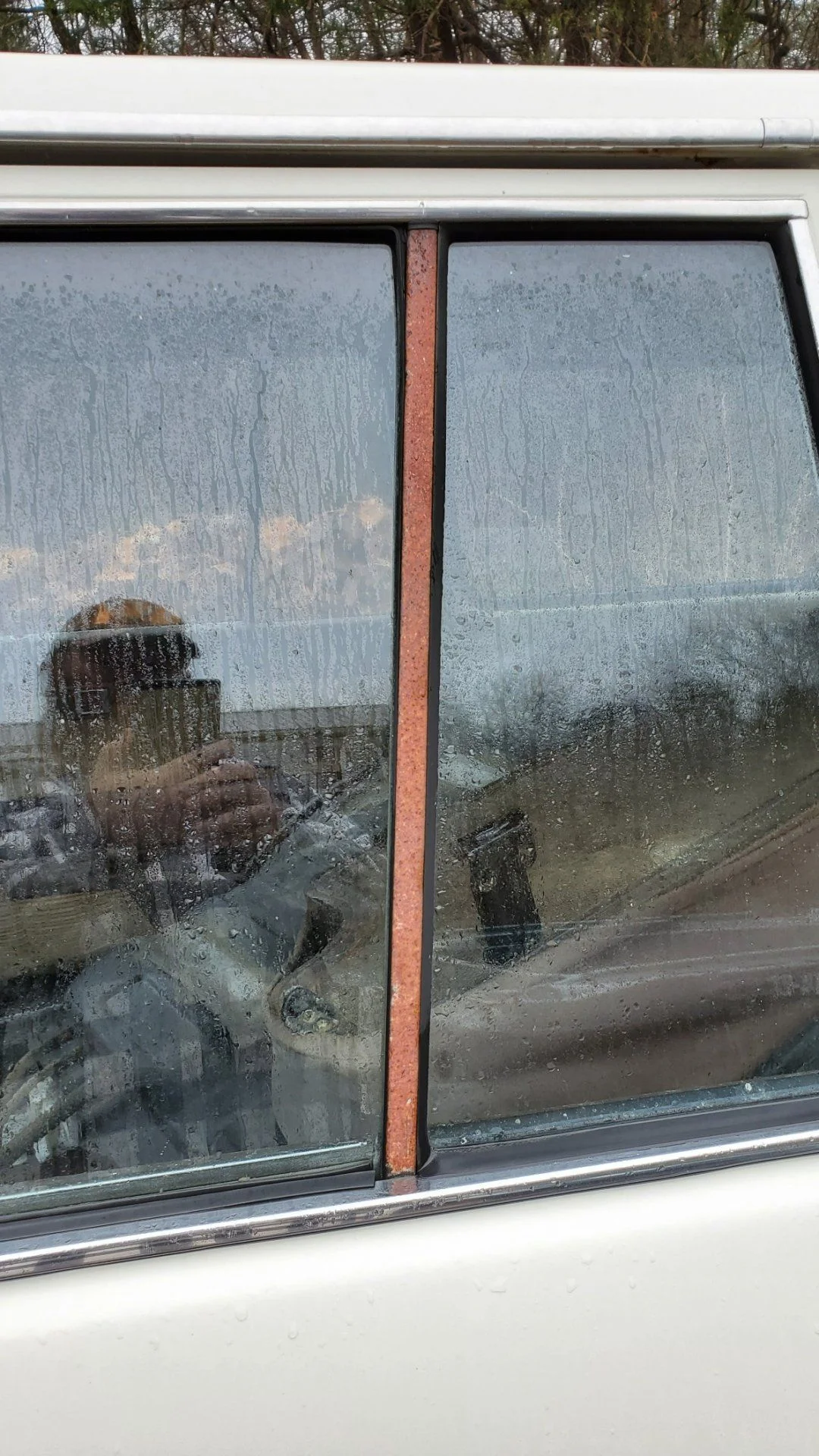

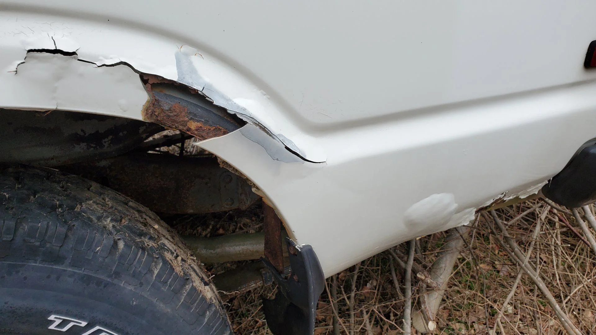

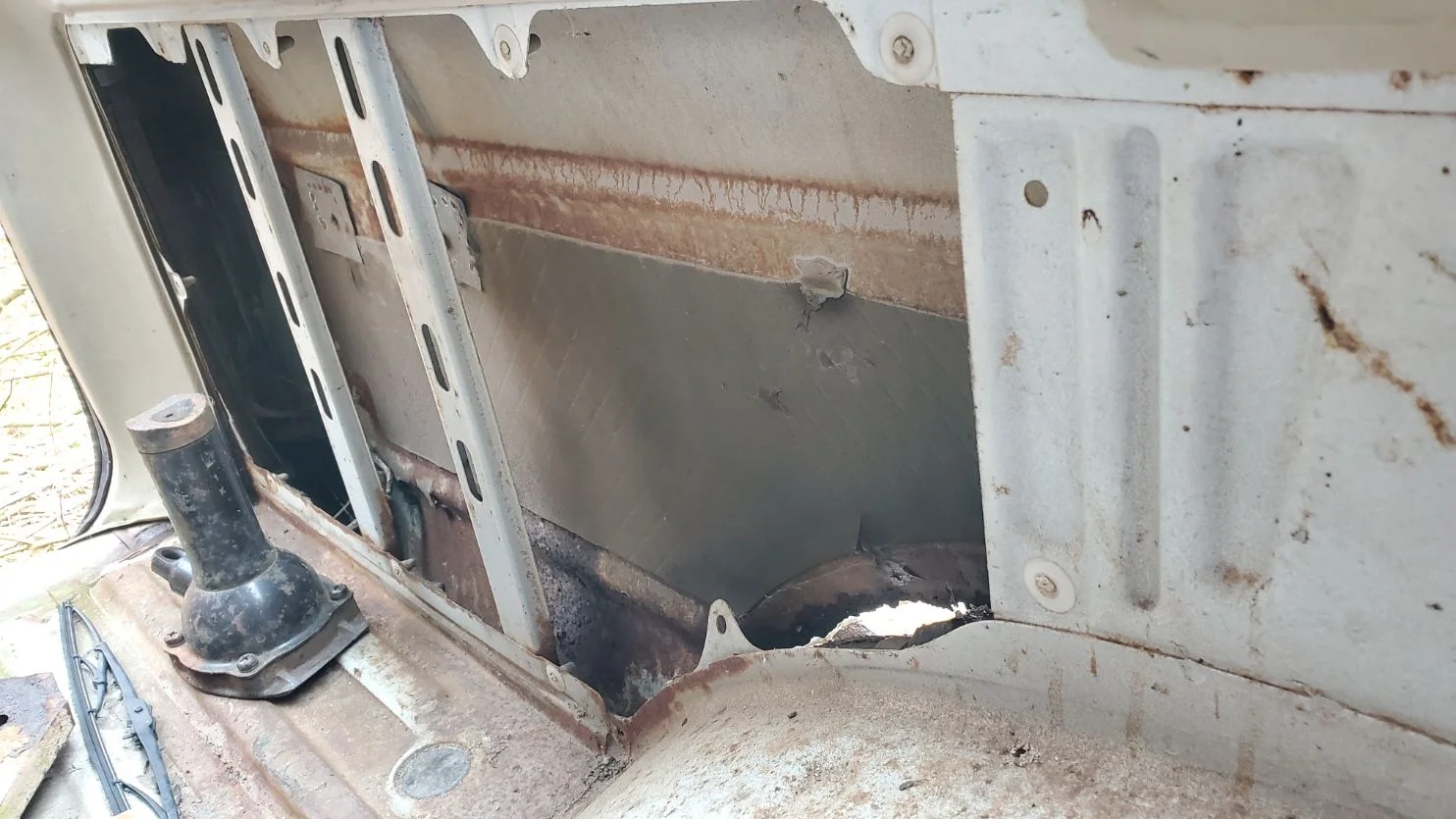

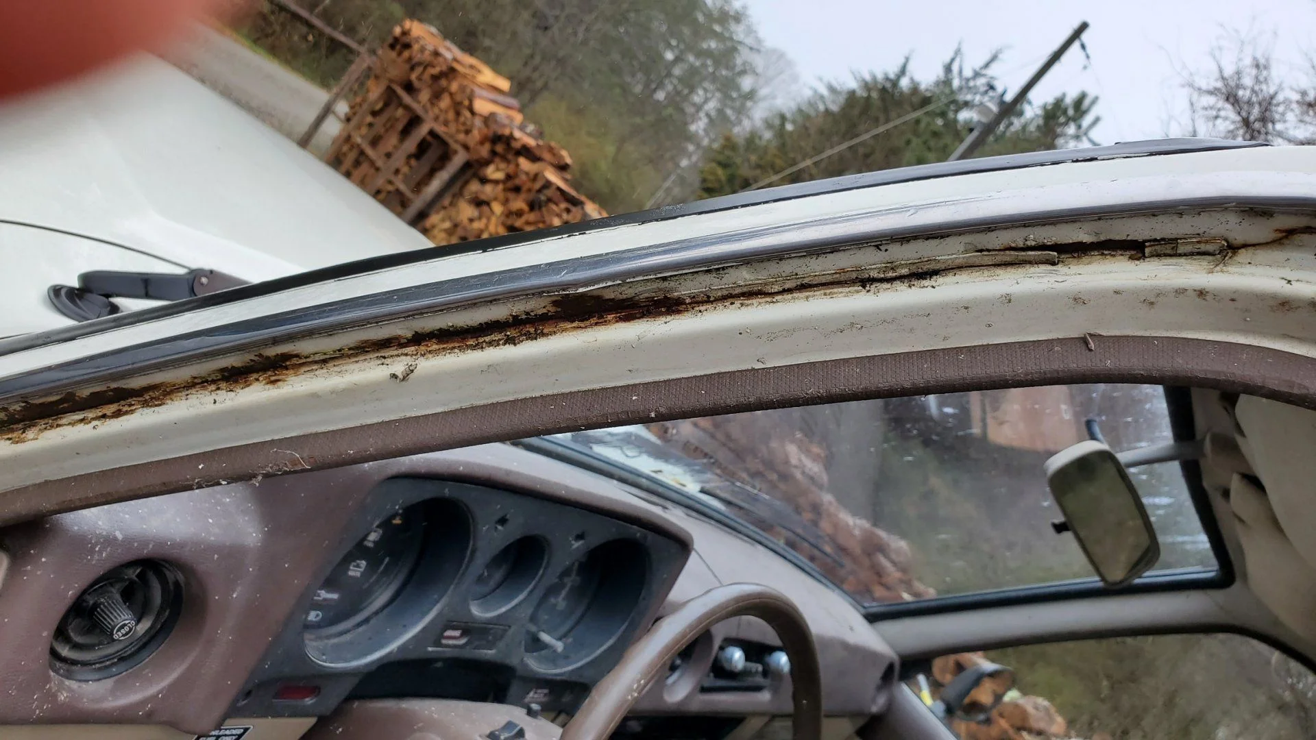

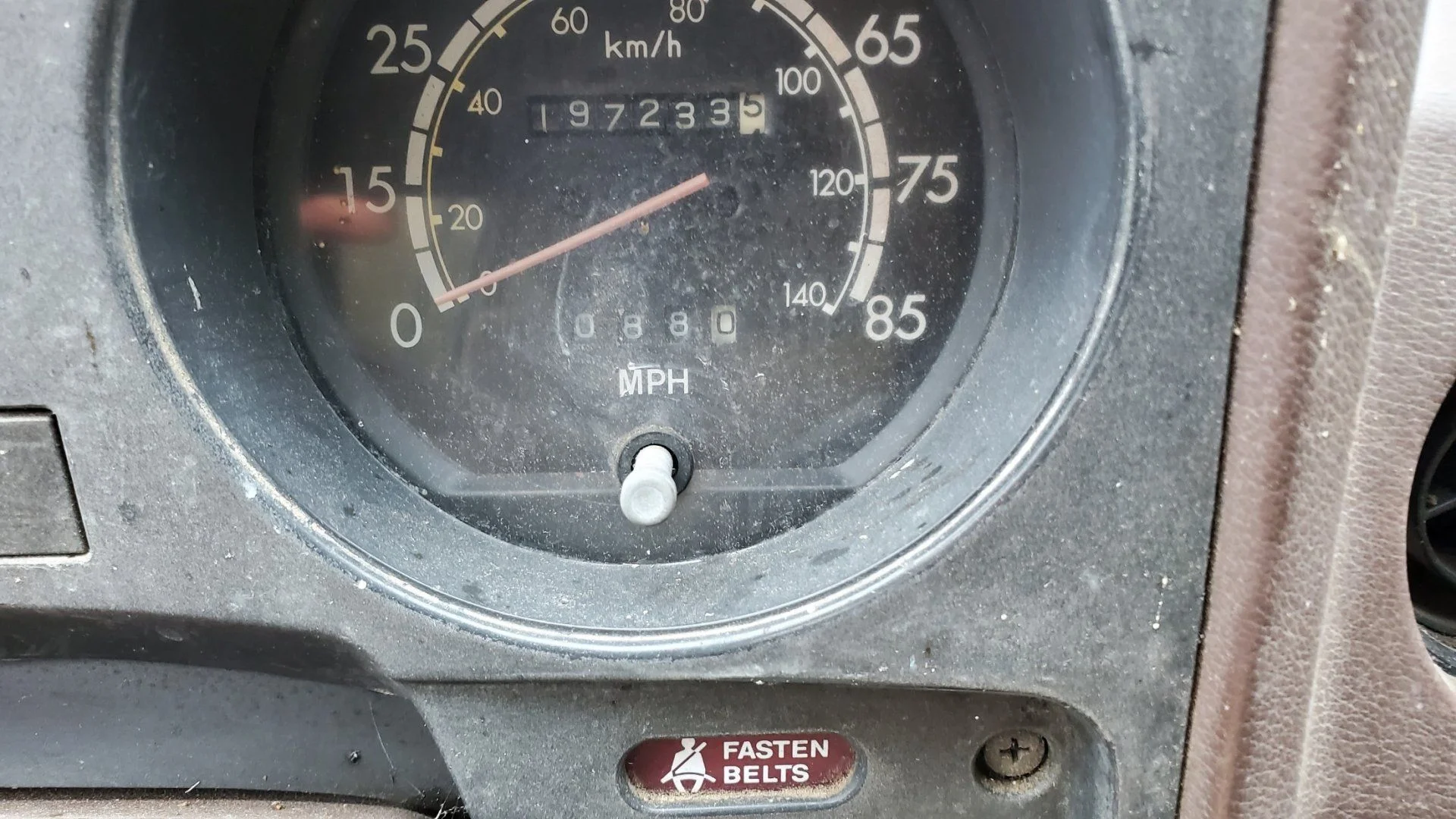

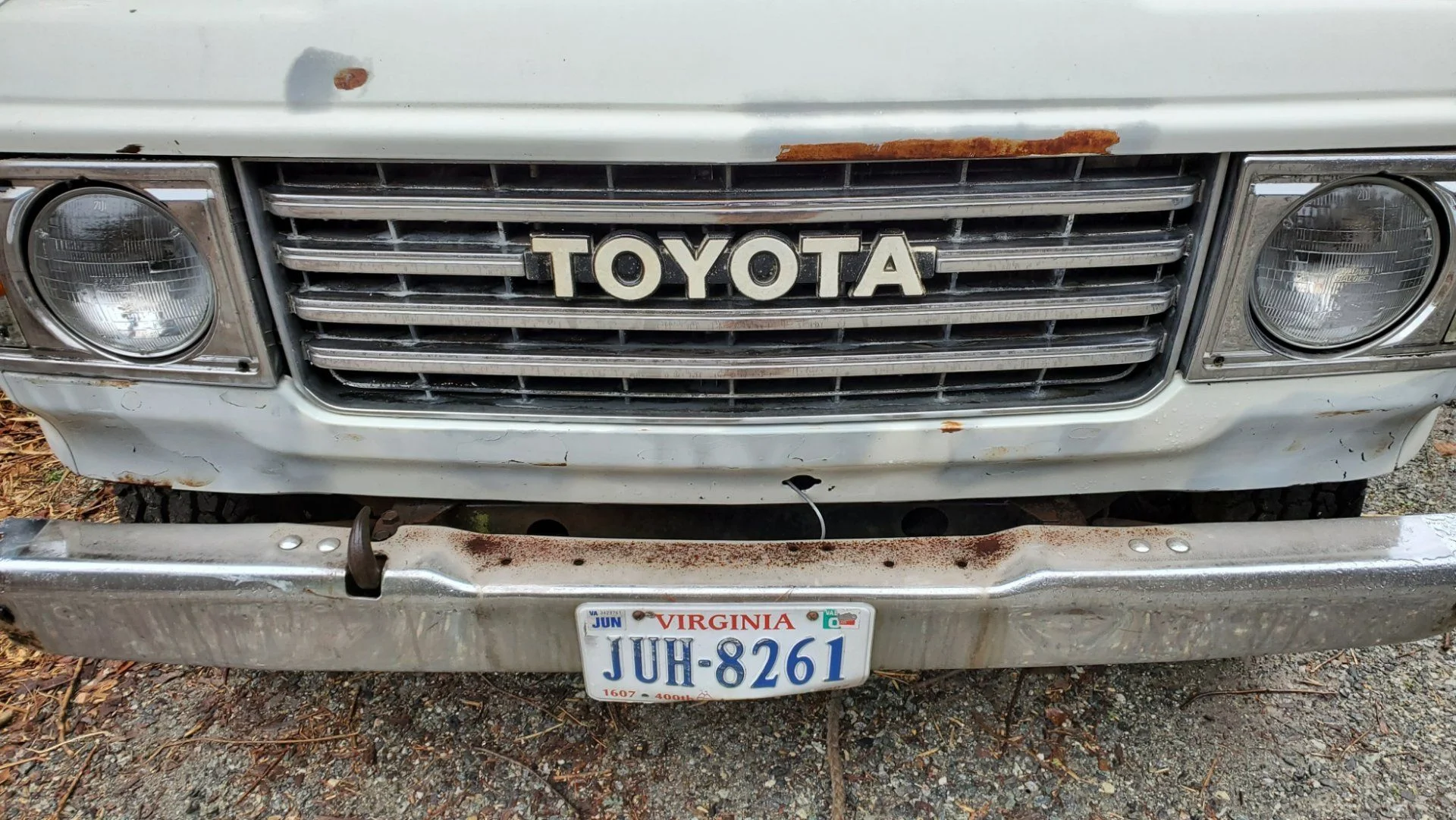

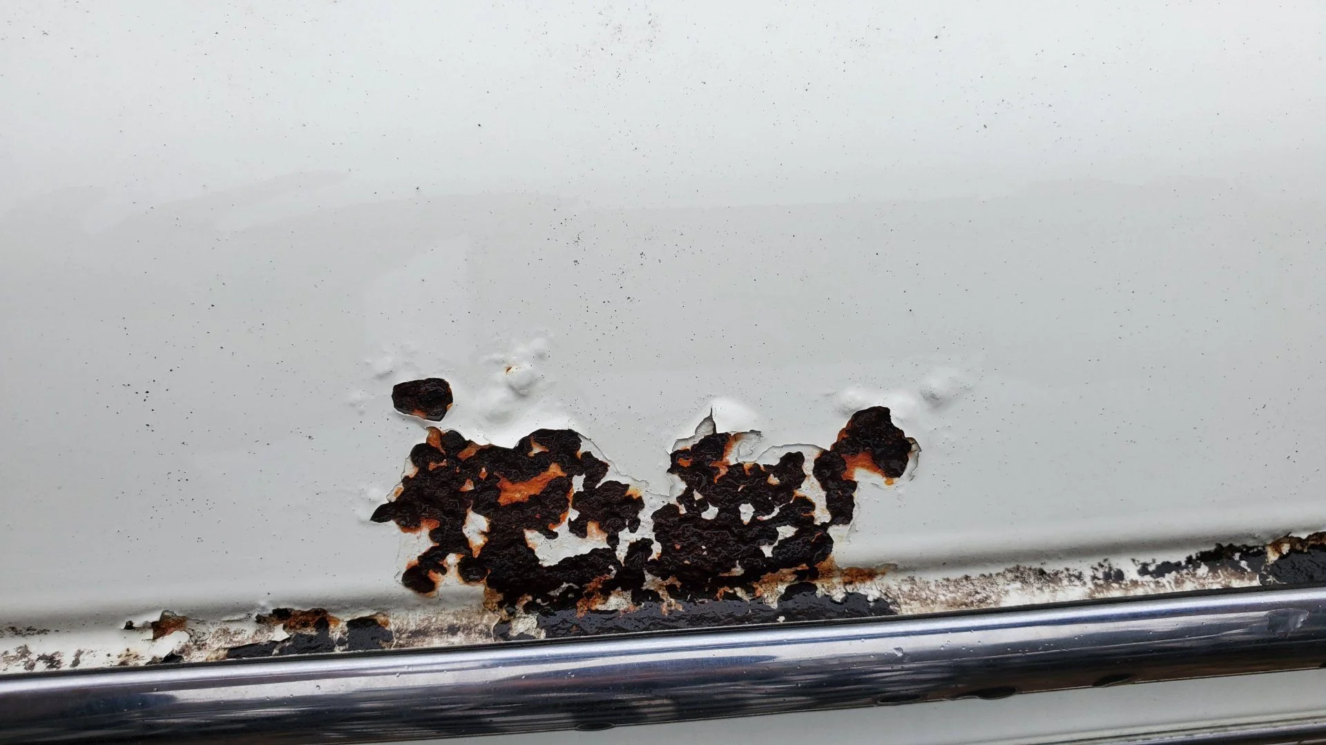

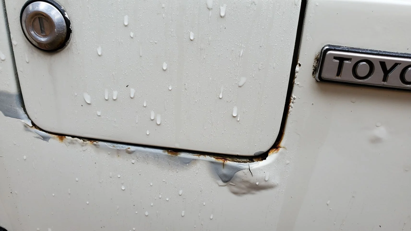

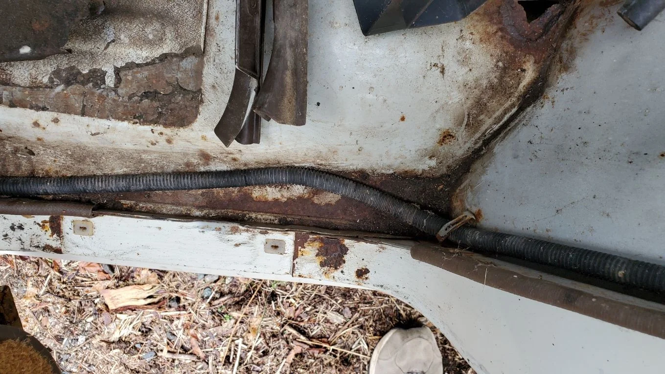

So I was bored between meetings and went outside and took some more pictures of Tetanus's beauty marks.
Ouch man. You're either going to set this thing on fire from frustration or you're going to be an automotive god by the time you're done with it.
Would it be uncouth to ask how much the seller was asking?
You'll definitely be a metal repair guru when you're done. As for the engine, zero compression on 3 and 4 prolly means valves are stuck open. I'd think that unless the head gasket is totally blown out, you'd at least see a few PSI on cylinders with HG damage vs a big fat zero. Keep us posted on what you find out.

Thank you for the advice any quick tips for getting them unstuck? In a lot of ways making it somewhat mobile are pretty high up my list with stopping the ongoing rust. I plan to do my own compression testing and investigation.

Holy Welding, Batman!
'Tis but a flesh wound!
My FJ62 is languishing a little bit due to the 80 needing a head gasket. At least there are replacement quarters and dog legs out there. It looks like it could have been a lot worse on yours. Yes, lots of work and cursing but at least you're not in it for $10,000 with a bunch of covered up issues.

Yes and while not super cheap for the price I paid I've kinda built in a bunch of replacement parts. I can't get under it at the moment but when I bought it the frame looked ok not great but I've seen worse on here. I'll post pics of it when I don't need to lay on the wet ground to get them. I'm interested in what the guys who have been through it think and besides wire wheel and other methods of cleaning and then POR15 to attempt to keep the rust at bay. What other things should I do to make sure it lasts. I'm debating a sand blaster honestly. Anyone think with the level of my rust that would be a good investment to get the rust off?
