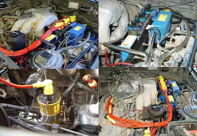

maybe that's the distributorless system that the Venezuelan 1FZ's run
Correct, the "powerpack" (three coils) system.
Hmm.. powerpack three coil system (distributor system) like these one below?
(Nope the pic's not mine, - from JDM website)

That's an interesting setup with the 3 coilpacks and the distributor... Guessing the distributor cap/rotor live a long and happy life being that it handles the low voltage switching to fire off the coils?
The pics I have seen of the OEM distributorless coilpack ignition had the packs mounted up front where the distributor goes. If it could be a bolt-in replacement without too much effort for the early US distributor 1FZ-FE's I would be game... But would prefer to use direct coil mounted spark plug boots if I was going that far, 6 direct fire coils mounted to their individual plug with just a signal/power wire and a ECU or board to drive them... $$$$.
