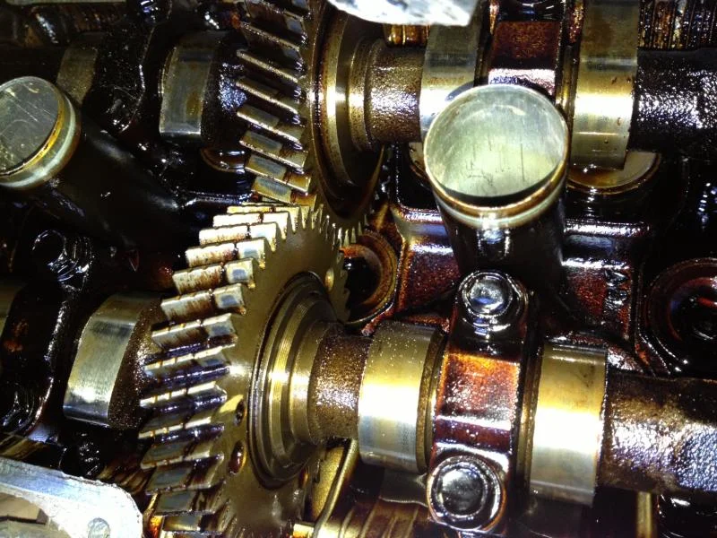

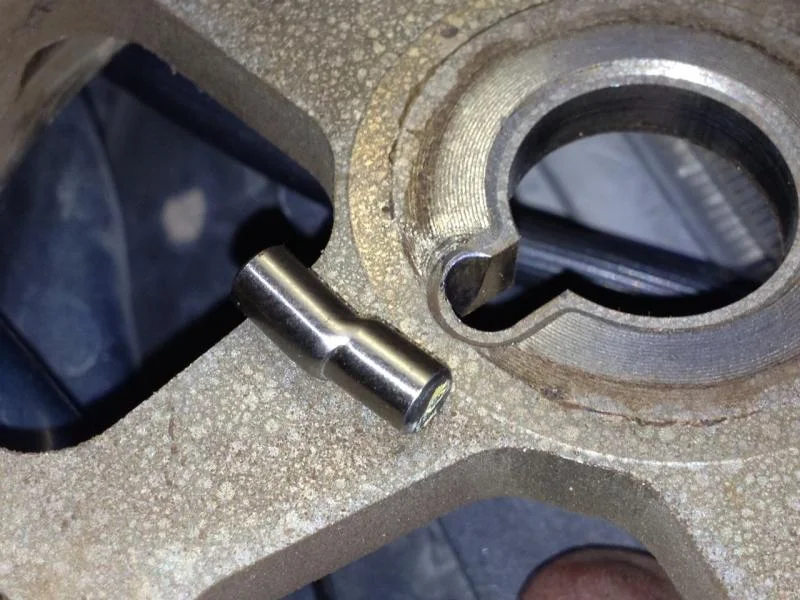

First picture is the heads today, the second is how they looked a year ago, and the third is the shear pin on the cam pulley.
It doesn't sound like an oil pump issue, if that's what you're still thinking.
The first thing I'd want to figure out is why the camshaft stopped turning, causing the belt to jump time.
My guess is you lost a valve keeper and dropped the valve, contacting the piston, and bending the valve. That doesn't fit with total loss of compression in 2 cylinders, though.
BTW, which cylinders were low? And which camshaft has the bent pin?
The first pic looks nasty. Whatever it is it looks to me like you haven't had very good oil circulation in that head for a while. Blocked oil passage in the head perhaps? Maybe the cam seized in the head. If so that head is probably junk. Knock on wood my tacoma is running perfect at 260k and I was amazed how clean the inside of the head looked when I did valve covers last fall.

It's got to be a oil circulation issue as Ken said so I'm not ruling out oil pump at this point.
I believe both heads (cams valves etc.) were stuck on the morning it would not start but then started to move after several attempts to start. The heads might as well be coated in a browning sugar and molasses. So far on the right head everything looks ok - no scratches on the bearing surfaces still slightly moist with oil. But I'll know more once I get the other head off and take them to the shop.
The low cylinders are 3,5,6 but I have a feeling that the timing being off 180 is the biggest factor. It wasn't until i got these readings that i checked the timing. The pin is bent on both sides, the right side is the one in the picture and is the worst of the 2.
The oil passage on the right head is open and free so I'm guessing its either just after the pump ,before the pump or the pump itself.

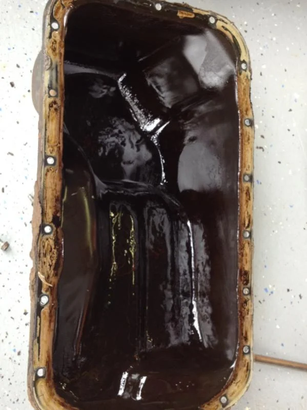

Well looks like sludge...so the question now is how did I get this sludge? 10k ago it was fine and religiously change my oil every 3k-3.5k (believe me the engine starts to preforms worse at about 3k). My head gaskets look good with no obvious leak. The only clue I've seen that was weird is there a light tan slime I found on the inside oil cap. Any ideas?
The only only other place coolant could get into the oil would be the oil cooler on the side of the engine. Need to come up with a way to test it for leaks...
Moisture is a major contributor to sludge. It takes 10-15 minutes of driving at normal temperature for morning condensation to be evaporated out of the oil and removed by a properly operating PCV system.
Water is also a byproduct of combustion, so worn rings would allow more moisture into the crankcase.
Just throwing some facts out there to consider. I'm also assuming you're using higher end detergent oil and somewhere in the 10W-30 range.

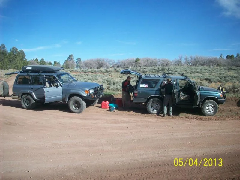

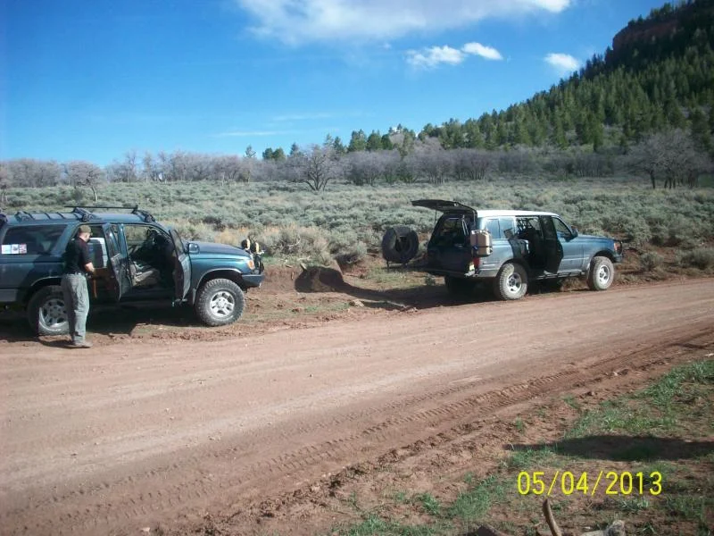

The pics below are after towing Steve back to the dirt road and emptying out his 4Runner, just in case some &^%$#@ decide to break into it. Thankfully, this didn't happen. Unfortuantely, some jackass stole the NATO gas cans from the swing out racks out from the 80s in the motel parking lot in Moab :mad:

I don't think you've found the root cause of the problem yet. Mobil 1 just doesn't suddenly turn into sludge by itself. There's a slow coolant leak somewhere that's made for the perfect storm.
