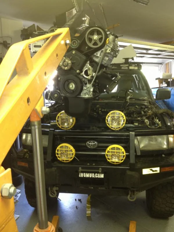

What happened to my 5VZ-FE?

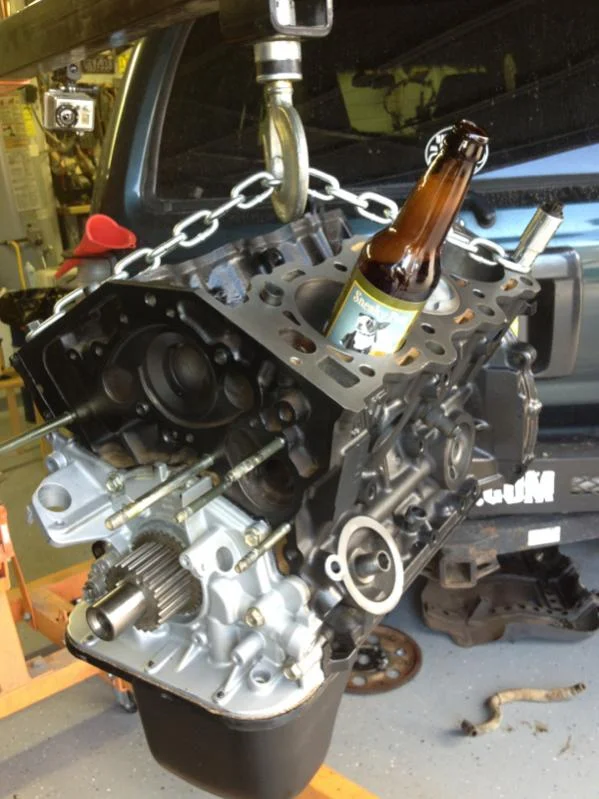

Should, both surfaces have been machined :D
Engine porn!
And a long weekend to put it back together!
I see the GoPro hanging there. Are you going to make one of your awesome videos of the install?
That sure looks pretty!
Did the oil cooler check out good? If so, does this all come down to pitting on the block surface possibly allowing coolant into the oil? That just seems very unusual to me.
Glad you're on the way back to rolling with a newly rebuilt and reliable engine Steve! Like Tom...the sludge and gum still seemed unusual...a real mystery
Not sure yet...hoping to get it back tomorrow, it's the last thing I need to fully drop the motor back in. I did some testing with a bike pump and it seemed ok. I figured I'd have it cleaned and pro tested so I can sleep at night;p
