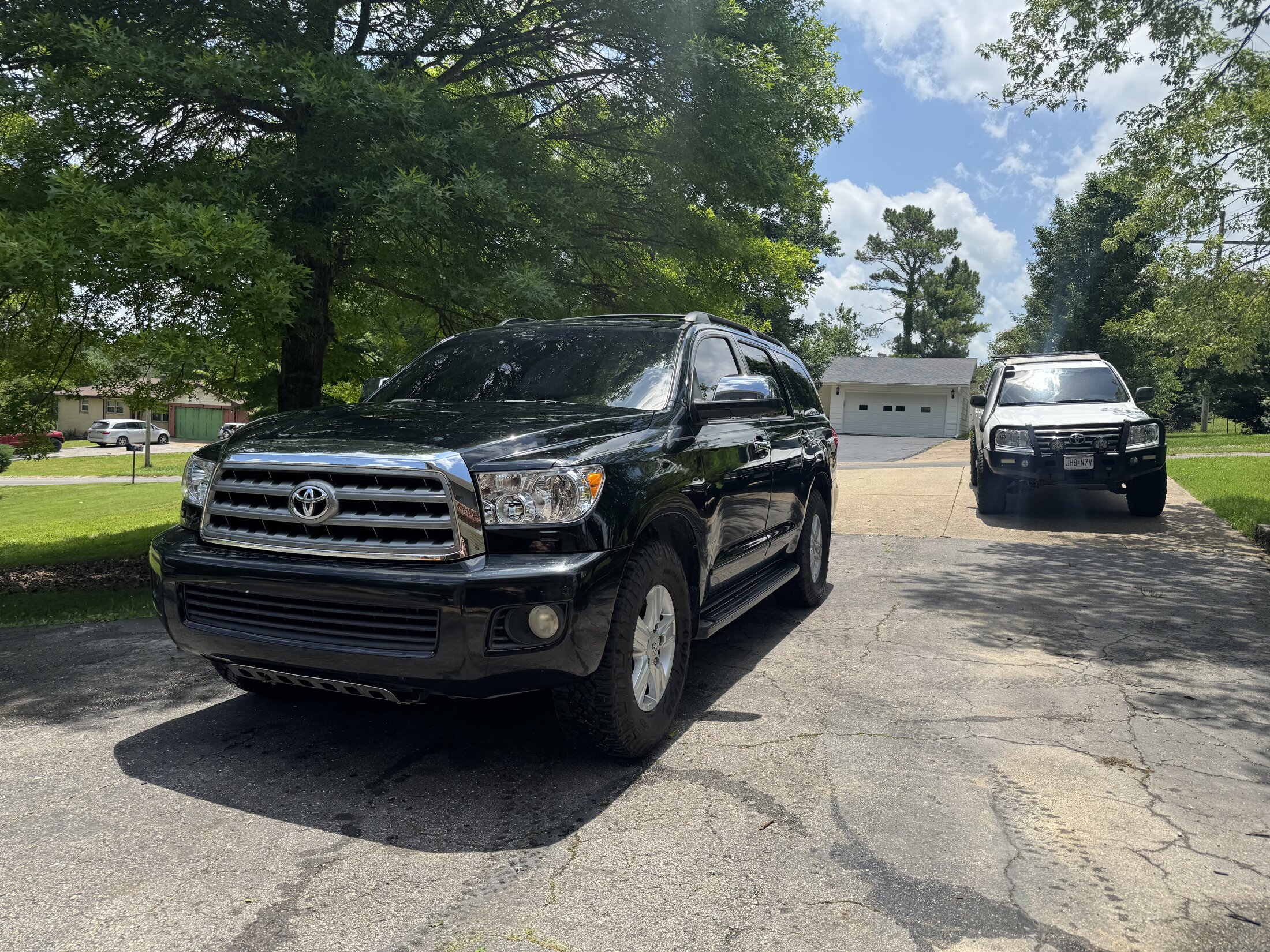

Today I got around and started putting the new radiator in wifeys Sequioa. Installed the new headlights I’ve had for a while and detailed it out.
