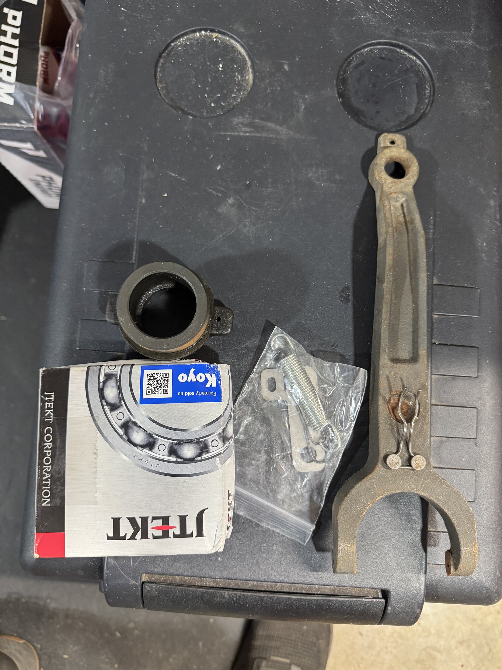

Something I Ran into this week.. my slave cylinder rod is about 1” too long. I’m wondering if I used the wrong pivot fork or the wrong throw out bearing..
@cruisermatt any input?
Thanks @cruisermatt and crew
Well I see your problem clear as day.
That’s the 3-speed fork and bearing hub.
Sorry![]()
I was afraid of that.
Guess I’m on the search for the 4 speed one.
Any chance you have one you want to part with?
No need to search. That’s the easy part. I’ve got plenty of them here

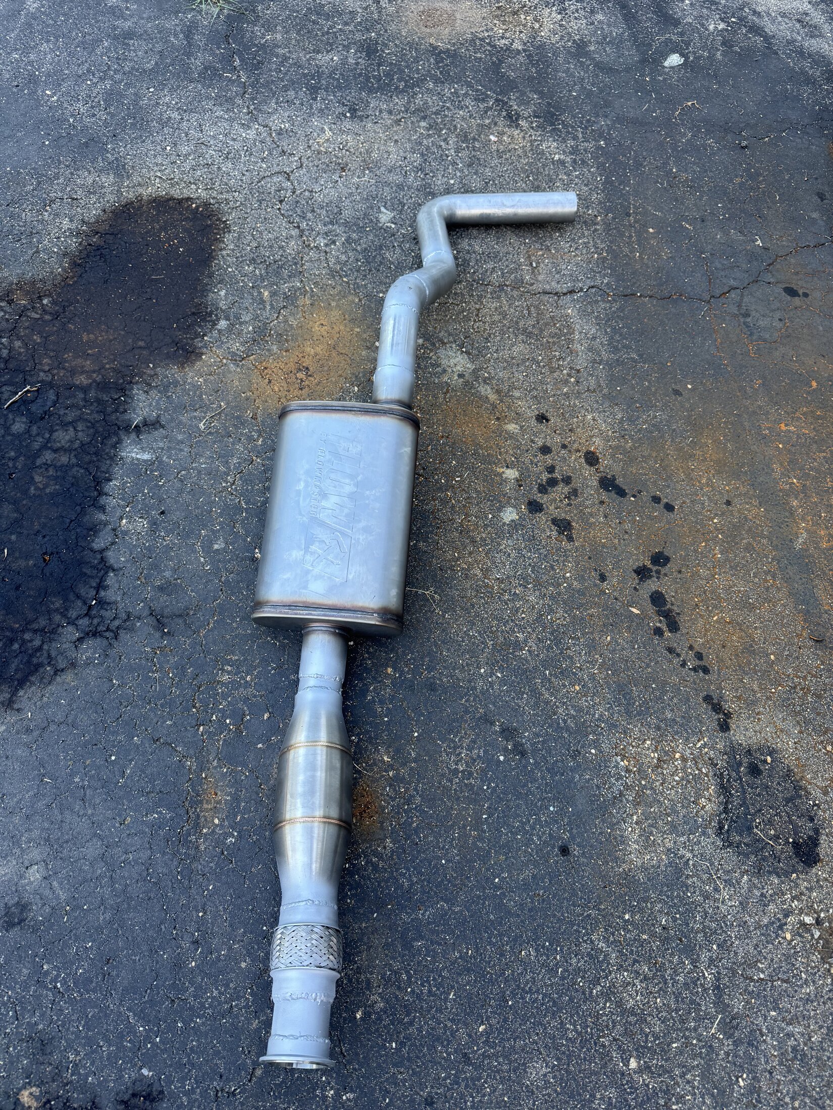

Those “small” days really make a lot of progress to bring the end result.Small day again yesterday.
-Exhaust welded out
-Oil pressure sensor adapter installed

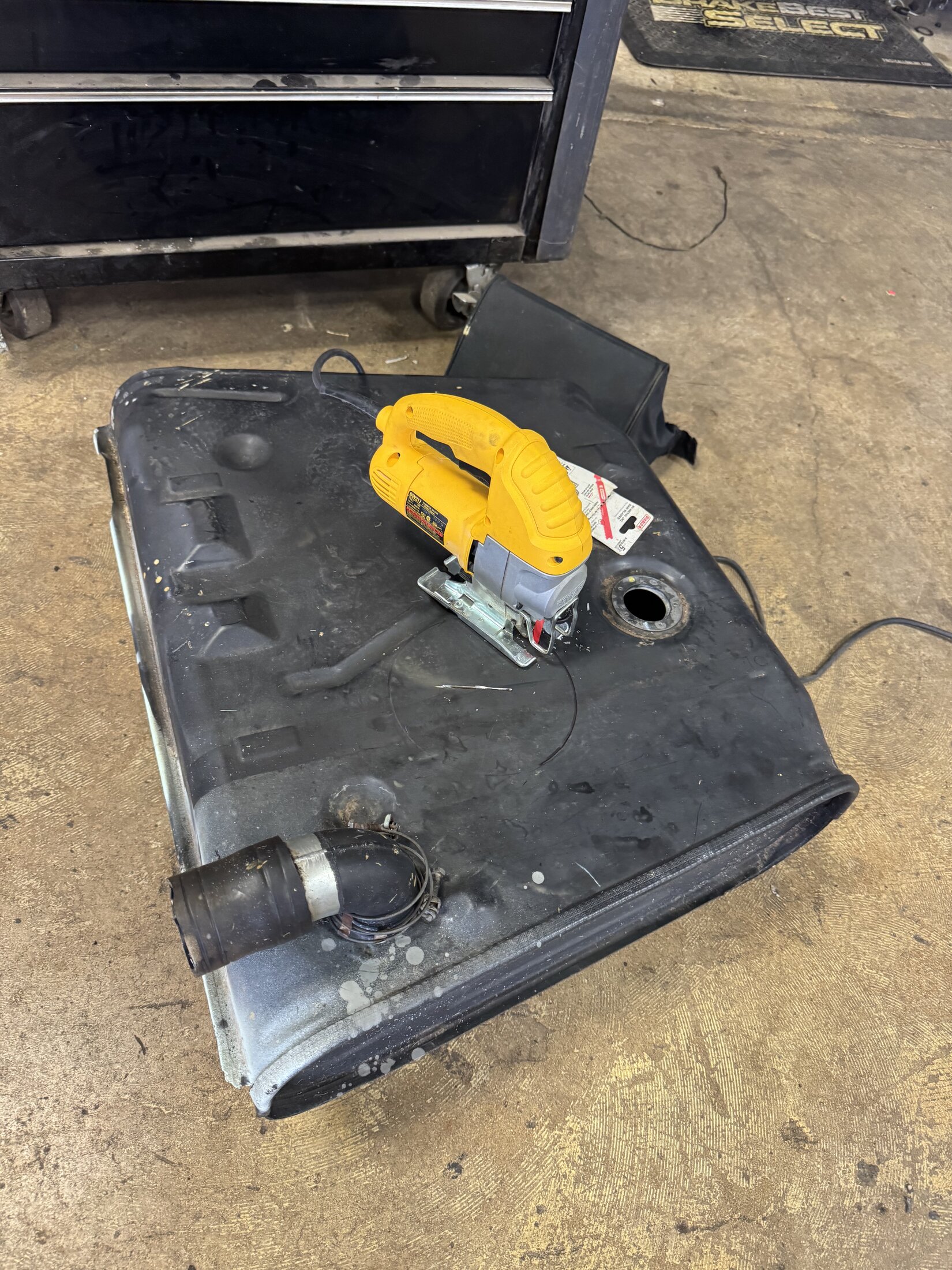

-Fuel tank prepped for ring- first cut made and didn’t go boom
- Clutch Parts arrived from Florida from Matt
Flex pipe or flex joint. I’ve started using them the last few years and they are really nice.@clrussell is there a technical name for the steel woven fitting between the flange and the cat?
That’s the important part of itTank cut, welded out, and some paint.
