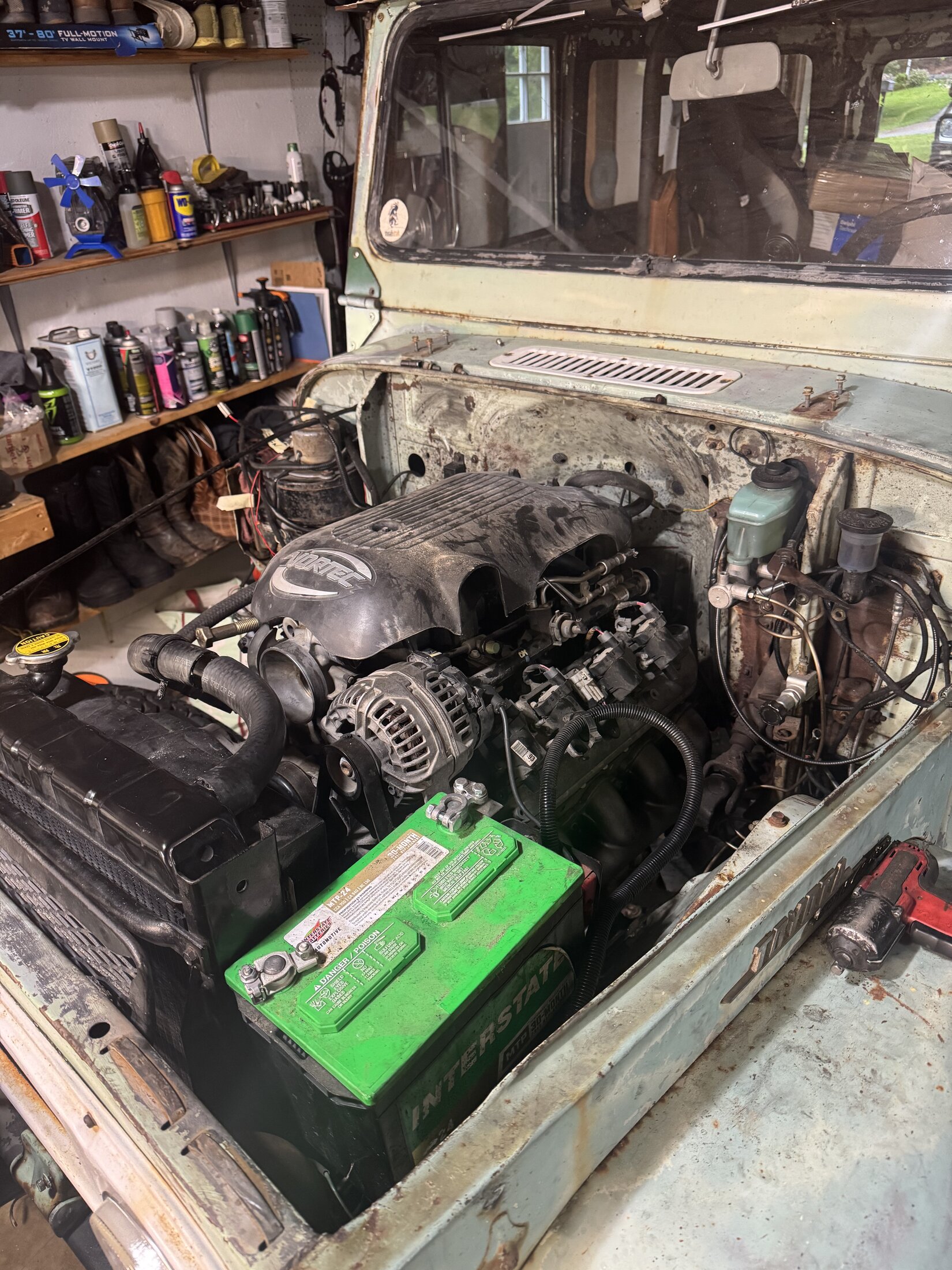

What do I have? 40 newb
I don’t know, I like the look. It’s like OEM+ with the 52s
They “look” the part and they give your LC options w/out sacrificing the OE appearance. Regardless, I’ve enjoyed watching the evolution. 🏆
That looks great.

Hauled off the donor today. Picked up my new seats. Working on more little things.
Radiator moved 1.5” and lowered as much as the shroud would allow, fan shroud chopped up to make room for new outer ring.
Upper hose is stock suburban that’s cut up.
Working on battery tray next. Going to a side post OEM battery for the LS
