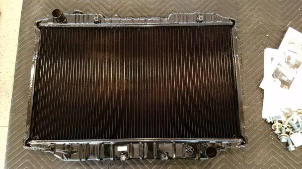

You can also get your original one repaired! Mine was leaking and I had a radiator shop put in a new core it’s been working perfect for years now! Just another option to the aluminum units, which are great themselves.
