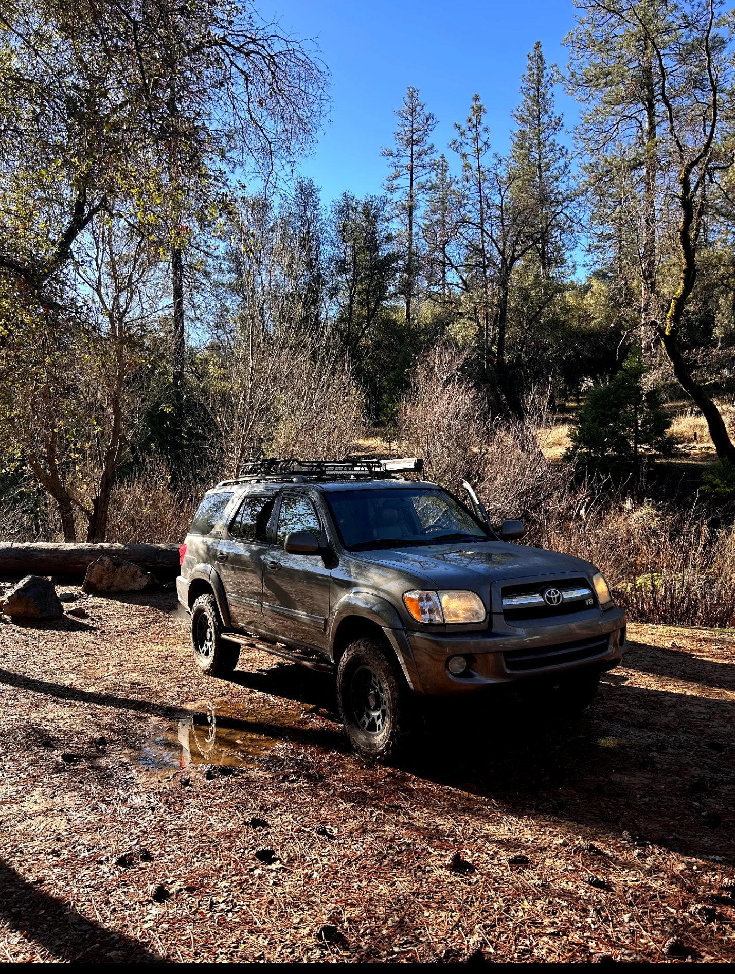

Replaced the front door speakers in the 2005 Sequoia. No more blown rattle!

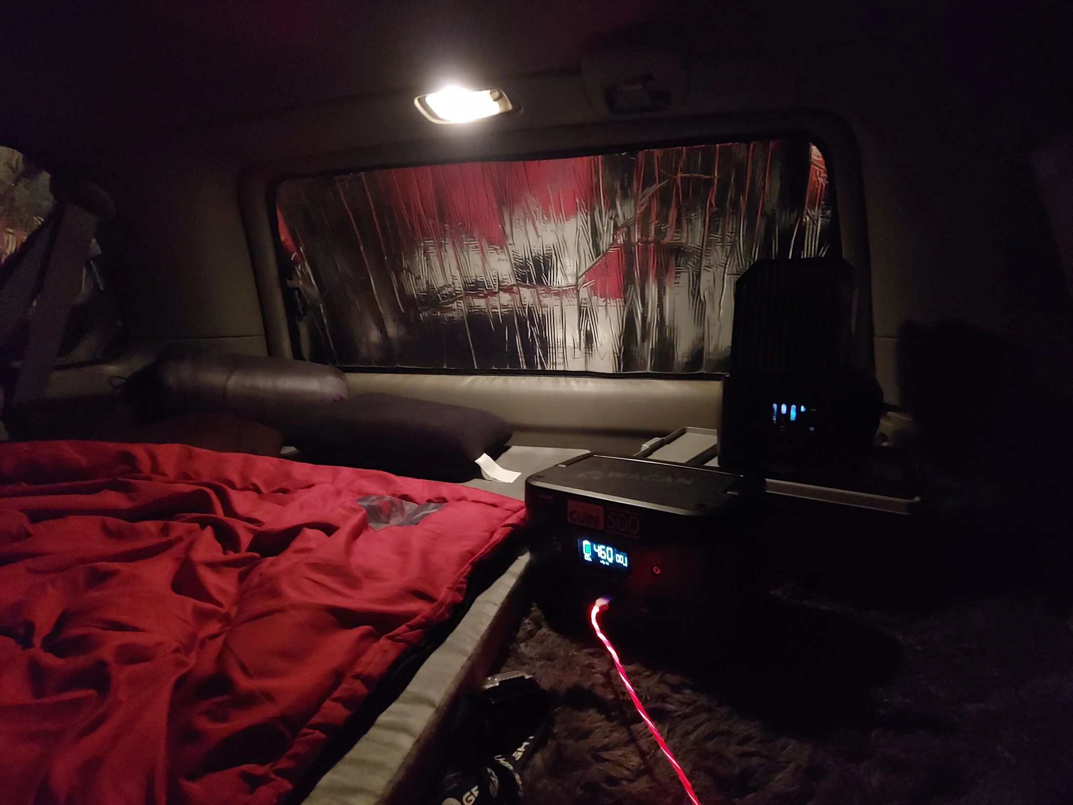

Was hoping for snow to really test the new heater from Insta-fire while camping in the low 40s (high 30s). Works like a charm. With ventilation it was in the low 70s with the new set up. Super happy.

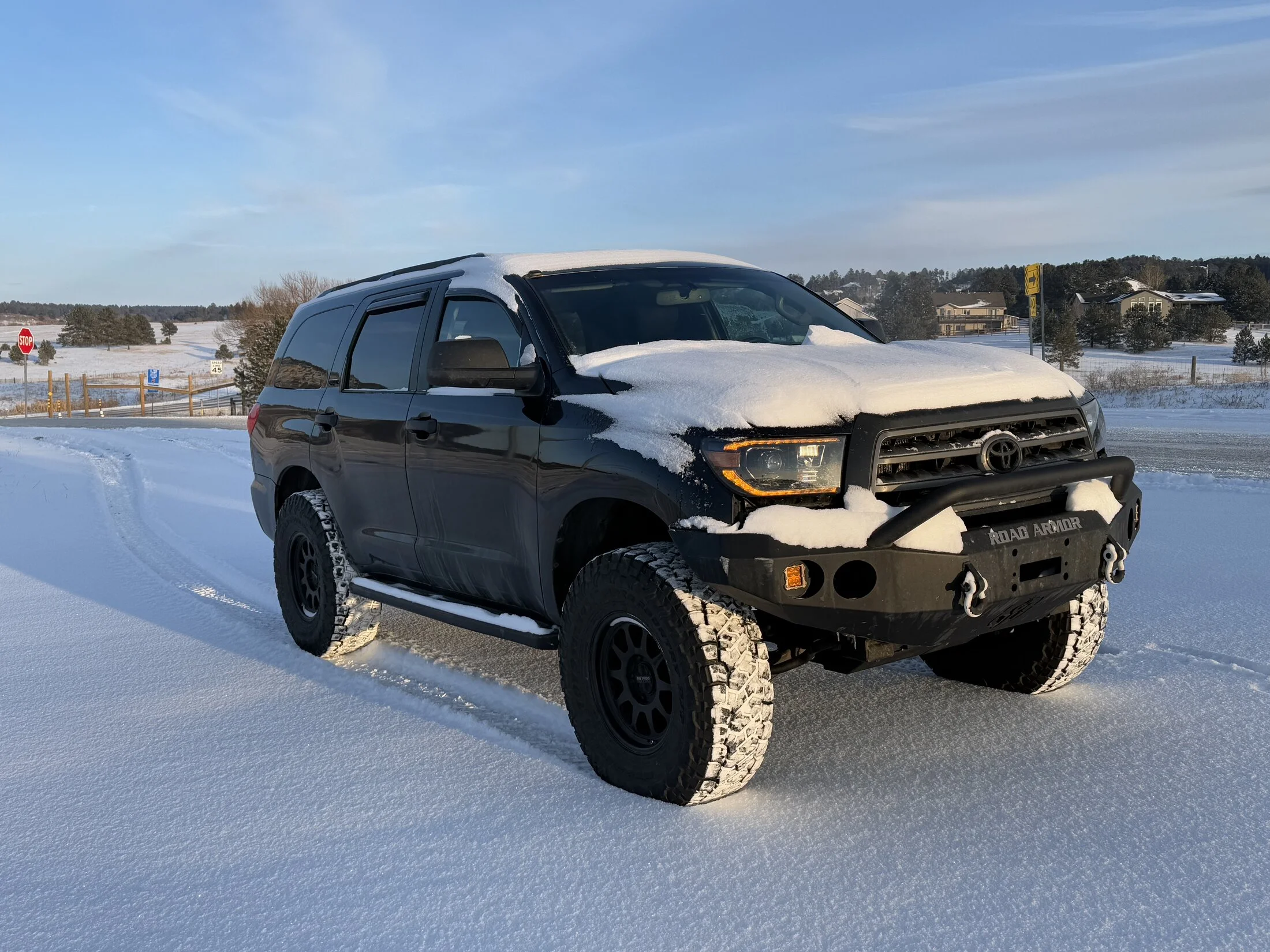

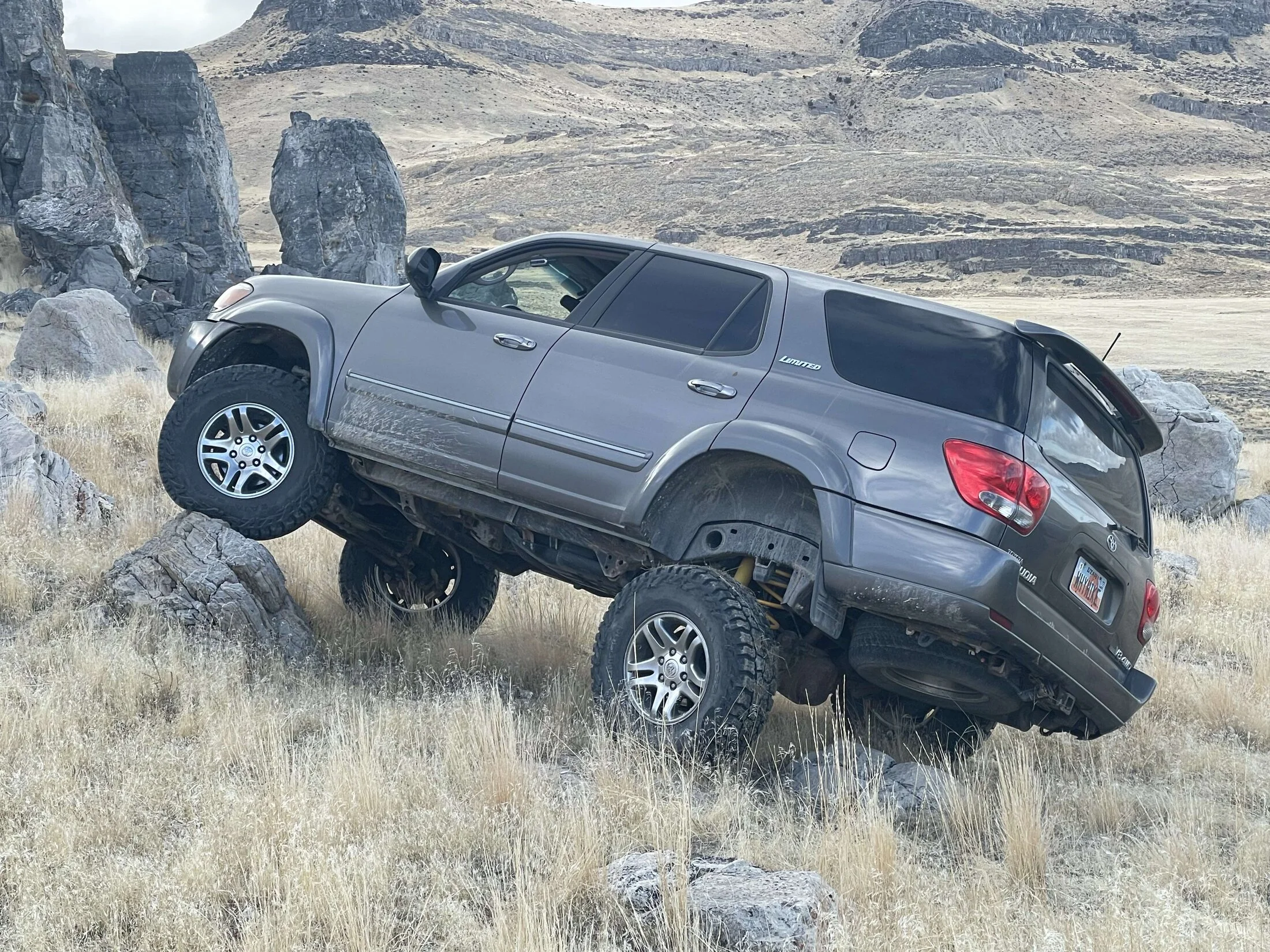

Elka 2.5” remote reservoir coilovers up front replacing a blown 2.0 Toytec setup. These things are butter, NVH is way down although how much to attribute to a blown coilover I don’t know…but the claims of damping in the cabin are very real.
Also swapped the Road Armor bumper from the smaller Sequoia to this one, 37x12.5/18 Toyota RT Trail fit perfectly, very minor rubbing on the sway bar at full crank only.
People have expressed concerns with the beefier/heavier front bumpers and coil compression. Hardly did anything to the 700 lb/in coils, the weight of a winch would be about right. Pics at this angle don’t show that front and rear lift are identical at about 4”, which is how the Toytec was setup also with 700 lb/in coils.
