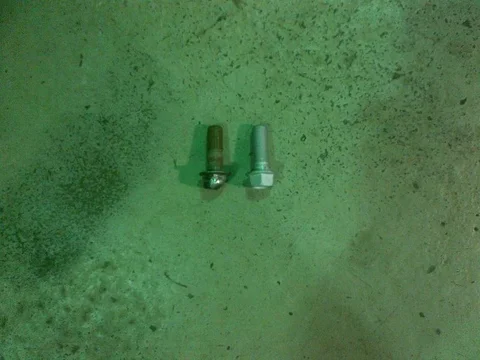

Installed a new caliper bolt after discovering that about 1/3 of the bolt head had been sheared off (not crushed, just gone - wrench still fit over it just fine). Not sure how I managed to do this without f@*king up something else (front wheel).
