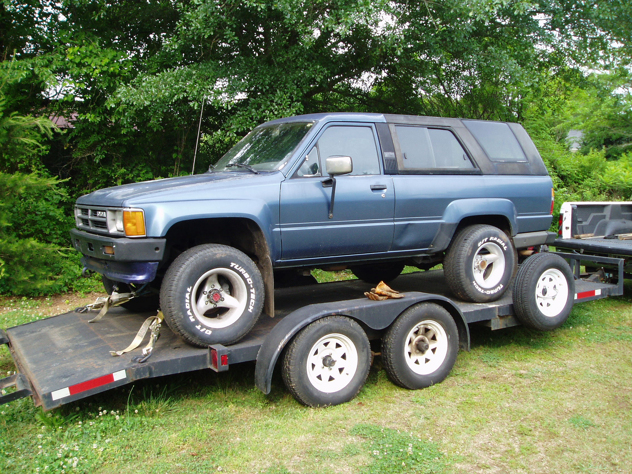

Got the 88 4RNR up and running :) New timing chain, Timing chain cover, oil pump and water pump. Thing is running great. Heather wants to keep it but I think I am going to sell it to help fund a power transplant for the 60.
