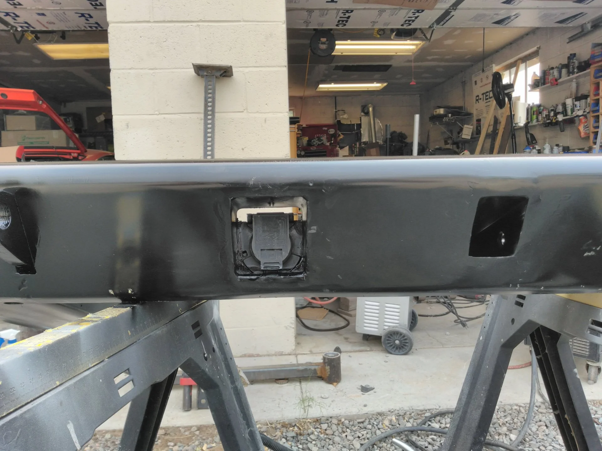

Trailer plug in 4x4 labs bumper...

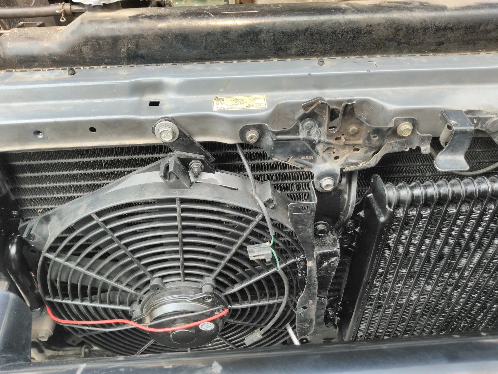

14" aux pusher fan to help the a/c at idle,. Modding the center bracket was a pain... But it fit... 12" would have been alot easier..
