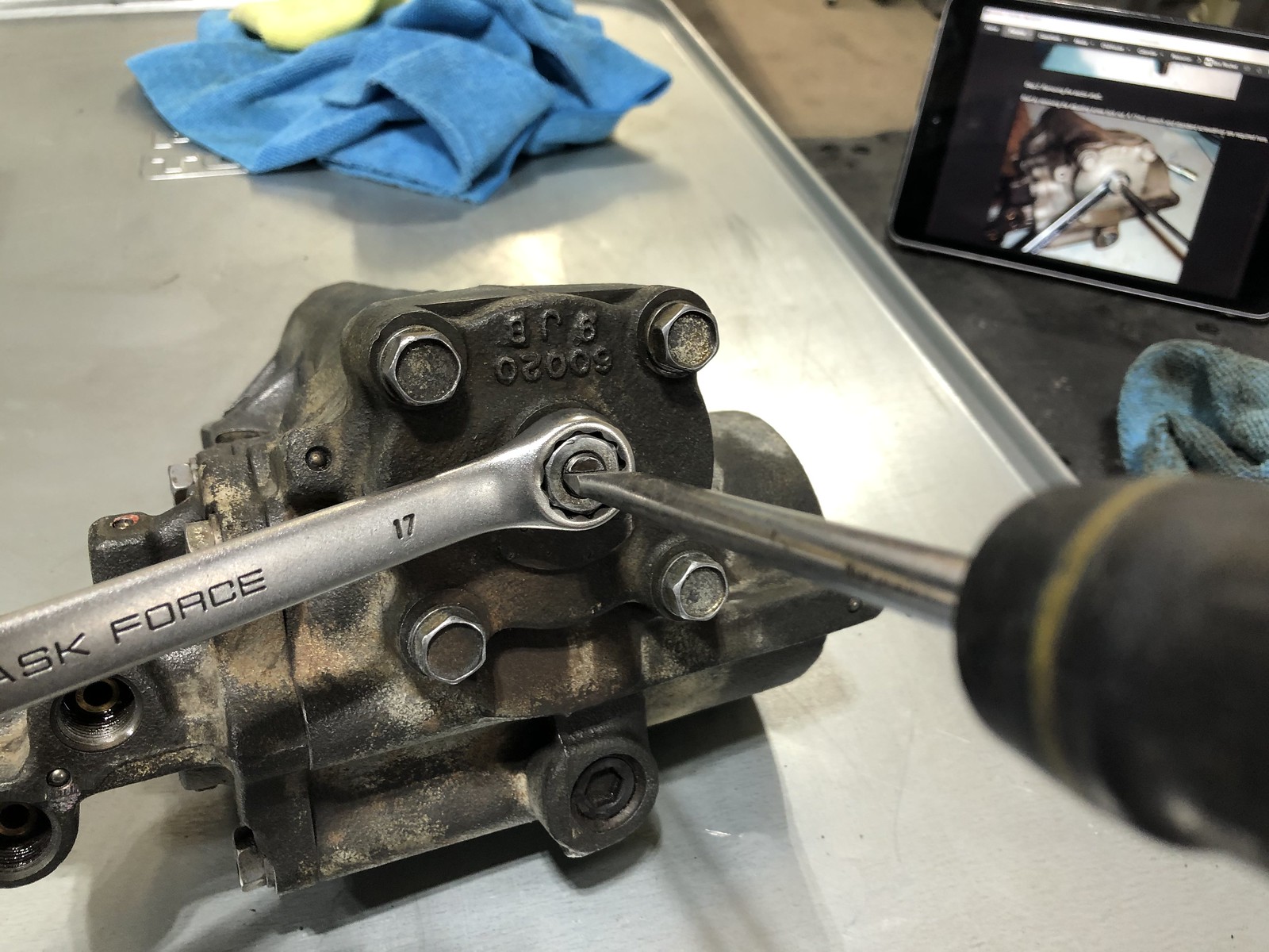

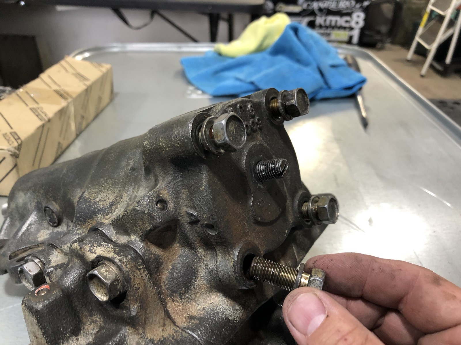

Step 2: Remove the sector shaft. To do this you need a flathead screwdriver and a 17mm wrench. Remove the adjustment screw lock nut using the screwdriver to make sure the adjustment screw doesn't spin.
Steering box FZJ80 by Adam Tolman, on Flickr

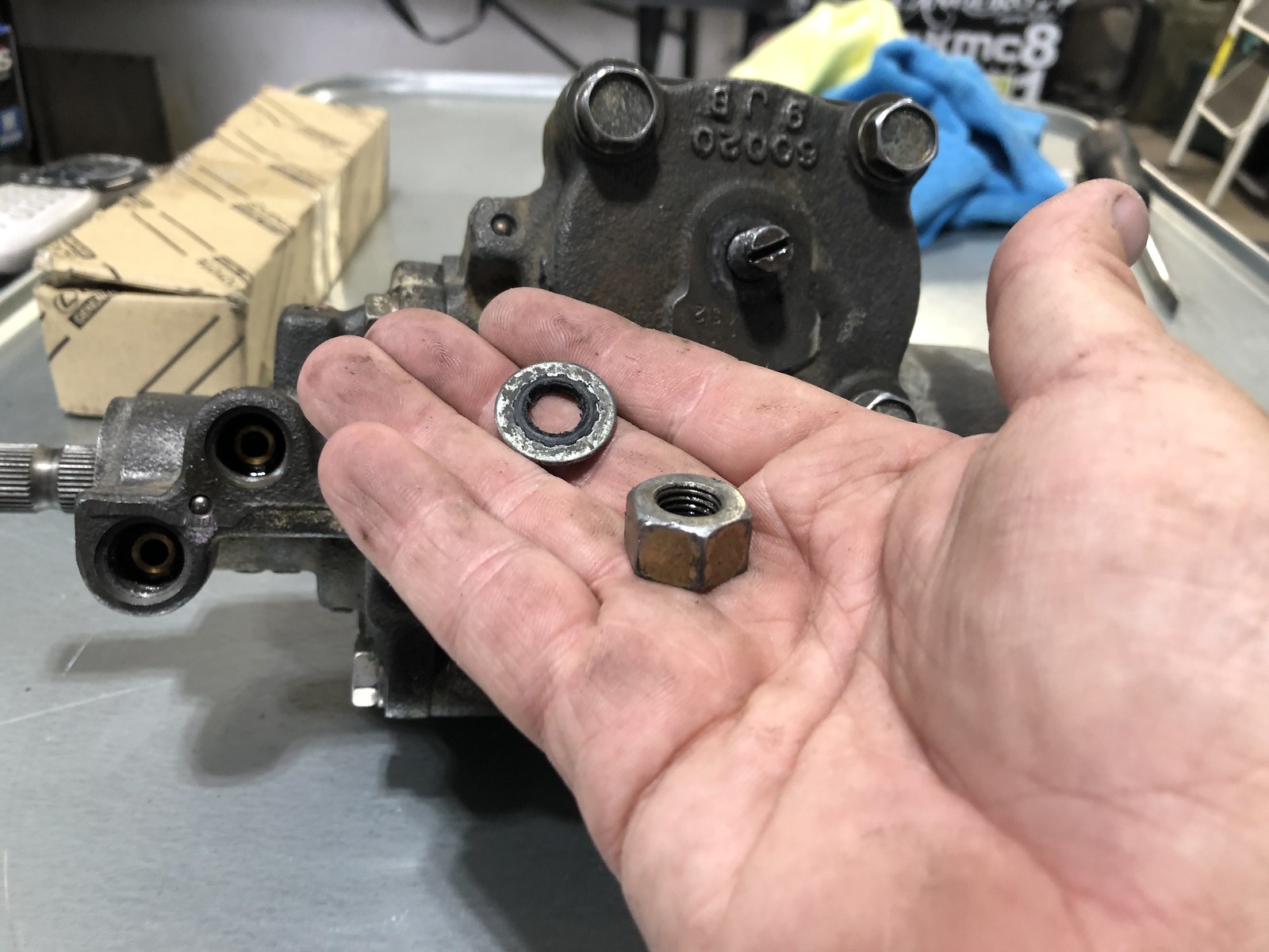

There's a seal washer under the nut. Your new seal kit hopefully includes a new seal washer. If it doesn't, you'll need to reuse this one if it's in decent shape so don't lose it. You'll reuse the nut.

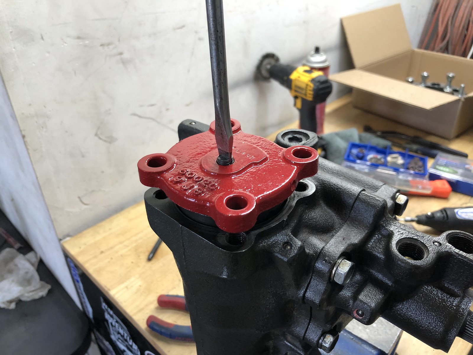

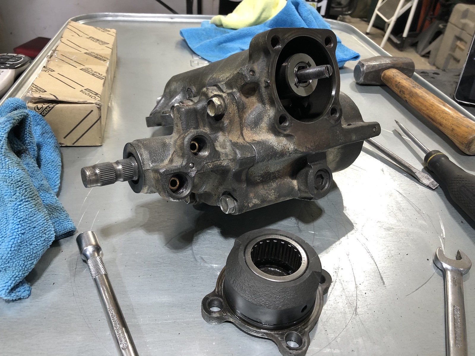

Next you need to remove the side cover. There are four 14mm bolts that hold the side cover on. Remove the 4 bolts.
Once the bolts are removed, tighten the adjustment screw with the screwdriver and it will push the side cover out.

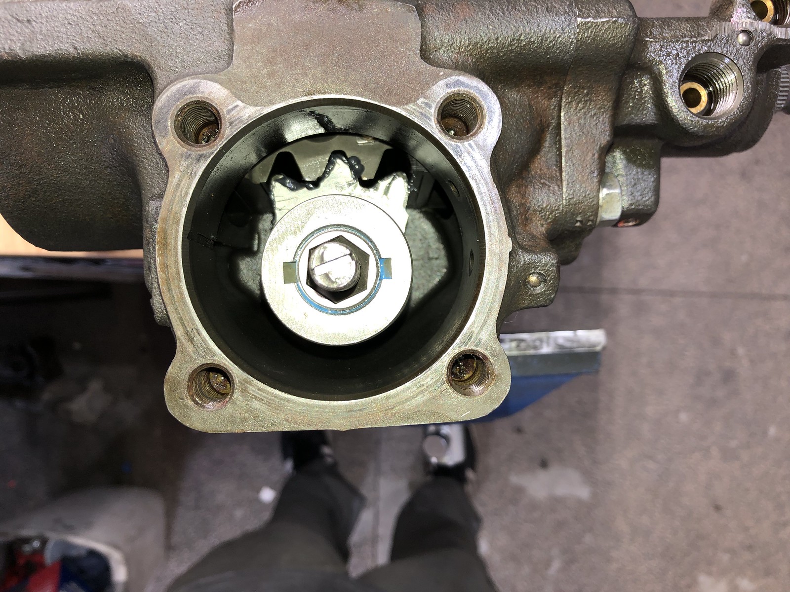

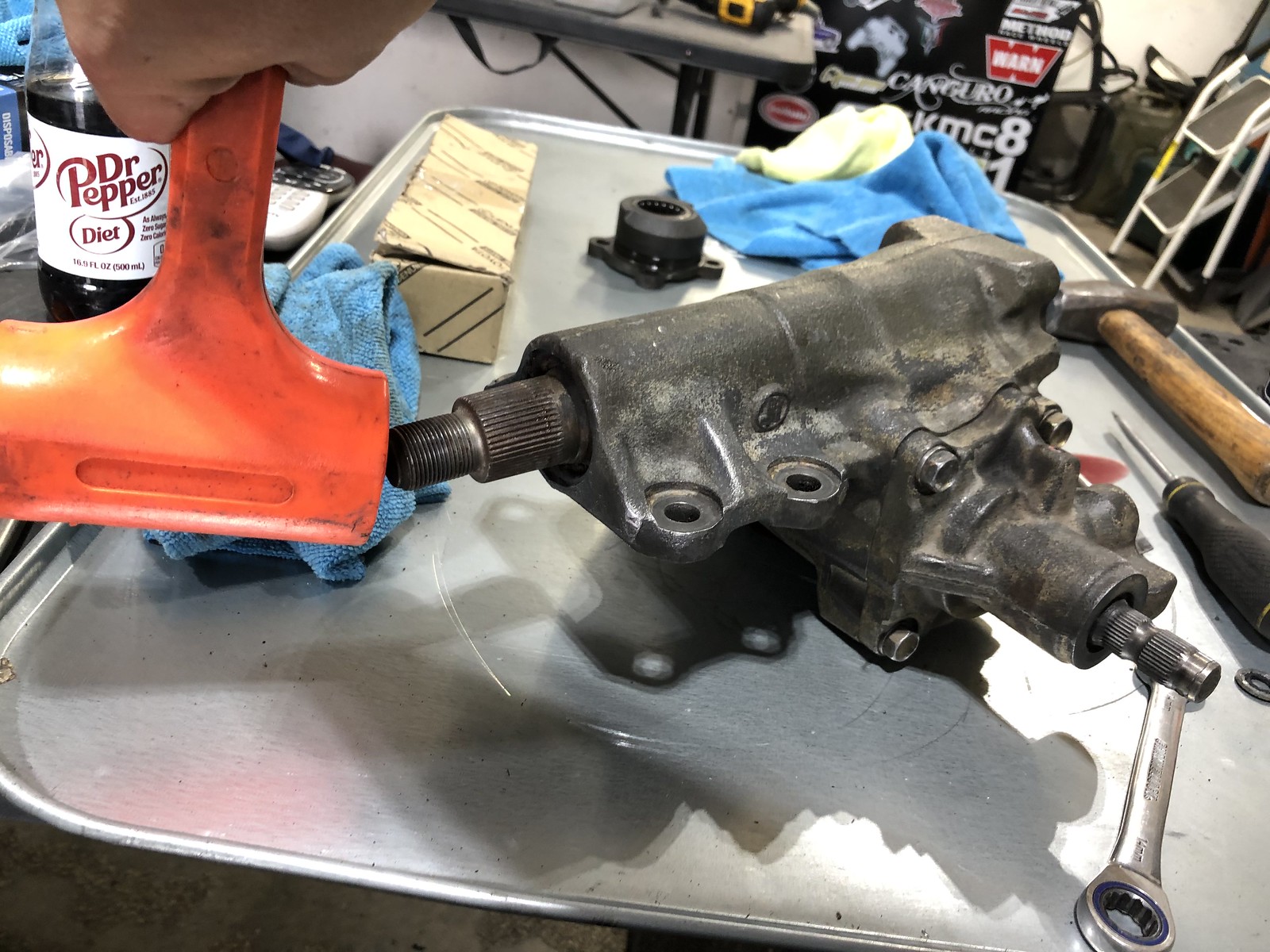

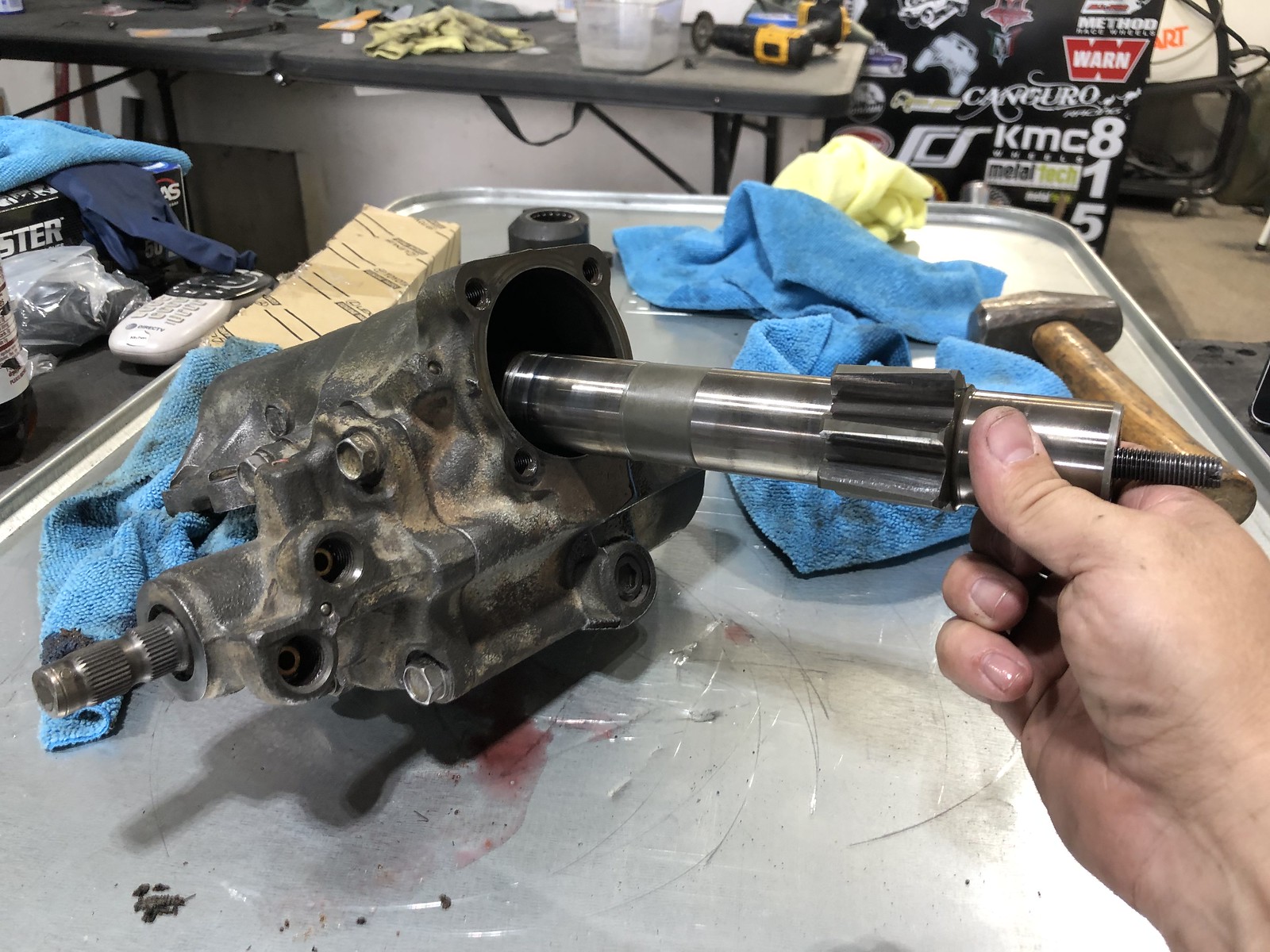

With the side cover removed you can tap the sector shaft out of the box with a dead blow. It should come out with a few light taps.

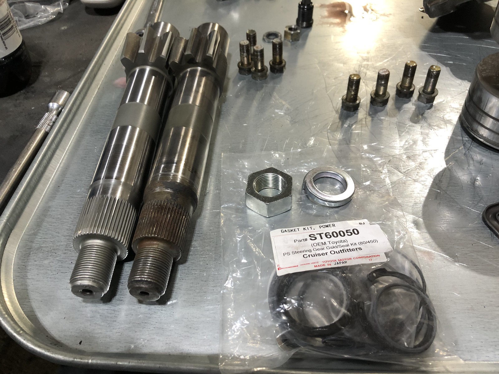

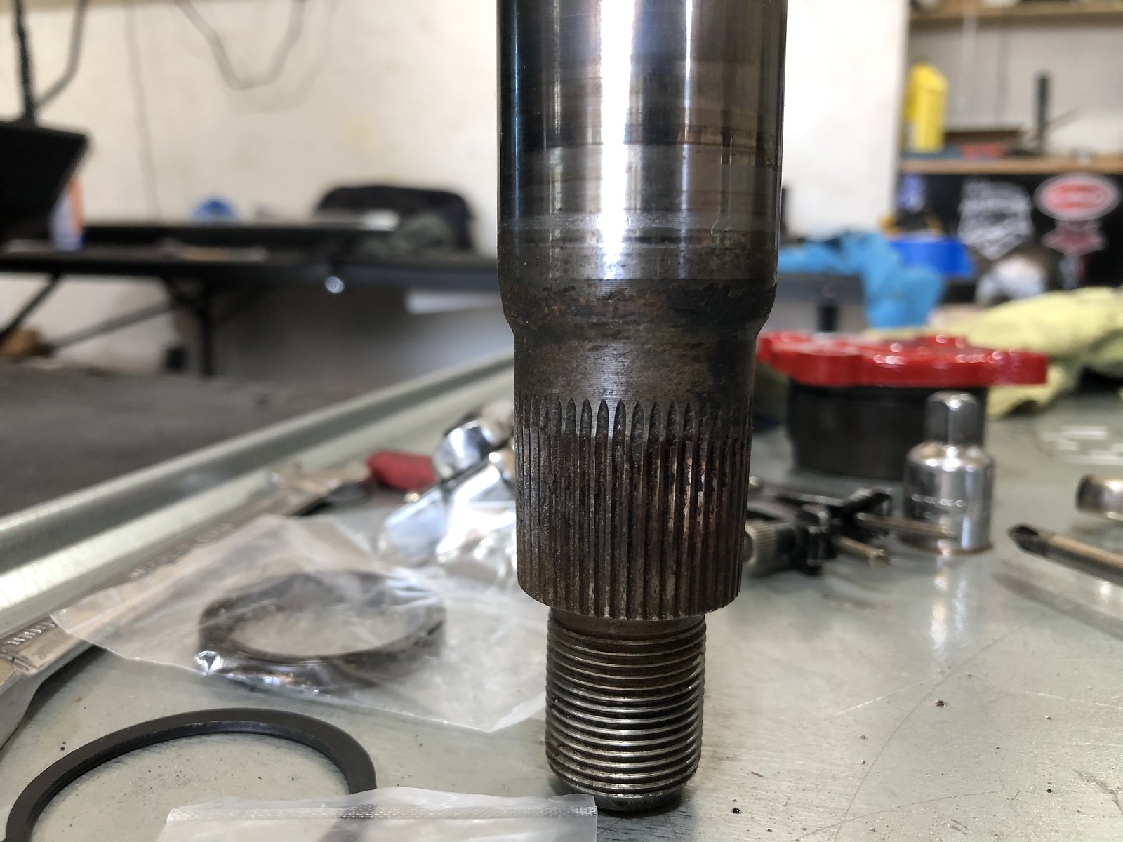

Here's the stock 80 sector shaft next to the 105 shaft. There's a noticeable difference in size as well as spline count. Note: the splines on the 80 shaft look to have a slight twist starting. If the splines on your sector shaft have any amount of twist to them, the shaft should be replaced. Twisted splines are a warning that the shaft is close to failure. Unfortunately the only way to really check the splines for twisting is to remove the pitman arm. Sometimes you can see some twist in the splines without removing the pitman arm by holding a straight edge up to the box and check the splines against the straight edge. Also note in this photo: the steering box seal kit with part number.
The twist in the splines is more visible in this photo. The twist will nearly always be right at the top edge of where the pitman arm sits on the splines.

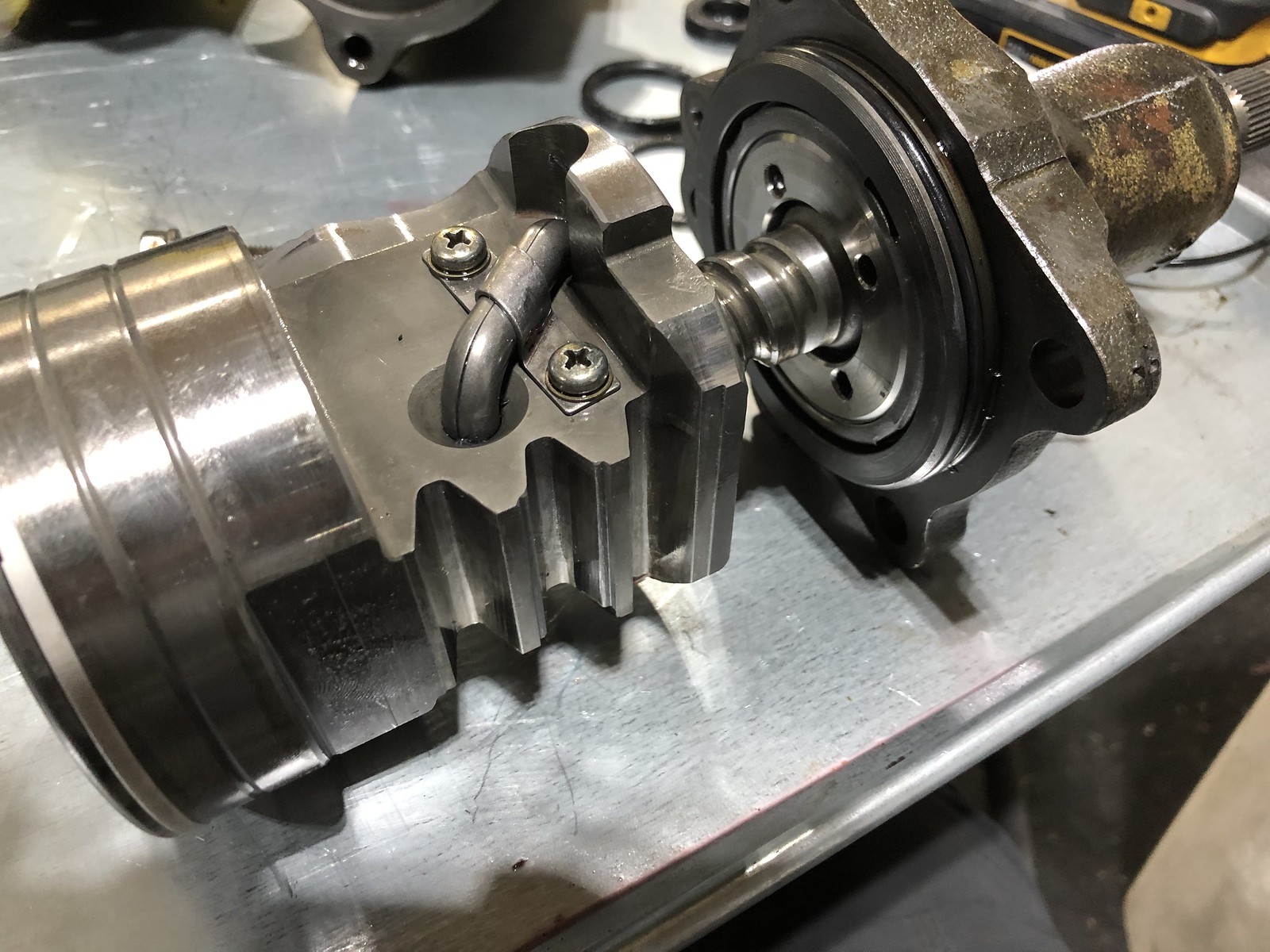

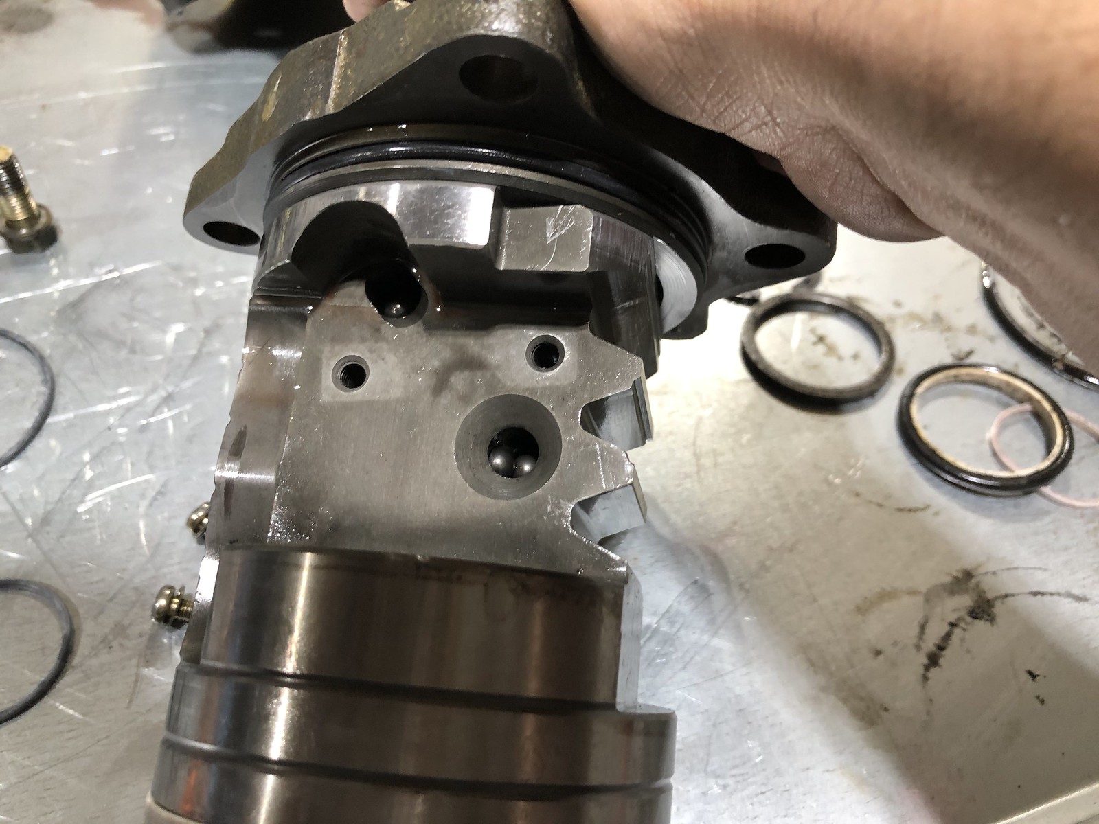

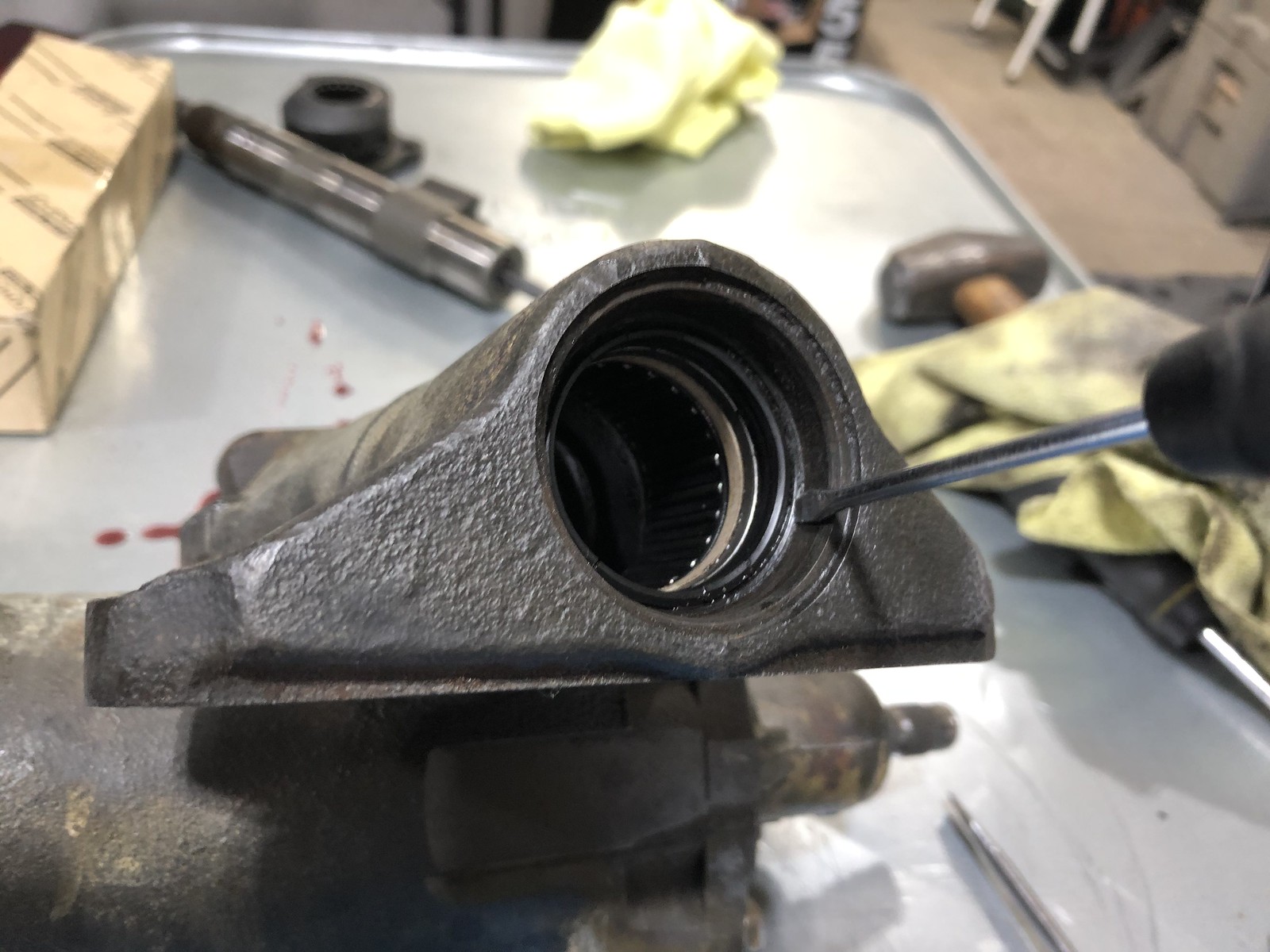

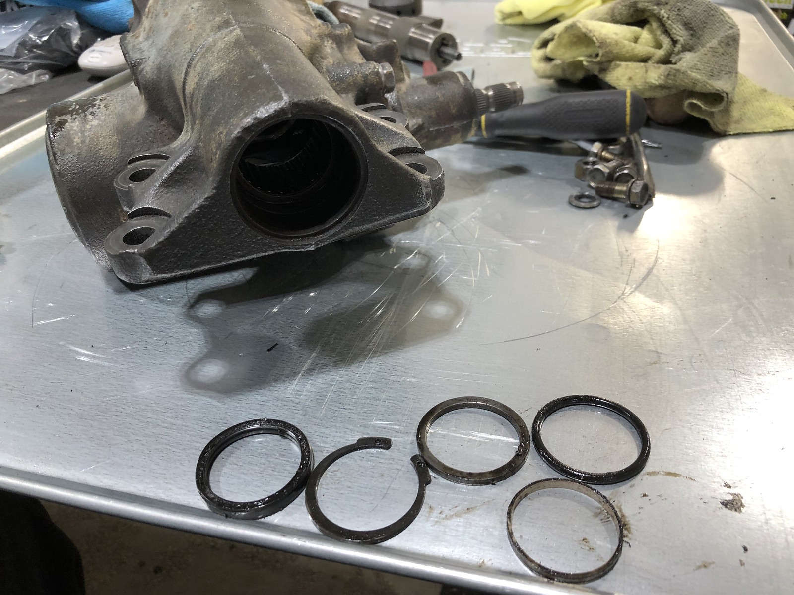

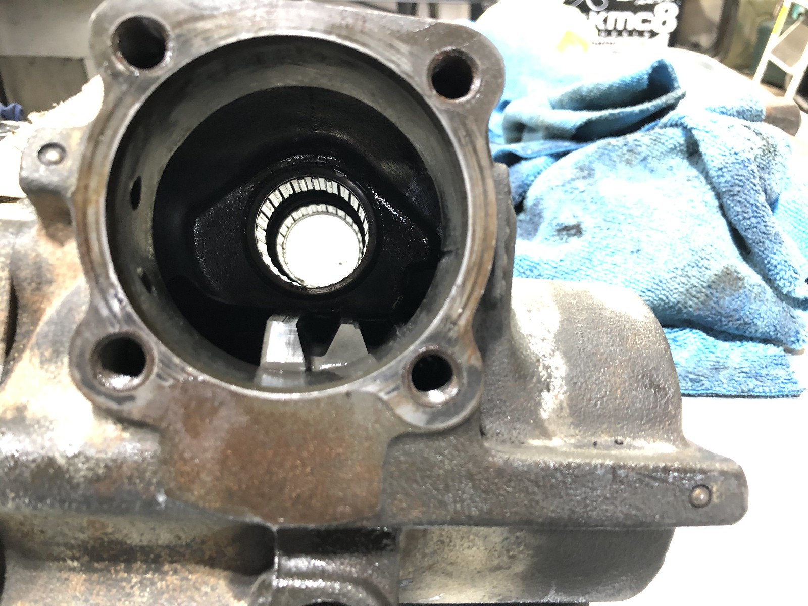

Inside the box you'll see more needle bearings as well as the power piston teeth. As with the side cover needle bearing, check for smooth bearings and replace if needed. Again, mine were in good shape and didn't need to be replaced.
There is a seal, a snap ring, a metal ring, a Teflon ring, and a rubber O-ring in the bottom of the box. Remove them all, but leave the bearing in place. Use a punch or seal puller (if you have one that will fit) to remove the seal and expose the snap ring. Remove the snap ring. The metal ring is next and should come out easily but if there is corrosion inside the box you may need to use a little emery cloth to remove the corrosion so you can get the ring out. Under the metal ring is the rubber o-ring and Teflon ring that should come out without issue. Note the order that these come out so you can put new ones back in in the right order when you reassemble.

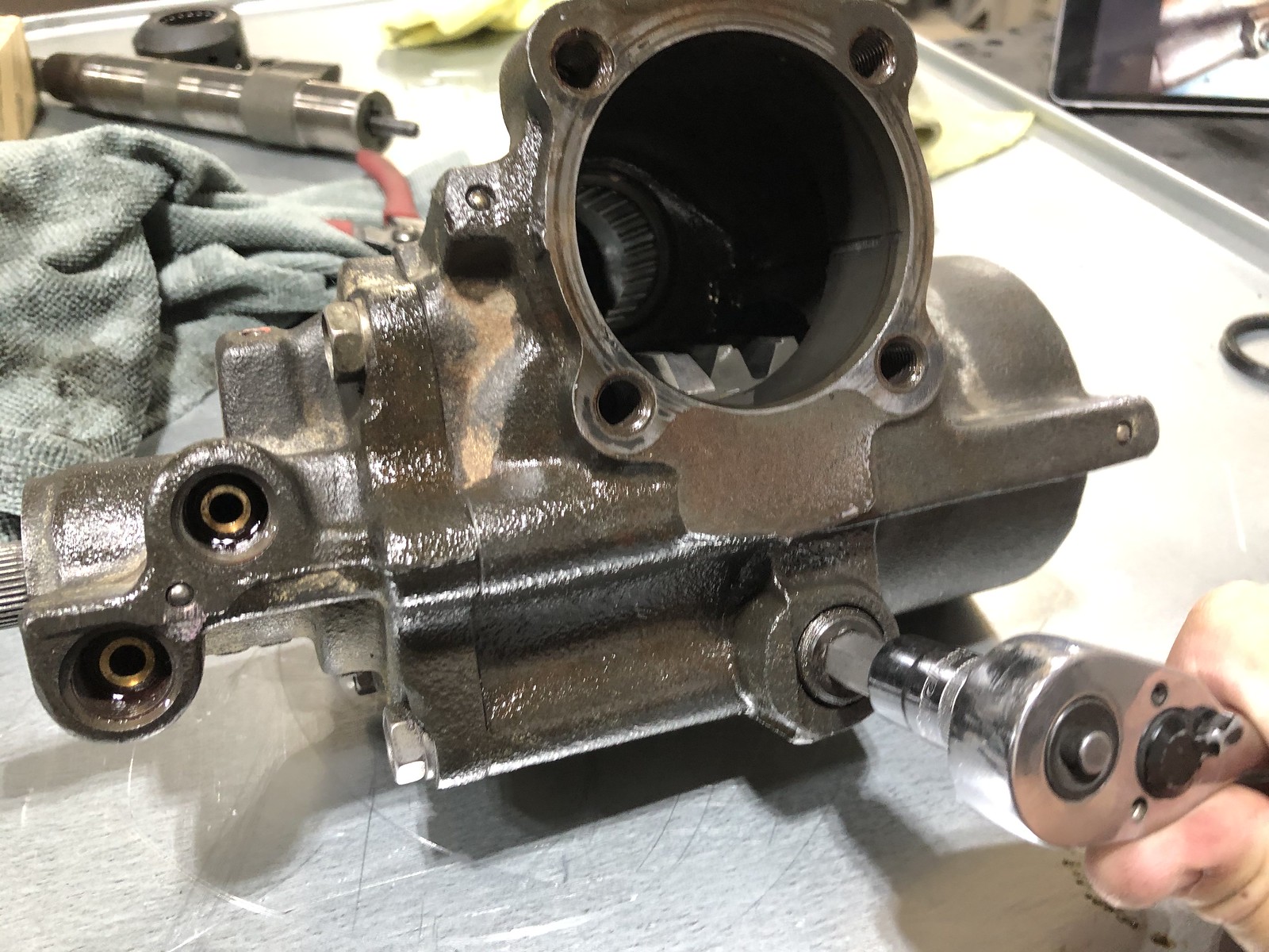

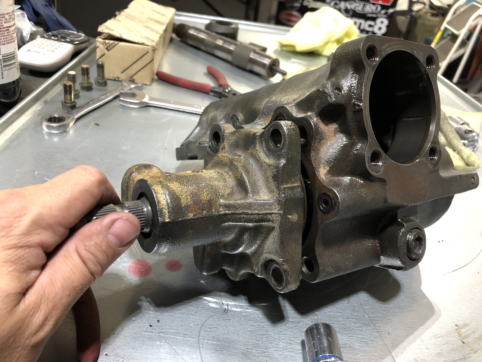

Step 3: Remove the worm gear valve body

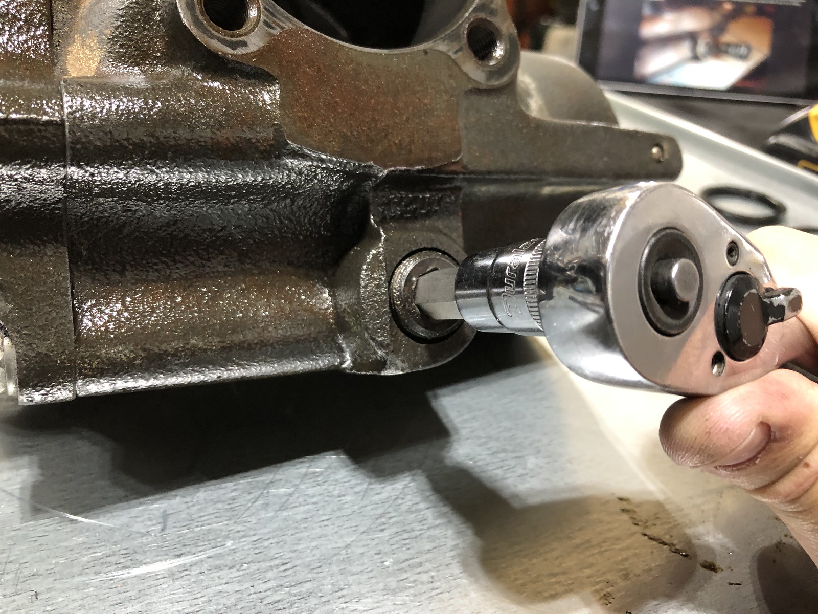

First you need to remove the power piston plunger guide nut. This is were you need the 10mm allen wrench.
Now remove the 4 bolts that hold the valve body cover to the side of the box. Once the bolts are removed, turn the input shaft all the way to the left. It will bottom out and start to push the side cover out of the box.

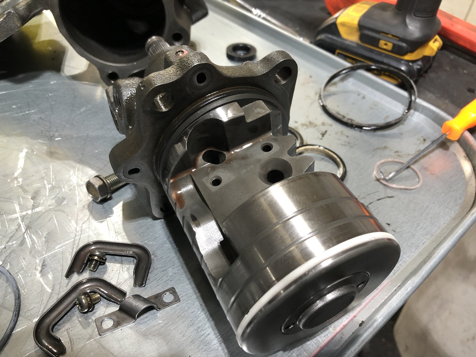

The valve body assembly will all come out with the side cover. The metal tube you can see holds a bunch of ball bearings. The ball bearings fit into the grooves on the worm gear shaft. This is what this style box is called a "recirculating ball" steering and the worm gear is what will move the power piston back and forth and the teeth on the piston is what turns the sector shaft and pitman arm.
I did not get a photo of it but on the steering box under the valve body cover you just removed are two small o-rings. Replace those with new o-rings from your kit.

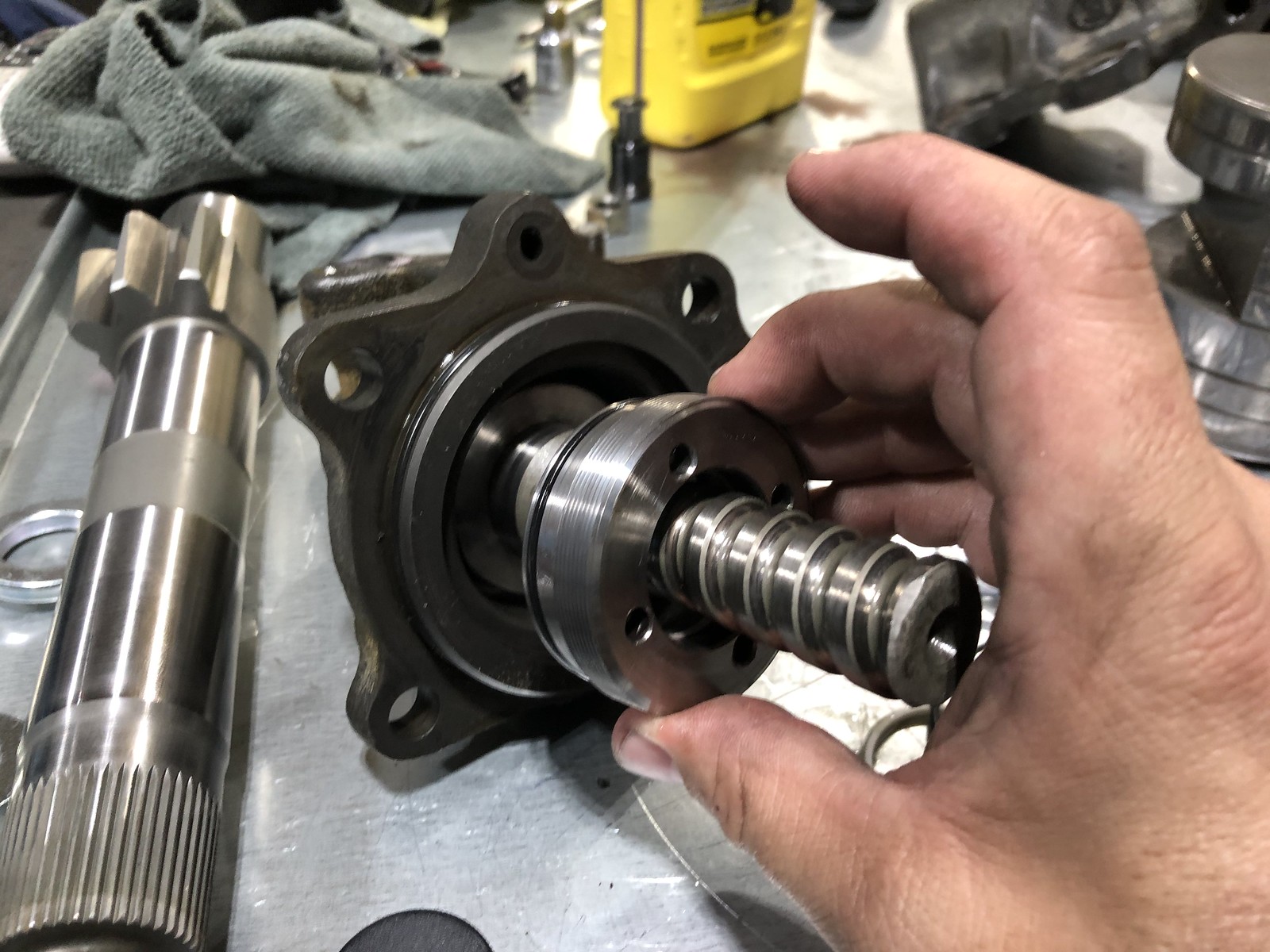

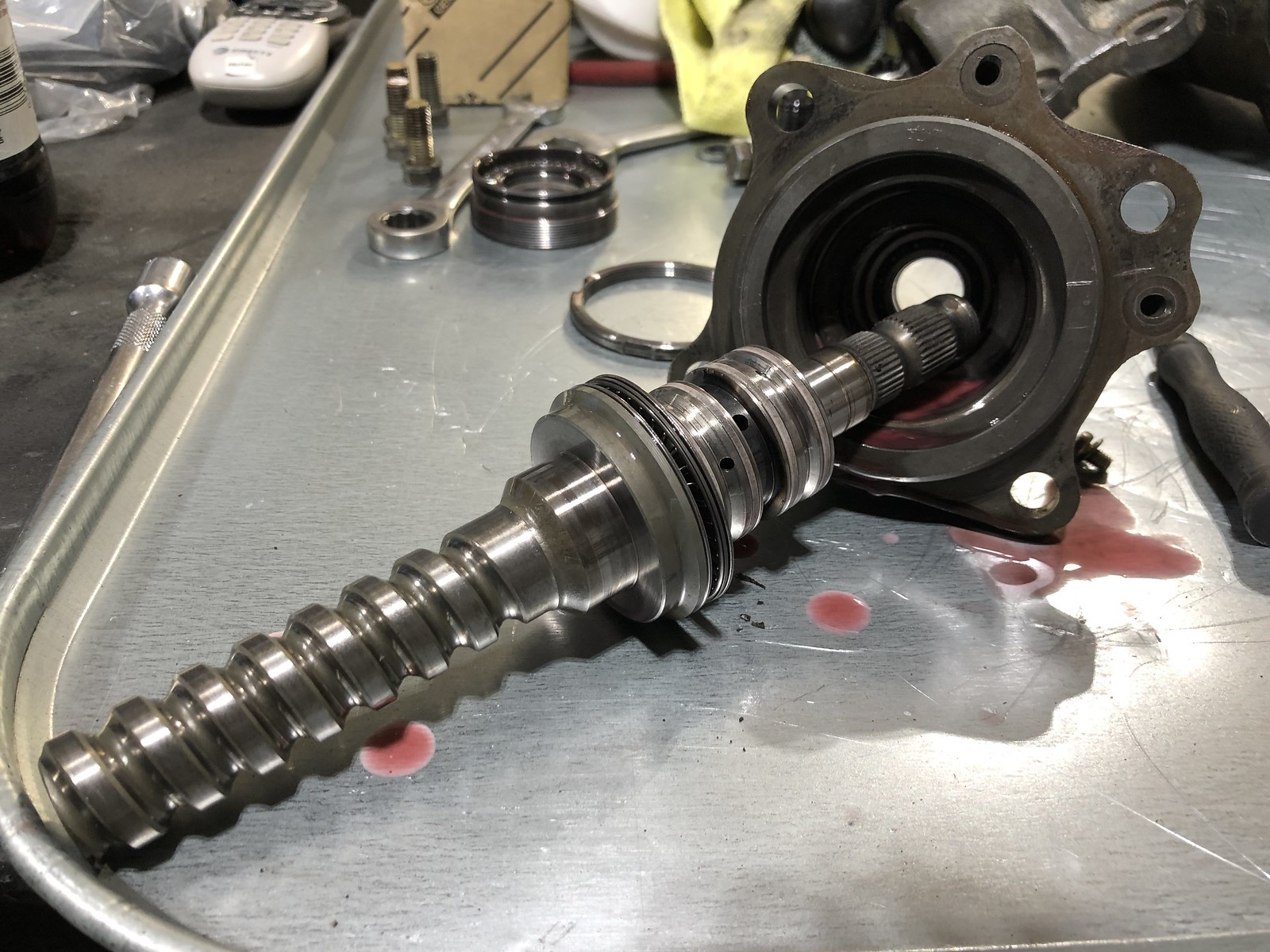

Step 4: Disassemble the worm gear valve body assembly.

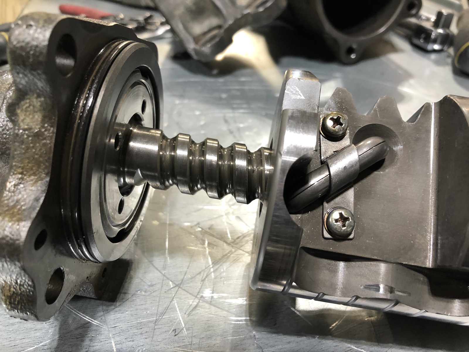

Separate the worm gear from the power piston by turning the input shaft. Be careful of the ball bearings inside that could come out. Don't lose any that come out.

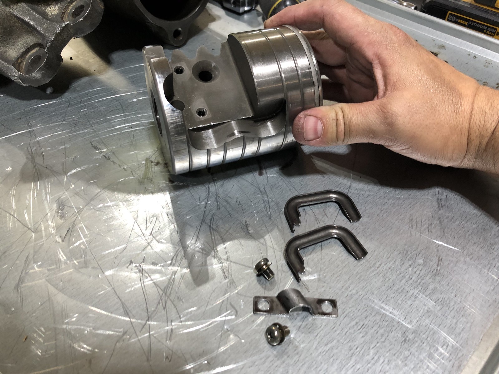

Now remove the two screws holding the ball bearing tube. #2 Phillips screws. Keep track of the metal strap that holds the tube. The tube is two pieces. Set those aside also. Put the ball bearings in some kind of container so you don't lose any.

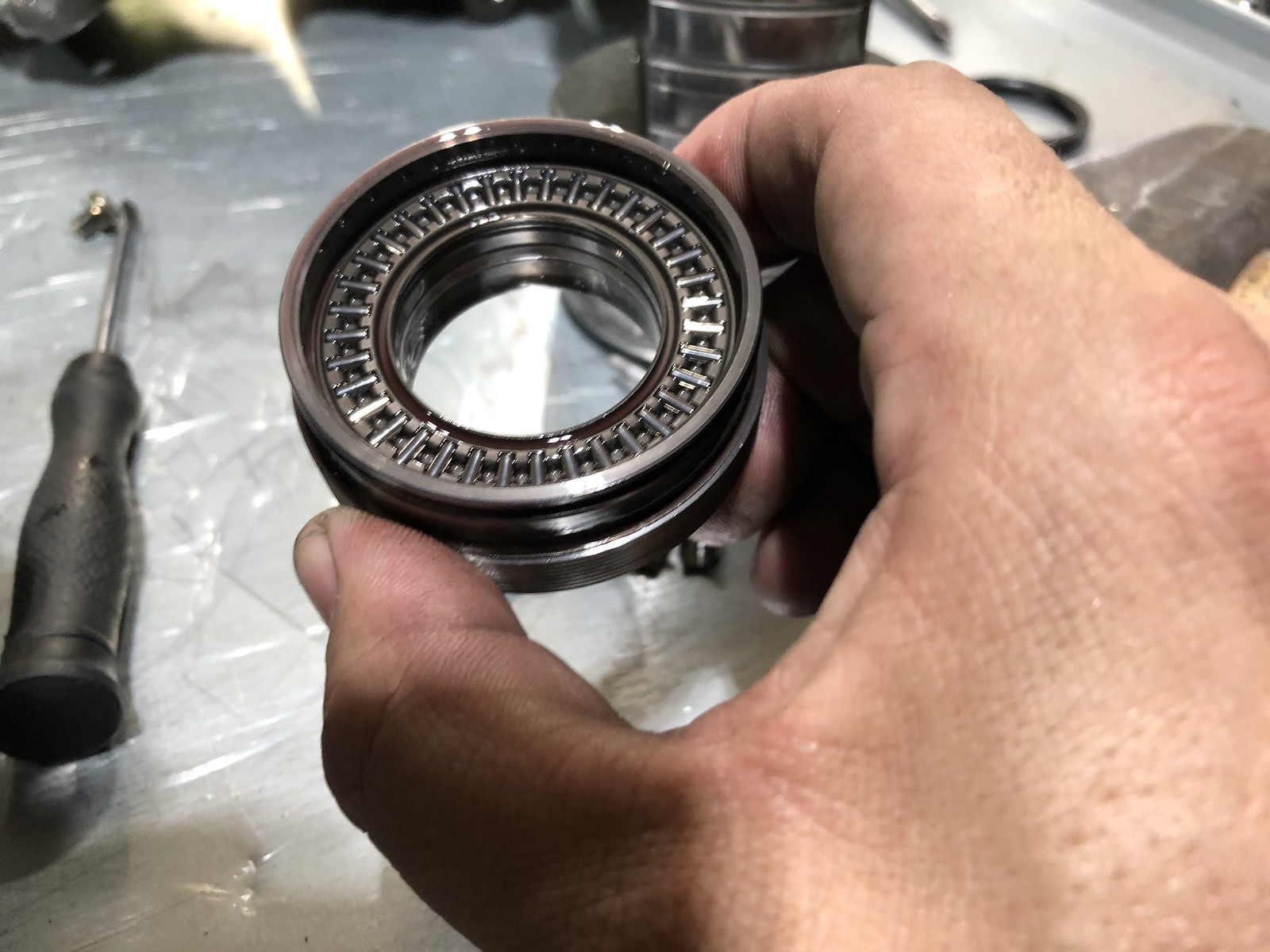

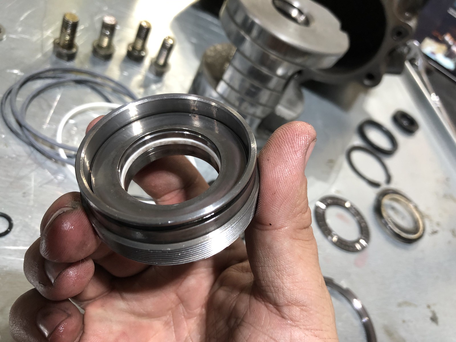

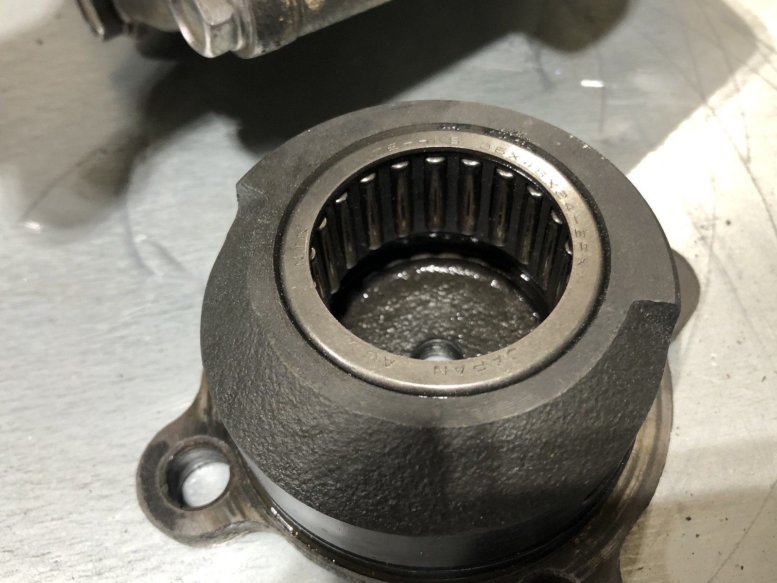

There's another needle bearing inside the preload nut.

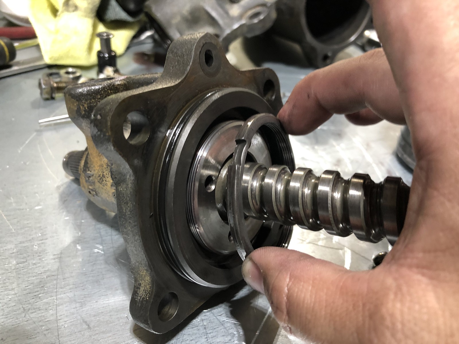

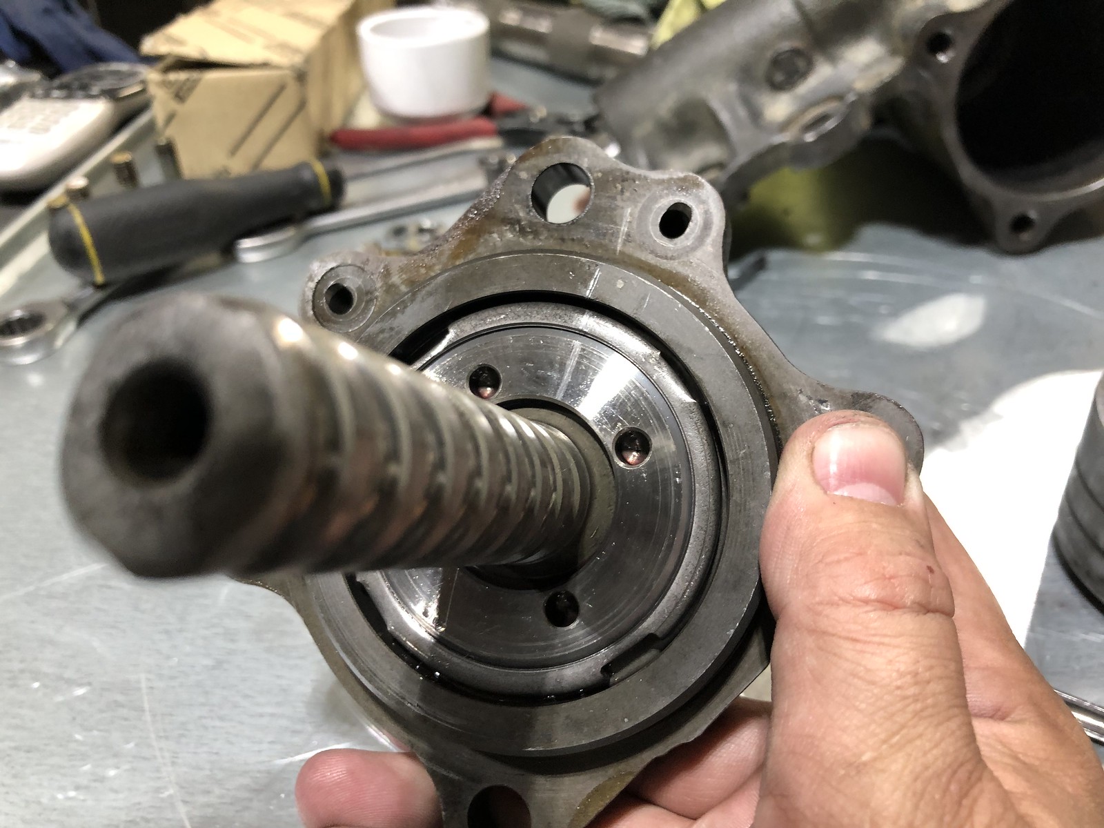

Under the needle bearing is a metal ring (bearing race) and you can see a Teflon ring inside the bore of the nut that you'll replace.

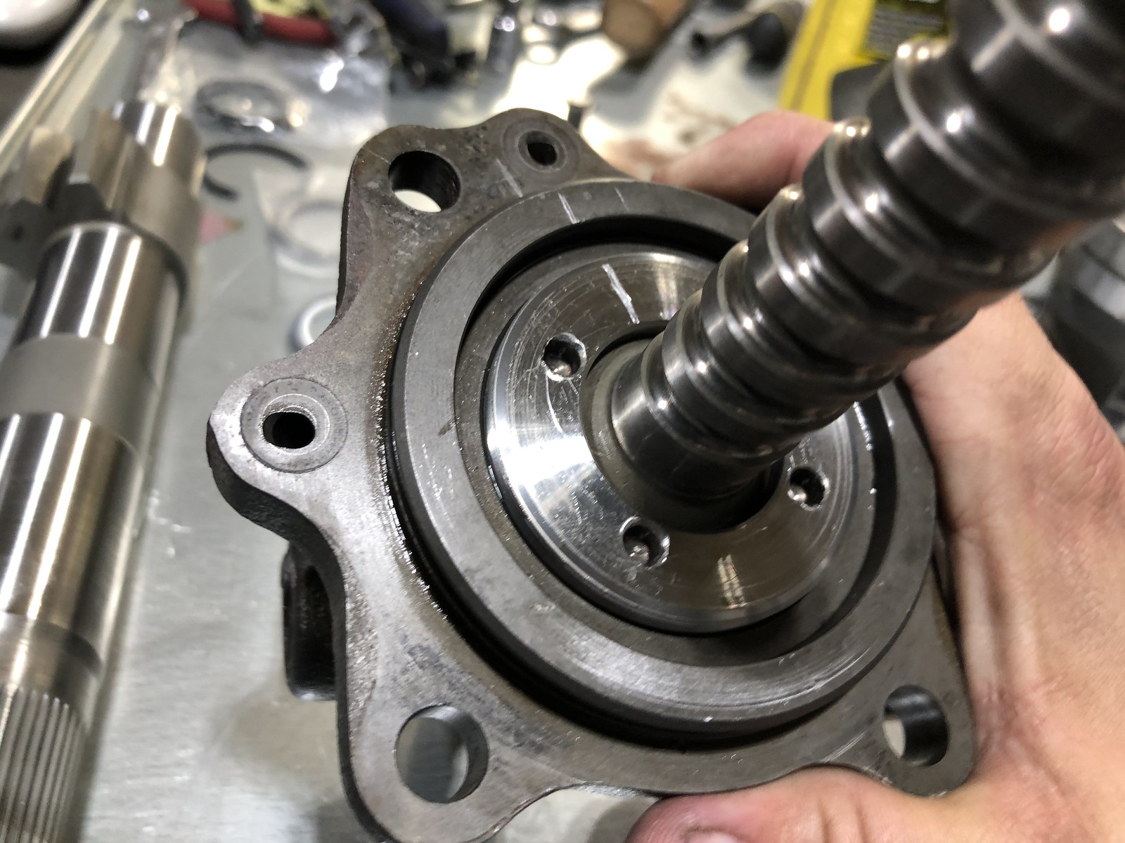

Now you can remove the input shaft. It might need a couple taps with a mallet to get it out. The Teflon rings on the input shaft are not included in the seal kit so the ones on the shaft will be reused. Don't damage them.

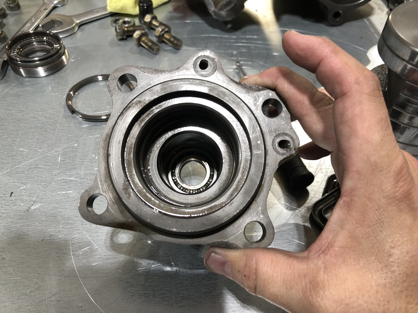

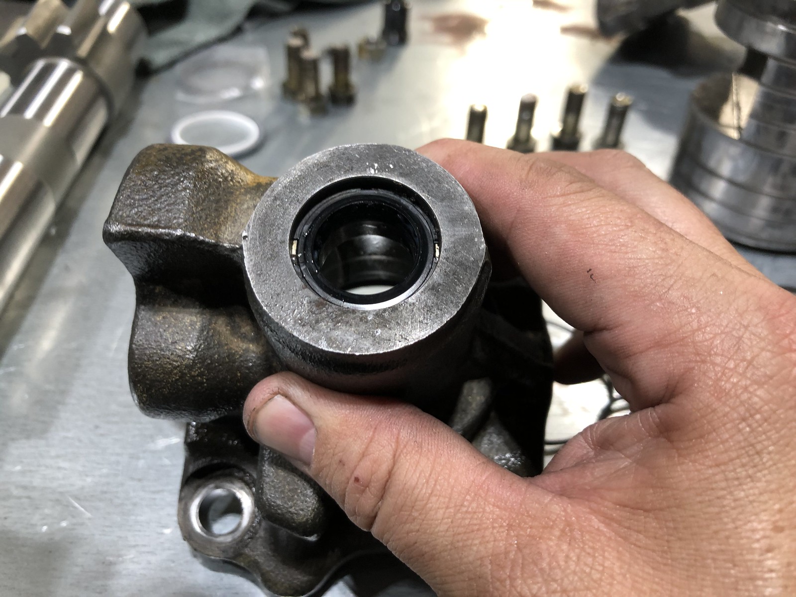

Inside the input shaft housing is a seal and bearing that need to come out. This seal is often the one that leaks.
The bearing and seal removed

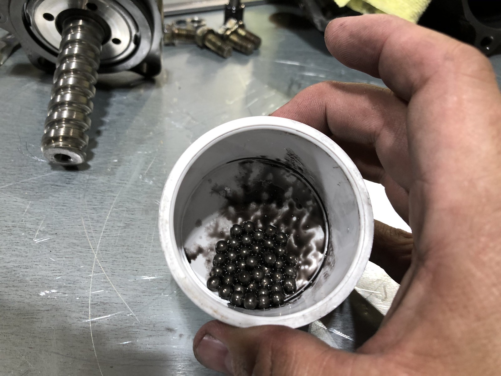

Now you get to put all the ball bearings back in the power piston. Before you do that, replace the o-ring on the input shaft housing. You can see the o-ring on the housing in this image

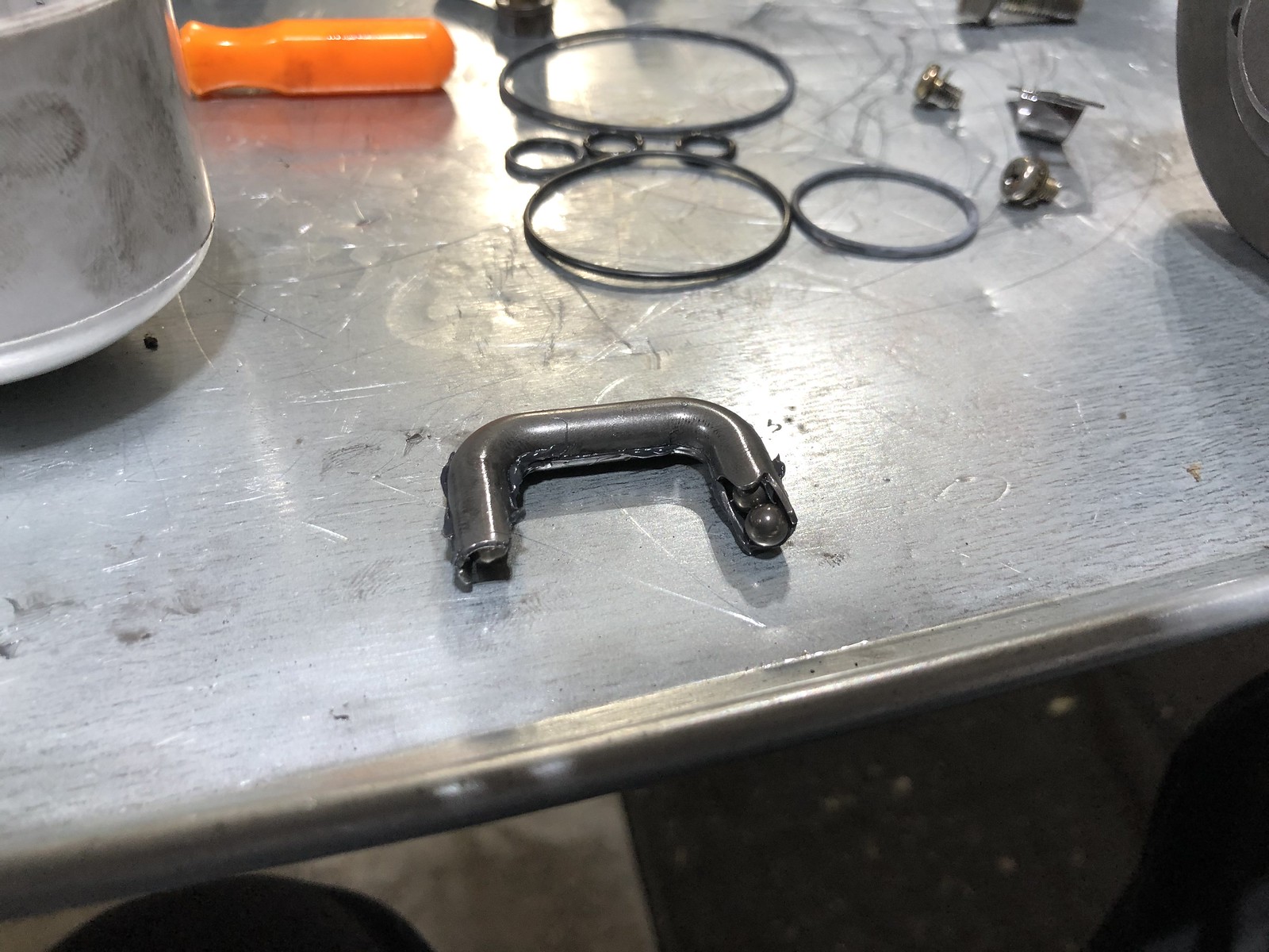

When you have most of the balls back into the piston, take the two halves of the metal tube and apply a little moly grease to both sides. Then set the remaining balls in one half of the tube and place the other half of the tube on top. The grease will hold the balls in place.

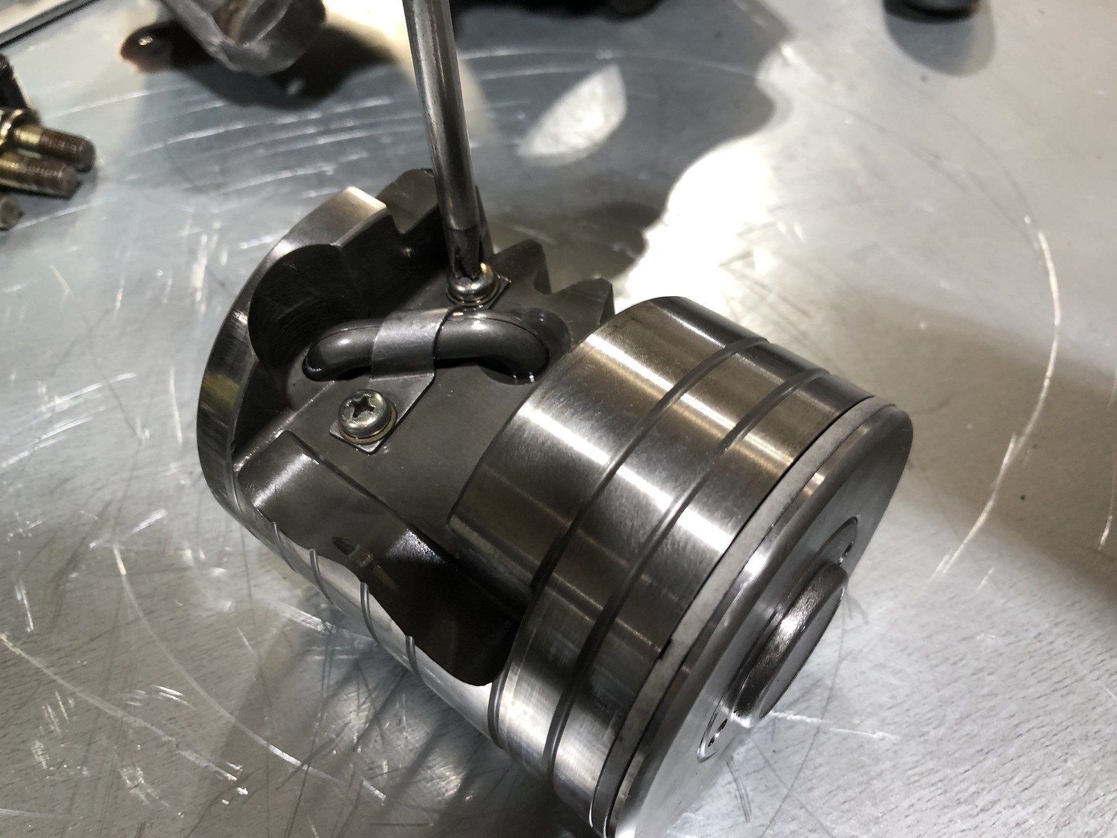

Put the metal tube back into place on the piston and place the metal strap and two philips screws back on to hold the tube in place on the piston.

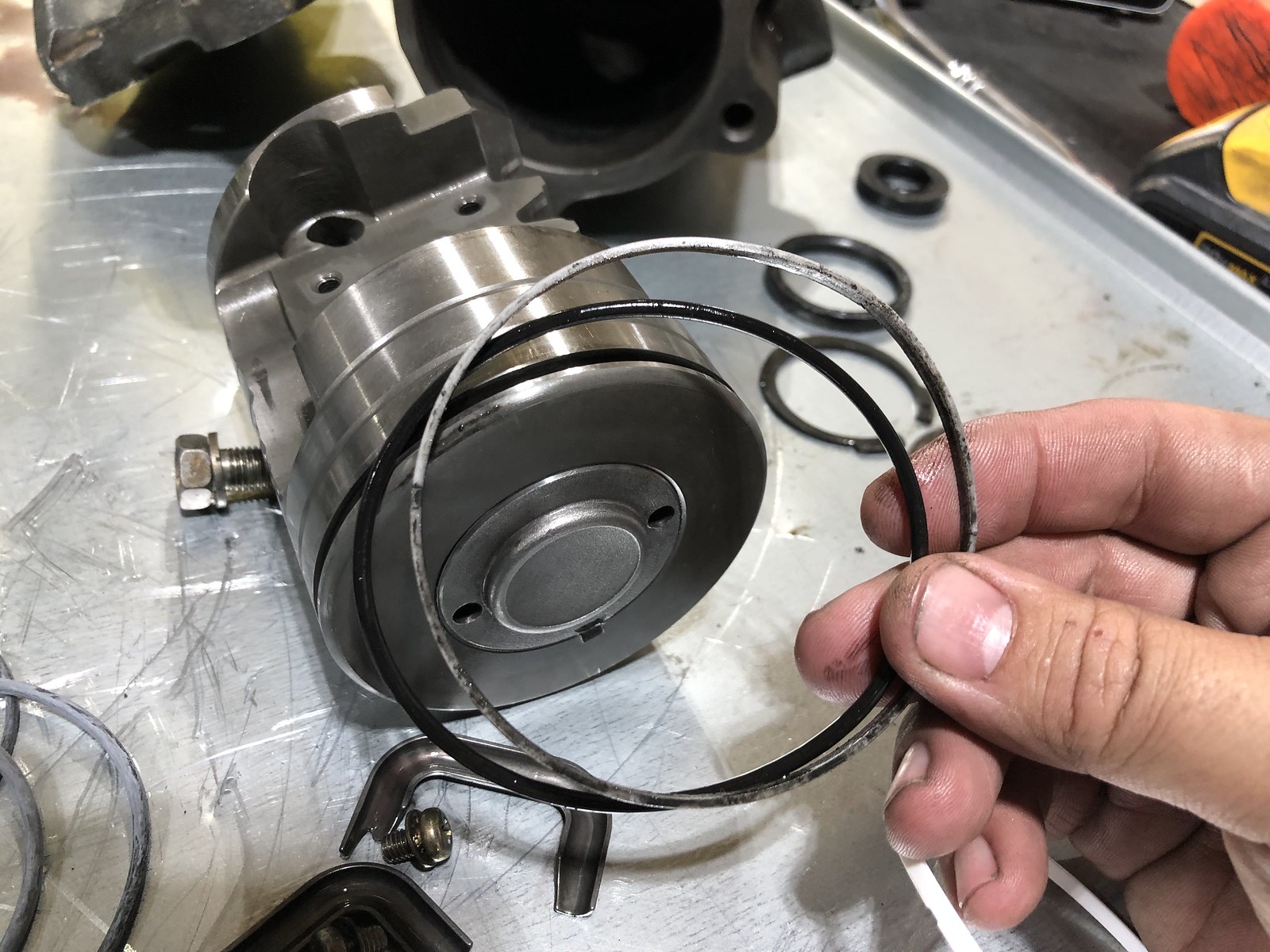

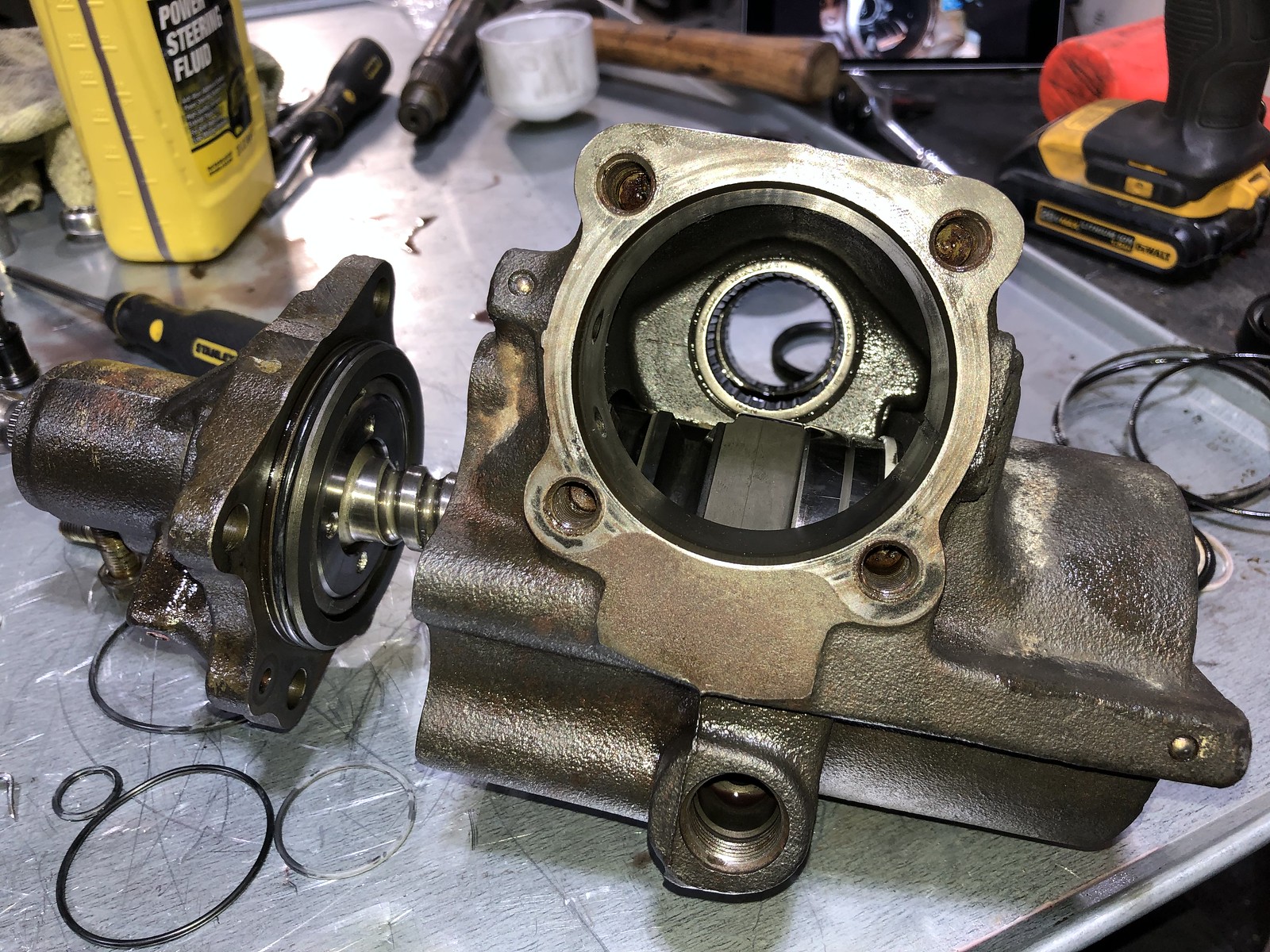

The next step is to reinstall the worm gear valve body and power piston assembly back into the housing. On the end of the power piston is a rubber o-ring under the Teflon ring. Your seal kit should come with a new o-ring and teflon ring to replace the old ones. Put the new o-ring on in the groove and place the teflon ring on top of the rubber o-ring.
Note: this photo is out of order. I actually replaced both of these rings before putting the ball bearings and tube back together.

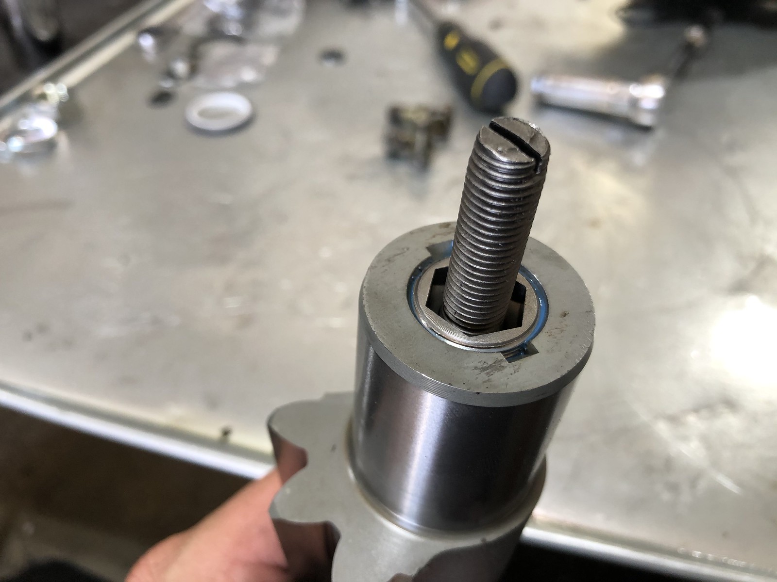

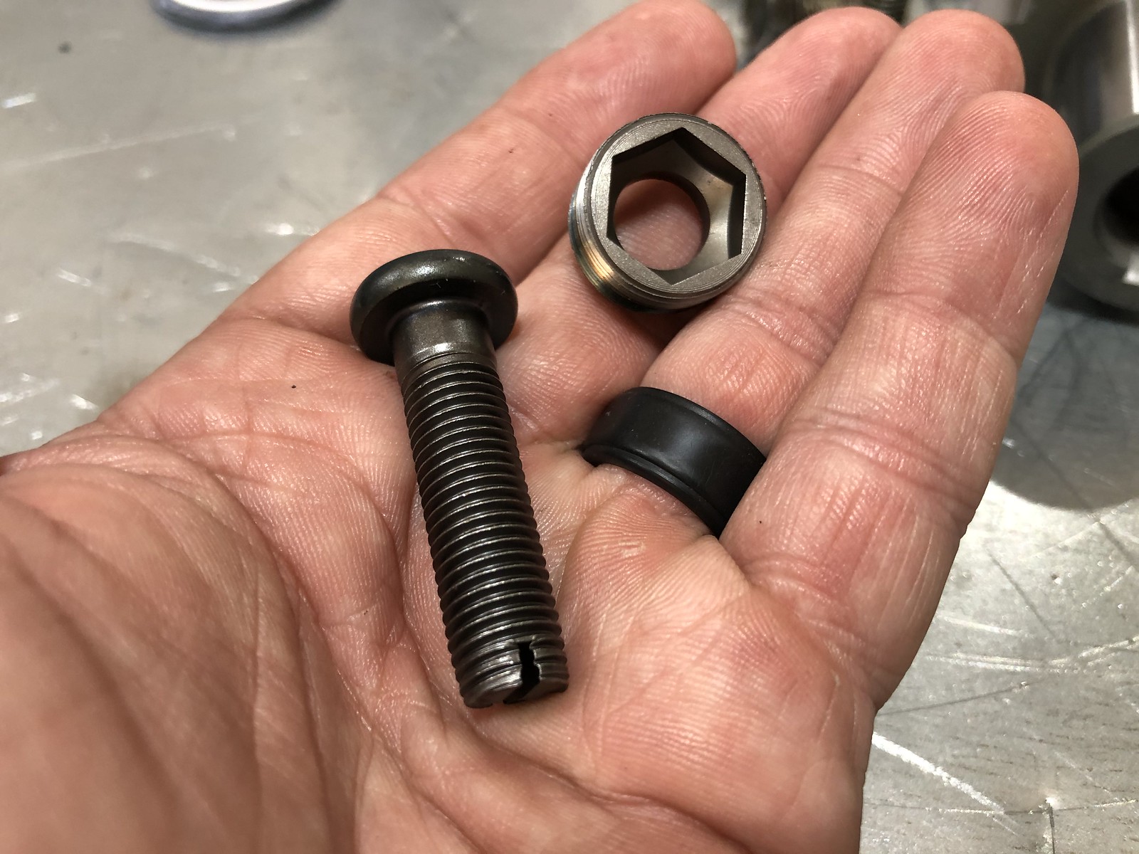

I got a new nut and adjustment screw. I suggest getting a new one of both of these when you purchase your parts in the beginning. It's probably not the best move to reuse the original stake nut anyway.
Steering box by Adam Tolman, on Flickr

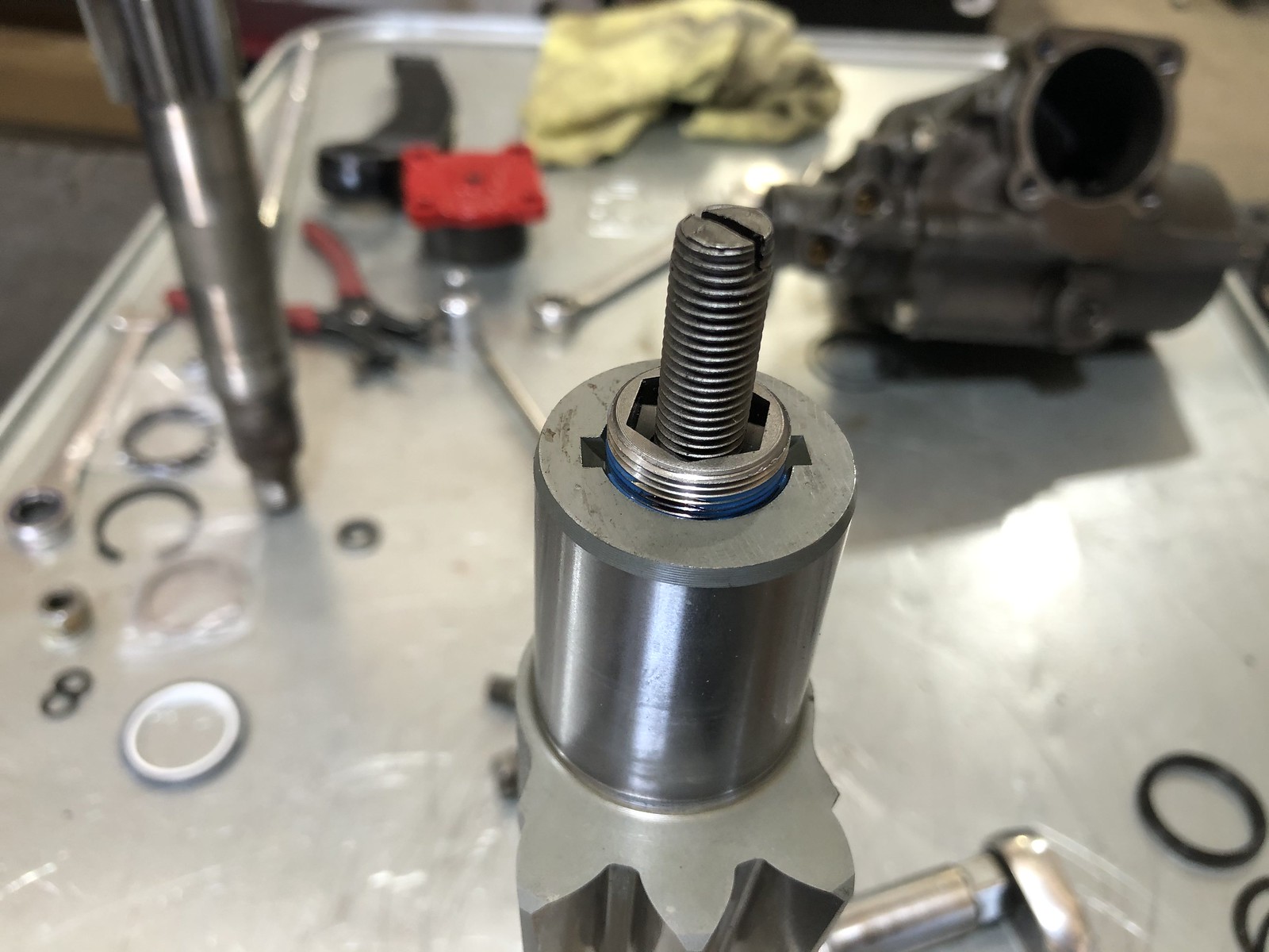

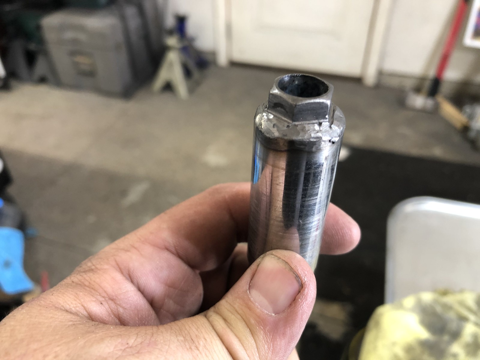

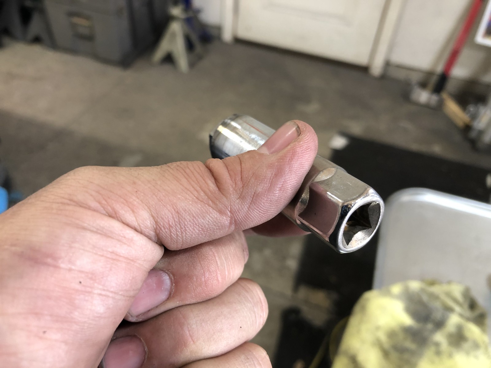

This is where you'll need a SST to tighten the nut. I made my own SST by drilling out a 14mm nut so the adjustment screw could pass through, then welding the nut to an old socket. I little dremel work to shape the weld so the SST could have as much purchase on the nut needing to be tightened.
since the new nut did not have staking tabs, I used blue Loctite on the threads and installed the nut and adjustment screw into the new 105 shaft.

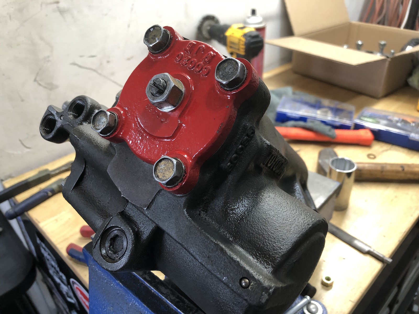

Since I have two steering boxes out of the truck being rebuilt I painted the side cover red on this one so I know which has the 105 sector shaft without having to count splines. I know a certain shop also paints the side cover red on their rebuilt boxes. This isn't meant to copy them, just helps me know which is which. I had some red paint or white paint and white didn't seem like the right choice. So red it is.
Put a new o-ring on the side cover and put it back into position with the adjustment screw. Use the adjustment screw to pull the side cover back into place. Note: turn the adjustment screw counter clockwise (lefty-loosy) to pull the cover into place.

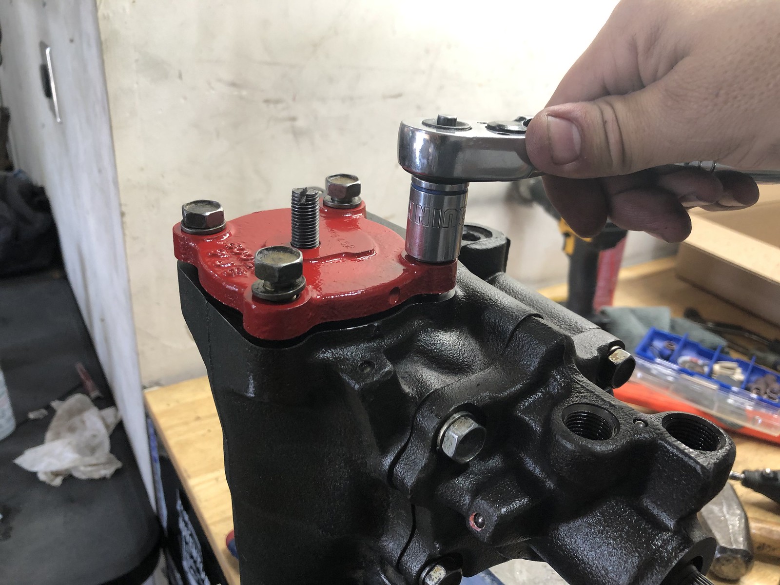

Now reinstall and tighten the 4 bolts that hold the side cover on.

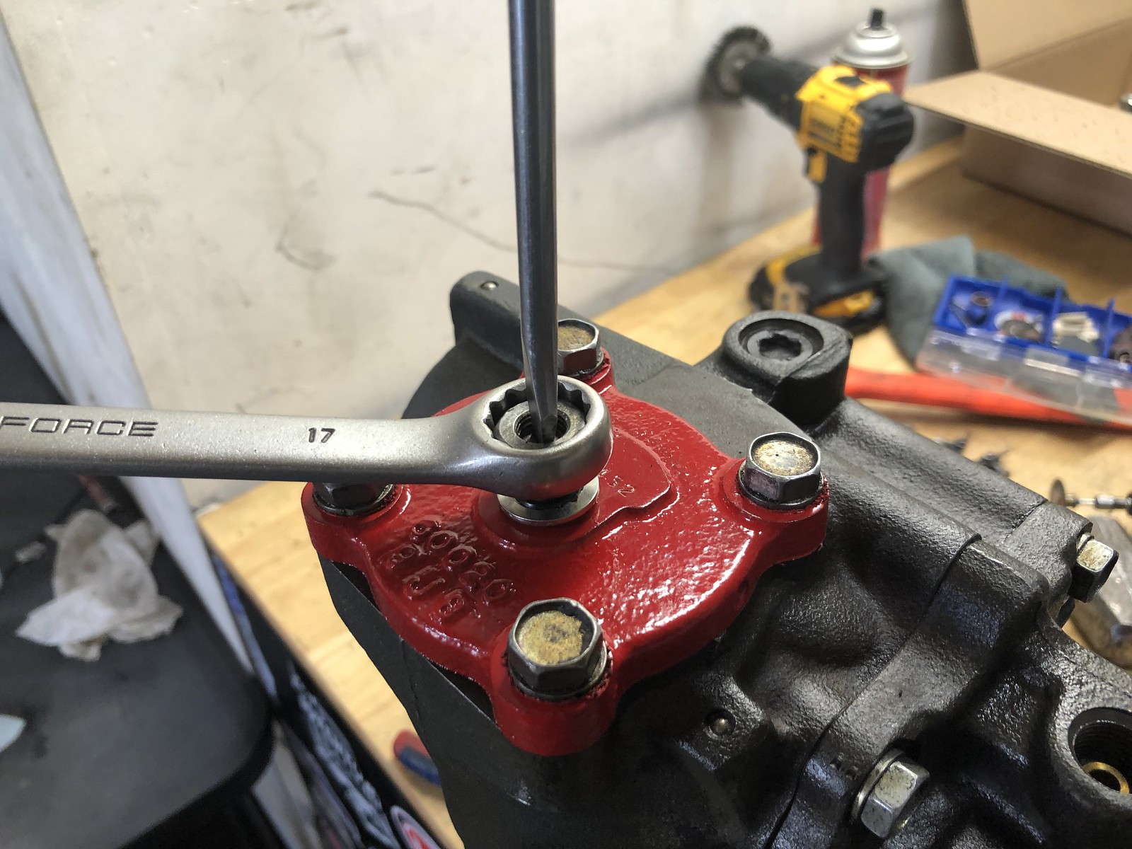

Now you need to set the preload. I don't have a dial indicator so I set the preload by feel. It's pretty easy to tell what is too tight on the adjustment screw. Start by tightening the adjustment screw all the way. You won't be able to turn the input shaft. Then slowly loosen the adjustment screw ( I did about a 1/4 turn at a time) and checked the tension on the input shaft by turning it lock to lock. I set it just where the input shaft would turn smoothly lock to lock without any hitches and no more loose than that. I ended up at about 5 in/lb. I think that's close to any spec I've seen published.
Using a 17mm wrench and a screw driver to hold the adjustment screw so it doesn't move, reinstall the new seal washer and reuse the lock nut on the adjustment screw.

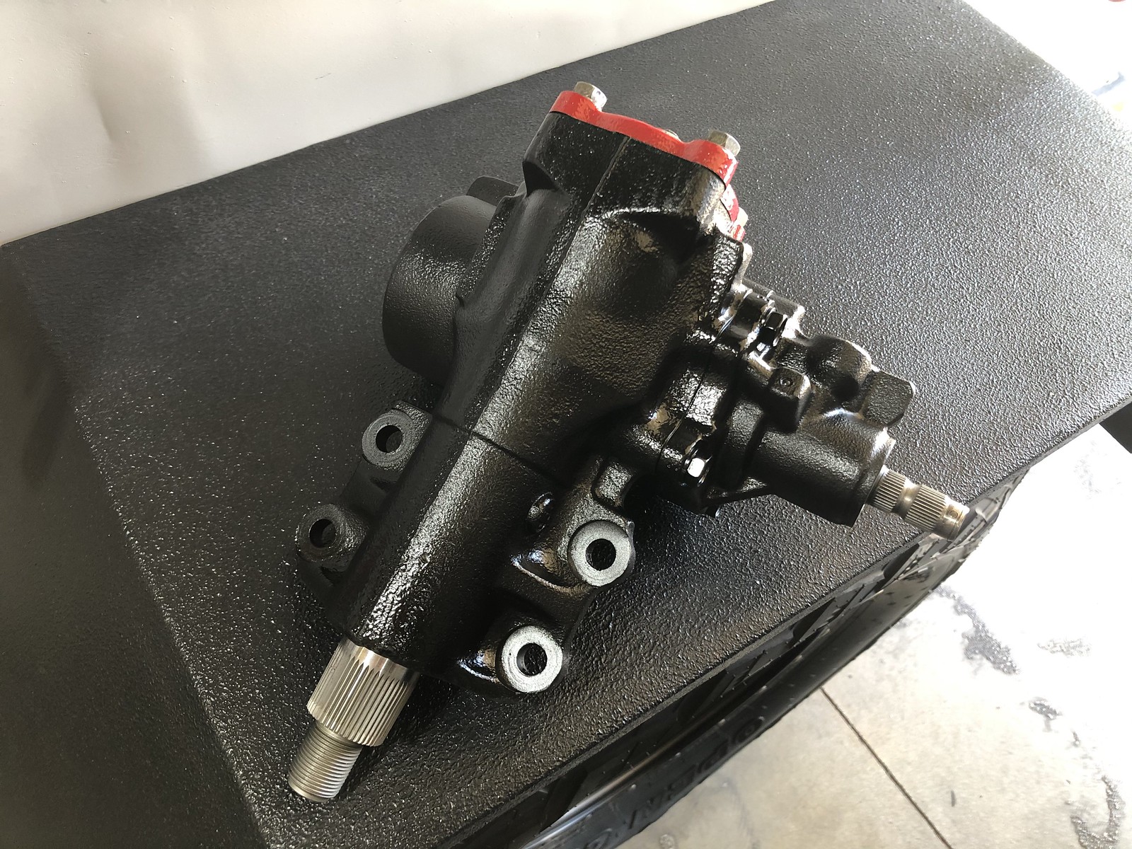

I sprayed a coat of fresh black paint on the housing and now it's ready to go back in the truck. This is the first steering box I've rebuilt so hopefully it all works out. The process was not that difficult. If I missed something or did something different than you have done it, I apologize. I tried to follow the FSM and other steering box rebuild threads that are here on MUD to compile the steps and photos. Hopefully this is helpful for someone that wants to tackle a rebuild/upgrade on their own.
