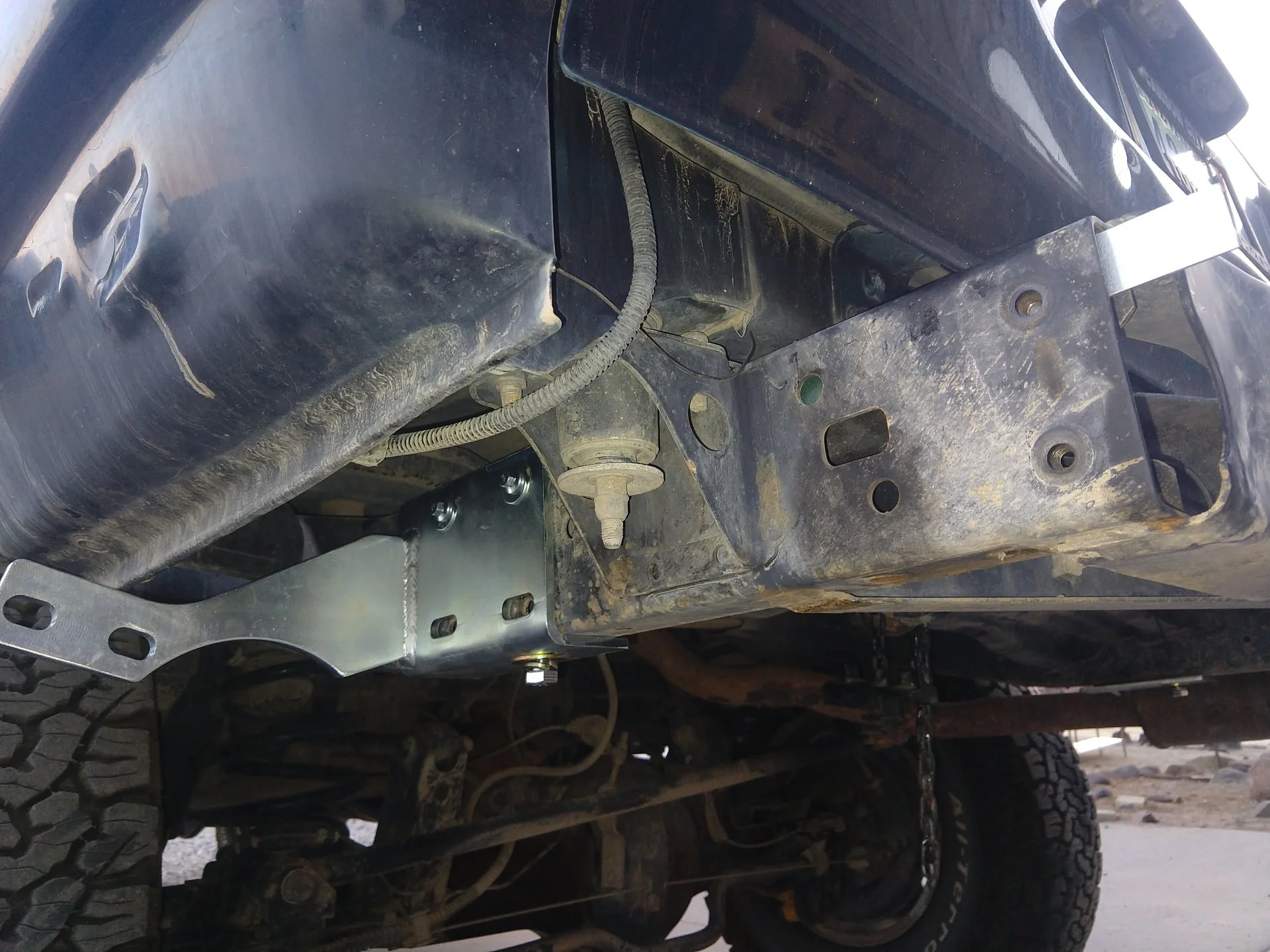

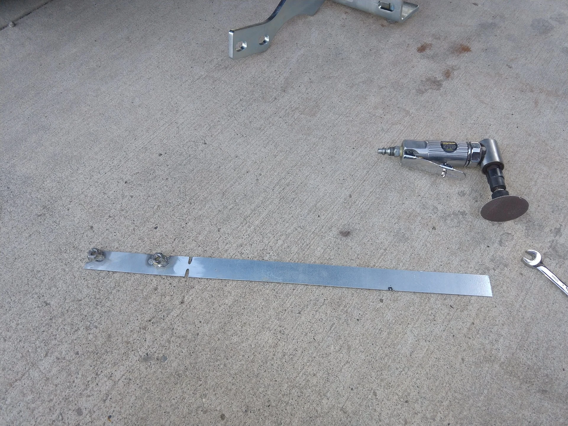

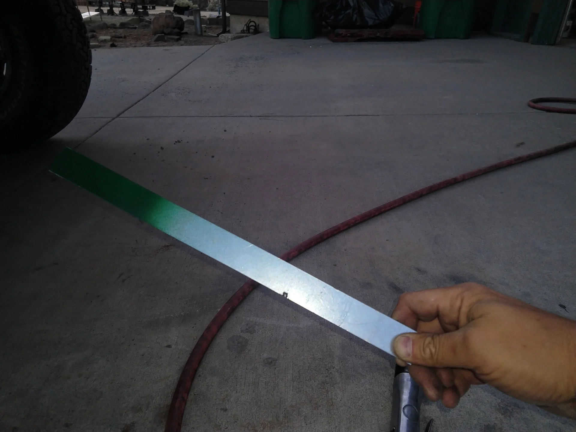

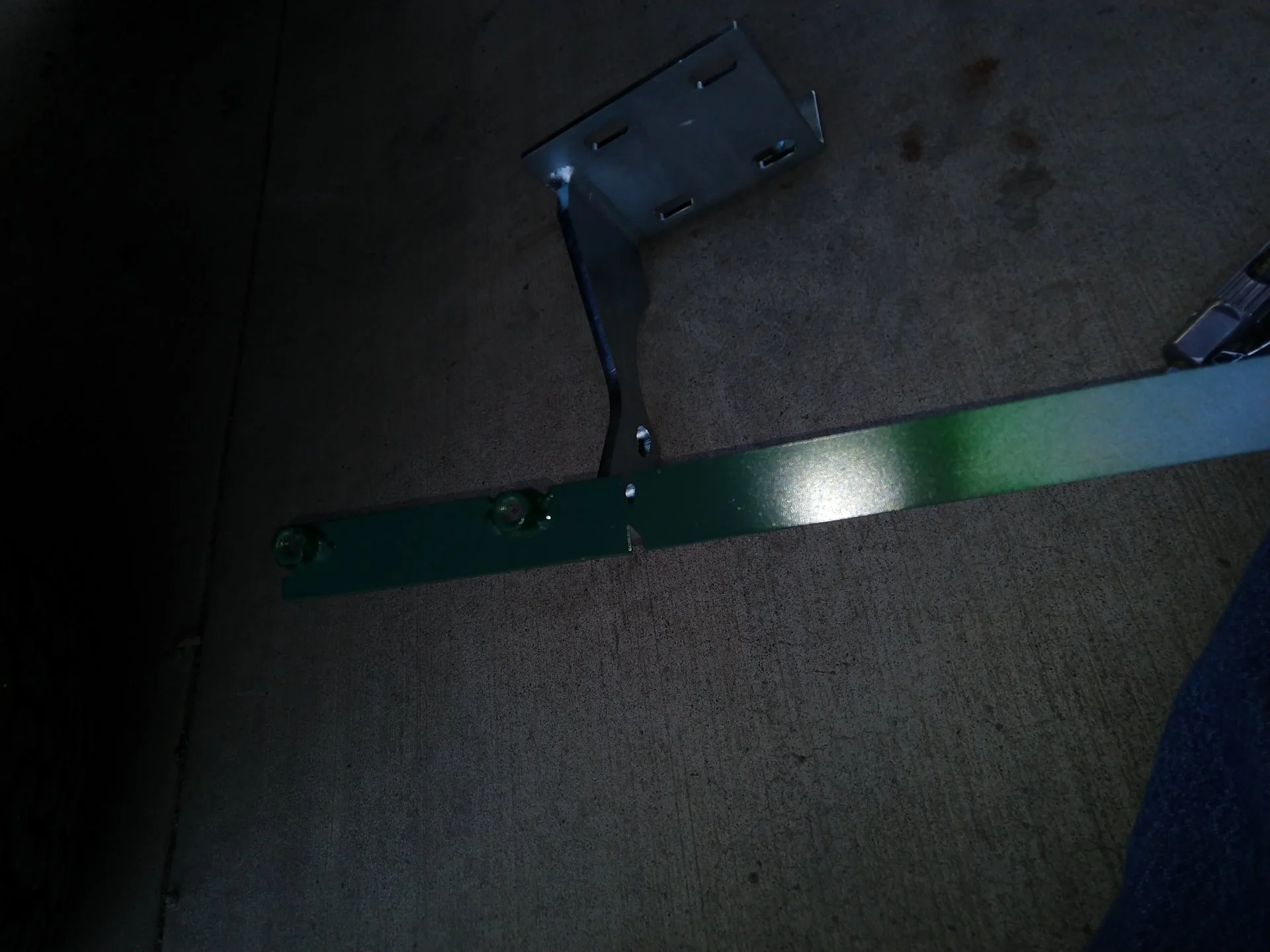

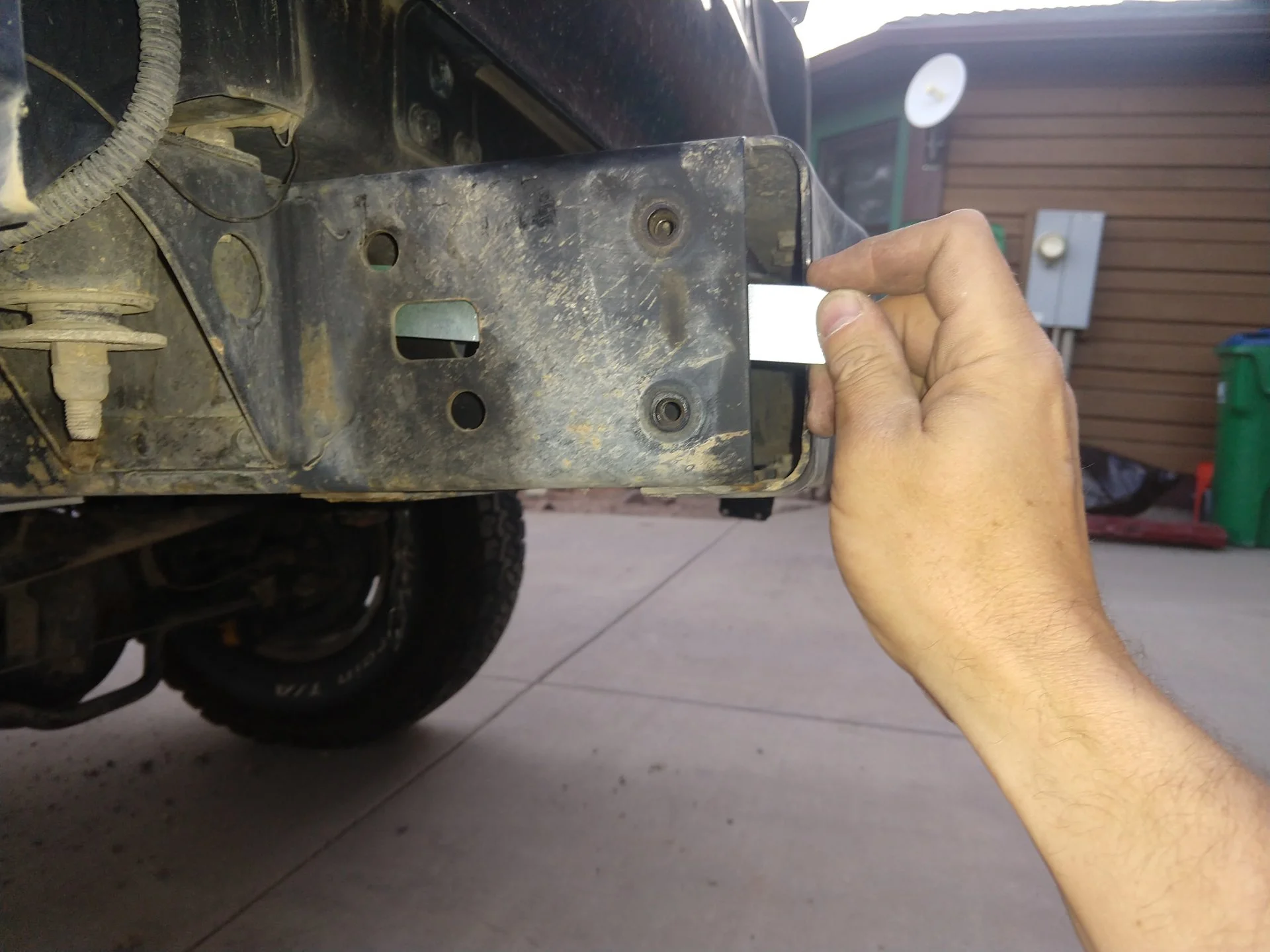

The Slee bumper's driver side bracket is slotted for 4 optional bolts, but the frame doesn't have nuts. I didn't want to drill the frame, so I welded the nuts to a strip with a breakaway handle. If I ever remove the bracket I will have to pull the strip with a magnet and weld on a new "applicator".

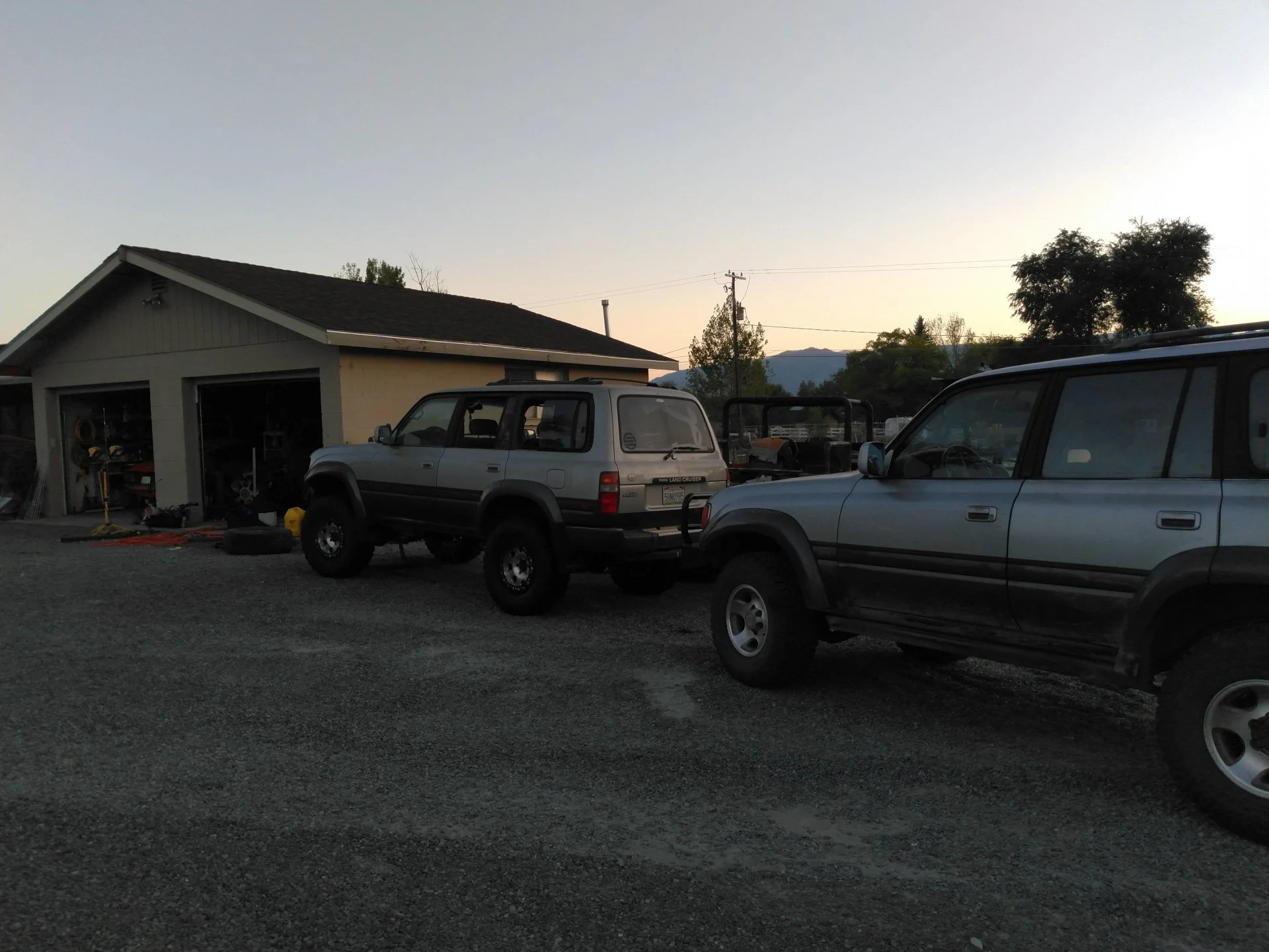

We will see how it sits when I get the motor back in it.. the j springs have it about 4" higher than mine, the armour, bumpers, sliders,. Add alot of weight.
Ohh and yes both trucks have been repainted from the front doors forward..

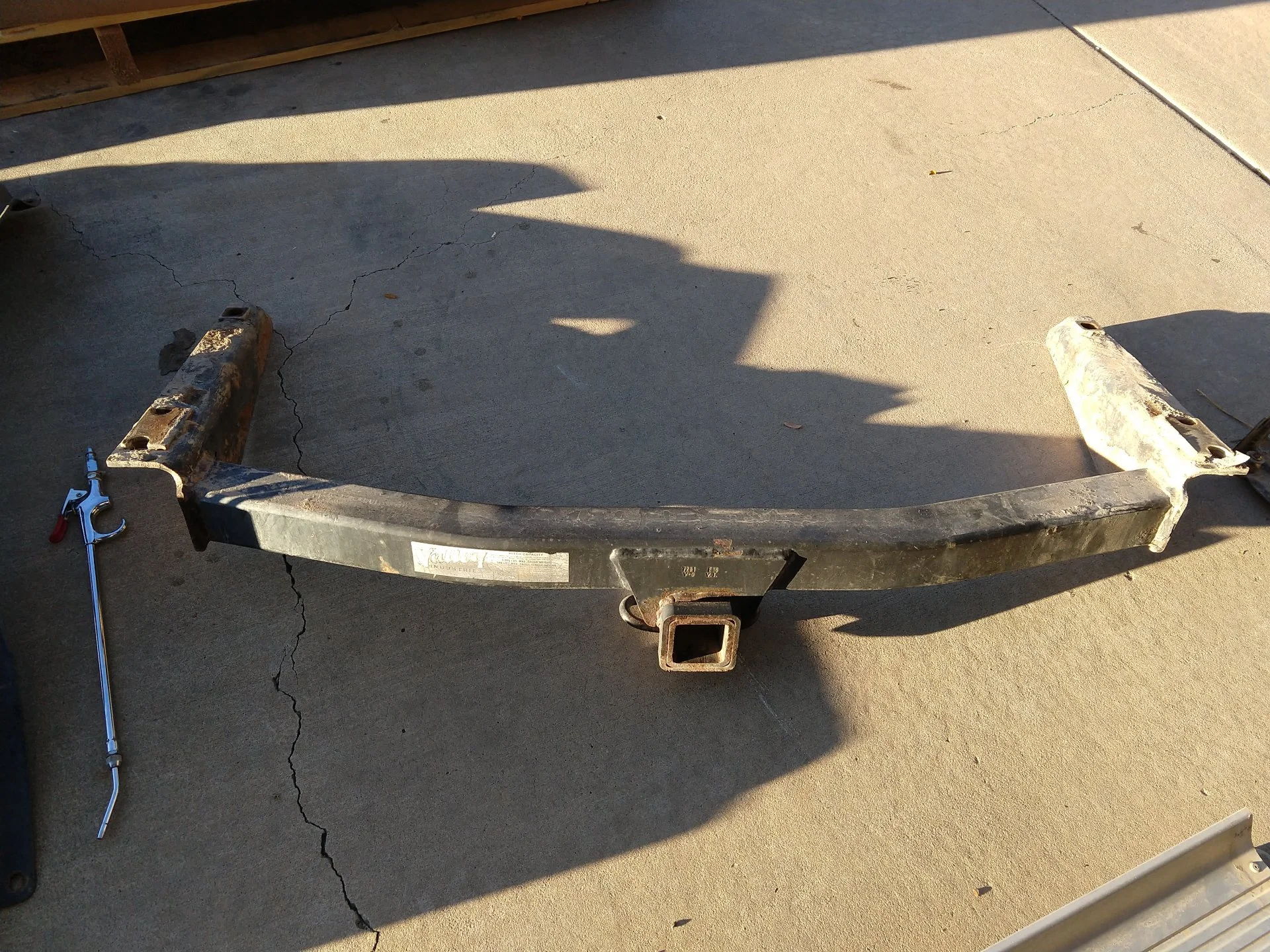

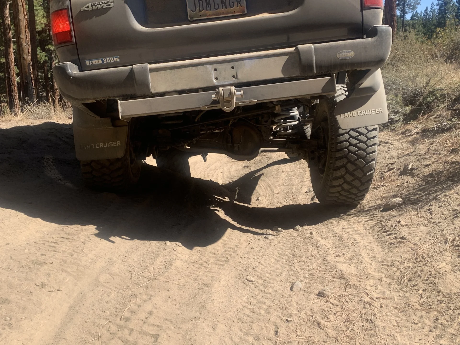

Bumper is on, though I need longer bolts to mount my receiver. Which brings me to a couple requests.
First: I would like to replace my receiver with another class III or IV with 6-bolt mounting, that does not drop the receiver tube. I can order a new one but if any of you local guys have one you'd like to part with let me know.

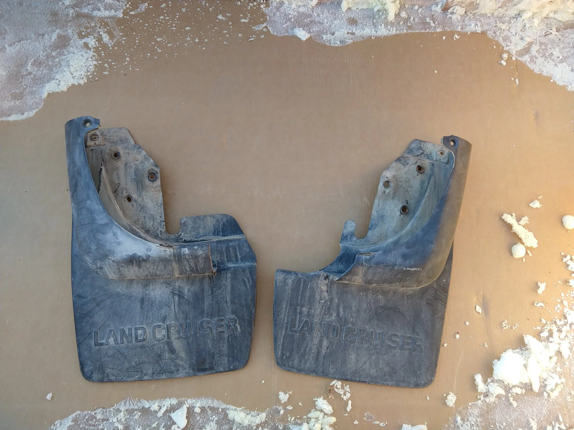

Second:. I need to cut up my rear mud flaps to fit the new bumper, but they are in pretty good shape. If you have thrashed rear mud flaps with good mounting holes and you'd like to get rid of them or work a trade let me know.

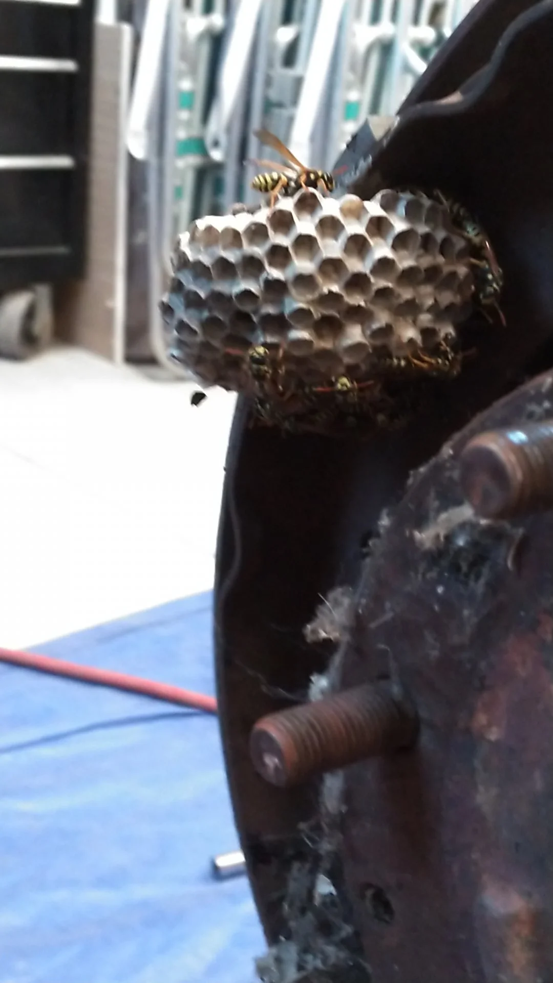

The axle you gave me had "62 land cruiser noisy" written on it. I went to drain the oil today to get started stripping it and figured out why it was noisy, there was no oil, not a drop. :rofl:

I have a couple receivers off 80's but I think they all drop down like that,. Call me later in the week and I will go look..

After I evicted the tenants everything went pretty smooth. The noise was probably caused by the grooves in the center pin, it was badly worn. I didn't spend much time looking at it but the side gears could have seized up. The gears looked pretty good otherwise if somebody wanted to build a spare.
