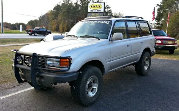

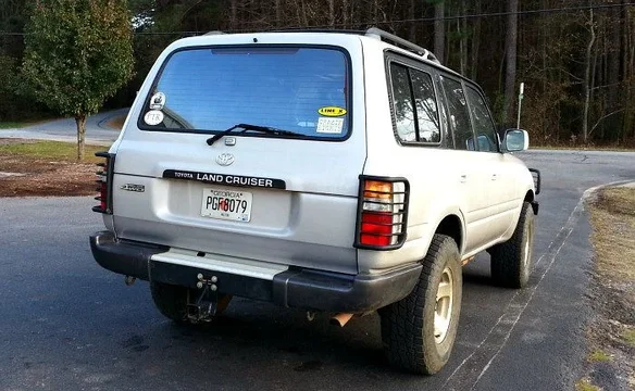

It's not the weekend, and I didn't actually "do" it, but I had Line-X of Athens color-match my 19 yo paint, cover all my flare holes and coat both sides. The owner, Chris, also painted the dark strip along the back to match for free. El Guapo es guapo nuevo!

Did you plug the flare holes before line-x? Just curious as I'm about to pull mine.
After I pulled the flares, I drilled out the holes (as needed) to the next standard size, and then filled them with nylon locking hole plugs until I got the money for the Line-X. Then, the day before I dropped it off at Line-X, I pulled all the plugs and coated the inside edge of all the holes with touch-up paint to seal the bare metal. The Line-X guy told me that he'd cover all the holes with aluminum tape before applying the product.
