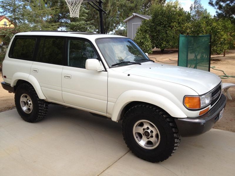

Mounted up some new 315's... Hope to get the TJM 4" lift on this weekend. :)
That how my rig looked when I got her. 315s on factory height!!! Looks great imo
