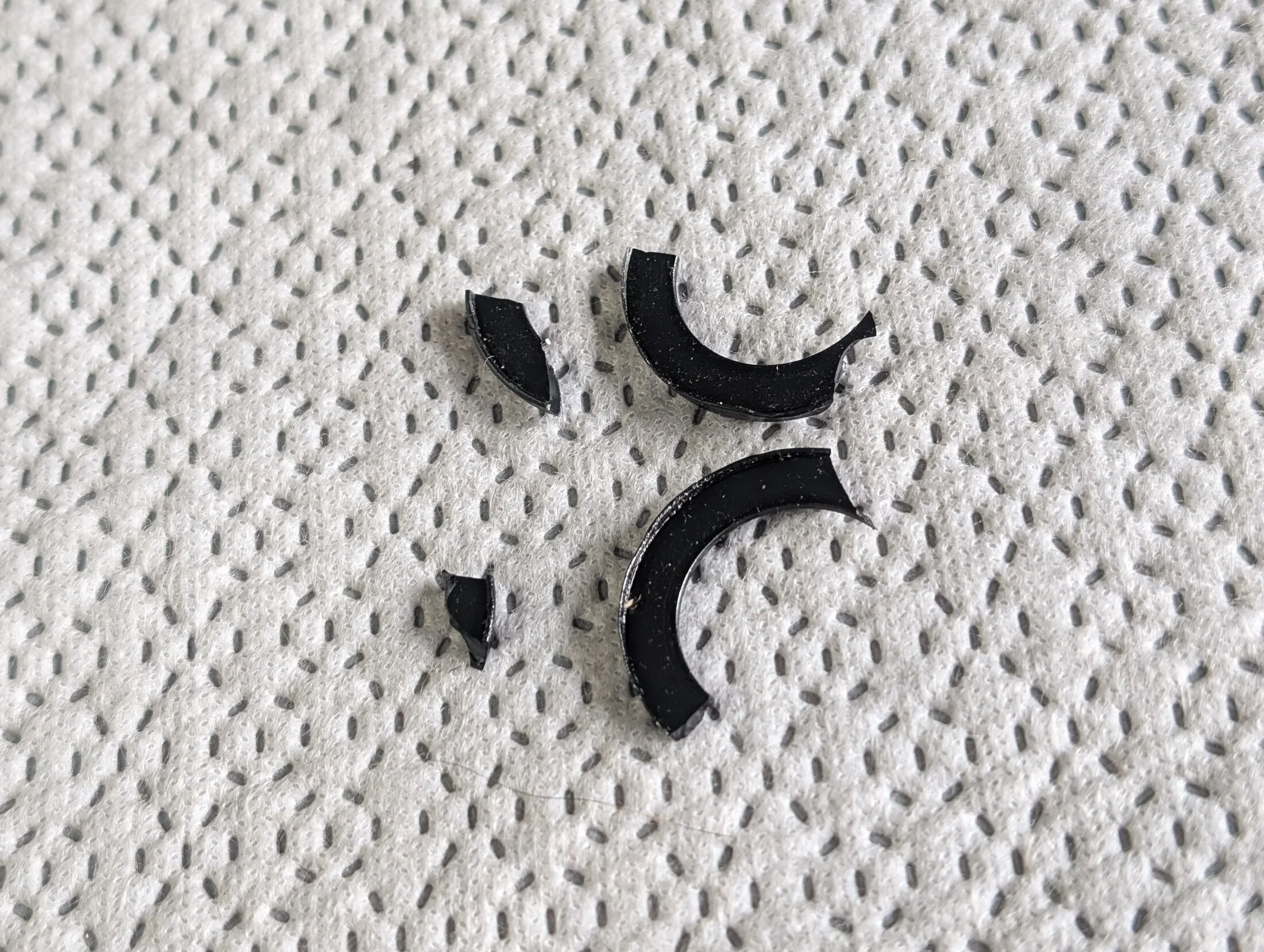

Installed a new oil level sender gasket. Old one was brittle and had to chip it out

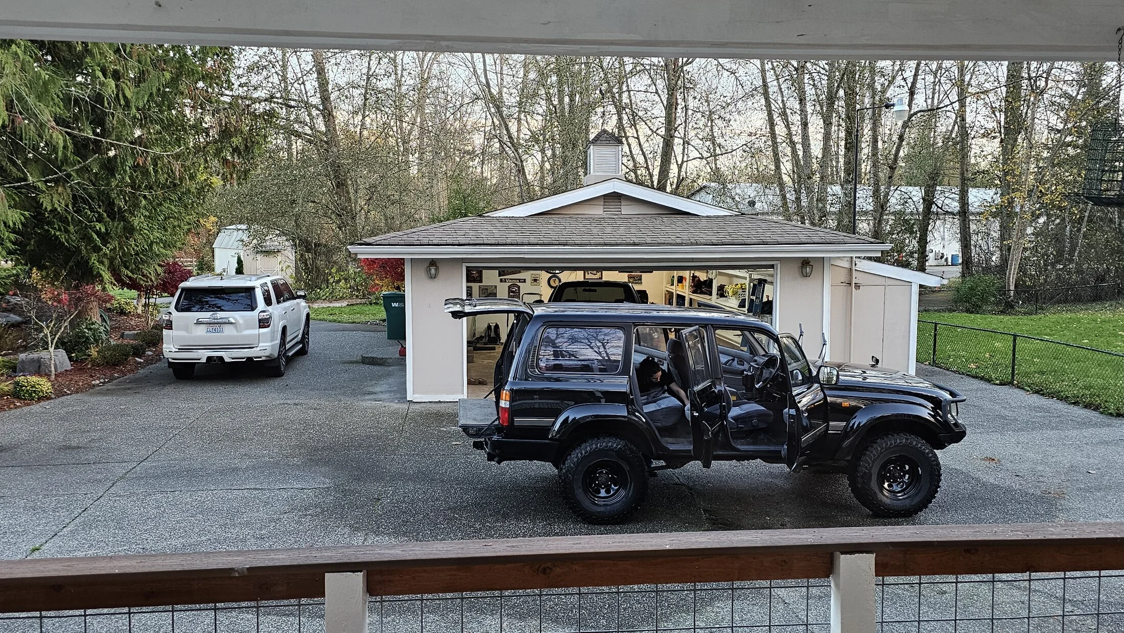

I watched my daughter wash it

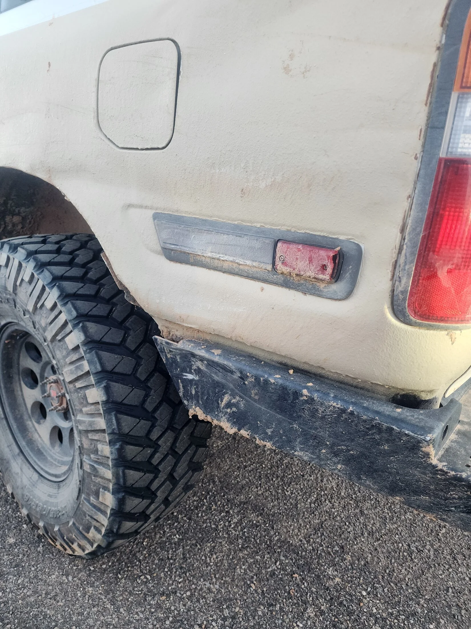

Took a Dodge ram to the rear quarter panel and slee bumper today.
Thinking the damage is pretty minimal.
Initial observations: Bumper is a bit pushed in, gas tank door doesn't open, marker light is busted, turn signal has some cracks that were not there before, and the steering wheel is slightly off center now.
I will take it to a few shops for a good inspection, frame measurement, and quotes.

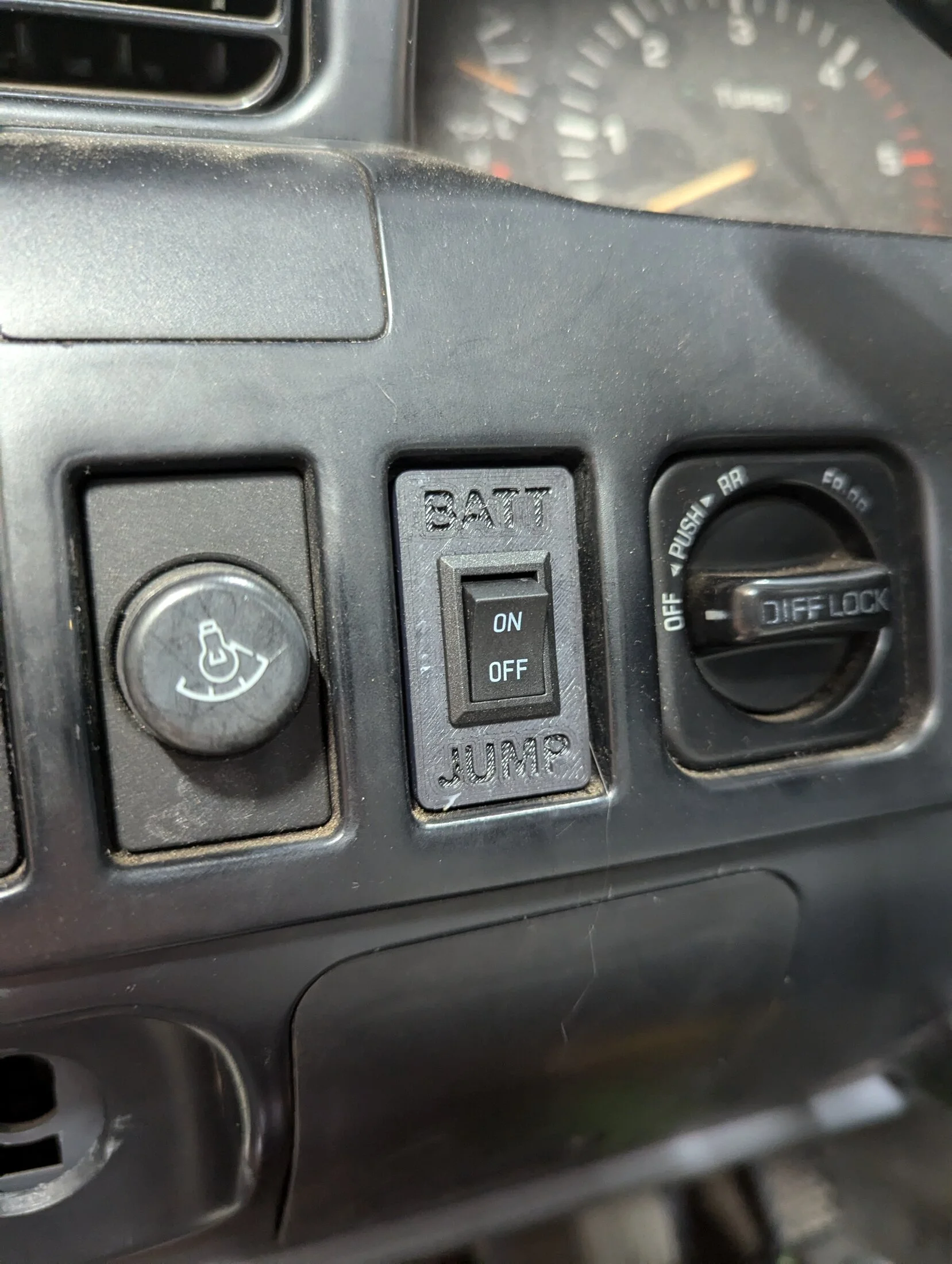

Small but mighty, finally made and installed a battery jump switch to trigger my red arc automatic battery separator. This forces the batteries together and allows the battery maintainer to charge both start and house battery on my 1hdt
Love that. My Red Arc kit just arrived today.
Did you make the switch bezel/cover yourself with the engraved wording? Or is that something you can buy?
