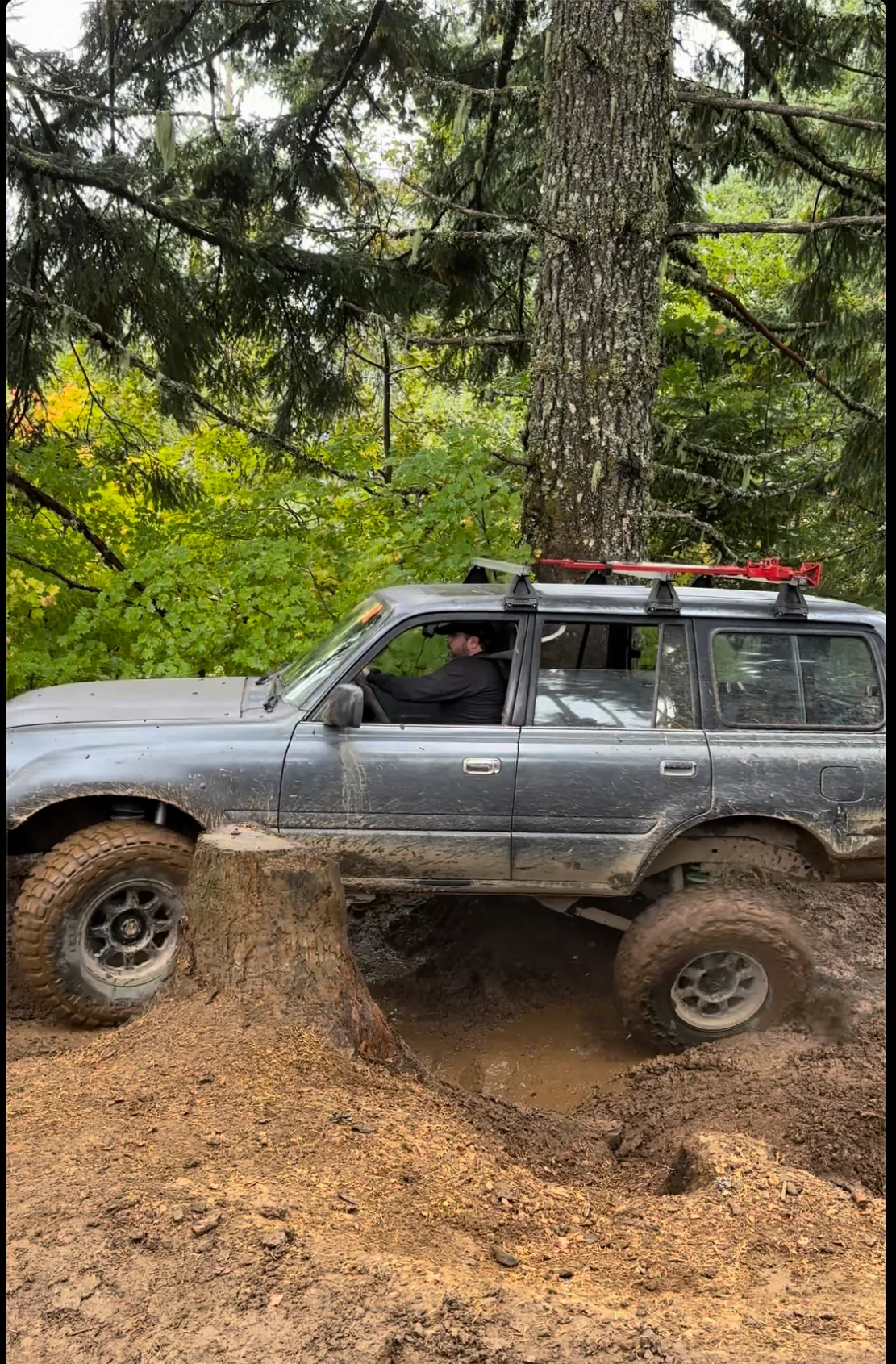

Took it fishing!

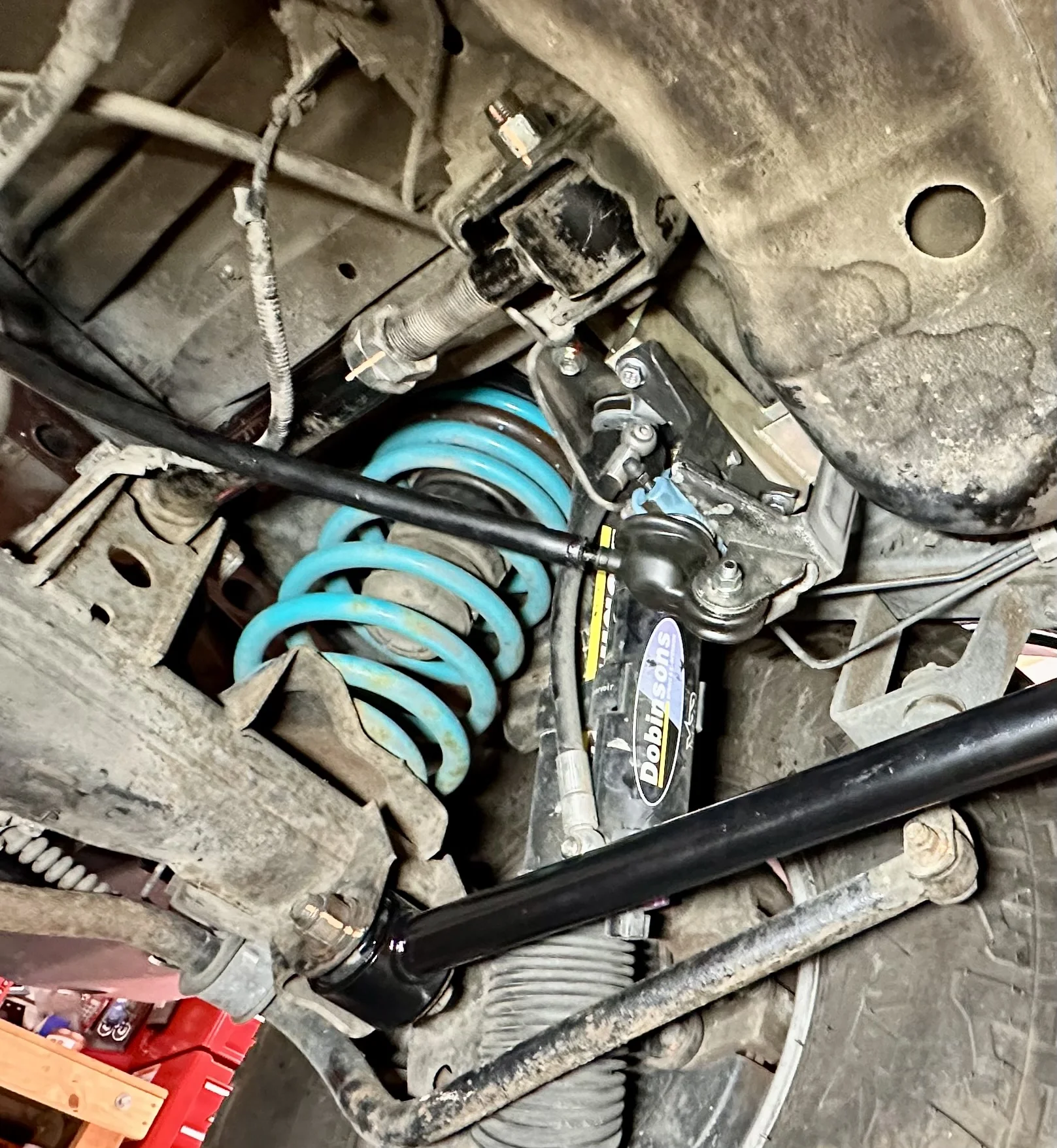

Repainted then reinstalled stock LCA because my lift is now under 2” so Landtank extended arms no longer needed. Will be for sale in classifieds.
Adjusted the UCA to get t/case flange and diff flange within 1 degree.
Was fun afternoon under my truck wrestling control arms!

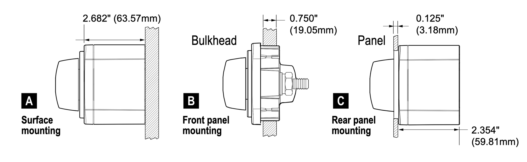

Also, what about installing this Blue Sea switch? Has anyone installed one, and if so how did you mount it? This particular one has three options surface, front panel or rear panel mounted.
Blue Sea m-Series On Off Switch

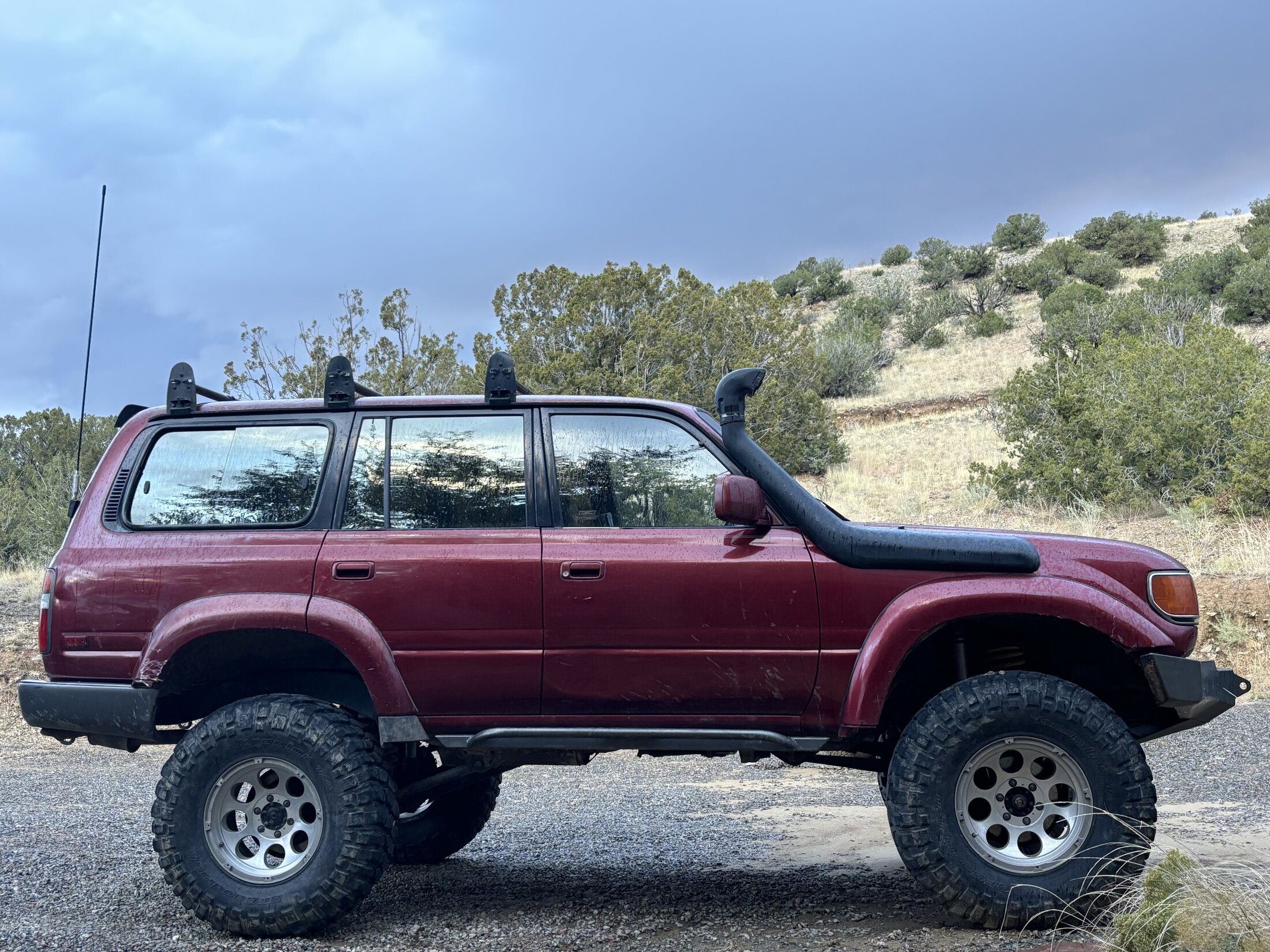

Sat on the porch, watched the rains kiss my 80, smoked 1/2 a J and enjoyed admiring my new rig, Betty, while dreaming of what adventures she’ll take us on and which rear bumper to get…
Tomorrow I go mud bogging as we have had lots of slow steady rain and I have miles of dirt roads to travel on to get home!

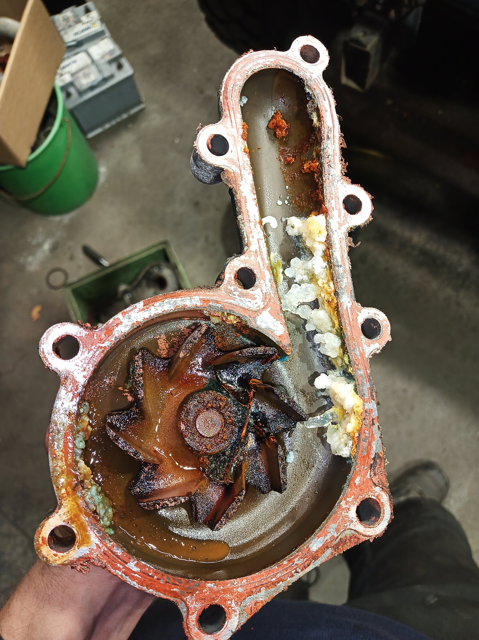

That's what happens if the PO used the wrong coolant before parking the truck for 5 years.
So new waterpump, thermostat, radiator etc. I really hope the heater core survived.
This is why I only ever use the genuine LLC and sing its praises.
My Water pump below when the bearing started screeching just short of 1/2 a million kilometers
Switch on the positive to the winch. Added a 300 amp Blue Sea fuse as well.
That is a great place to install it. I was thinking along the fender liner behind the battery box but I would have to get more cable to wire it up.

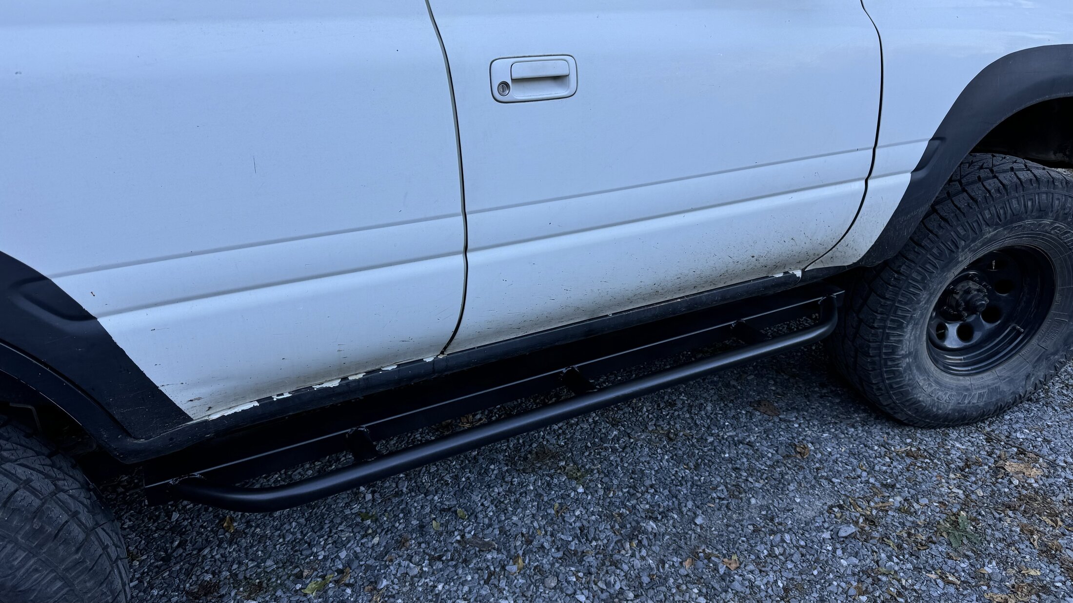

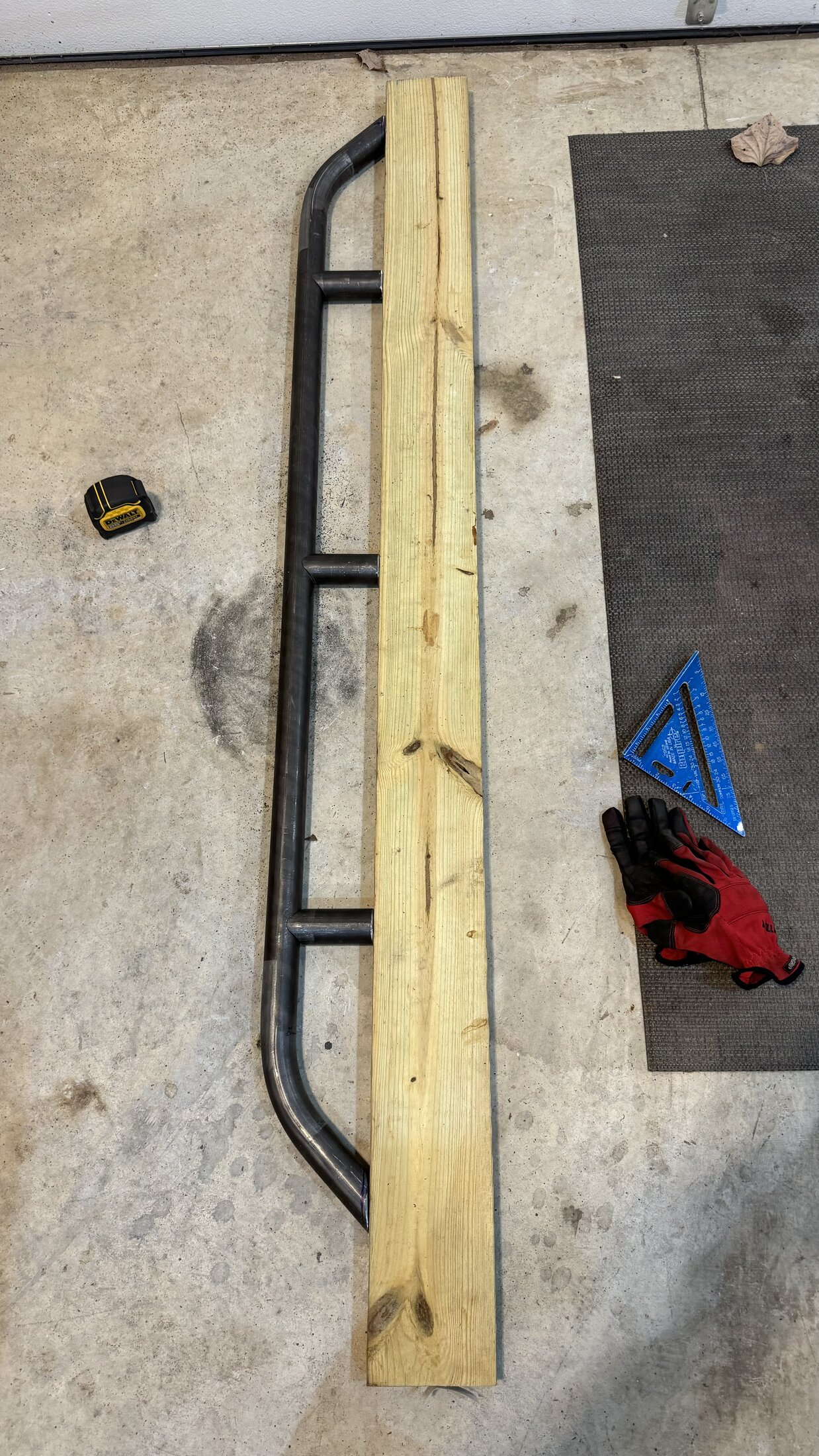

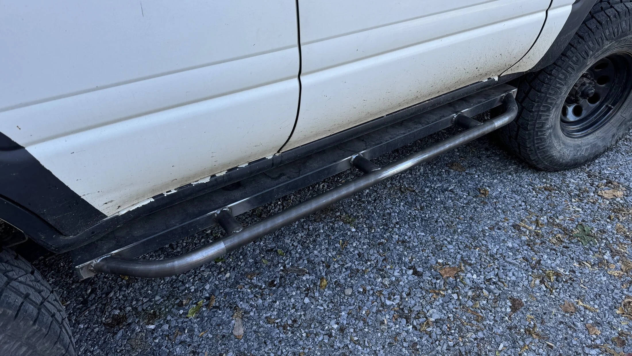

Kudos on welding those steps to the 2x4s. That’s a first for me😂😂😂😉. Nice job. They look great.
Thanks, honestly the biggest inspiration for them was to help my wife get into the rig lol. I suspect they’ll have some functional use on the trails too!

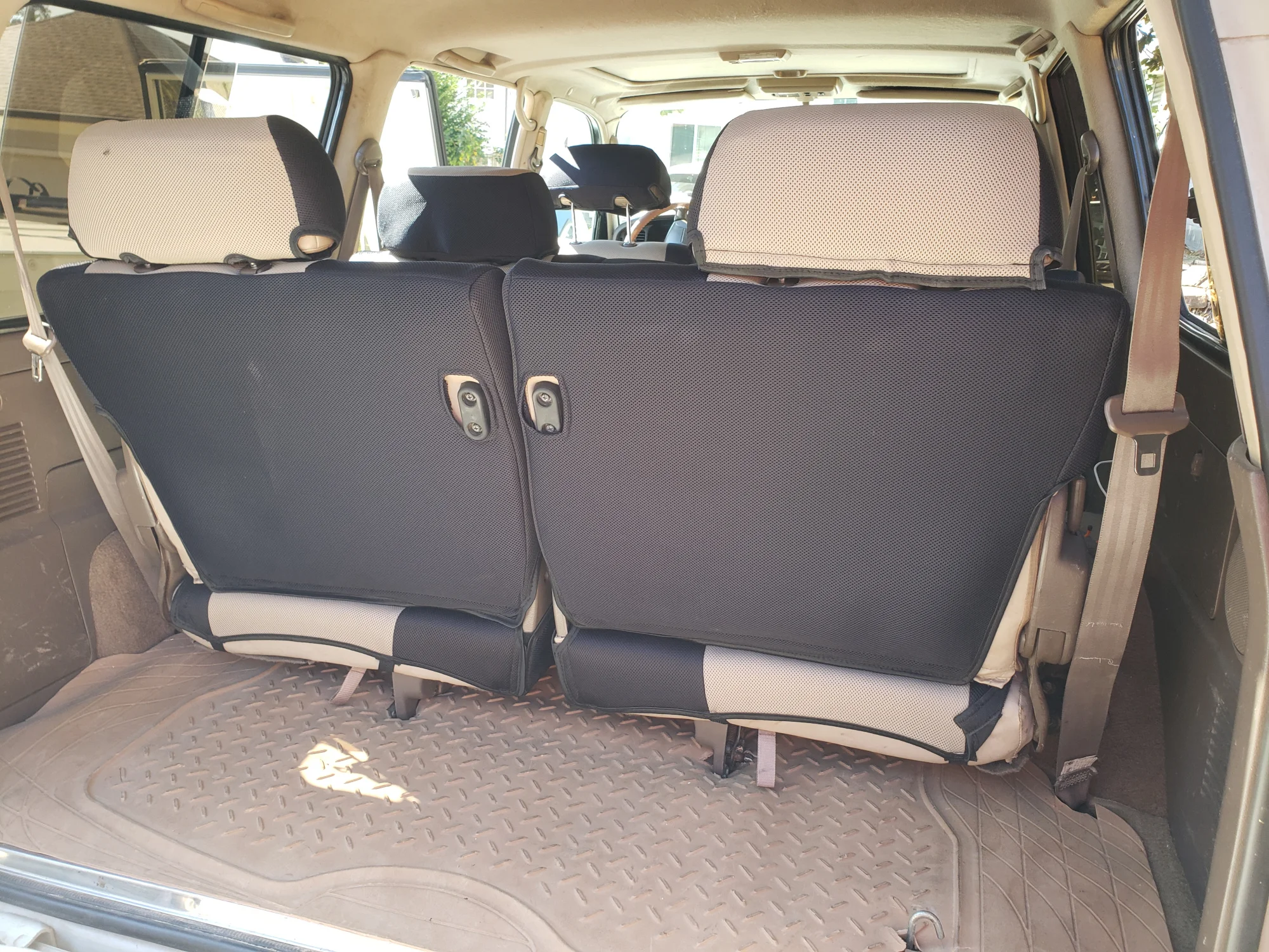

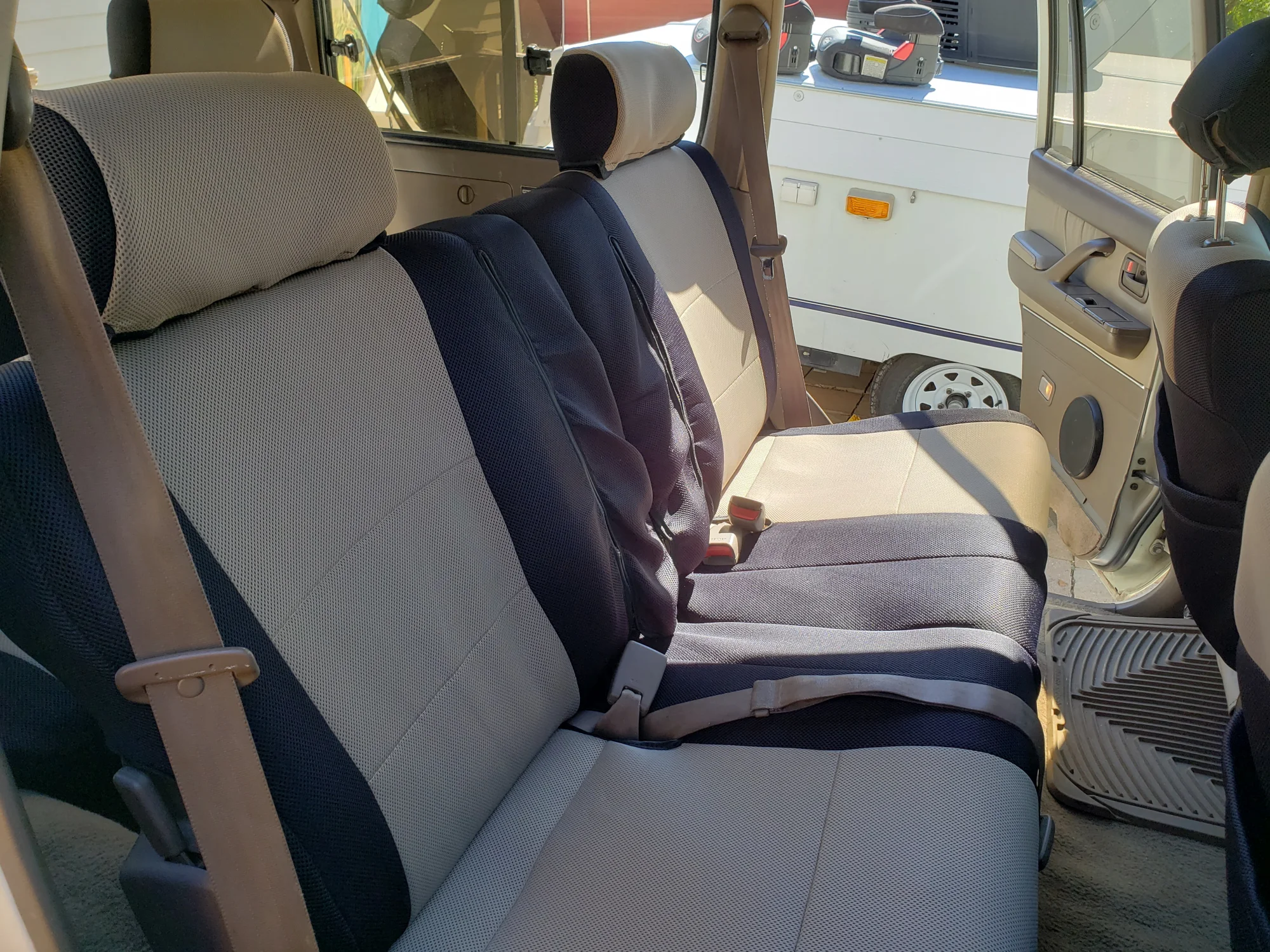

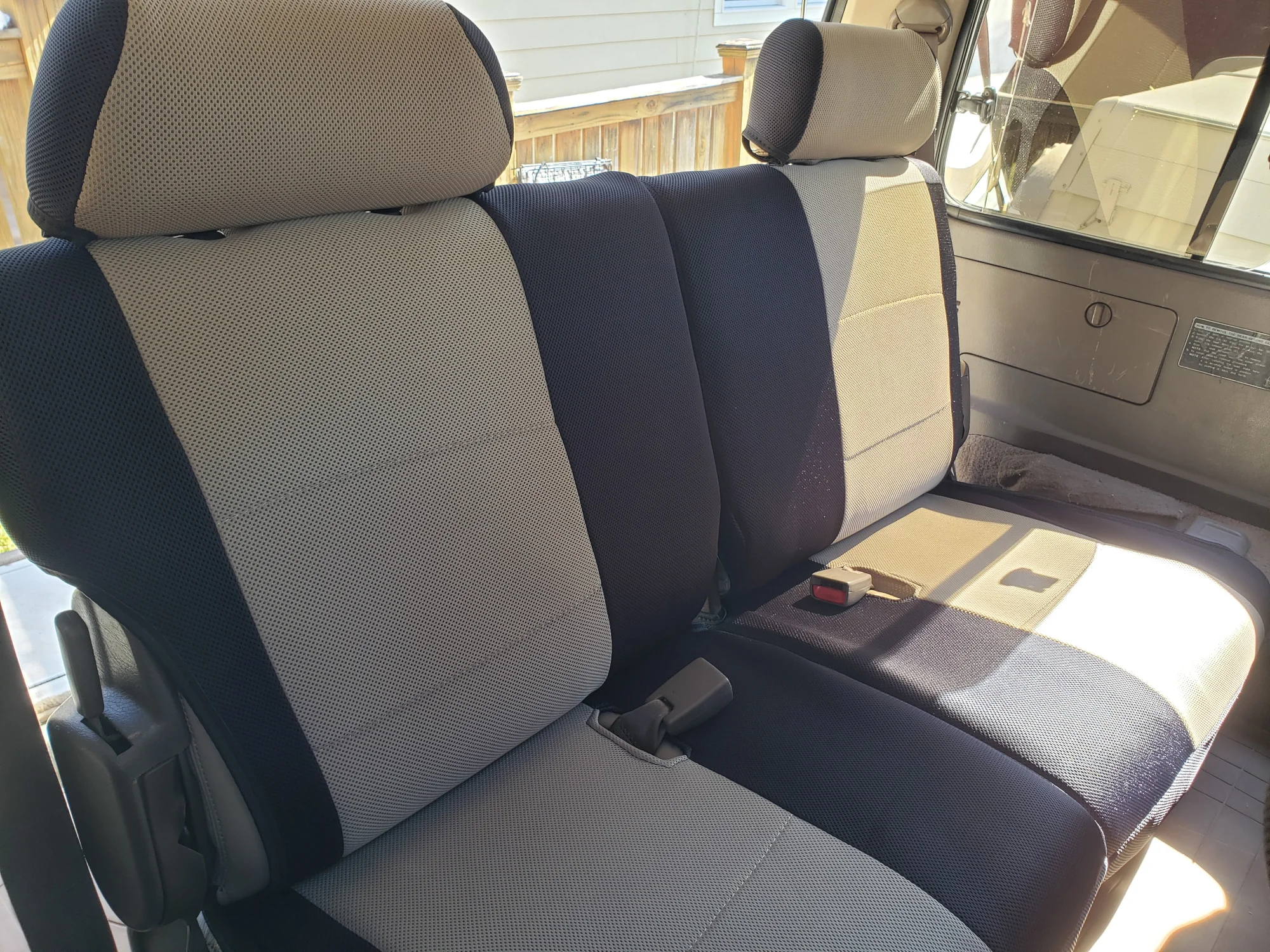

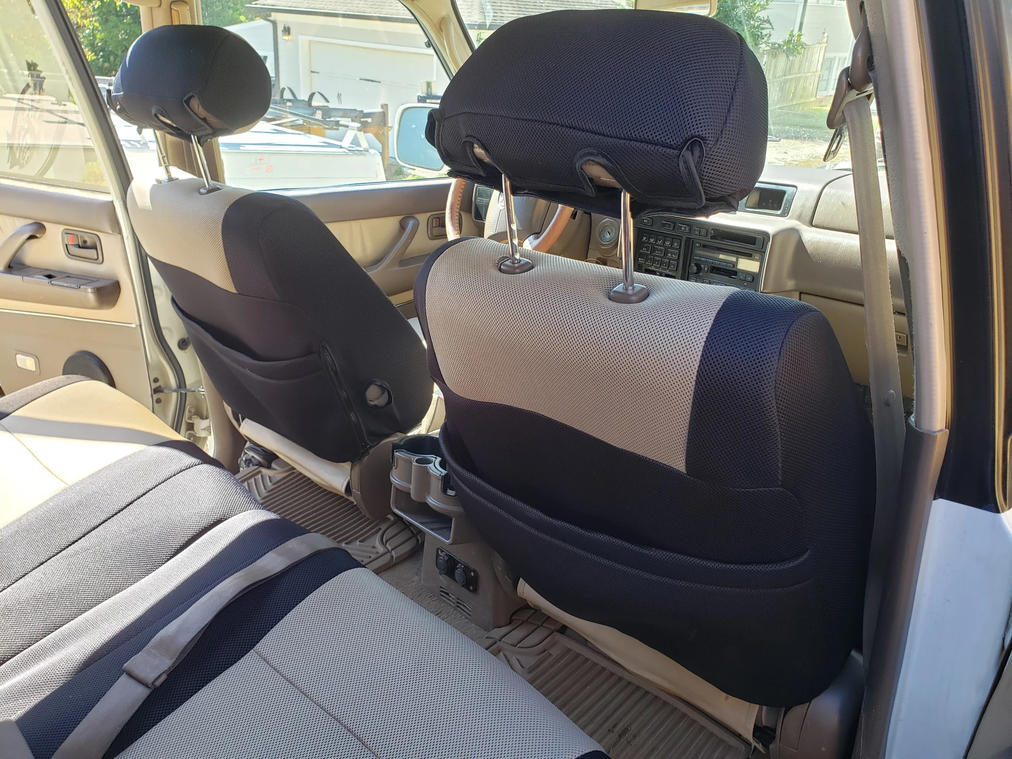

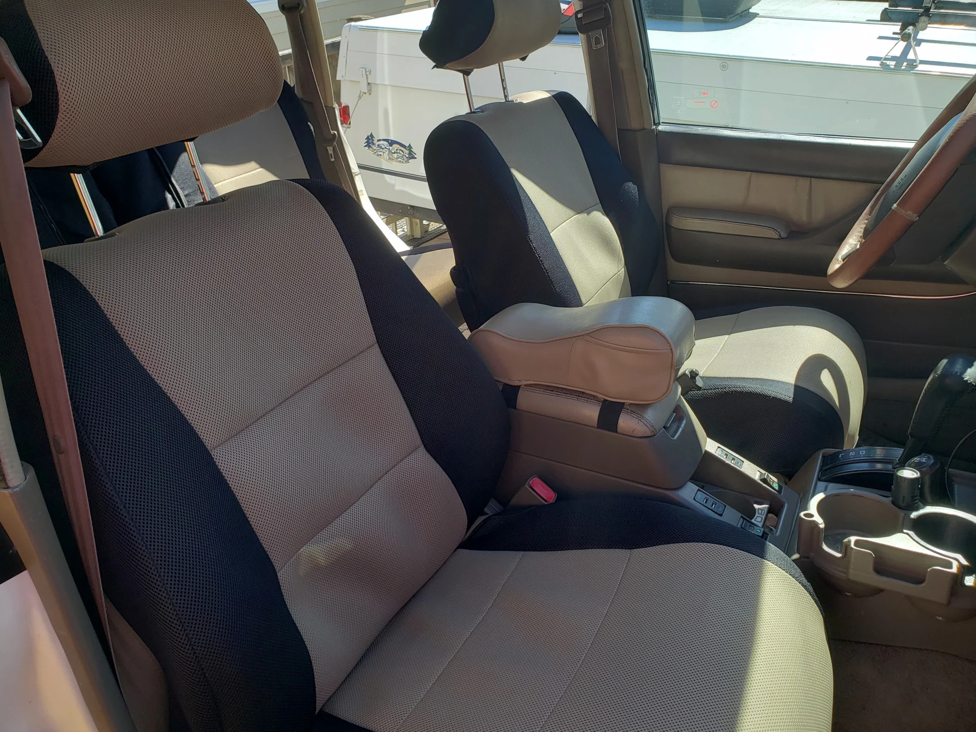

Installed CoverKing Velocivent seatcovers on all three rows of my '97 FZJ80. Took about 10 minutes or less per seat with the 1st row being the most involved to install. Fit is good and they don't slide around much at this point thanks to a layer of the perforated foam sheeting added on the bottoms (the stuff that is sometimes used to stop rugs from slipping on wood flooring). I need to dial in the fit a little more in a few areas but am happy with them after the quick initial fit and a few drives. I'll share an update in a year or two after young kids, large dog and various road trips have exposed the weaknesses in these seat covers.
Price all in was just over $300, ordered from Costco. The Velocivent material is the least expensive and also is supposed to be a little cooler than the other options, which is the main reason I chose it.
