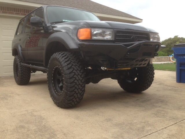

Phil,
EDIT; shown in this thread might be the production version... Looks slightly different from what I describe below.
I've seen this bumper on Lukes rig in person. From what I recall the only way to get this bumper any further back is to cut the horns on the frame rail it's self... The frame is the furthest point out wards... I think Luke dropped some small lights into the horns just to fill the hollow void.
-Matt
Shown here:
Just discussing, no hate....Im a Luke supporter and love new products and designs!
Looks like I have the same set of pics. Sticking an 8274 in front of the grill pushes the front out a min of 10" in front of the grill, using Warns published specs. For comparison the fairleed of my Modded Slee is 7" from the grill although much lower. A drum style winch (maybe the production model) could reduce that a couple precious inches.

I've seen them in person and it's not as extreme as it seems in pics. I have the non-8274 version so I just need it to clear my Runva 12k. I can also position the stinger in whatever position I want. I don't see it affecting approach angle unless you're trying to climb a vertical wall.
Here's another angle (credit to @Bimrunner)
