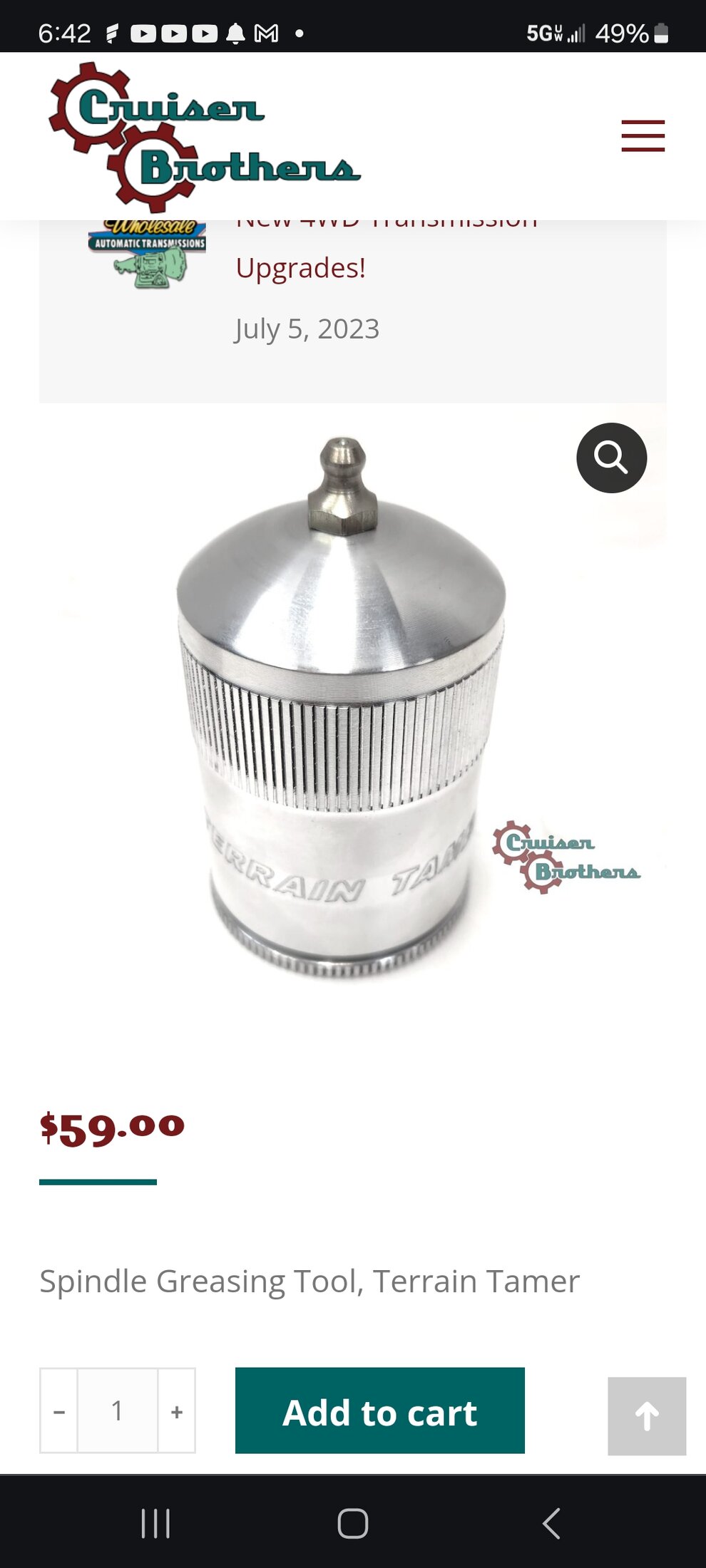

That is awesome. Thanks much. Does it end up greasing the spindle too like the terrain tamer version?

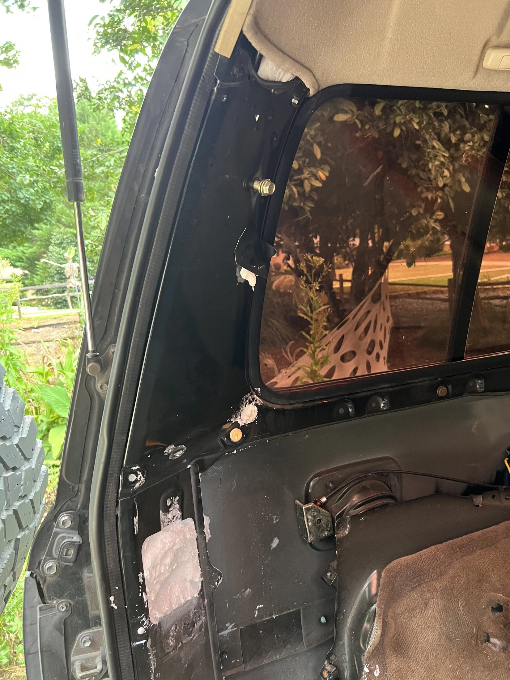

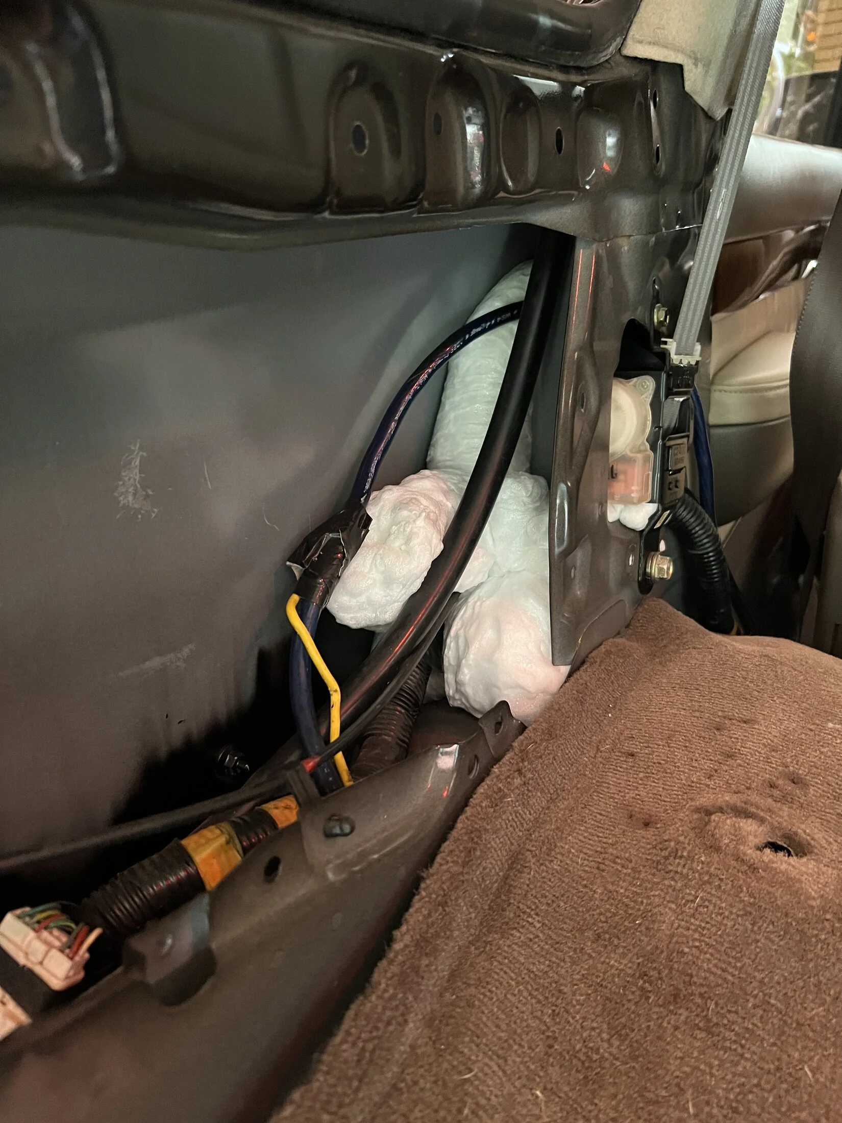

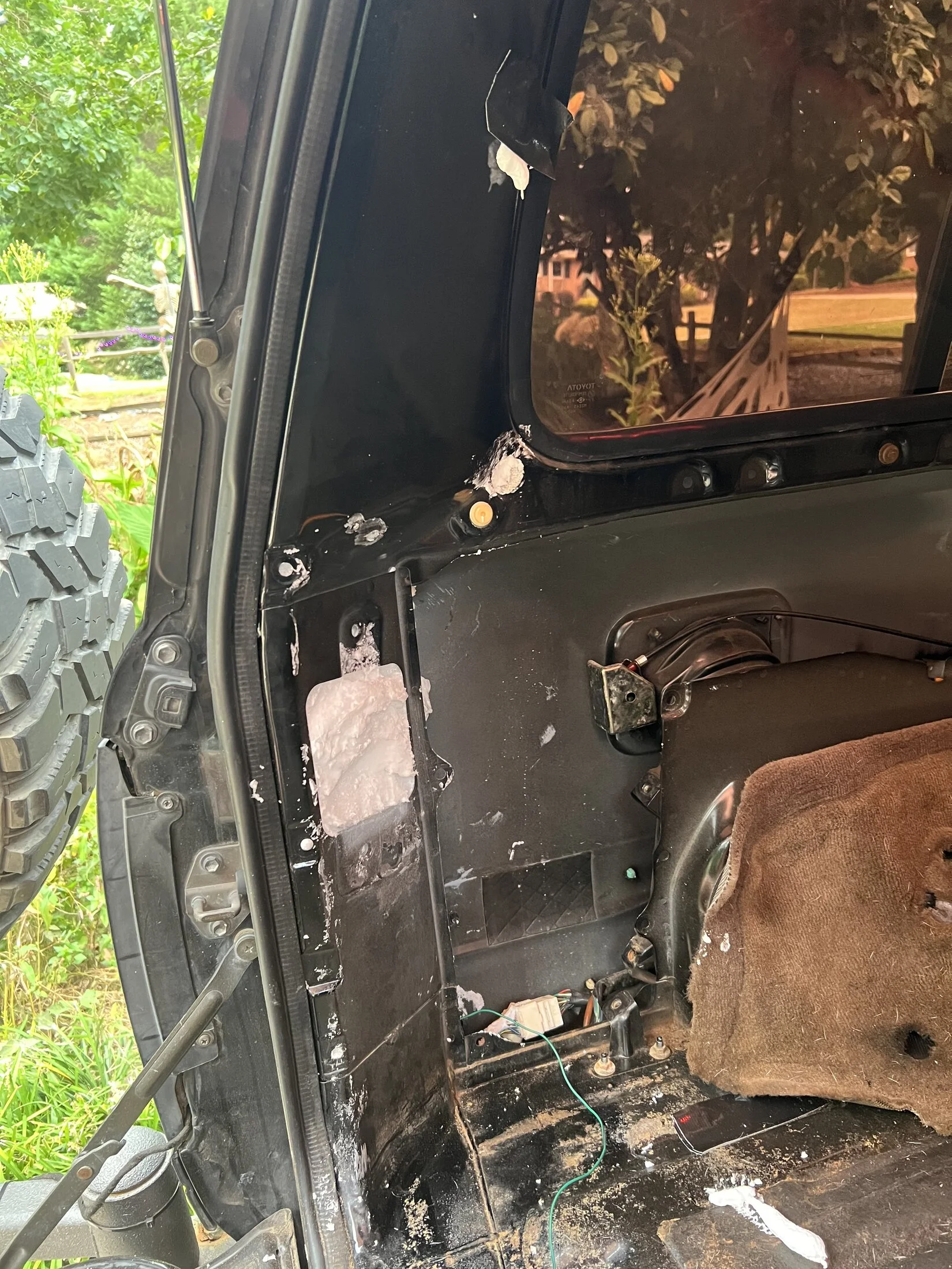

Going down the rabbit hole of sound! I’ve done just the mat with a foam layer on my last 2 cruisers on this one I’m going to try something different. I’m filling the giant echo chambers that the cruiser has stating with the rockers and above the rear fender and the rear pillar. It has actually made a pretty big difference with the old knuckle test. I did notice less tire noise this morning on the way to work. Make sure to take the seat belt out and wrap a bag around them

Wouldn't that trap moisture?

Is that expandable foam? If so, I would keep a close watch on water intrusion. The sliding window frames and rear vents are a known source for water pooling in the quarter panels. The foam may trap moisture causing rust and carpet mold.

It could but I have went threw and sealed the holes on the bottom of the rockers the fender and the pillars shouldn’t have water in them if you do there’s a problem

i still have access to the drains

I’m trying to get to that g wagon status lol I just want it quite for those long trips with 37s there’s a lot of tire noise filling that gap between the out fender and the door jam really did cut down on the tire drown.
