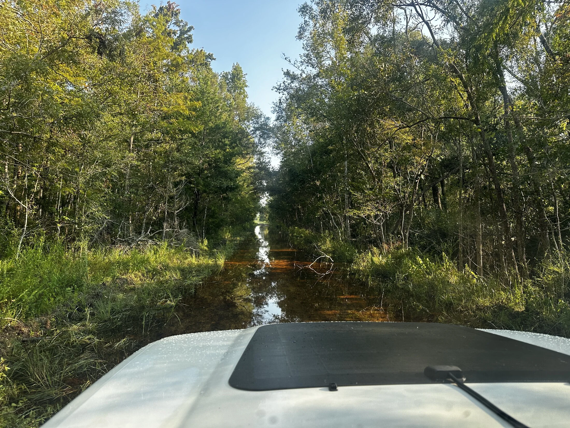

Changed the fluids in the axles and an oil change after driving through this last week
It’s a property I manage which just happens to be about 8’ asl and was where hurricane Debby made landfall last week…
There were instances where I was hood deep in water and I’m all alone out here…not fun…don’t recommend…
So I had to change all fluids and purge any water intrusion from driveshafts etc…
All good…truck performed perfect…but it’s a lonley part of the state…

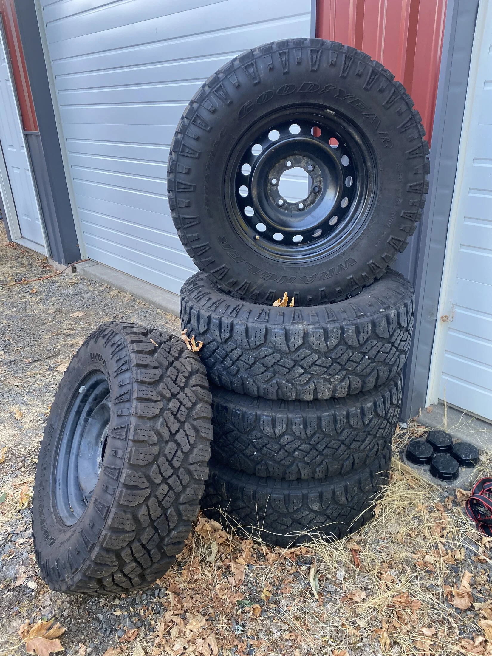

Used it to go get new tires

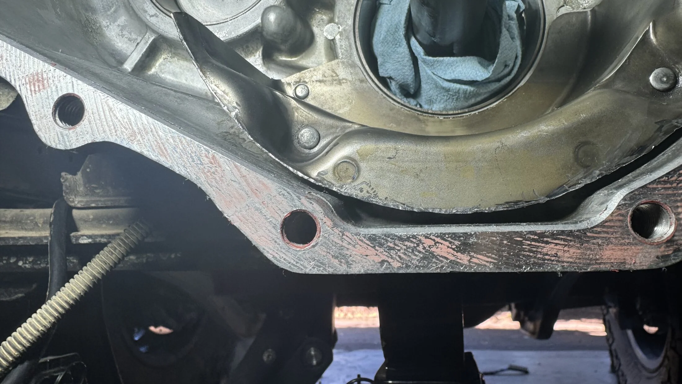

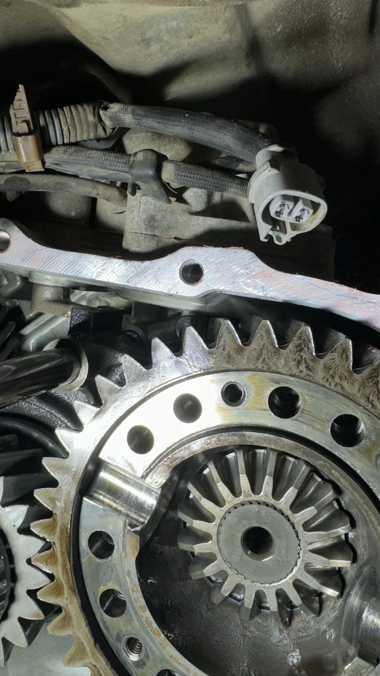

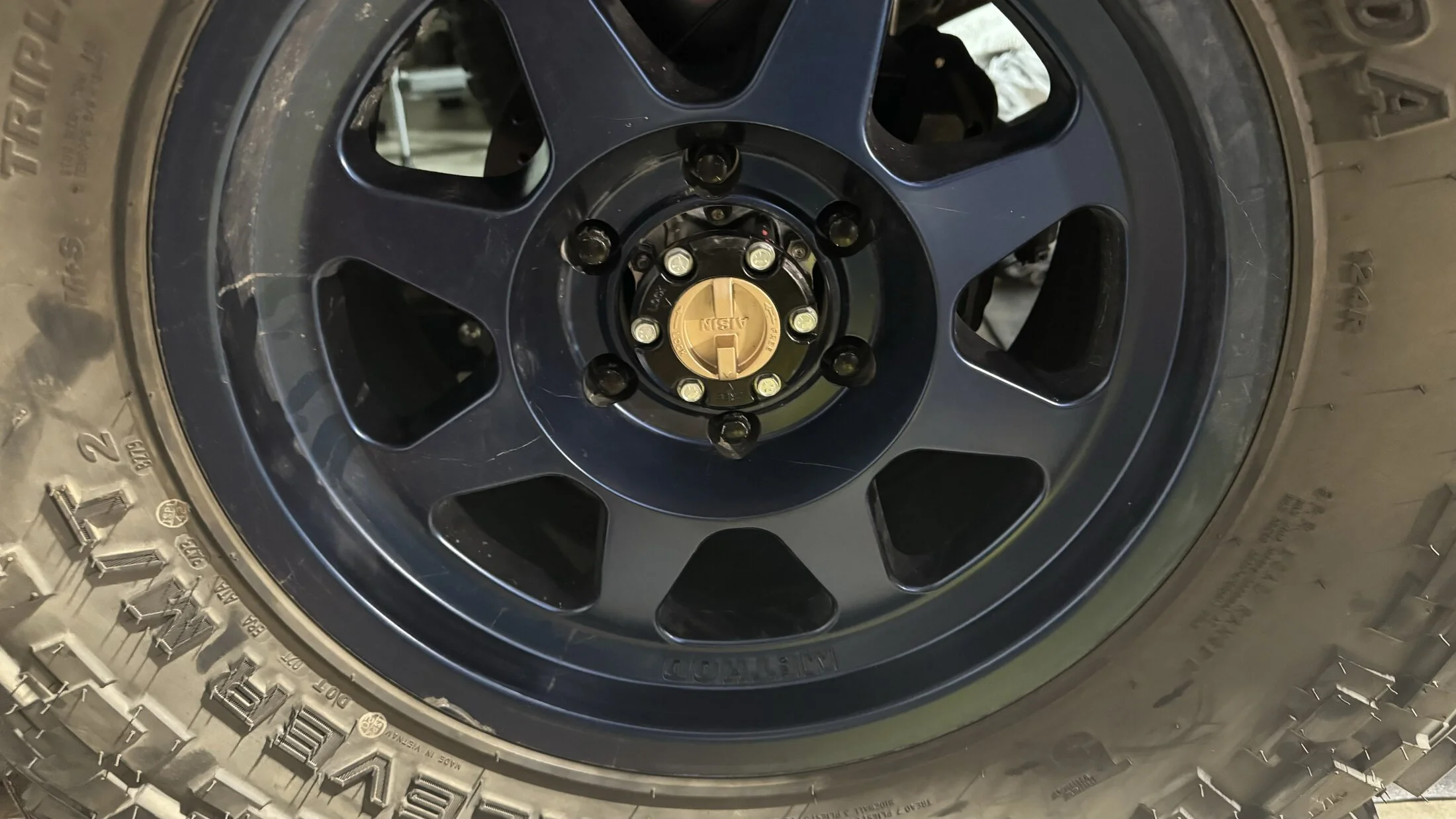

Finished up the low range gearing and part time 4wd kit. For me, clearancing the case was the most nerve wracking part of this install. After the grinder work, I used a red paint marker and did a dry fit, then checked for any issues.
Only had to pull this apart 3 times
1st time forgot the shims
2nd time dropped the detent ball and spring into the case where the gear goes (dumb I know) after it was glued together
3rd time was the Goldilocks for me.
We do it right because we do it over and over and over again 😬
After having to take apart one of the hubs due to clutch spring misalignment (it wasn’t turning after install) it went back together and worked fine. The combination of the A440 transmission, 3.1 low range in the t-case with stock 4.11 diff gears is lower than my Tacoma with 5.29’s in the diffs (stock tcase) which is great.
Nice! I'm about to tackle my part time conversion, along with RCV axles and a full knuckle rebuild. The manual hubs look awesome.
I just put in rcv a few months ago and did the knuckle rebuild. When I put these hubs on I noticed some gear oil in my bells, so I’m pulling em apart again… all this to say, be very very careful with those axle seals, it’s the most irritating thing to have to replace

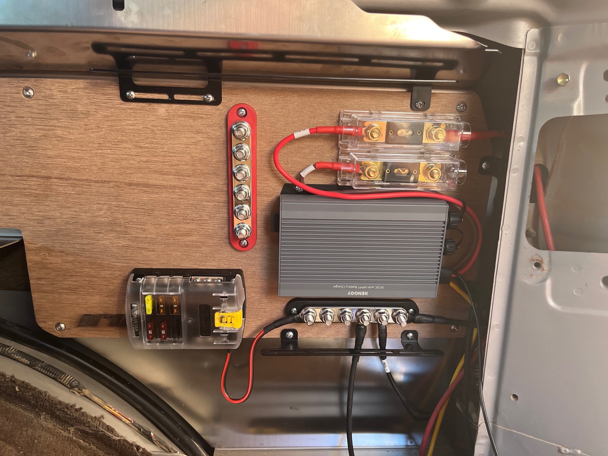

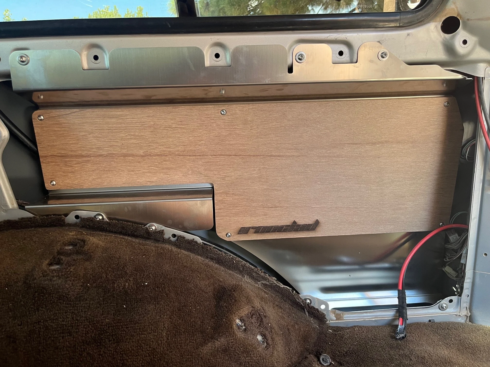

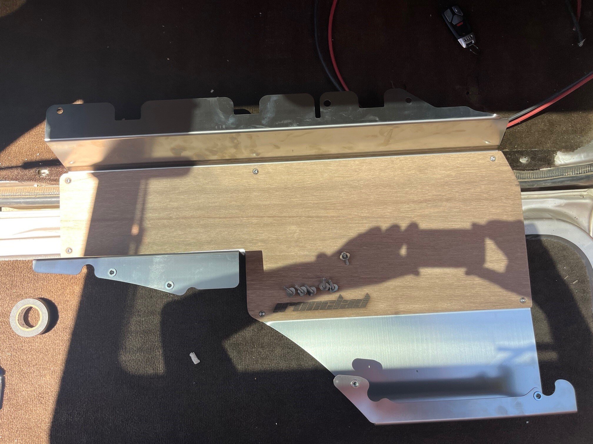

Installed the Ironclad Engineering rear quarter panel bracket for the 80 Series LC and got started on installing my auxillary battery and accessory power distribution.
Ordering from Brad at Ironclad was a great experience. Pricing is in AUD. He was quick to contact me with the production/shipping timelines and was right on the money. I received the bracket (shipped Australia to New Mexico) in just over 3 weeks.
I prepped by pulling the rear quarter panel trim and could not believe how much dirt was in the quarter panel. There was easily an inch or two of dirt down in the bottom. I wasn't intending to install quite yet, but the bracket slipped right it so I decided to go ahead and bolt everything down.
I had the bracket installed in less than 5 minutes. Later in the weekend I started all of my electrical install. That's still a work in progress.

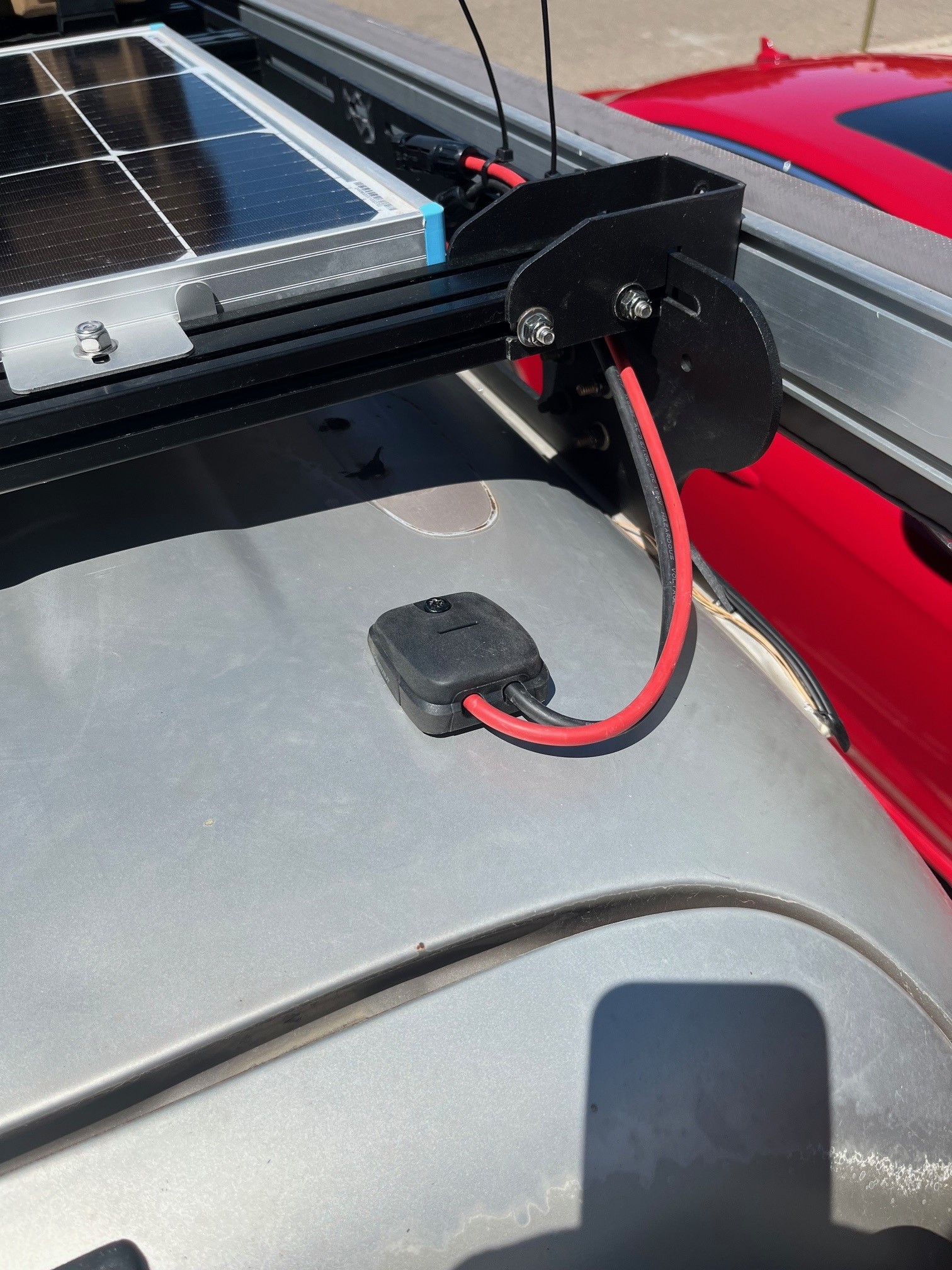

I was also really happy with the Scanstrut roof entry I used for the PV leads. The roof entry is IP68 waterproof. The material feels high quality and fits together very well. The kit also comes with a drill template. I used a fish tape to run the leads down through the hole and into the C pillar down to where my charger contoller sits in the rear quarter panel.
What screws did you use for the scanstrut? I know it comes with wood screws as it's intended design is for boats. Did you pull the headliner back to access the bolt screw combo?
I used some self tapping metal screws. I think they were #6. No nut/bolt. I'll keep an eye on it, but the screws seem to hold pretty well. They do recommend a bolt/nut for metal surfaces, but getting that headliner pulled back there is a pain.
