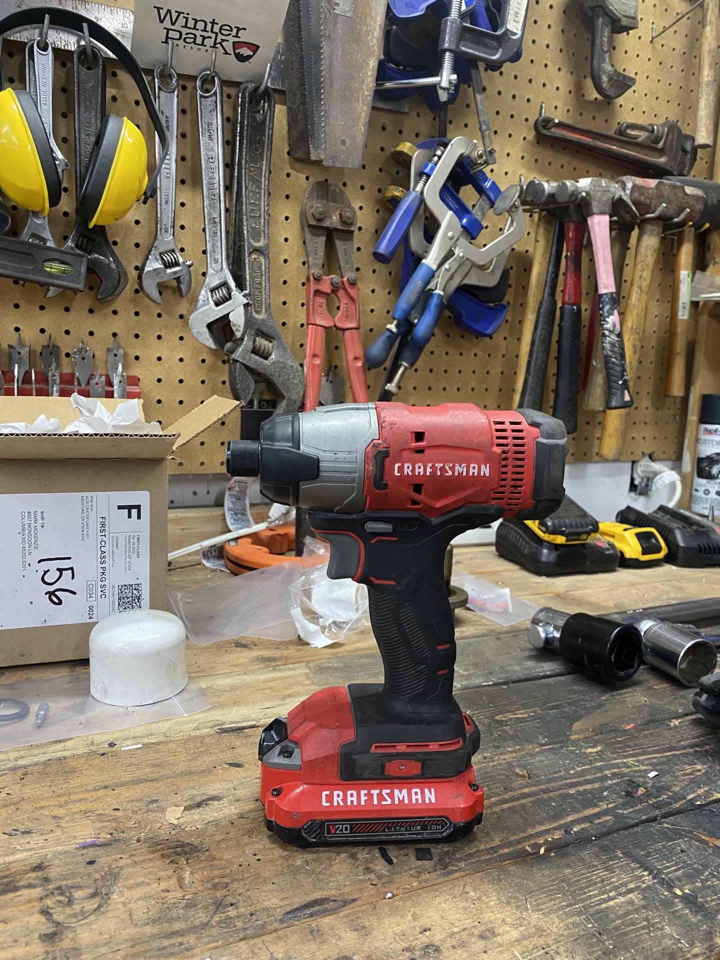

Oil pump cover seal and crank seal installed. This is the 2nd 80 series I’ve owned and the 2nd one I’ve done this on and this time I used my little cordless impact driver for the oil pump cover screws. Wow what a difference that makes. They pop right out versus using a ratchet. I did use the #3 JIS bits.

I bought that exact screw gun for exactly that job on mine 8 years ago. It worked perfectly.
