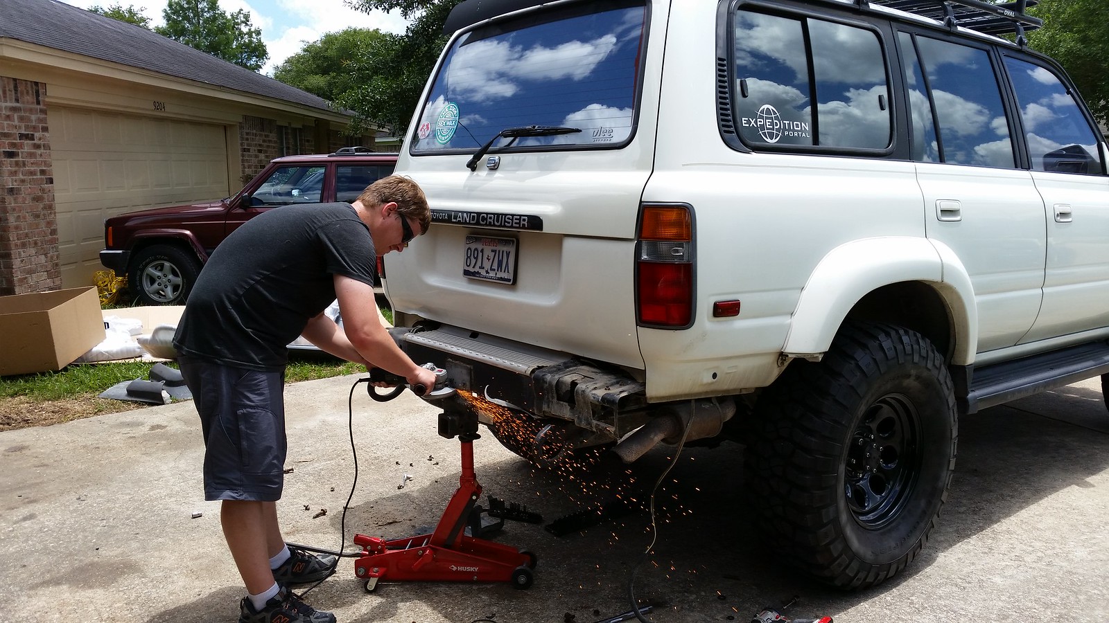

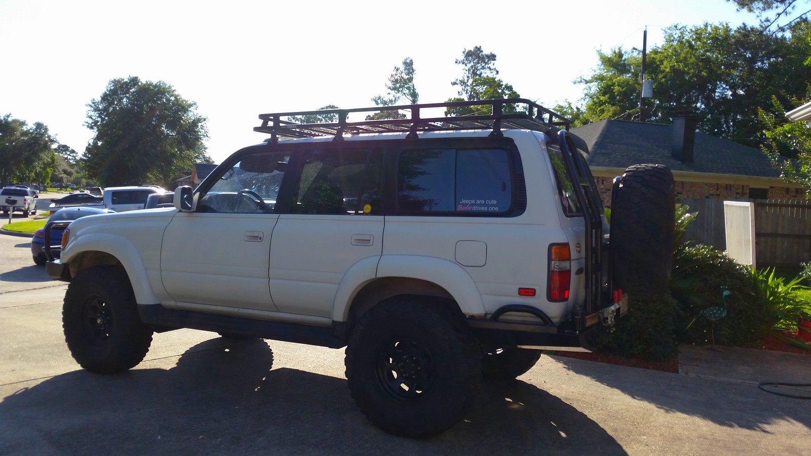

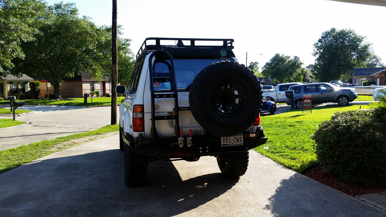

After replacing all the vacuum lines in the engine bay, flushing the coolant, new radiator hoses, clamps, and Toyota red coolant I installed my Slee rear bumper :grinpimp:

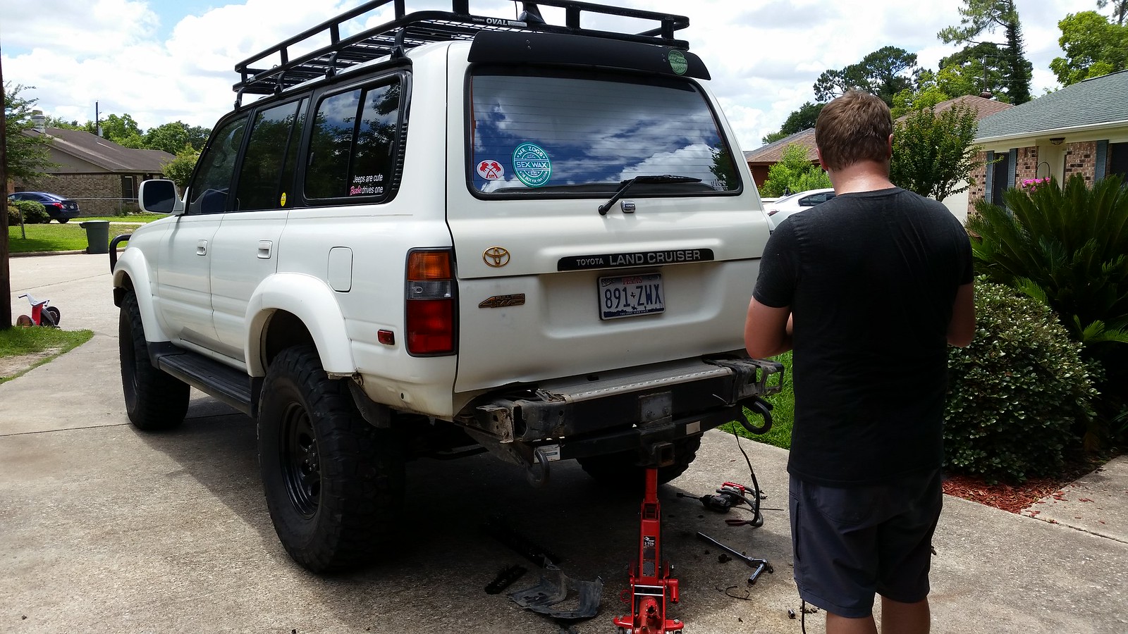

Had to grind off a plate that was welded from the crossmember onto the hitch!

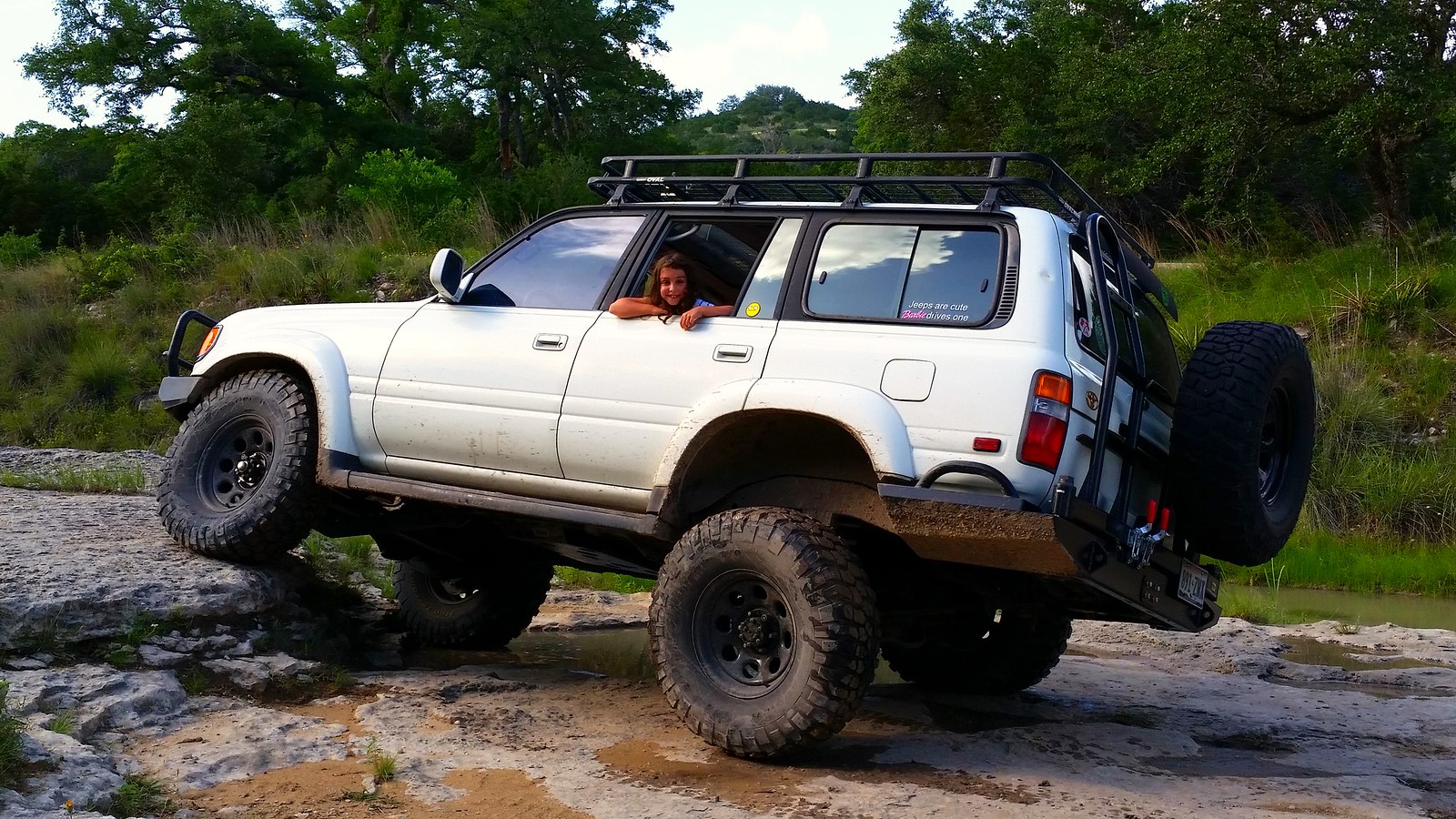

And then went to Hidden Falls to try everything out. :beer:

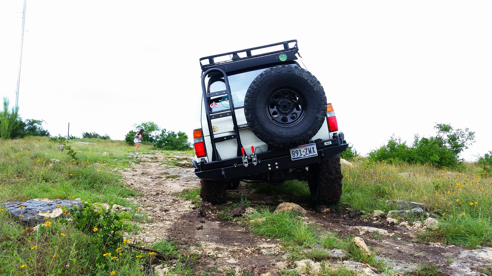

The only thing left to do! I was surprised I didn't hit them at all when we were there. I dropped off some big ledges and was certain at least one of them was going to hit. :p
I'm working this weekend unfortunately. How often do you go wheeling? I need more people to go wheeling with since the couple we usually go with are too busy with their infant to make it out much.
You must have been one of the 20 folks that got a slee is the latest run. I have mine sitting in the garrage waiting to be installed...looks great! How long did the install take you?

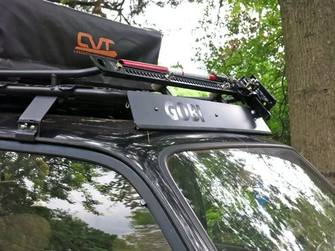

- Made a mount for the hi-lift jack to attach to the Gobi roof rack

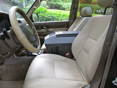

- Installed a second fridge (Dometic CDF-11) which will be used as a freezer. This fits perfectly between the front seats, and as a bonus has two cup holders!
Yeah I called to order one shortly after they ran out and got put on the waiting list. :beer:
It took a while but I also had to grind off a plate that the previous owner had welded on to repair the hitch. 6 hours total from unboxing to closing the swingouts. We had a hell of time getting that damn plate off.
