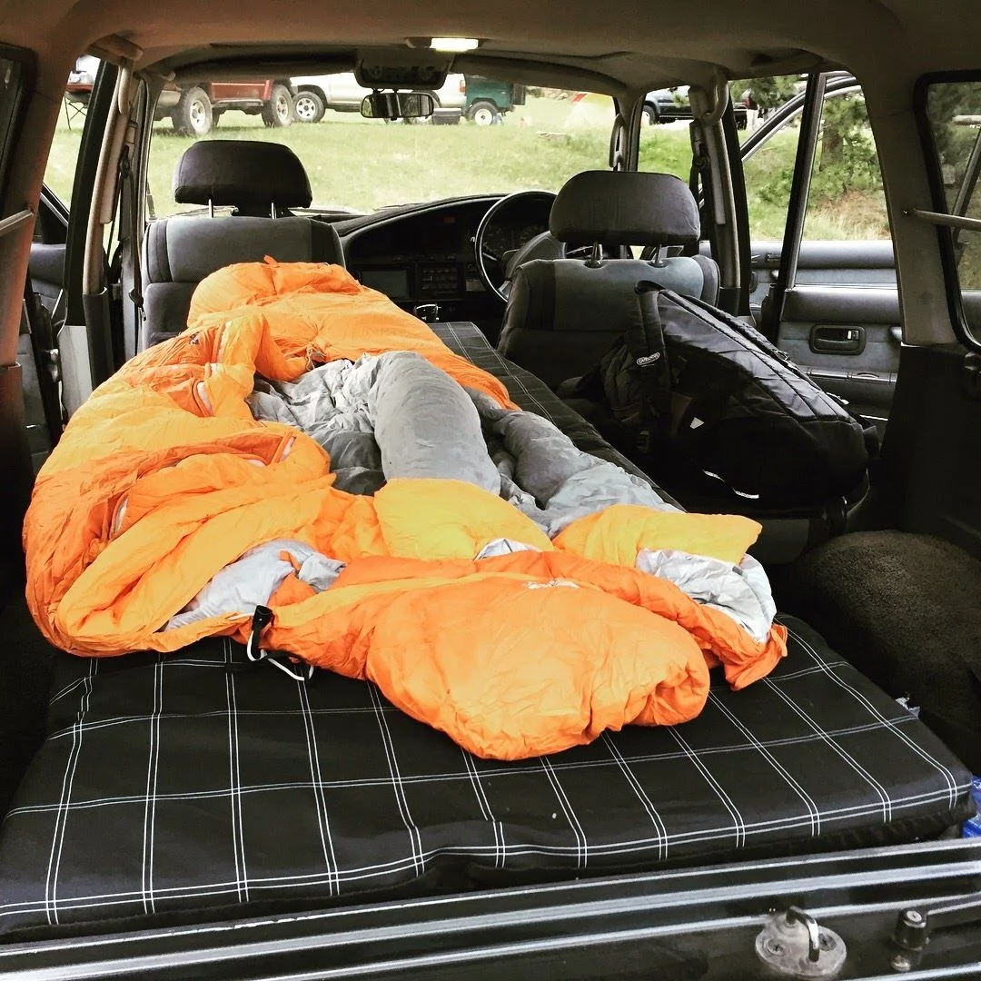

Slept in the 81 for the first time. I used a Coleman cot with one end resting on the folded down second row. I'm pretty happy with the setup as it is easy to remove, takes very little space and is comfortable for me at 6'2". I also got to try the Webasto thermo top for cabin heat. I can start it using keyless entry a couple hours before sleep and come to a nice warm cabin. Probably not the most efficient way to stay warm from a time perspective (since it has to heat the engine block first), but it hardly made a dent in fuel or voltage.

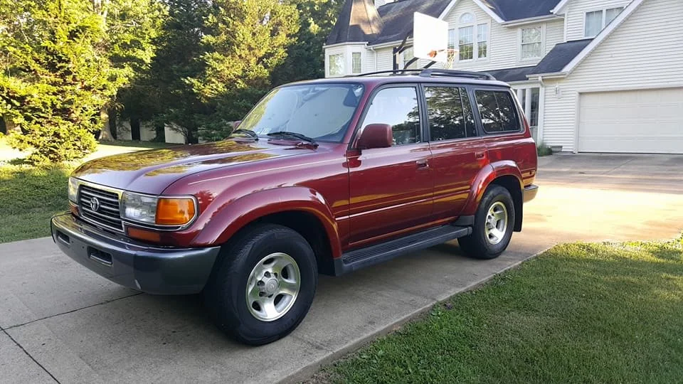

I know.....
I preferred a Dark Green, but this just couldn't be passed up..
Dude! Set your goals higher!! Dark Green is almost as bad as burgundy! (Full disclosure: I own a dark green 93...)

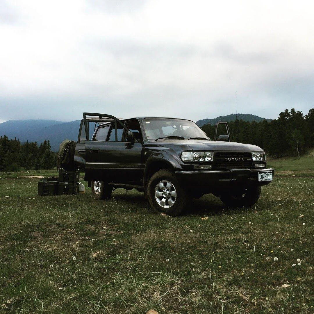

I purchased my 80 on Monday 6/26/2017.
100% Original, 1 owner last 20 years, triple locked and only 168,000 miles.
:bounce::bounce2::clap:
Let the fun of ownership begin.
No, really, that's a GREAT looking truck! Being second owner with low miles to boot! Congratulations!
We ALL have our crosses to bear.......
