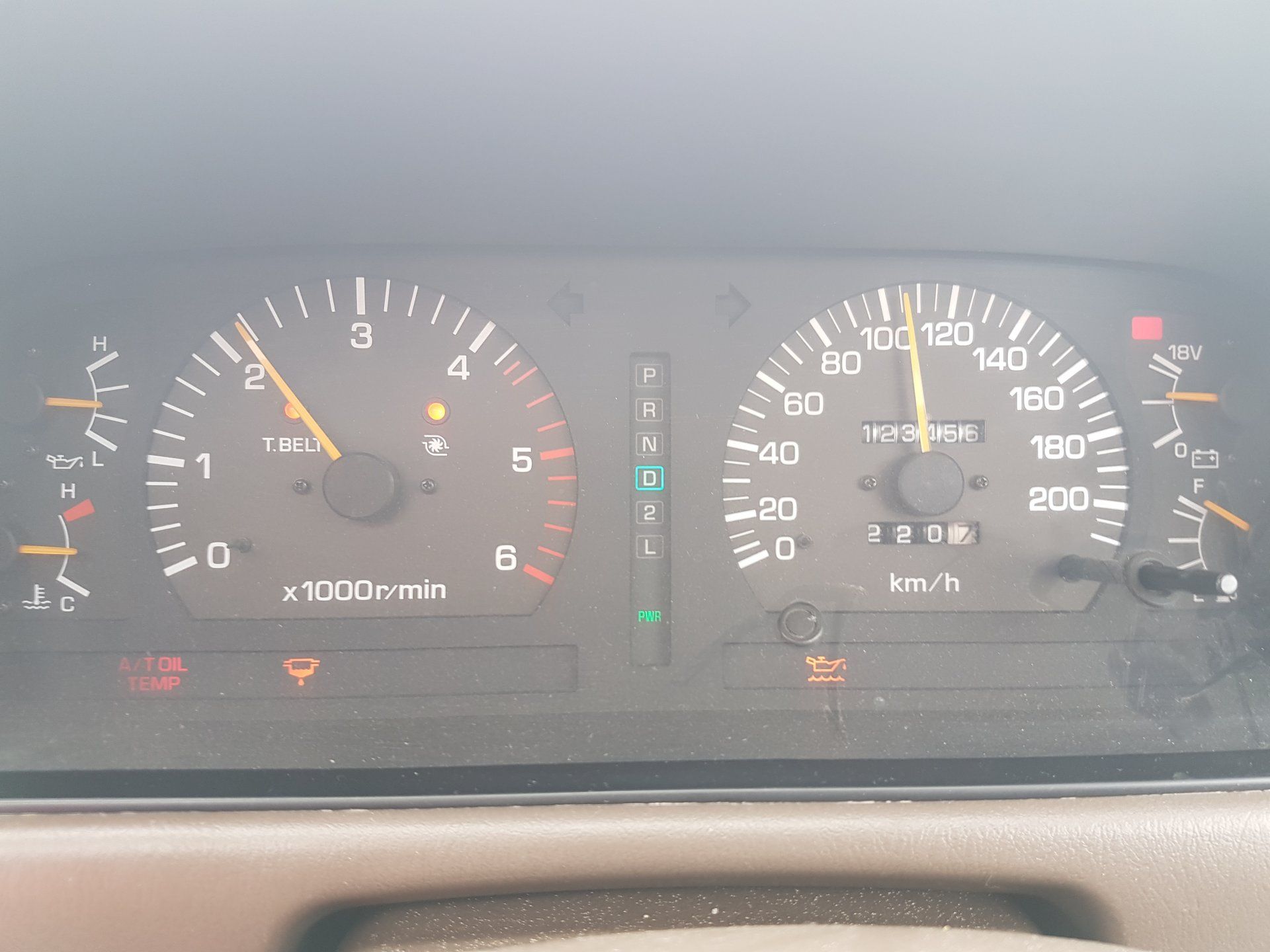

123456kms!
And the truck decides to celebrate by warning me about everything all at once. Pulling a 700kg trailer, but holding steady at around 110kph, egt@800-900f, trans@160f, everything looks great. Trailer was hooked up to 7 pin so i would have been charging up the battery after using it all weekend so alternator maybe? Bad ground? Water in the works (ton of rain all weekend)? Pulled the trailer 12v fuse just in case, and noticed that turn signals cause the voltage to drop temporarily. Good thing the diesel doesn't need spark so the other 150km home went without issue.

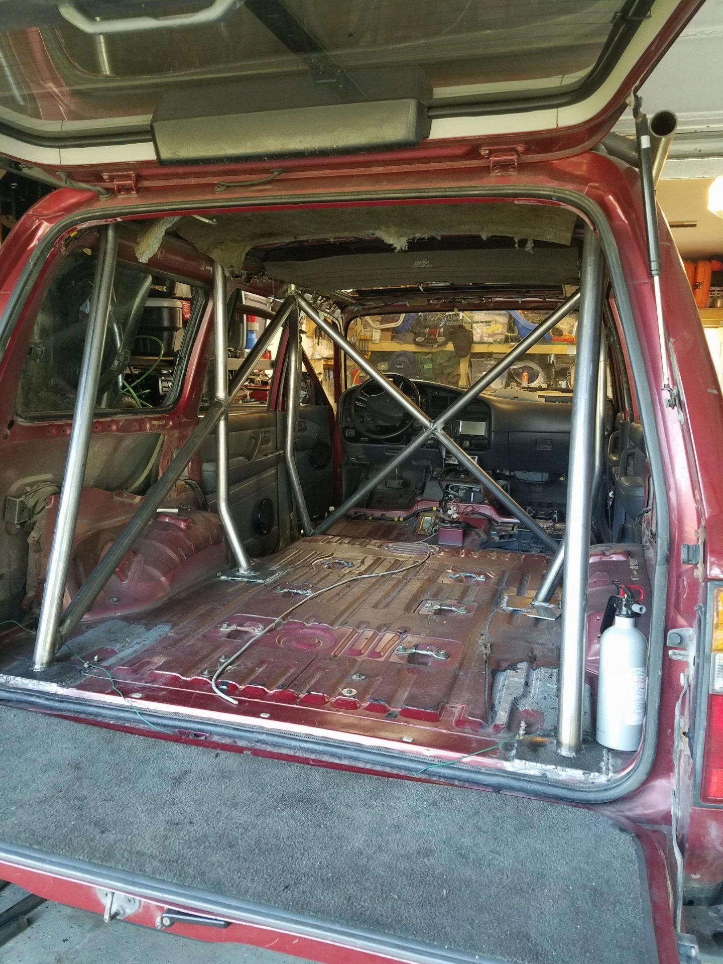

Finished the interior portion of the hybrid cage. Twenty joints on the exo portion need final welding, then it's ready for paint and to put a headliner back in.

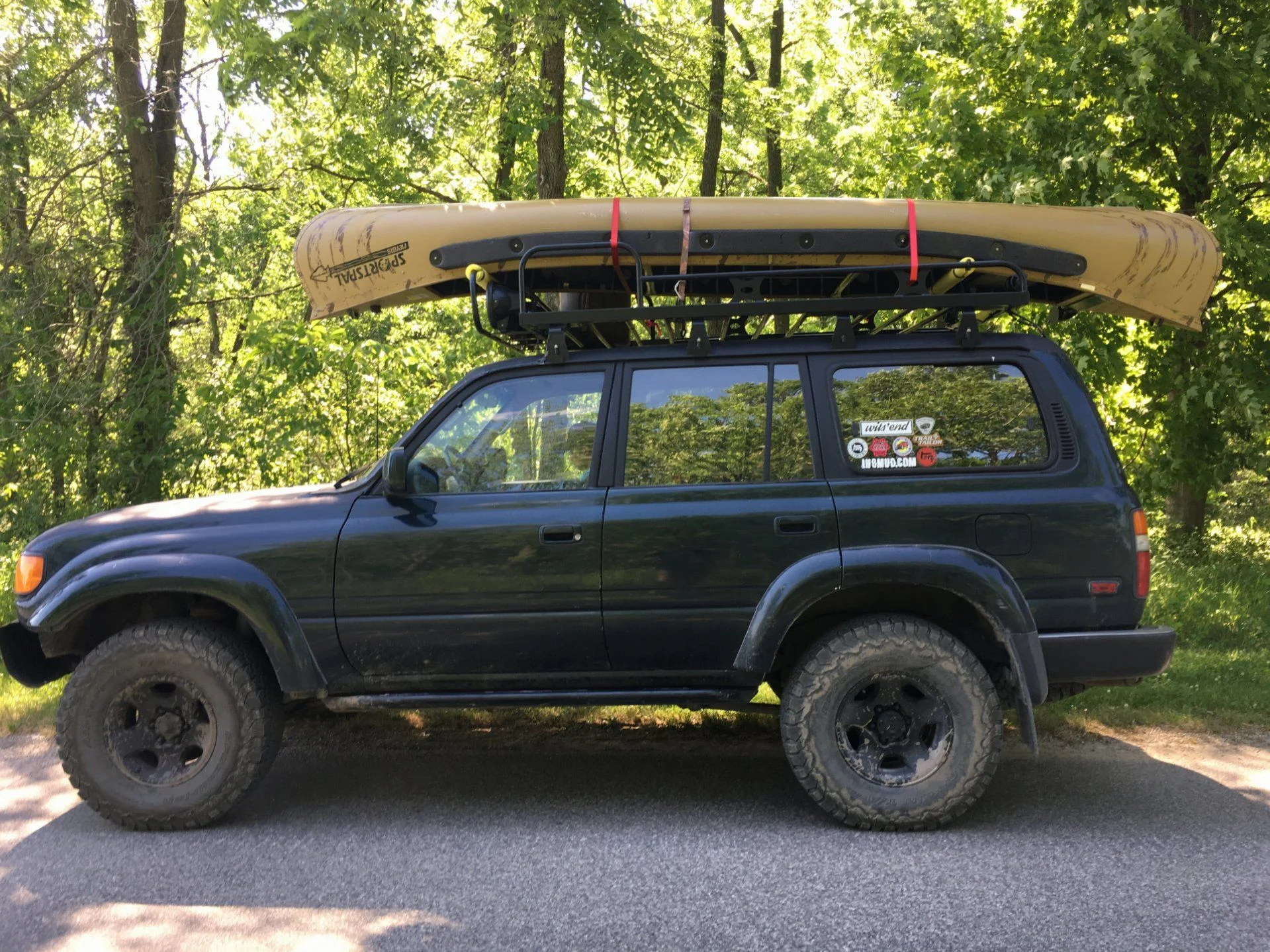

Was able to get away from work for most of the day. Loaded up the canoe and hit up a new double secret honey hole. Had to carry the canoe about 1.5 miles each way but it was worth it!
Used pool noodles for the cross bars on the rack. Not the fanciest but they worked.

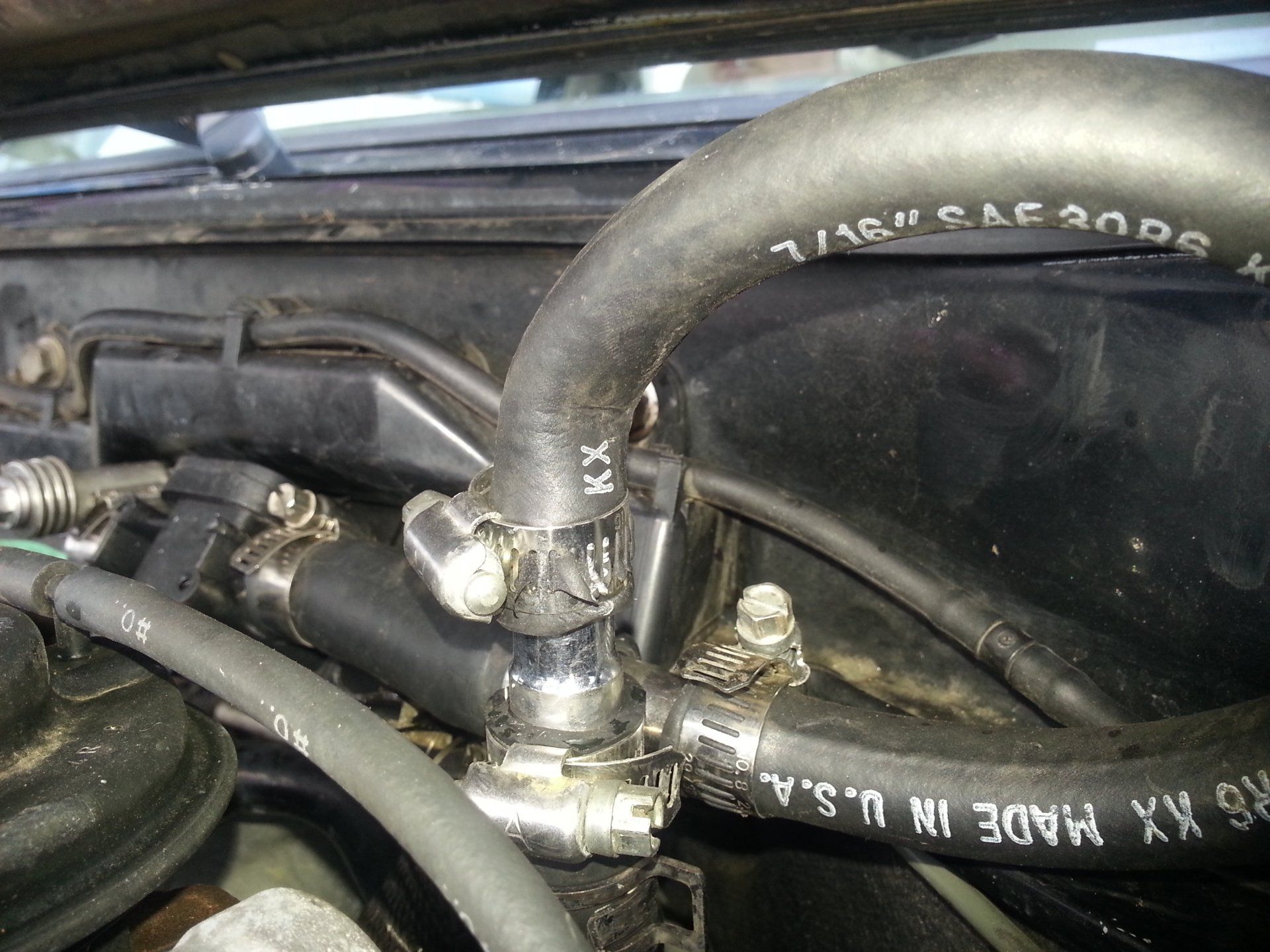

Wheeling on Beasley knob in north Georgia today and a plastic elbow broke on the heater hose the top end of the pesky heater hose. I used the elbow because I didn't have a replacement shaped hose to use way back when I did the head gasket. Factory hose has that bend formed into it. Anyway had to do some problem solving. I used 2 deep well sockets because the only hose I had extra in the truck was 7/16 size and the heater valve to top of phh metal pipe it's closer to 5/8 so using the sockets I was able to connect all thIs stuff together and finished the trip wheeling . It worked great
I'll definately keep that fix in mind!!

Careful.. you might get an earful for not using constant-tension hose clamps

Oh tell me about it I didn't use mr t hose either. Let the flame on begin. But seriously I was in a pickle and had to think around for a solution, didn't want the jeep guys help lol. Best of all it was a teaching lesson to my son in how to think for yourself and learn how to do stuff with minimal tools and resources
