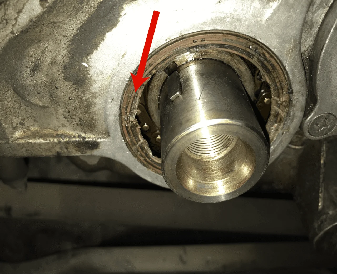

Crankshaft seal is coming in in piece and I put a dent in some condenser fins. :(
I'll play with it more later.
I am open to suggestions :D
Most of the lip where the spring resides has pulled off. I fished the spring out. I've tried to be cautious as I don't want to pry on any metal lips. I'll search for pictures.

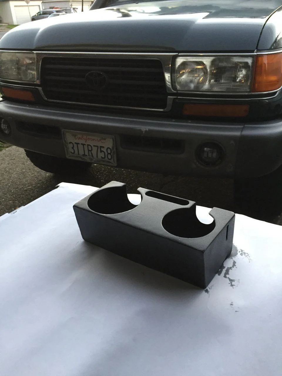

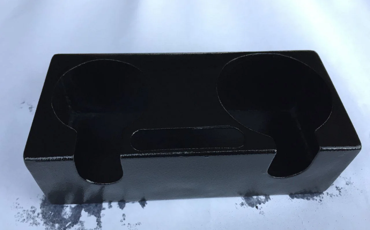

Finished the cup holder...Funny you mention that...it was inspired by one of @Aloha Jen post..... Jen i hope this does not offend..mahalo for all your post.
A hook pick works well. Or angled needle nose pliers. The hook pick is the easiest.

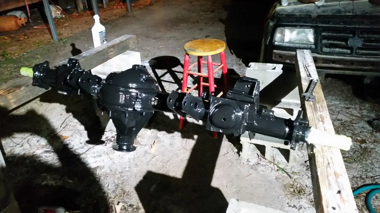

Been slingin POR-15 since 11 am, will likely still be paintin at 11pm. Got the links, front anti-roll, radius arms and the rear axles painted. 5 or 6 coats on the radius arms fewer on the links as i plan to replace them w aftermarket later. Multiple top coats on links etc gona start top coat on housing in another 30-45 minutes...
I tried that gently until it started getting dark. Is it just recessed behind the seal (red arrow) or is it a channel that the seal resides in?
Thanks

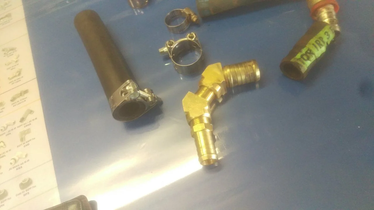

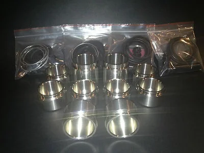

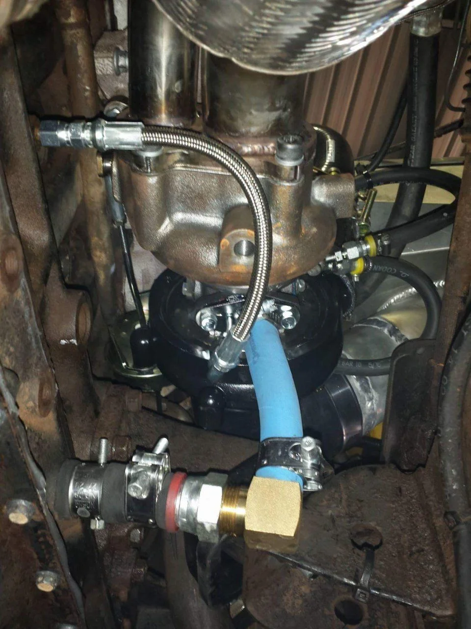

Well it turns out that the rotor that suffered the failed bearing is beyond recovery, pads chewed too much out of it, so I pulled the trigger on DBA T3 rotors, heavy duty 105 series pads and a stainless piston rebuild kit for the spare set of big brake calipers I have had sitting around waiting for this opportunity, time to make it stop on a dime :) Also revisited the turbo drain line, the last effort was a just in time job to get me going, and while I have had no issues with it, I've always wanted to improve, so a trip to the local hydraulic shop and $100 later (seems that much every trip there!) I have a custom 3/4" to 7/8" elbow with 2 x 45's in it instead of a 90 and new hose and clamps. Might as well make the most of the opportunity to fix as much as possible I reckon :worms:
Old drain setup with 90
New ubeaut custom job
Shiny stoppers
