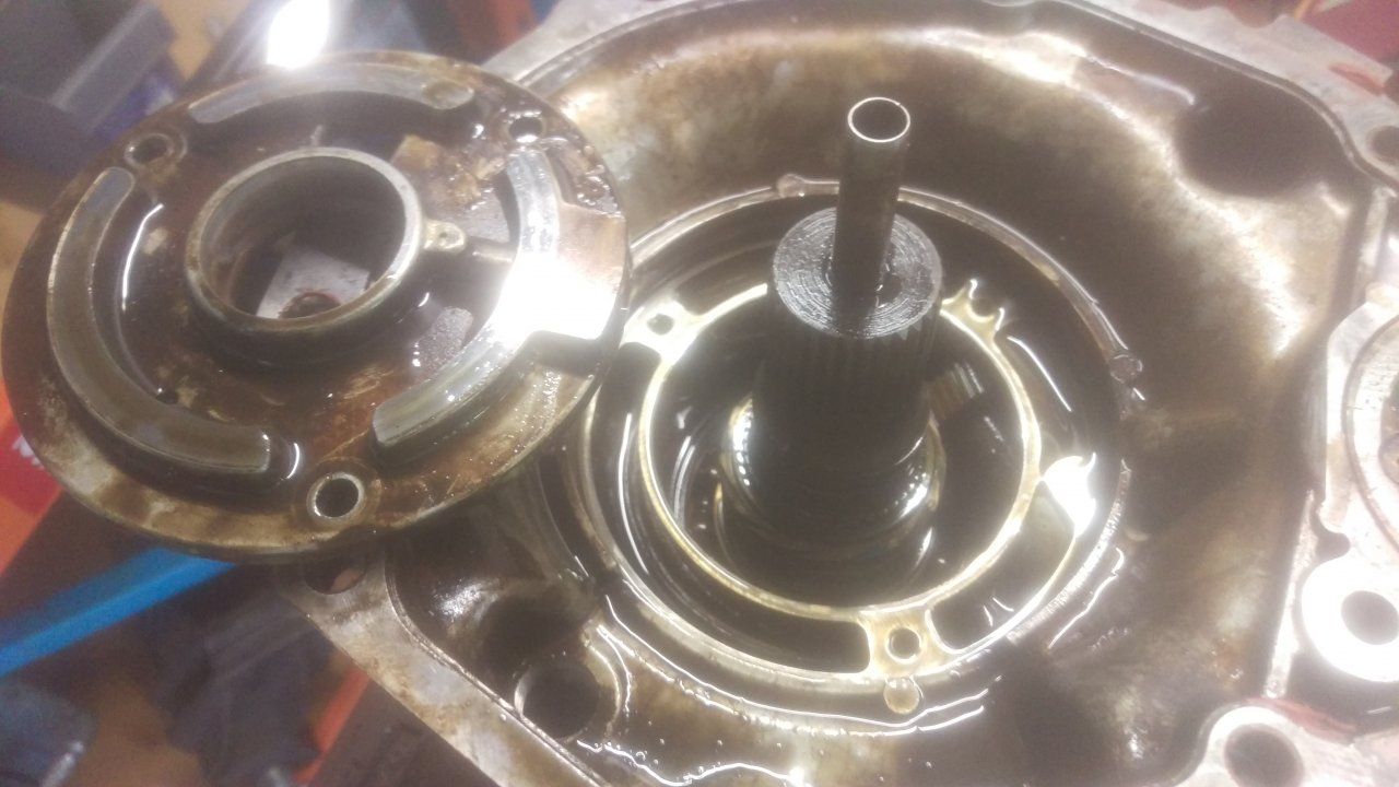

Finally got round to replacing the weeping rear output seal on the transfer. Put the new inhex bungs in while it was empty. Also tweaked up handbrake and added a tee piece to my aftermarket oil pressure sender so I can chuck a mechanical gauge on at any point. All good fun

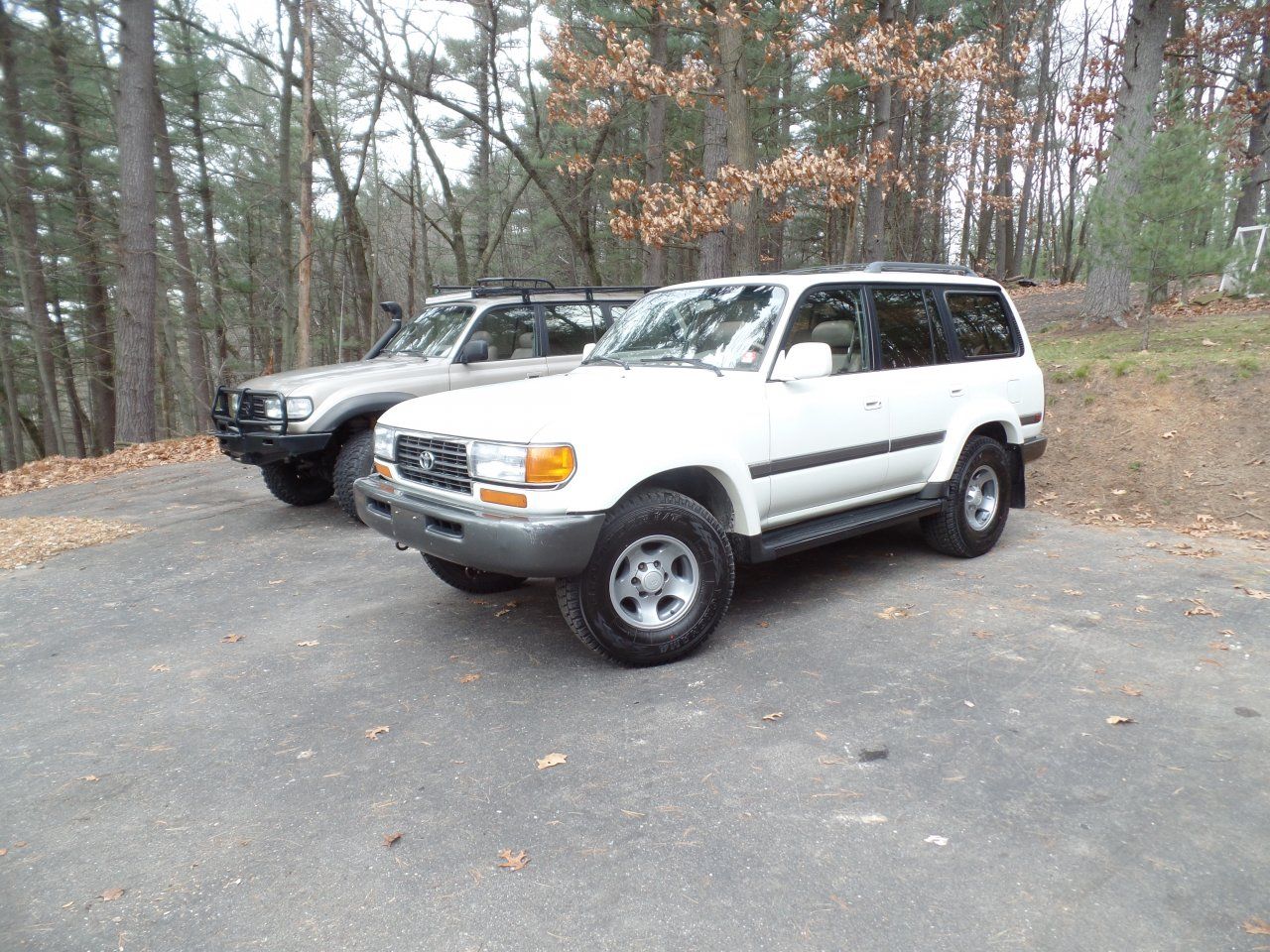

Did the winter tire/wheel swap on the white 80. The Dynapro ATM's are great tires but the Yokohama winter ice and snows rock. I'll get more total miles so it's worth it. Took it to town for a wash to get some miles in so I could recheck torque. Ready to resume daughter-driving-to-college duty!

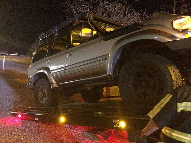

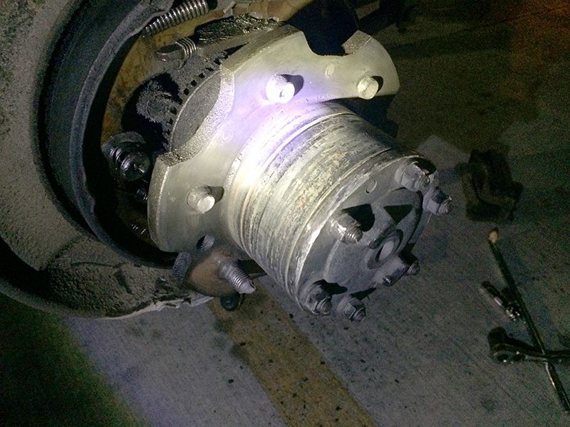

I was doing about 60 driving behind someone else on the slow lane. Not a ton of traffic but enough to not be able to speed. There is a truck lane on the far right that was unused so I decided to change lanes and maybe stop at Primm to get a Starbucks sugar-free vanilla latte, the drink of champions. Unfortunately there was something in that lane that I didn't notice until I moved into the lane. Quick swerve and my front wheel missed it but my back one nailed it. Hit hard. Decided to get off the frwy to check to see what damage was done. Then I slowed down enough to realize it started to feel like a bad tire blow out. Then about 5ft before stopping...the tire just fell off. :doh:
So that my wife wouldn't panic and bug me, I sent her to Starbucks. Gave her something to do. :p

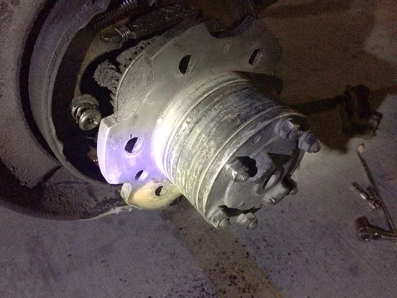

The Metro truck came over and he knew there was nothing he could do but hung out til the tow truck got there. I called around for a rear hub, wheel studs and nuts. No one. Nothing. No where close. At all. Except for freaking O'Riellys on Rainbow in Vegas. An hour later and we were back in Vegas. It took me exactly two hours to strip everything down, knock out the broken studs and installed the new wheel studs and get back on the road. I had to use the draw-thru method of pulling the wheel studs thru the hub but I was out of options. All good but I think I need to replace the rest of the studs around the truck.

You don't use impact tools to install your wheels, do you?
yep, that'll cause exactly what is pictured, stretches the studs causing failure. only way to use a rattle gun is with a torque limiting bar, or just nip up and do the final tension by hand
@Rob1983 Looks great! ?Do you have a parts list for what you replaced? We need to do this on my son's 92 next month.
Only thing I replaced was the seal, 90311-58008. There is a bearing in there too, but it was fine. Old seal was pretty degraded, probably factory. Would leave a small puddle every week or so, I just got annoyed about it enough to finally replace it! Reused the snap rings and all bolts
