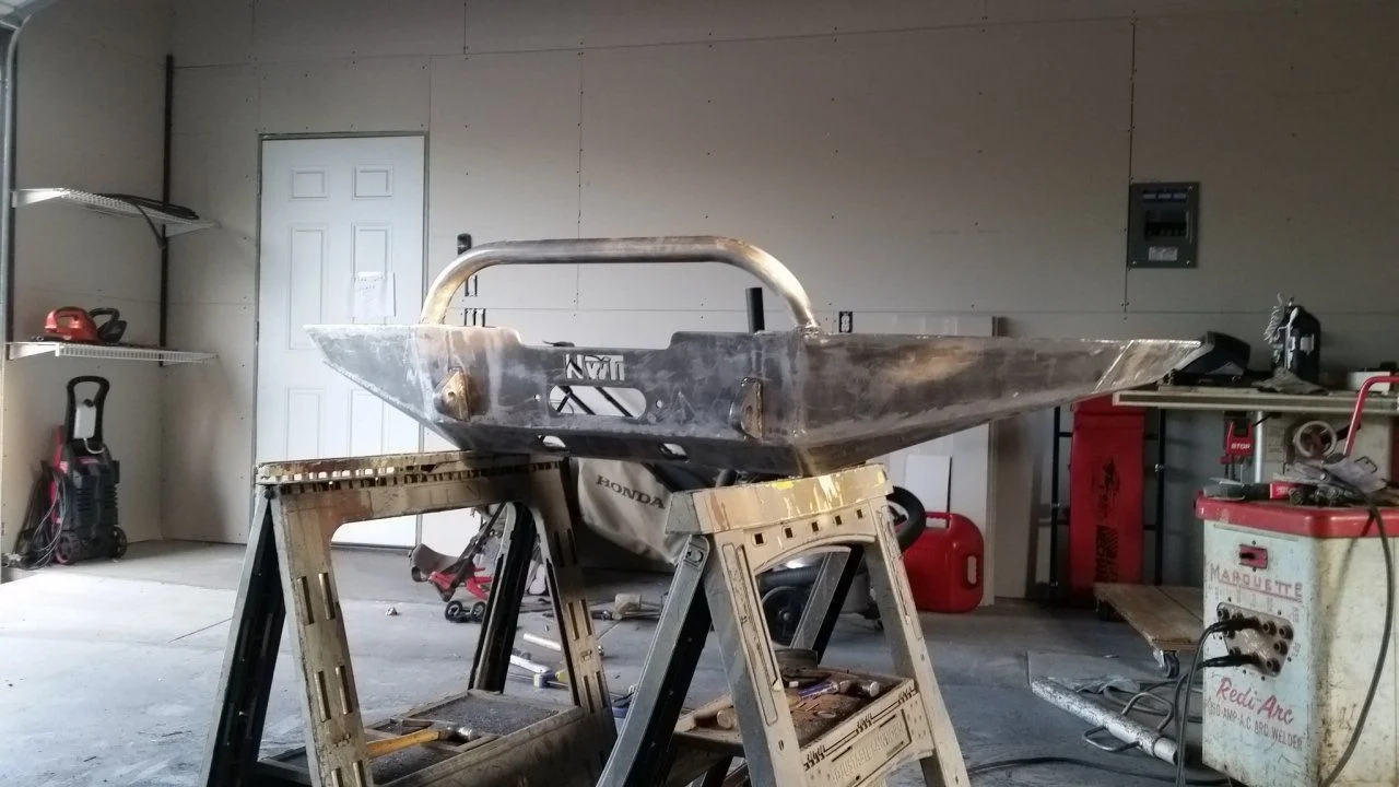

Welded, ground, sanded, ready for paint.

WTF?????????????
do you really think we're all dumb here?
"cut down the from bumper" and all I see is a hammer!
That's how we do it in Iowa! I cut that with a SFH! I got skillz!
