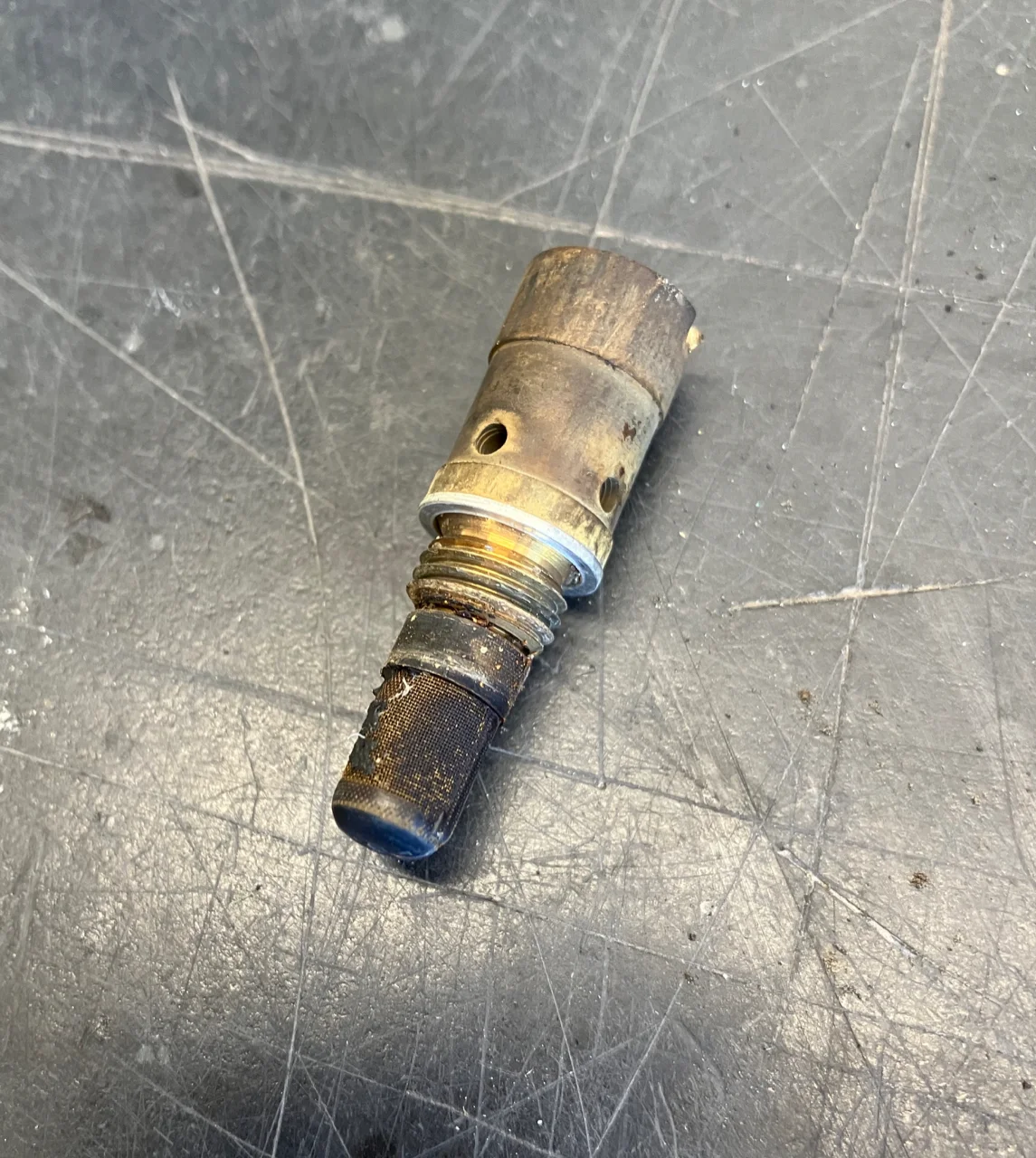

Rebuilt my carburetor. I think I found my fuel delivery problem🤞 That mesh screen on the inlet is about 80% plugged with crud, the image is the clean side. Plus there was crud in the bowl. That adds up to poor performance.
View attachment 3427790View attachment 3427791View attachment 3427792
Wow that screen is pretty dirty. If you still have any trouble with seeing enough fuel in the sight glass don't forget that the needle valve can get stuck - even a new one. A few taps on the outer part of the carb where it is located with a wooden or brass drift will knock it loose.
