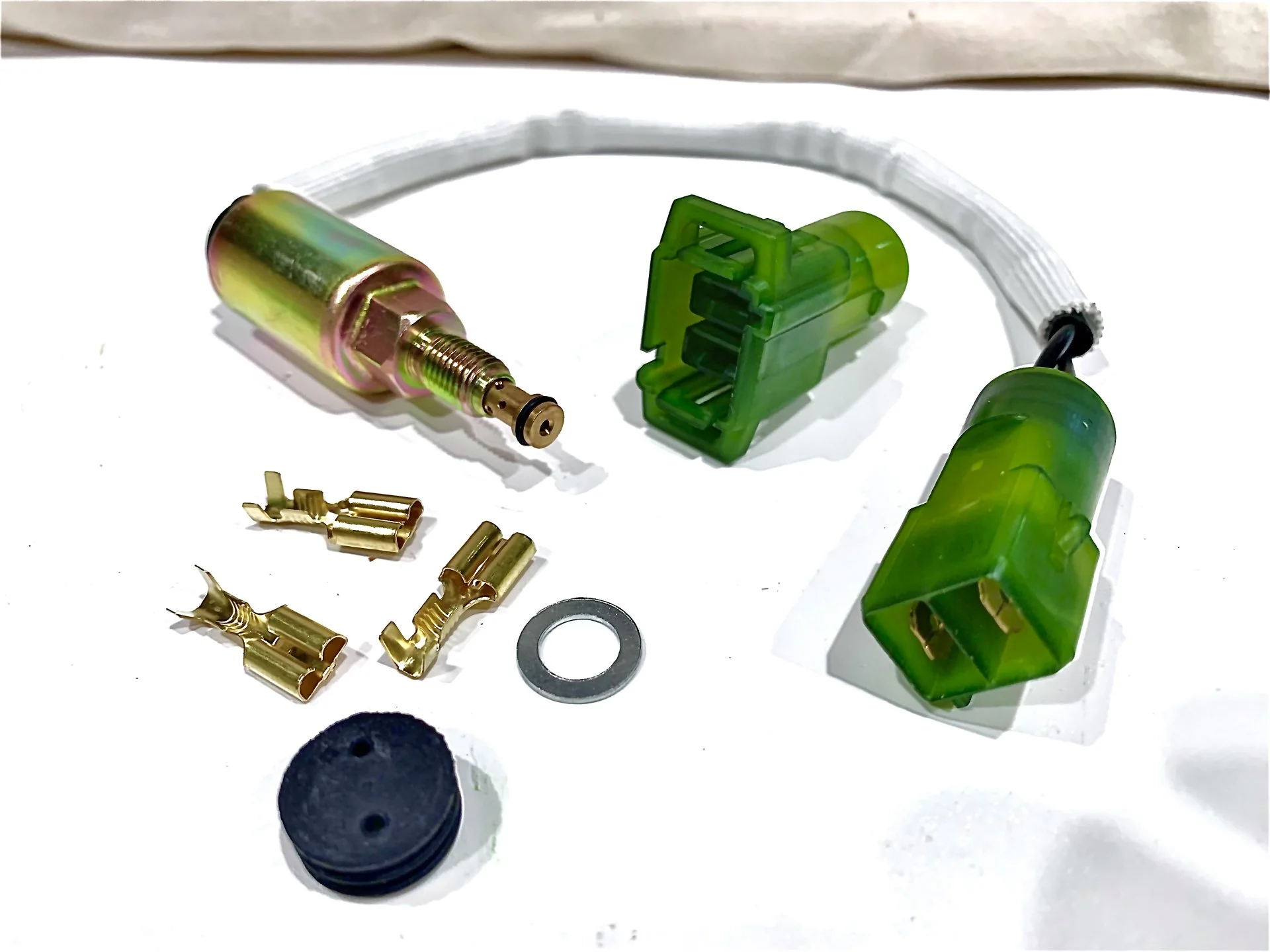

my updated 21062-61060 Double Wires Fuel Cut Solenoid plug and play repair refresh and restore all inclusive kit form 1 stop solution
i pipe dreamed together recently is now a reality …
comes with a harness side oem splash proof SUMITOMO connector housing , extra solid brass terminals
, MADE IN JAPAN FIRE RATED CLOTH loomed
period correct adds SAFTEY to the equation as well :cool:

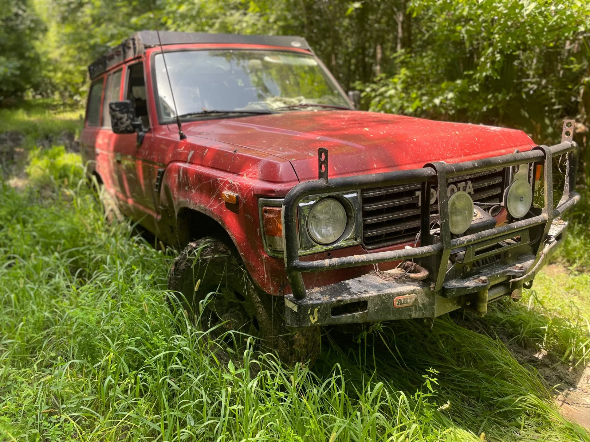

In and out of muddy spots yesterday while conducting research in southern Louisiana. Normally I would expect muddy conditions but the area has been dry and most of the road surfaces were dried and caked mud, but where remains some moisture grasses and vegetation hide the soft mud.
