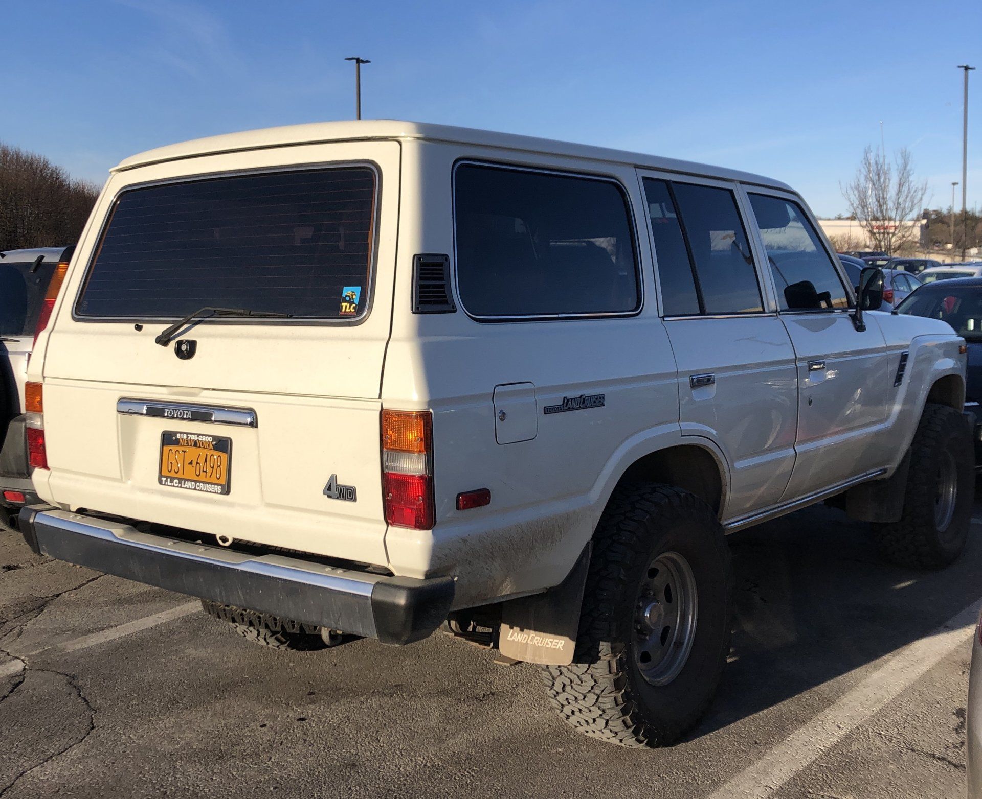

I did get to drive it to the exhaust shop this week. No more rear sway! Before there was oversteer, the rear end would dip and I felt like it wanted to pass me when I would turn. I drove at highway speeds, and turned the wheel left and right on a county road, and that sensation was gone. Just tracked nicely.
I have 2” OME lift, 33” BFG on 16 inch 70 series wheels. (Avatar is 31” Goodyear’s on 15” 40 series wheels)
@John Staton
Is it a kit you bought and where did you get it? I have a sway bar on my front and I replaced the links and that helped, but nothing on my rear.
I picked it up from a member on mud. It’s from an FJ62. I got extended links because of the lift, OEM links were too short. You need everything from the frame brackets to the axle brackets. And the bar.

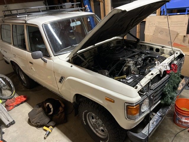

3FE began running very poorly two weeks ago. Today I finally took a close look and found the source of a massive vacuum leak. Could have slapped on the spare intake tube but decided to dive in and swap out the injectors for ones that have been serviced plus do a desmog. I'm down to having stripped off the upper intake. Throttle body and cold start injector have been cleaned.
