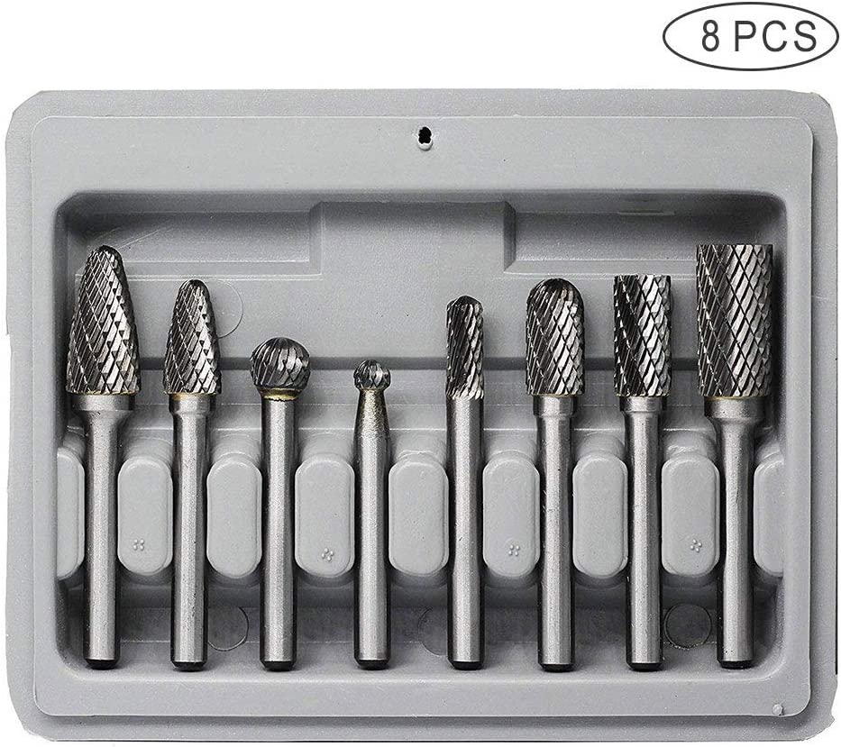

Finally made some progress on the rust repair at the corner behind the back left door. I was left with some welds to grind down in a spot I couldn't get the grinder into (last photo). How are you supposed to get rid of them? I'd go through tons of dremel stones to get those flush. I went to the tools store and wasted some money on some rotary files that didn't last. I got some HSS small saw blades to go into the drill and those managed to get it off but wouldn't last much longer than that.

@MarkBC - if you need to grind down welds I would suggest getting a rotary carbide burr set with 1/4" shafts. You can get them off Amazon or ebay at a reasonable price. I use the burrs an air die grinder, but you could also use the burr with a standard drill. You can grind 90% of the weld off with the burrs, then do finishing work with other tools (2" roloc sanding discs). Be forewarned, the carbide burrs can take material REALLY fast. Make sure you don't dig into the existing metal with the burr (I speak from experience on this one).

Like this?
Those look a lot like the rotary files I got that lasted about 1 minute but I guess the different material means they will last.

Yes, those are the ones. The 1/8" shank rotary burrs used with a dremel last about 1 minute. My experience with the 1/4" has been much better. The burr on the far left of your picture is the one I use the most. I think mine are starting to dull, but I have ground down a ton of welds.
