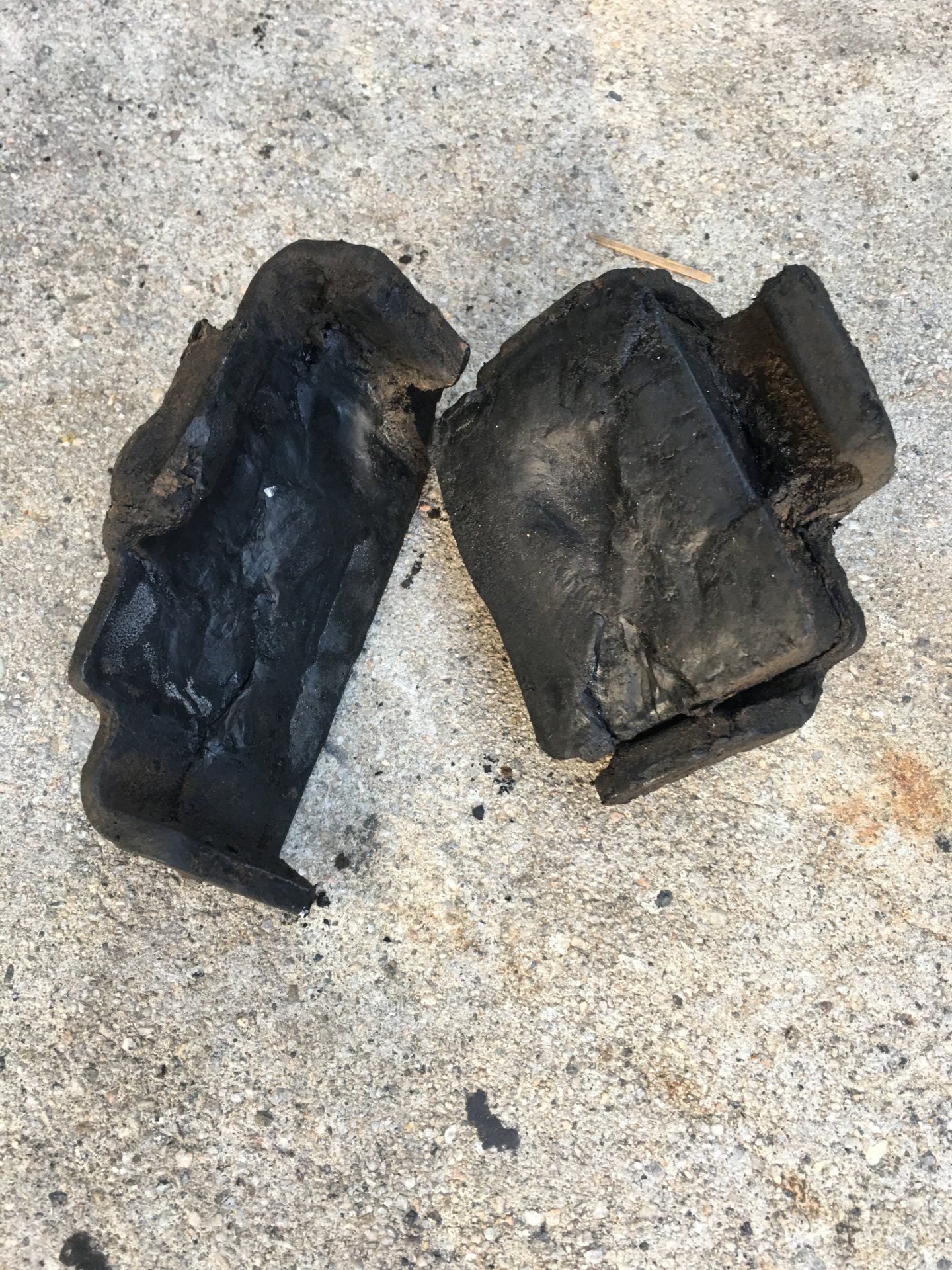

Replaced drivers side motor mount!
And 2 out of three exhaust isolatosr.
(No pics) on isolators.

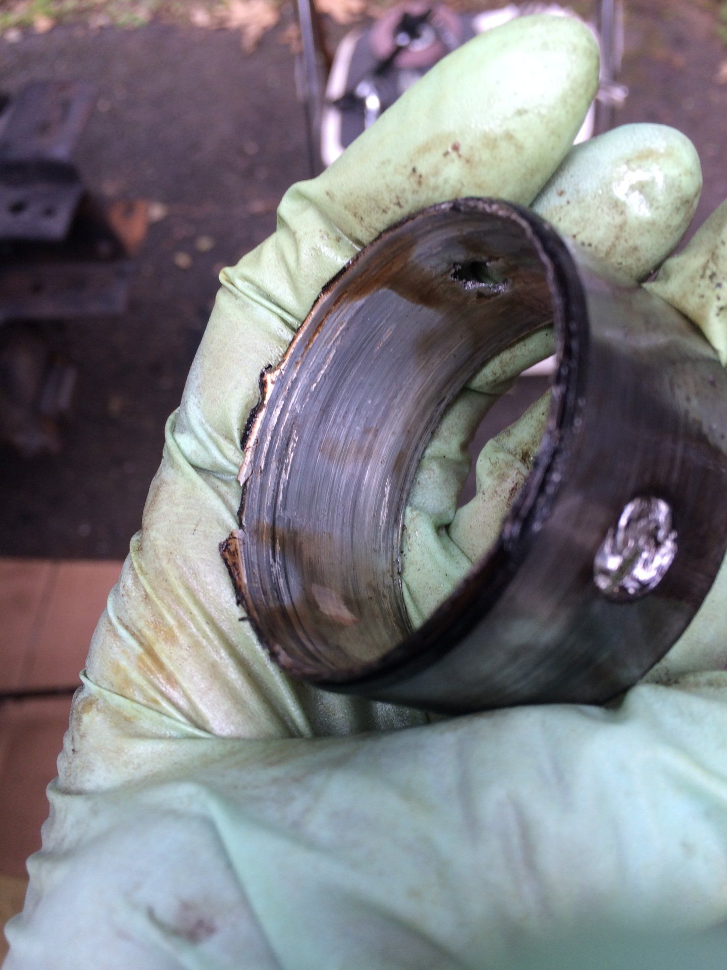

Pulled my camshaft out today w/o pulling the engine. Had to do some cutting and bending of the front crossmember but hey... onto replacement of one partially spun cam bearing #2 and if able #1 and 3.

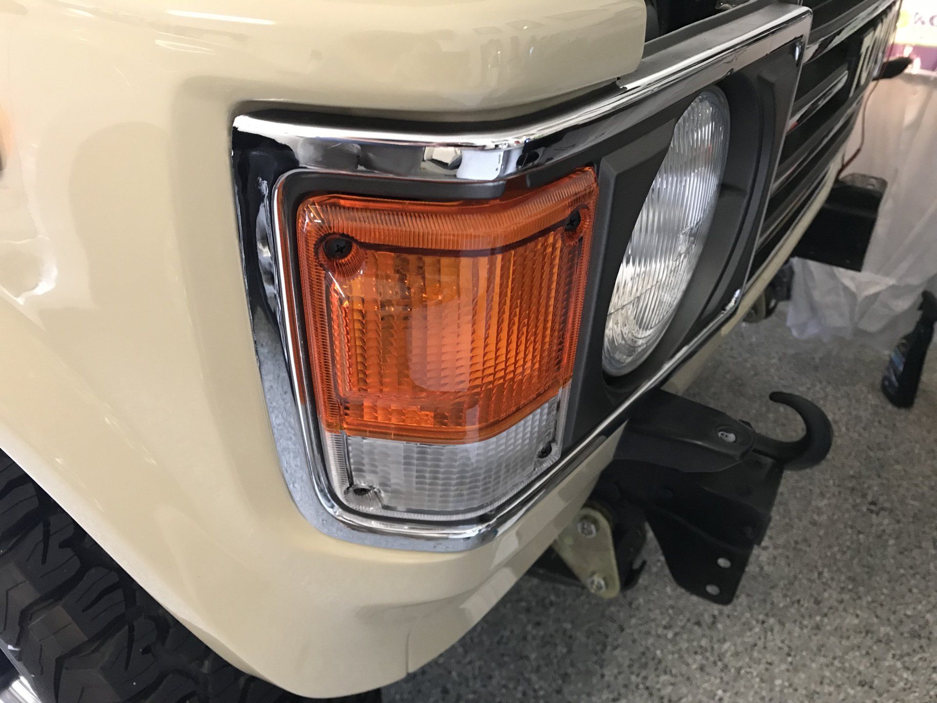

@Javelin... I see 3 part numbers under HELLA H4 headlights, what part number did you use for your HELLA H4 conversion headlights?
