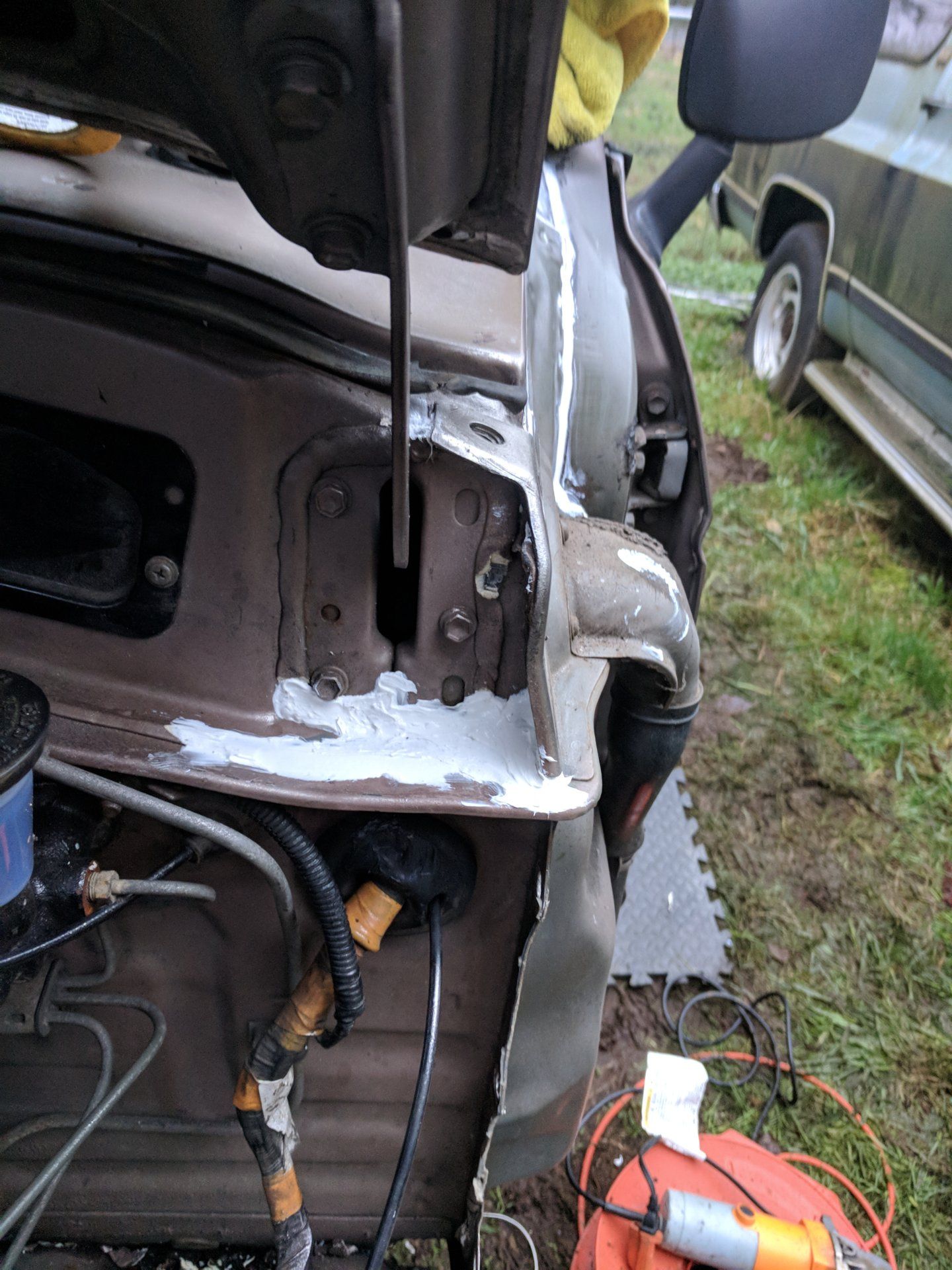

Chased my wet drivers footwell using some food coloring and some NW rain. Pulled the fender and sealed everything up with urethane sealant. Next weekend I'll get around to painting the sealant, putting the fender back on and getting the carpet and drivers seat re-installed.
Pro-tip: don't use power tools (i.e. 20v impact gun) to remove the outer most bolts inside the wheel well... Broke 2 of the fender clips and had to cut the bolt heads off to remove.... :bang:

It’s not rain, just PNW sunshine. Great idea to chase the leak.

I have been chasing my own "damm A pillar leaks" for about two plus years with no secess. So my question is you you how did determine where the leak was from. Was it the "A" pillar, the side firewall or the engine side firewall? Where was the biggest leak or was there only one leak ????? Did you use a bore scope to fine the leak ????
Thanks Jason
Thanks Jason
I think different color food coloring was used to "show" via the tint of the water inside which seam was the culprit.
