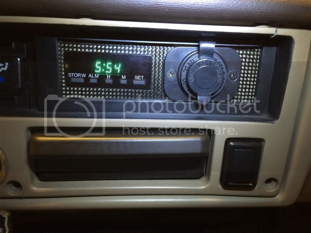

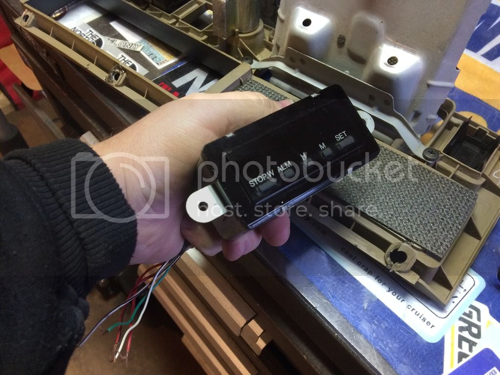

Installed a 62 clock in my 60 with a 2 outlet USB plug. Took some custom work, but pleased with the result!
In case you want to do this, I wired as follows
Solid White & White W/BLK stripe = Grounds. Wire together
Red = Switch ON. Wired it to positive on Cigarette lighter
Red W/BLK = Battery, Hot (for clock memory). Wired this to the hot I ran for the radio.
Green = Dimmer. Ran a wire across under dash to fuse box and wired it into headlight fuse.

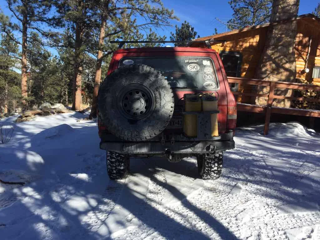

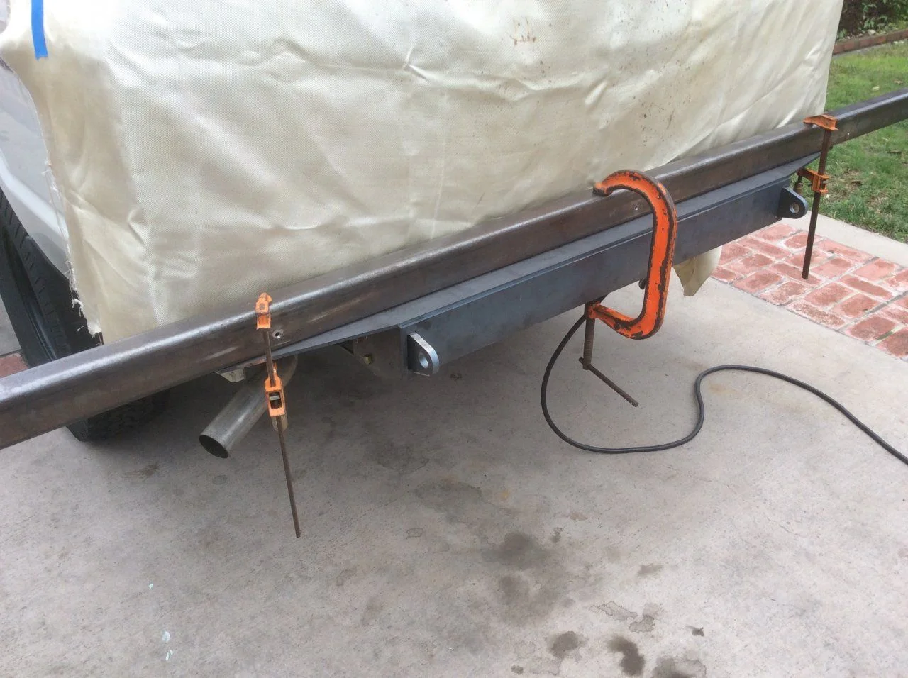

Started fabbing my new bumper from "fourrunner"
Great choice! I love mine despite the fact that it's hard to fab a connected quarter panel protection.

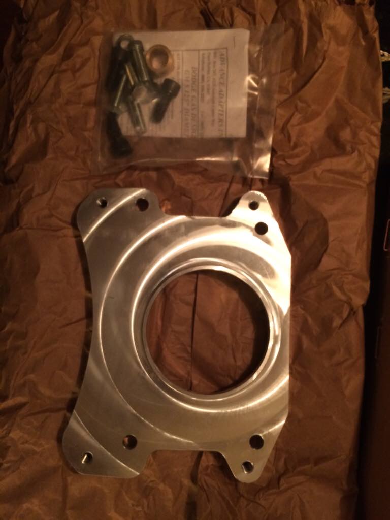

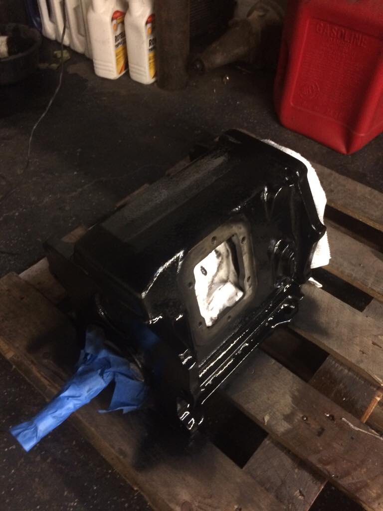

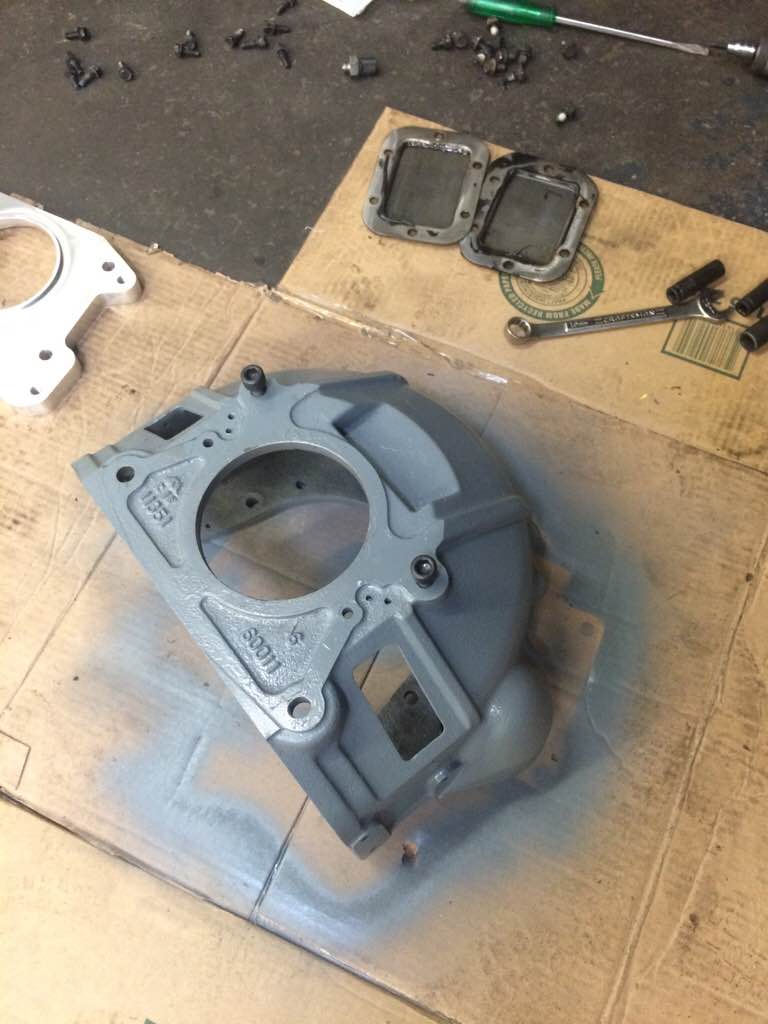

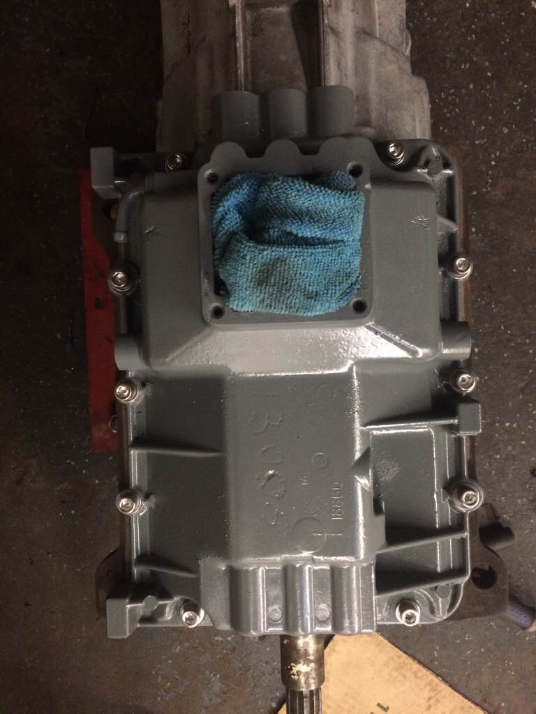

Started prep of my NV4500 and bellhousing...

@cruisermatt I'm sure you already know this but just a reminder since it would be a good time to secure the 5th gear and replaced the input shaft seal if your rear adapter is aluminum i would use anaerobic sealer or a good RTV. Just my 2pennies.
