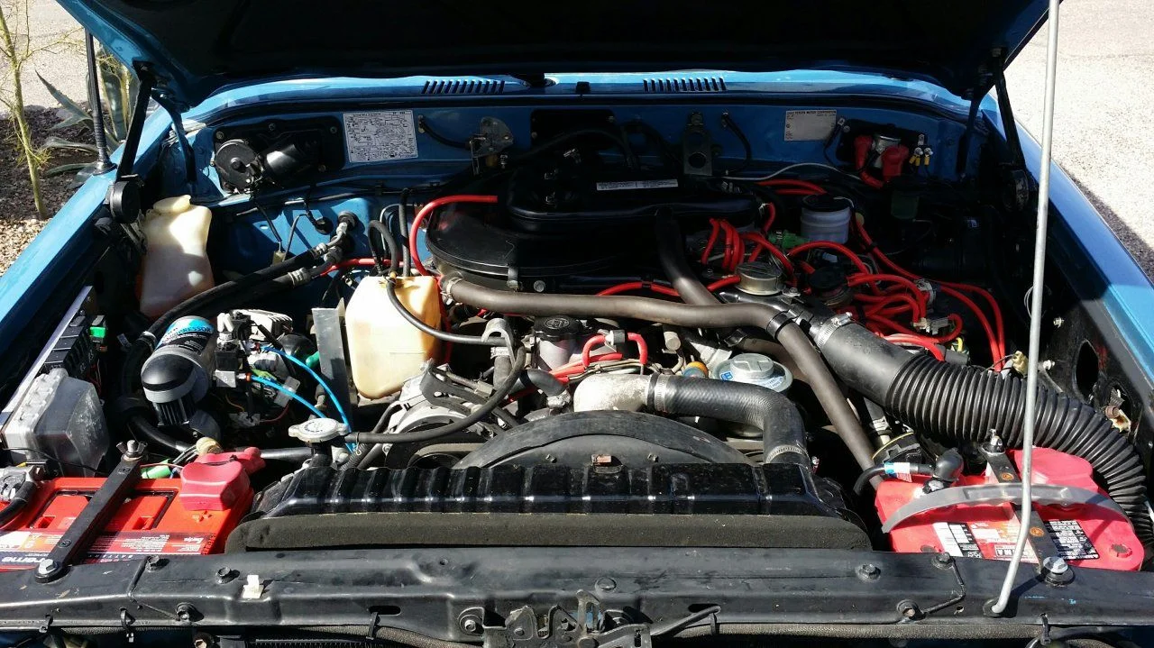

This past week got new brakes all the way around, new front calipers, all new brake and clutch fluid, found and fixed some tiny leaks on my ARB compressor, relocated the coolant overflow bottle, tightened springs in TRE's, centered steering wheel with the drag link adjustment, LED back up lights, full grease job, changed out center vents with the closeable type used on the outer vents, new Odyssey battery, torqued U Bolts, new air filter. Cant think of anything else to do now but head to the back country.
Edit......ARB now holds pressure indefinitely. Finally!

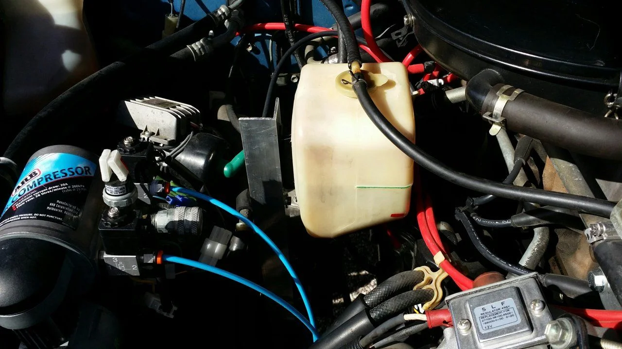

Pix of overflow bottle relocation and reason?
I ran out of space with the second battery and ARB compressor. Used 1.5 inch aluminum L and fitted it to the two bolts for the charcoal cannister

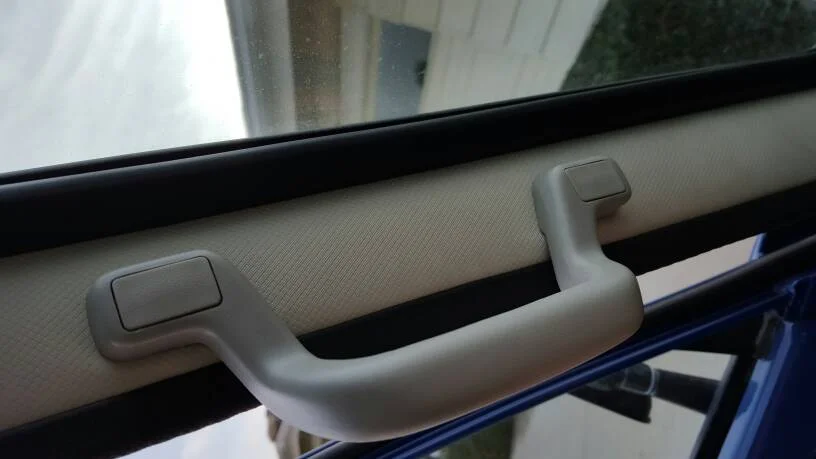

Completed A pillar grab bar handle install, changed fuel filter and the 30 amp Heater/AC breaker fuse. Turned on AC full blast, blew breaker in 15 minutes. [emoji53]
That's a great mod. A-Pillar handle is so useful. Did you use rivnuts or just tap the sheet metal?
