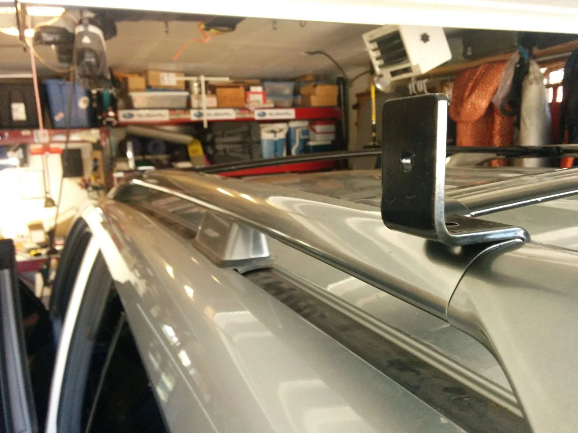

Allow a recommendation my buddy and I devised for using stock siderails, you may find it useful too....

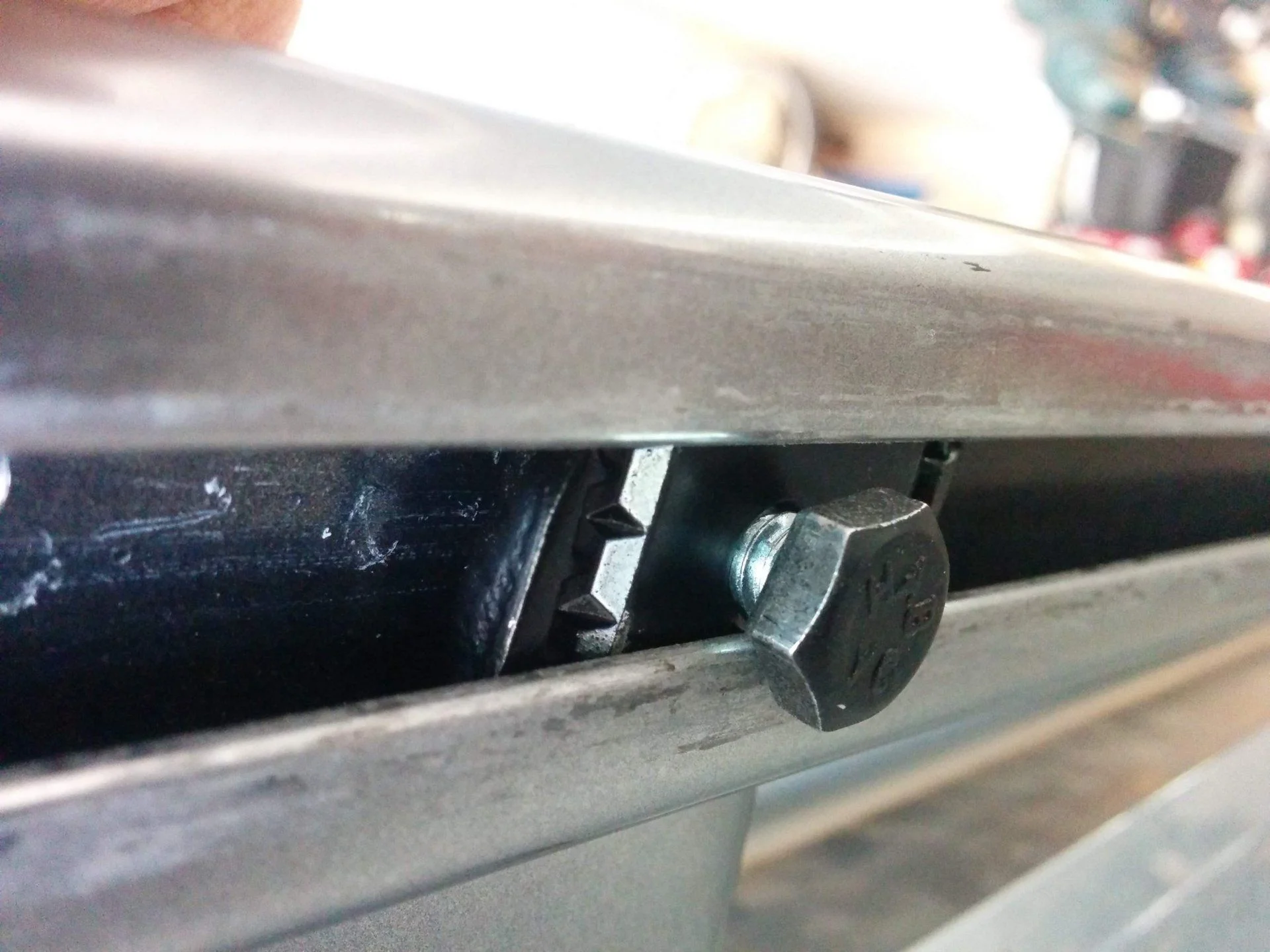

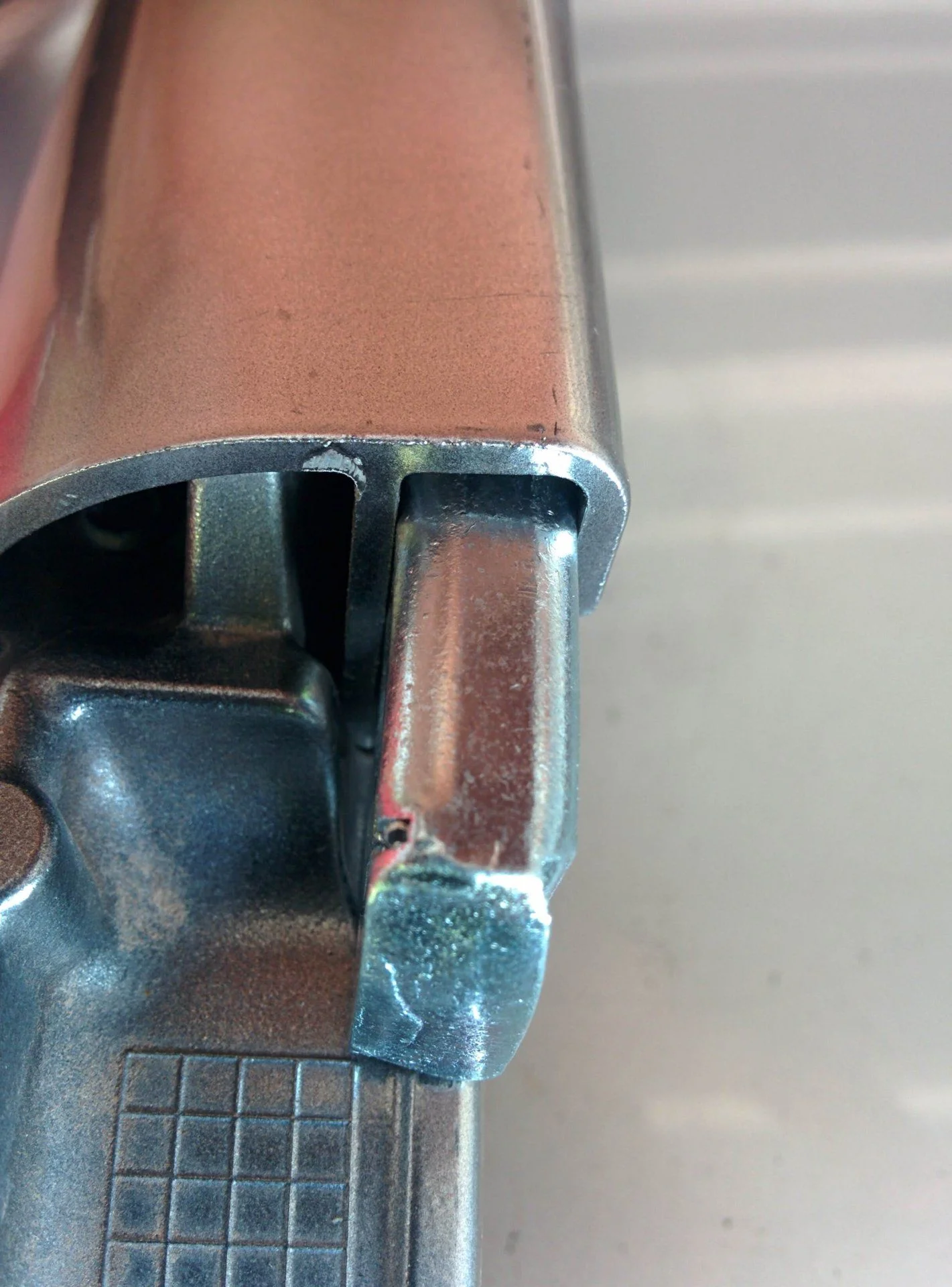

It may be a little better for you... Unistrut cam nuts fit in the slot on the inboard side of the stock side rails. I was able to bend the factory universal rhino rack mount bracket such that I could Mount the rhino rack directly to the factory side rail. I think that configuration might be a little bit more solid than a clamp over the side rail especially considering the side rail has a plastic outer coating.

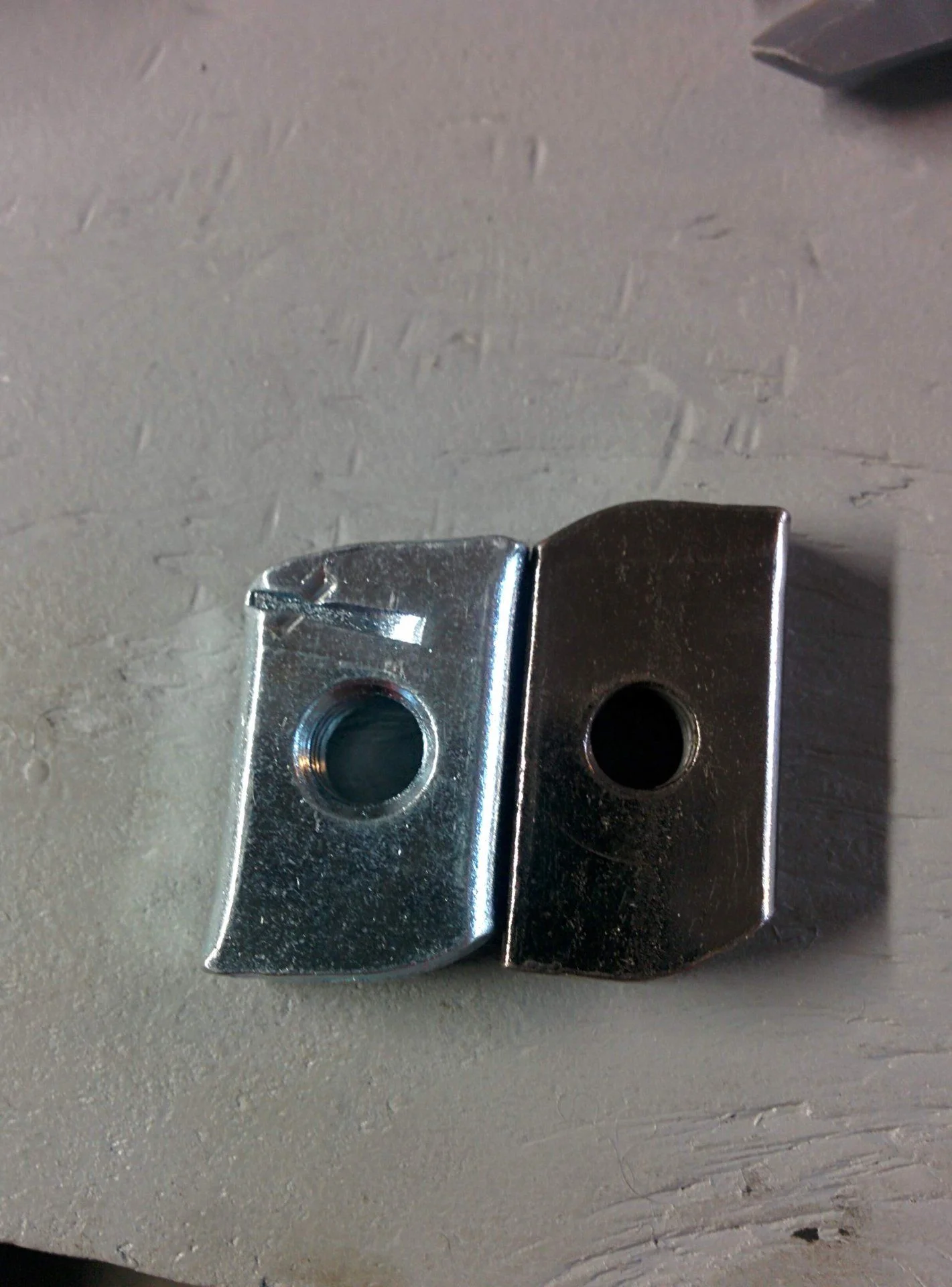

the darker nut is metric, Rhino Rack hardware, the zinc is off-the-shelf unistrut/superstrut hardware
to fit the 3/8" unistrut nut, I shaved it a little with the angle grinder, then painted it...
