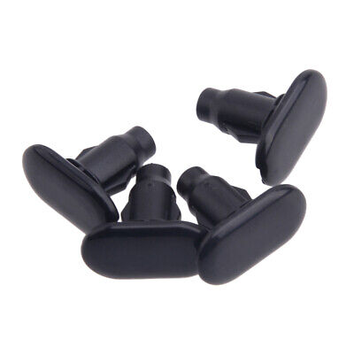

Also, looking for these clips, anyone know where I can find a PN? I can't locate them on the parts sheets.
