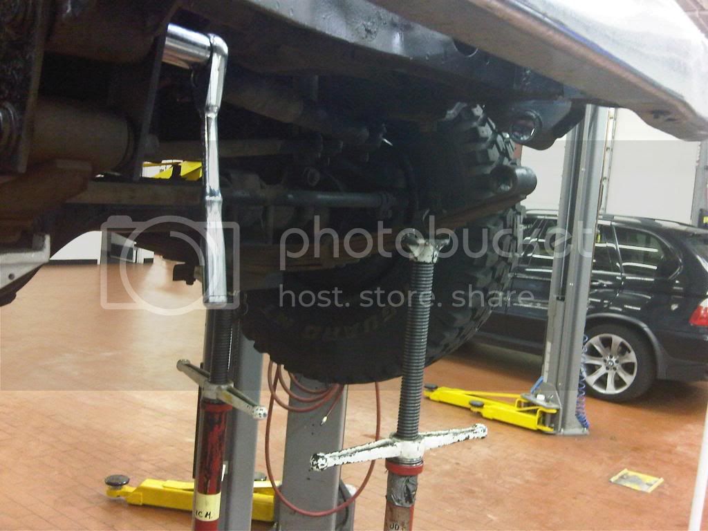

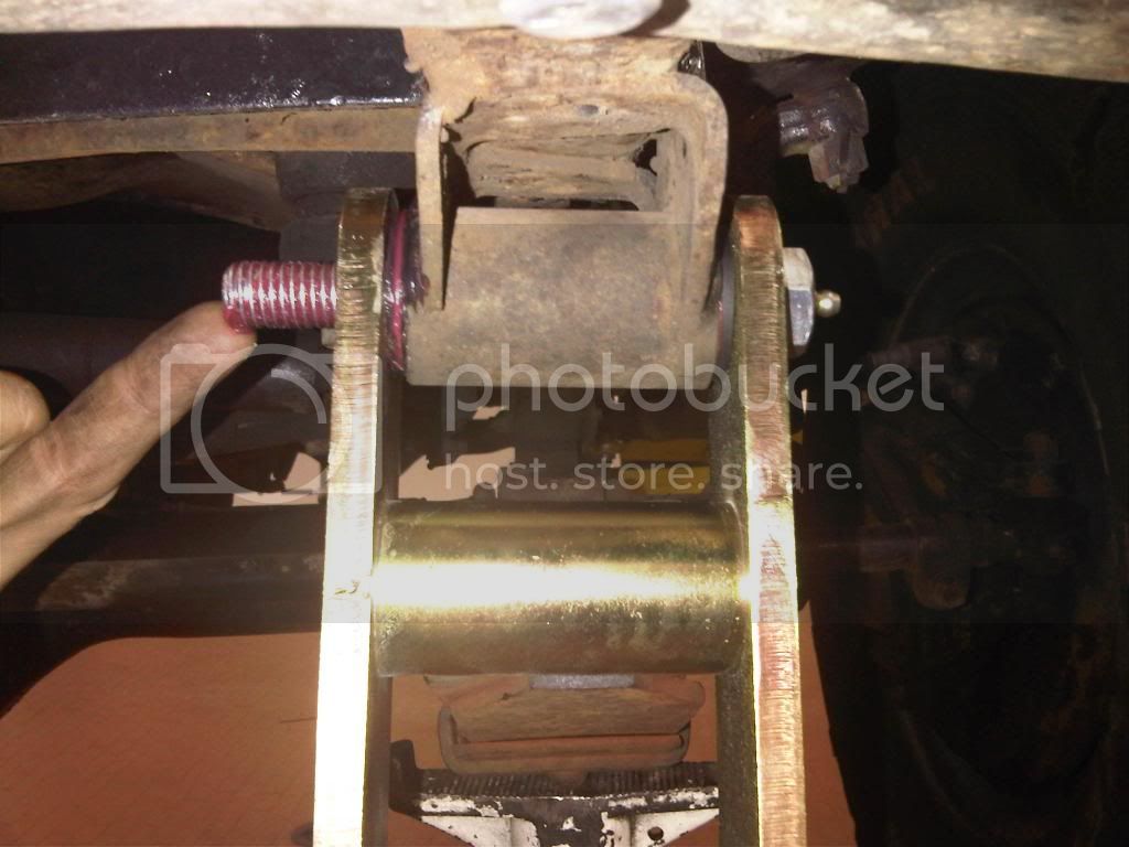

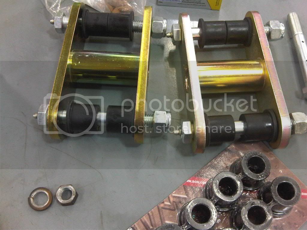

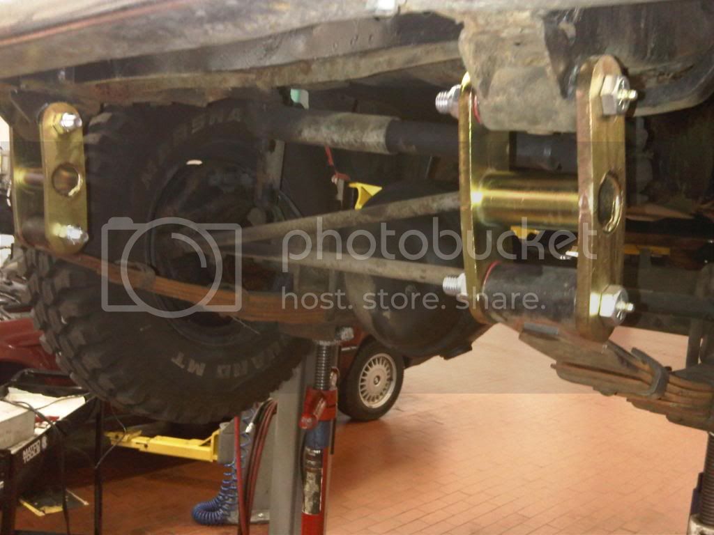

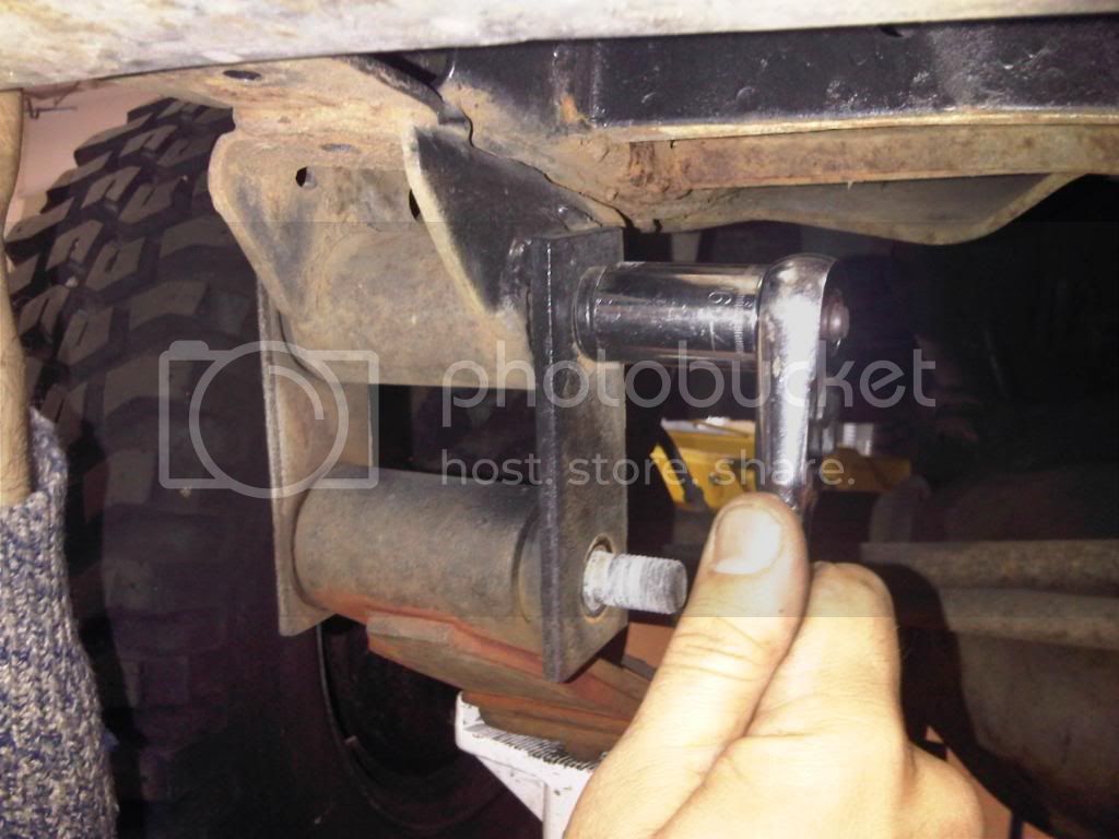

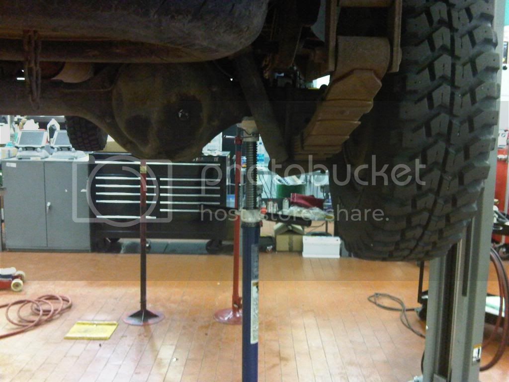

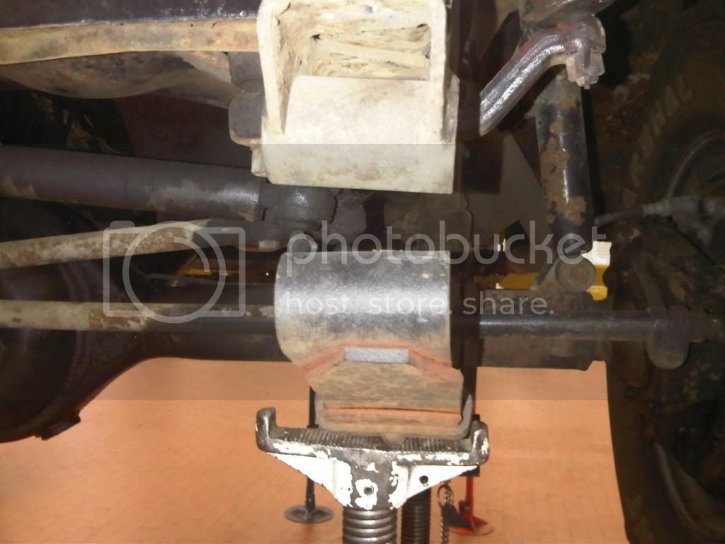

The shackles I thought were going to be a pain, taking the load off the sprigs so they don't snap your head or hand off. You can do it in your driveway, but man, how nice is a lift and screw jacks.

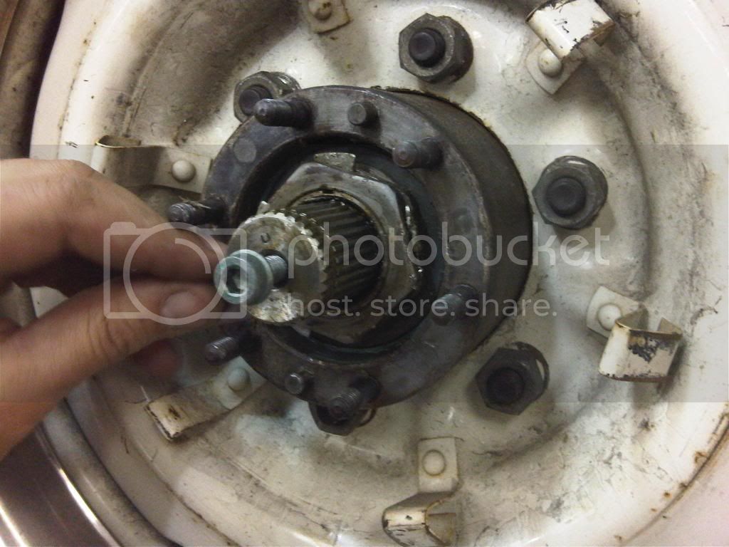

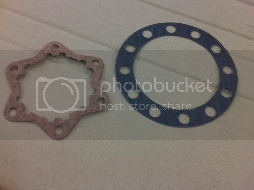

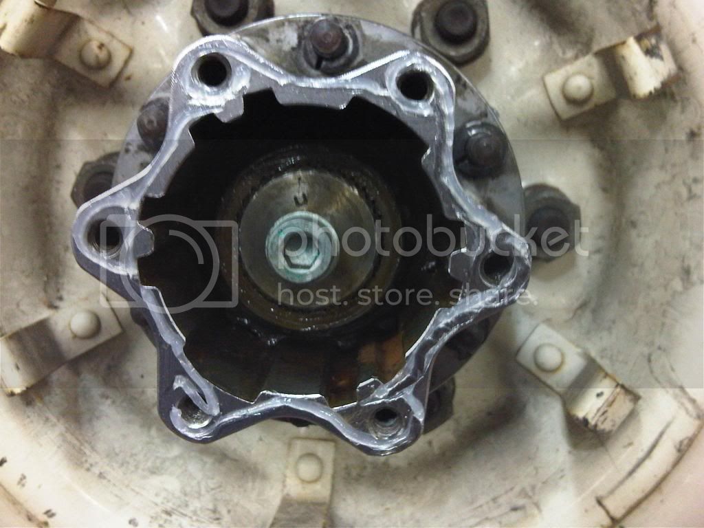

While I had the lift, I also went a head and replaced my hub gaskets and siliconed them to prevent any water intrusion....I'm not sure if this is recommended or not, but seemed like a great idea since my wheel bearing went out and were full of chocolate colored grease.

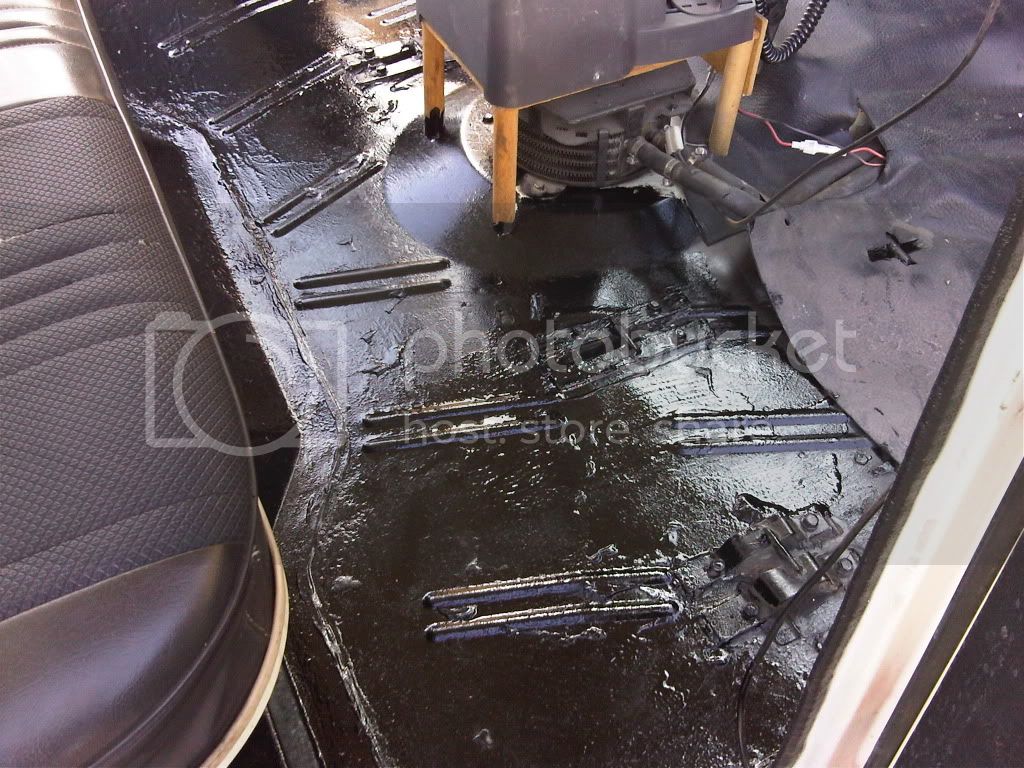

I also used POR15 on the floor to help eliminate and prevent rust.
Did you replace the axle seals while you were in there (pics don't indicate)?
The grease gets nasty and weeps out when gear oil escapes past the inner axle seal.
You probably know that, just trying to help a brother out!
Are you sure that is the outer race? Just asking because I fell for the same thing. Thought the sleeve in the crankshaft was a race and tried to remove it until I realized otherwise.
Ya I'm pretty sure. I've only taken out the inner race and the bearings. I can feel the groove where the bearings reside too. I've tried to make a pry type device, but I'm scared I'll damage the crank.
yeah, I did that when I did the wheel bearings a month ago....I didn't have the gaskets at that time....
