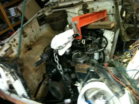

Gave Piggers 2 early Christmas presents. Moved him into the garage for the first time, and finally got the Mercedes engine in... Sort of. It's resting on blocks and tie straps for now. Tomorrow will be bolting the fan and radiator in place for fine adjustment before tacking the motor mounts. Next time someone tells me a diesel conversion is easy I'm slapping them. Hard.
keep it up, I'm very interested in the OM617 conversion...

Took the cutting wheel to the floor to reduce weight and improve air flow in the cab. Ok, in reality the long transmission needed more room. Got the engine and tranny in their final resting place, but since nothing is easy... The motor mount arms are too wide. Not enough clearance on the passenger side for the rubber puck. Looks like I'll be combing eBay and picknpull for the shorter arm...
