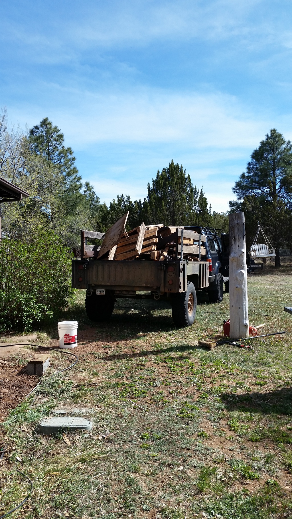

Removed old deck and hauled to the dump, grossed over 8200 lbs there. Trailer is 1460 dry, I figure the 80 sits about 6200 empty with 32+ gallons of fuel.
