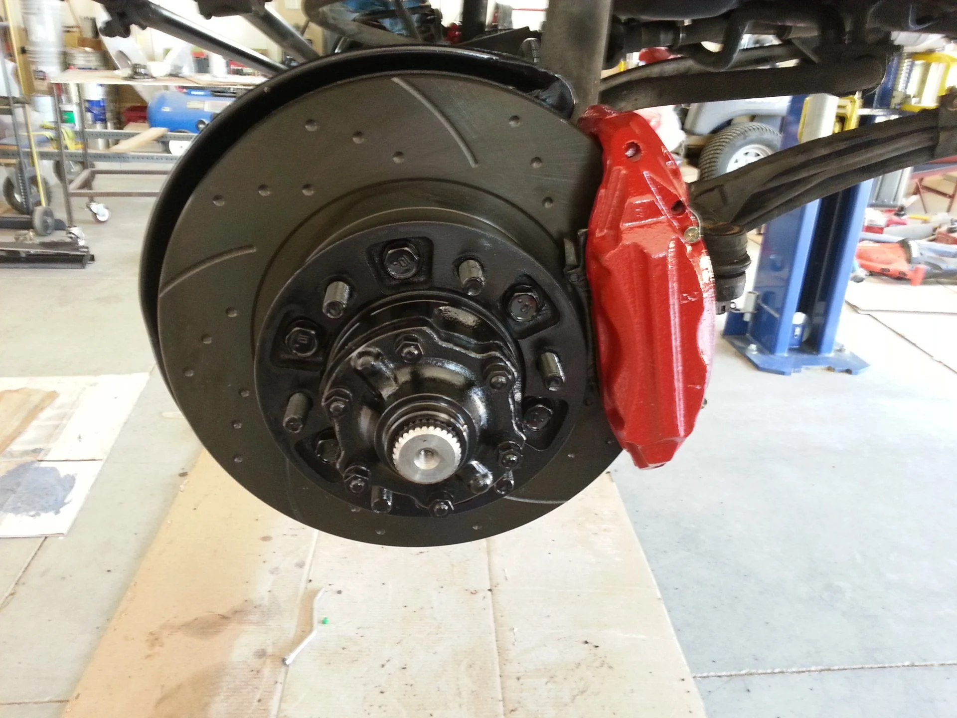

Well, Finished up the axle rebuild and brakes on OZO yesterday. After all the work a little disappointed with the brakes. Perhaps I had overly high expectations of the performance outcome. While they are a lot better than before the work, they just seem....soft and underwhelming. Wondering now if I should have replaced the master cylinder just for GP's. It's suppose to be "New" according to the PO.

The new Birf's required that you use the later model axle flanges
Made three runs around the rig bleeding with the power bleeder and then took it out for a test drive and back in for three more rounds of bleeding.
The extra pad area on the front using the 100 series pads in the 80 make for a nice contact surface.

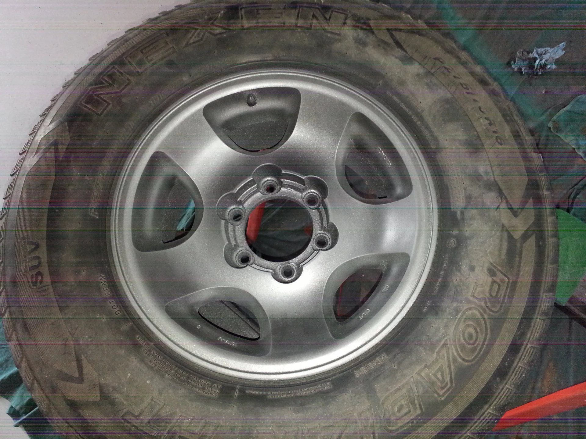

Started testing the wheel painting on the spare, once more, so much time cleaning to get it prepped. 22 years is baked on pretty hard.

Not happy with the brakes, guess I should have replaced the master cylinder "just because" even though it is suppose to be new. Lots of pedal travel and will drift to the floor. So, new MC when she comes home and a bunch more bleeding I suppose. Then the lift and bushings all around.
