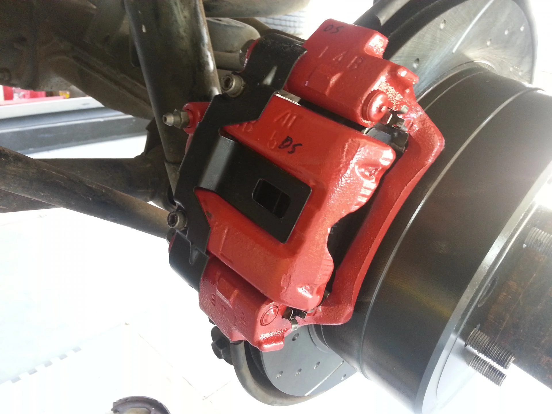

Well I have spent the last two weekends replacing the brakes on the FZJ80 to include all new extended flex lines from Beno, rebuilding the calipers, all new hardware and shoes for the park brake and dimples slotted rotors all around. The big time eater is the cleaning of all the parts to a condition to make them ready for rebuild; 23+ years and they showed every year in ring layers like an old tree.
Found that the forward park shoe retainer was missing on the driver side. This explains a few things. Found the spring stuck under the adjuster spring and the seat wedged between the hub and the speed sensor.

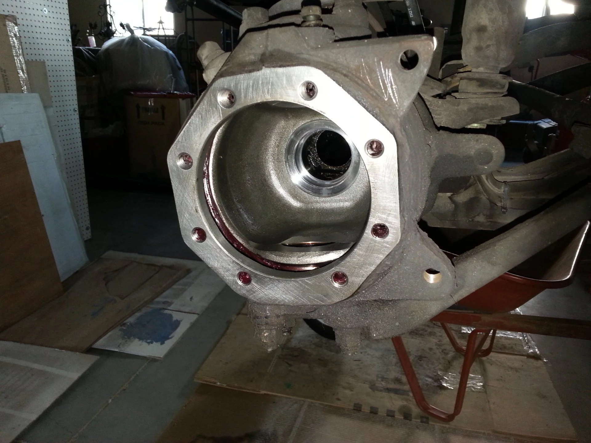

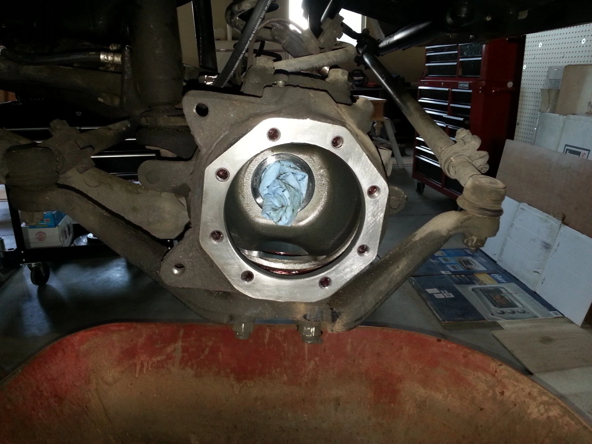

As part of this I began to rebuild the front axle as well. Got things apart and cleaned up and hit my first hiccup when the axle seals that came in my Trailgear kit were not the right ones (Way to small) so got the RIGHT ones on order and next is the passenger side axle.
Yes, that is a wheel barrow under the passenger side axle. It made a great drip/crap collector during this.

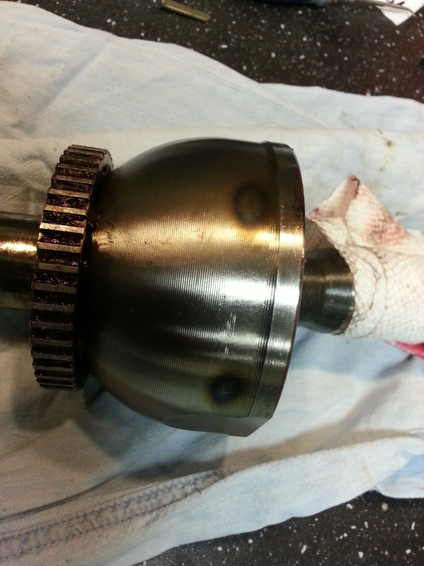

Looks to me like this got a wee bit hot.
While the drivers side Birf was packed in a moly grease the passenger side was just basic bearing grease and the axle shaft seems to be heat seized in the Birf. An hour of banging using the steel pipe trick (which worked first pop on the long axle) and no sign this short axle is going to budge. Considering a little heat/cool cycling on the axle and give it another go when next I have chance. Other than that I am scratching my head on the next option.

Couple of heat cycles on the short axle...more time with the pipe slamming, some time with hammer and drift... and it still wants to be part of the birf...any suggestions greatly appreciated.
Love the wheel barrow. Is that at your house?
They are like that from the factory.
Update:
I had one like that, it finally separated from the birf after constant slamming on the metal pipe very hard. The snap ring took out 2 splines during the separation process. If I have another one like this, I would just clean the birf as clean as possible, then repack with moly grease and call it done.
I have a new Birf (replacing both sides) but now I am considering ordering a replacement short axle.
I spent another hour beating that thing down on the pipe with no success and if it does come out what will be damaged. Add that with every bang the dogs think someone is breaking into the place and go crazy, the wife is asking me to "Stop teasing the dogs" :doh:
I'm still considering pulling the housings and finding a machine shop that will hot tank them for me because I am beyond wanting to excavate 22 years off them in my small parts washer.
I spent another hour beating that thing down on the pipe with no success and if it does come out what will be damaged. Add that with every bang the dogs think someone is breaking into the place and go crazy, the wife is asking me to "Stop teasing the dogs" :doh:.
Were you slamming the birf to the pipe or slamming the birf/pipe assembly to the ground? I used the latter method.
Holding the birf firm to the top of the pipe and slamming them as a unit down on a steel plate.

Well it came out. I put some CO2 to the axle via one of my paintball tanks and when the axle was good and frosty repeated the pipe process. It came out so easily it took me by surprise when I lifted the pipe for "bang #2" and it flopped out on the garage floor.
